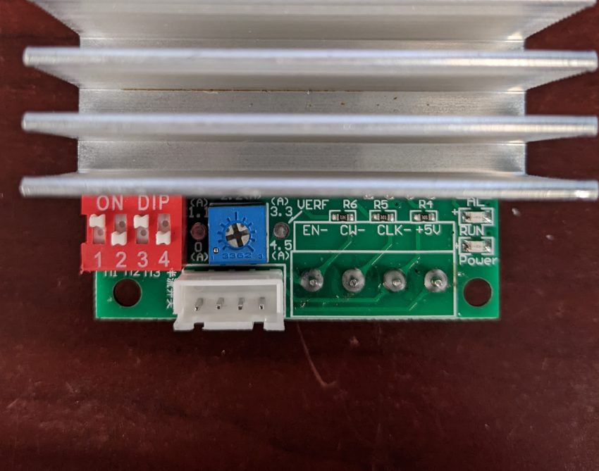

Making adjustments to your current can improve the overall performance of your machine. For the majority of users, you should not have to adjust your current settings for normal use. We recommend adjusting your driver to the position shown below.
If you’ve checked your mechanical parts and have issues with:
  • Vibrations or resonance
  • Missed steps
  • Overheating
We recommend adjusting your current settings.
To adjust the current, simply use a small screwdriver to turn the potentiometer to the current setting you want. Depending on your control box design, you may have to remove the outer casing to reach this spot or there might be a hole in the case that your screwdriver fits into. The two small notches on the potentiometer indicate the direction it’s pointing with the white numbers on the board noting the current at that location. In this photo, you can see that the current is set to about 2A since the slot between the two notches is pointed just to the left of the 2.2(A) label.
Download the instructions to adjust the drivers. The LongBoard allows for a max current setting of 4.5A.
