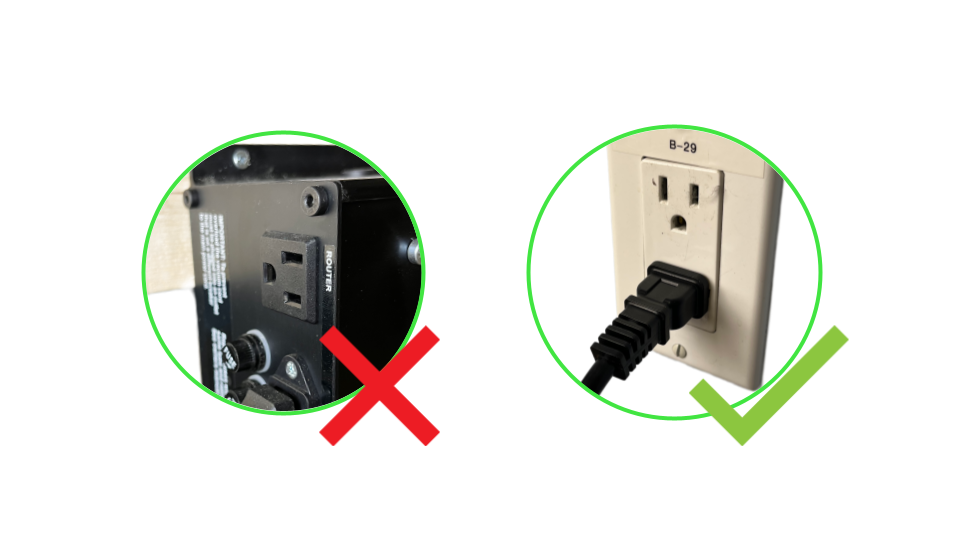

Now we will test that the AutoSpin is set up correctly.
First turning the dial of the router to the “S” position.
Then plug the router into the wall, and flip the power switch to the “I” ON position.
  • If the router spins up automatically, press “Spindle STOP” to turn it off. This bug should be fixed with the newest Masso firmware as mentioned above.
  • Do not plug the router into the relay. This can cause your router to not turn on due to the redundant on/off controls.
The two indicator lights on the router, for the power and spindle mode respectively, should both turn ON .
