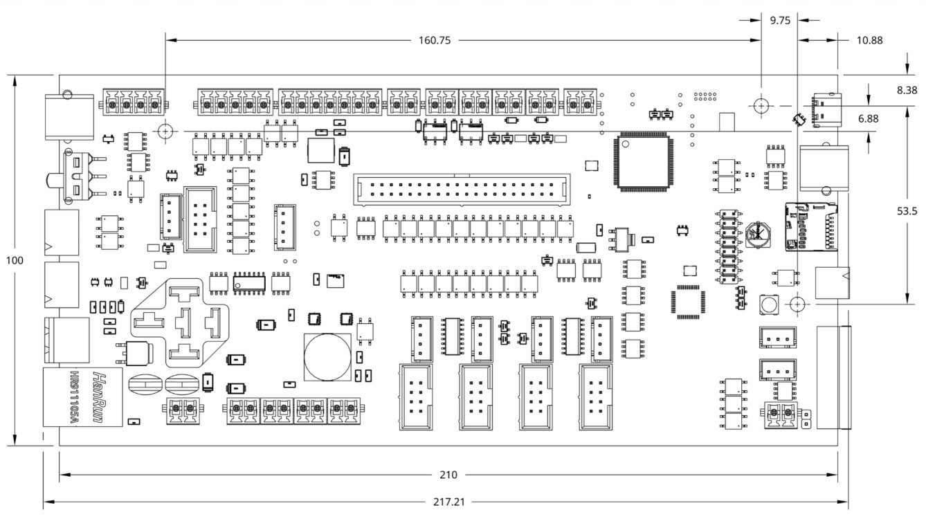

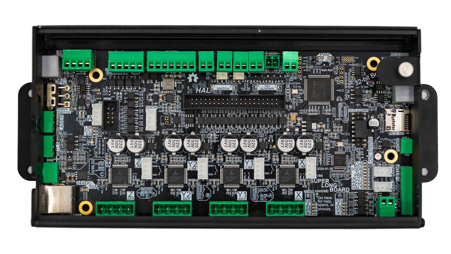

Dimensions
The SuperLongBoard is a typical PCB with a roughly 210 x 100 x 20mm (8.3x4x0.8″) footprint, not including plug stick-out on the short ends. It’s designed to either fit inside its enclosure, accommodate up to 4mm of edge mounting on the long side, or mount via 4 standoffs.
The enclosure has a rough size of 215 x 112 x 50mm (8.5×4.4×2″) not including the 16mm (0.63″) flanges on the short ends. These flanges allow it to be mounted to any flat surface either horizontally or vertically as pictured. The backside of the enclosure also has a feature to fit a bracket which allows the SLB to mount to the Y-axis rail of any LongMill MK2 CNC.
The enclosure has been designed with reasonable consideration for dust penetration, but if you are a more cautious person you can feel free to mount the box further away from your CNC. When placing your SLB on its own or among other CNC control electronics, consider that most wires are designed to route out the backside of the enclosure with the exception of a handful of more typically accessible plugs on its front like the E-stop and USB-C. For more information on mounting the enclosure see the section on Enclosure Mounting.

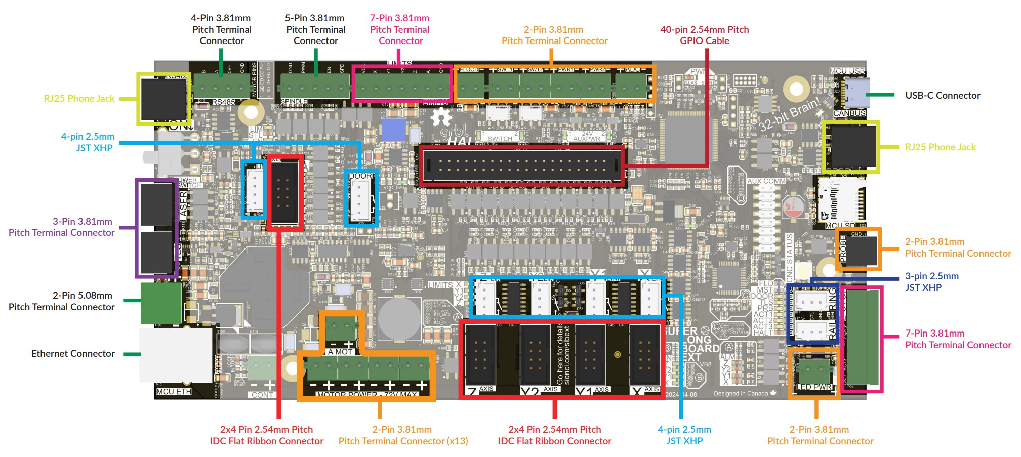

Wiring
The SLB accepts the same or similar input and output plugs as our original LongBoard; you should be able to unplug everything from the LongBoard and re-plug everything back into the SLB without much trouble. The only exceptions are the new USB-C communication cable, and the SpinPWM, SpinDir, and AUX limits, which can be easily rewired to the new terminal connectors with a small flat head screwdriver. The 12V misc output is also now 24V and switchable, see the section on ‘Accessory Outputs‘ to learn about this.
Some of the connectors are inside the enclosure so you’ll need to remove the cover to access them. To remove the cover, unscrew the top-right thumbscrew a couple turns (pictured) then slide the cover to the right. Once the hole in the cover lines up, you’ll be able to pull the top of the cover towards you and it will come free.
Route all the wires from inside the enclosure through the two cable guides at the back so you can close the lid again. The smaller, bottom one is meant to snugly fit all the motor cables, while the remaining cables should all fit into the larger, upper opening. These cable guides will keep all your wires in place when you’re accessing the inside.

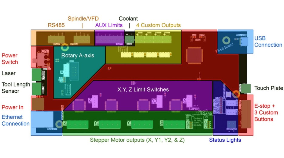

Here’s a general wiring ‘map’ you can use as a reference to start hooking things up. It covers the full scope of plugs and features that the SLB currently supports. Go here for the full list of connectors.
Power & E-stop Power in and control via switch, E-stop, E-stop backup, and board reset
USB & Ethernet Communication ‘streaming’ to the SLB
Motors Typical 3 axis (ganged Y) bipolar stepper motor control
Touch Plate/Probe Supports touch plates or other surface probing
Status Lights Onboard CNC status light, RGB LED strip outputs, other diagnostics lights

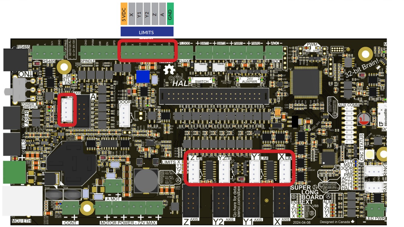

Limit Switches Hookup for Homing/Limits with two plug styles, also supports min/max switches for hard limits
Laser 5V PWM dedicated output for independent Laser control
Action Buttons 3 programmable action buttons that support macros
Accessory Outputs 2 SWITCH outputs that turn on any external circuits 1-24V up to 1A, and 2 AUX POWER outputs which provide up to 24V 250mA to external accessories
Spindle/RS485 Controls a Spindle or VFD using 5V PWM or RS485
Tool Length Sensor Powered input for a Tool Length Sensor for tool changing or for use as a secondary probe
Rotary/4th/A-Axis Output signals for an external motor driver and input of an independent rotary axis limit switch

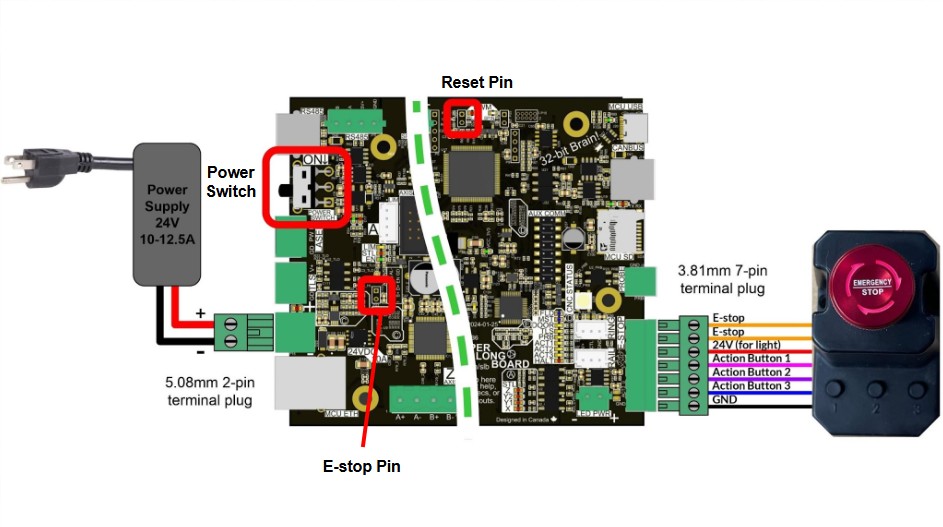

Power & E-stop
Each SLB comes with an E-stop and pre-made wiring to keep you safe out-of-the-box when cutting. When pressed, the E-stop is designed to cut all power to your CNCs stepper motors and also send a signal back to the MCU to disable all other accessories that your SLB controls. This includes turning off the spindle, IOT Relay, and anything else that’s triggered by M3/4 and M7/8 commands. Use the E-stop when there’s a hazard during carving and you need to immediately stop the machine.
Otherwise, the SLB needs a 24V 10A power supply to run all stepper motors at rated current alongside the other onboard accessories. Higher current such as 24V 12.5A is even better so the power supply isn’t strained even during peak draw. You can either provide this yourself, purchase one from us, or use your existing one if you’re switching over to the SLB from our original LongBoard.
  1. The larger 2-pin plug on the left side is the power connection
  2. There’s a main power switch above it to switch main power to the whole board
  3. The plug on the bottom right is for the E-stop and its customizable action buttons

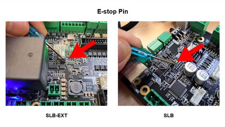

  4. For troubleshooting reasons there’s also an:
    • E-stop pin on the bottom left to act as an override if the main E-stop switch is broken
    • Reset pin on the top right to quickly power-cycle the board
A good rule of thumb is to have the power switch ‘Off’ (slide it UP to be in the OFF position) whenever you plug or unplug the power cable. MAKE SURE the polarity of the power supply connector is correct before plugging it in (red/+ on top and black/- on the bottom, Sienci power supplies should already be correctly wired).
Once the SLB is powered up, press down on the E-stop to engage it and twist it clockwise (follow the arrows) while pulling up to disengage it. You’ll know it is engaged when the E-stop light turns off, and disengaged when the power light turns back on. If you suspect your E-stop isn’t working, check our E-stop troubleshooting steps.
Since each SLB comes with an E-stop and pre-made wiring, you’ll only need to reference the diagram above if you want to make a custom setup or for troubleshooting. If you accidentally plug the E-stop cable into the Ethernet port, this shouldn’t cause any damage to your SLB.
If you want to set up the custom action buttons for your E-stop now, jump forward to the Action Buttons section 🙂

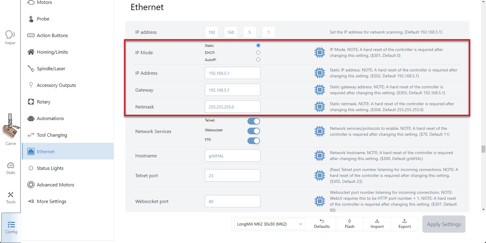

  1. To start, connect to your CNC over USB, open the Config tab to the Ethernet section, and copy down the numbers you see for the ‘IP address‘ and ‘Netmask‘. The defaults should be 192.168.5.1 and 255.255.255.0 respectively, with the IP mode set to static.
  2. Once copied down, you can unplug your USB and connect the Ethernet cable directly from your PC to your board. If you look where you plugged the Ethernet cable into the SLB from the outside, you should see a green light on and a flickering yellow light.

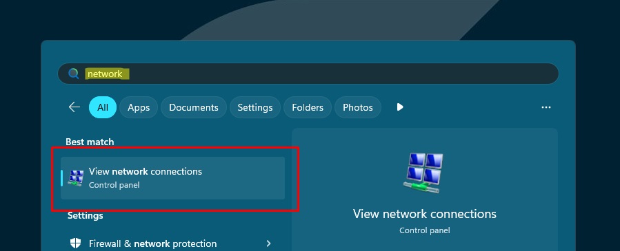

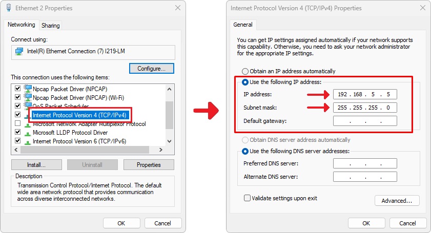

  3. Now you’ll need to configure the PC’s Ethernet interface. Start by opening the Windows menu, searching for “network” and click ‘View network connections‘ to get a list of Ethernet ports.
  4. Here you should be able to find the ‘Ethernet‘ listed that you connected to your SLB. Even if there are multiple Ethernet options, unplugging and re-plugging the cable from the SLB will show which one it is. Once you know, right-click it and open its ‘Properties‘.
  5. In the Properties, find the option for ‘Internet Protocol Version 4 (TCP/IPv4)‘ and double-click it. Here, you’ll want to:
    • Select the ‘Use the following IP address‘ option
    • Type into ‘Subnet mask‘ the ‘Netmask’ number you copied down
    • Type in the ‘IP address‘ that you copied down, just change the last number (for example, change it from 192.168.5.1 to 192.168.5.5)
    • Click ‘OK‘ to save and close the options

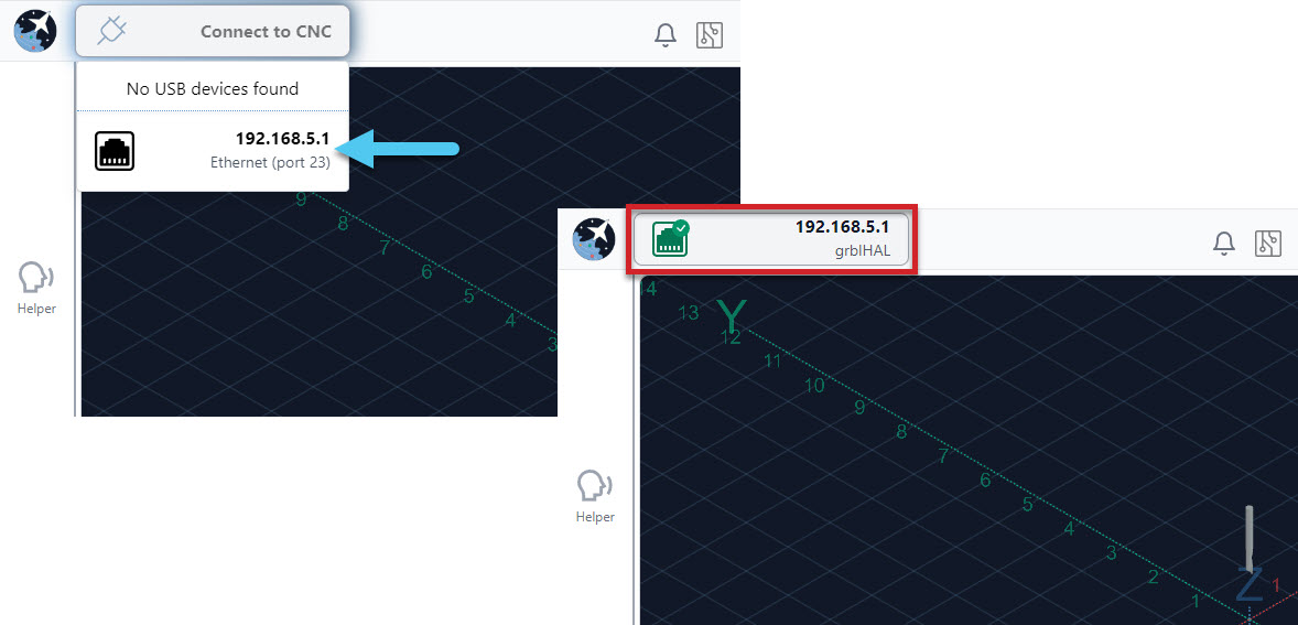

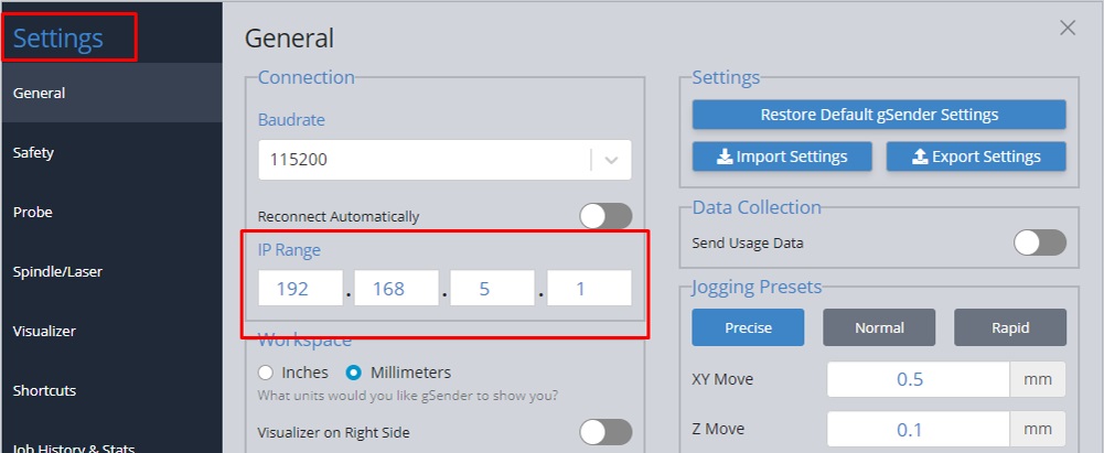

  6. Back in gSenders Config tab ➜ Ethernet section, make sure the IP address for gSender matches the IP address from the firmware.
  7. Now click on Connect to CNC, choose the Ethernet Port option and you should see it connect successfully 🙂
  6. Back in gSenders General Settings, make sure the IP Range matches the IP from the EEPROM.
  7. With the grblHAL firmware selected, choose the ‘Network Devices’ option and you should see it connect successfully 🙂

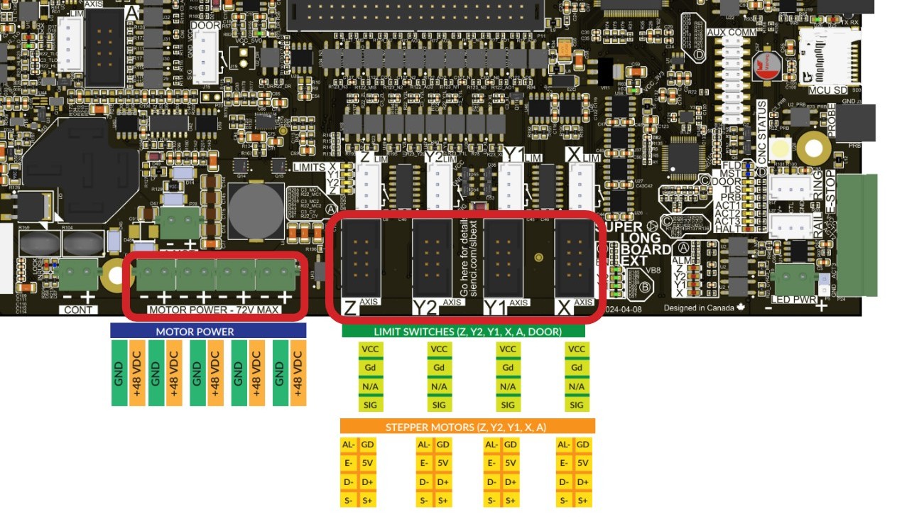

Motors
The board comes with 4 onboard stepper motor drivers so you can plug a typical XYYZ CNC router straight in. We recommend putting the left side motor on Y1 and the right side motor on Y2. If you ever need to swap cables around, grabbing the connectors by their sides and wiggling back and forth helps them pop back off easily.
The TMC2660C motor drivers are capable of 2800mA RMS and should allow for faster speeds than the previous LongBoard’s TB6600 drivers due to their higher efficiency which also means the machine runs quieter. Though they can all run independently (allowing Y-axis auto-squaring in the future), the two Y-axes are currently running ‘mirrored’.

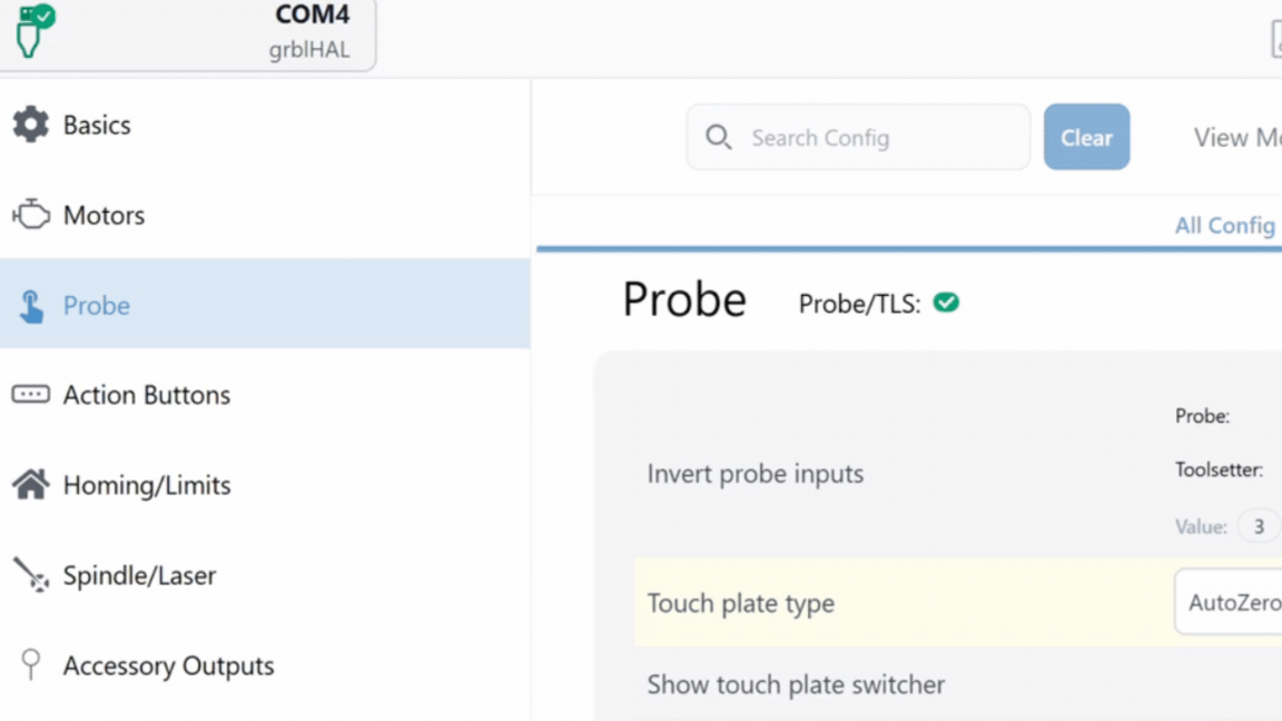

Touch Plate/Probe
Connect your touch plate or probe here. Any Sienci touch plate and many 3rd-party continuity-style touch plates should work and can be configured through gSender. For most touch plates, it doesn’t matter which way you plug them in.
If your touch plate has a third pin for power, consider wiring it to the TLS input at the back of the board instead just to make hookup easier. If you plan to use both the TLS and a 3-pin touch plate, then you can pick up 24V from the E-stop plug or 5V from the Ring LED plug. VCC from the AUX Limit Switch Plus is also typically available.
Touch plate cable goes in the front, above the E-stop cables
If you want to check continuity, tapping the touch plate and magnet together should turn on the yellow ‘PRB’ LED near the touch plate connector. For a NC probe this behaviour will be inverted.
You should find that probing with the SLB is faster due to its 32-bit processor, speeding up cycle times for zeroing and tool changing. You might also find that the touches are so much more sensitive that you don’t need to hold the touch plate in place anymore. Otherwise, all other aspects of probing should follow what you’re familiar with.

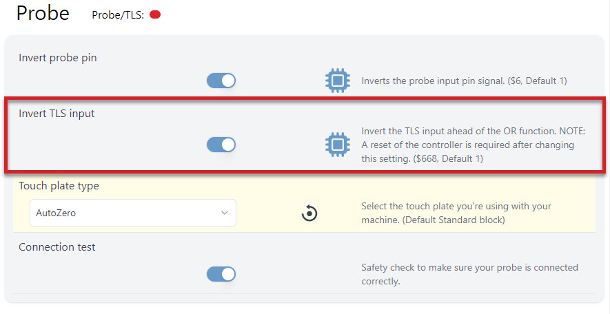

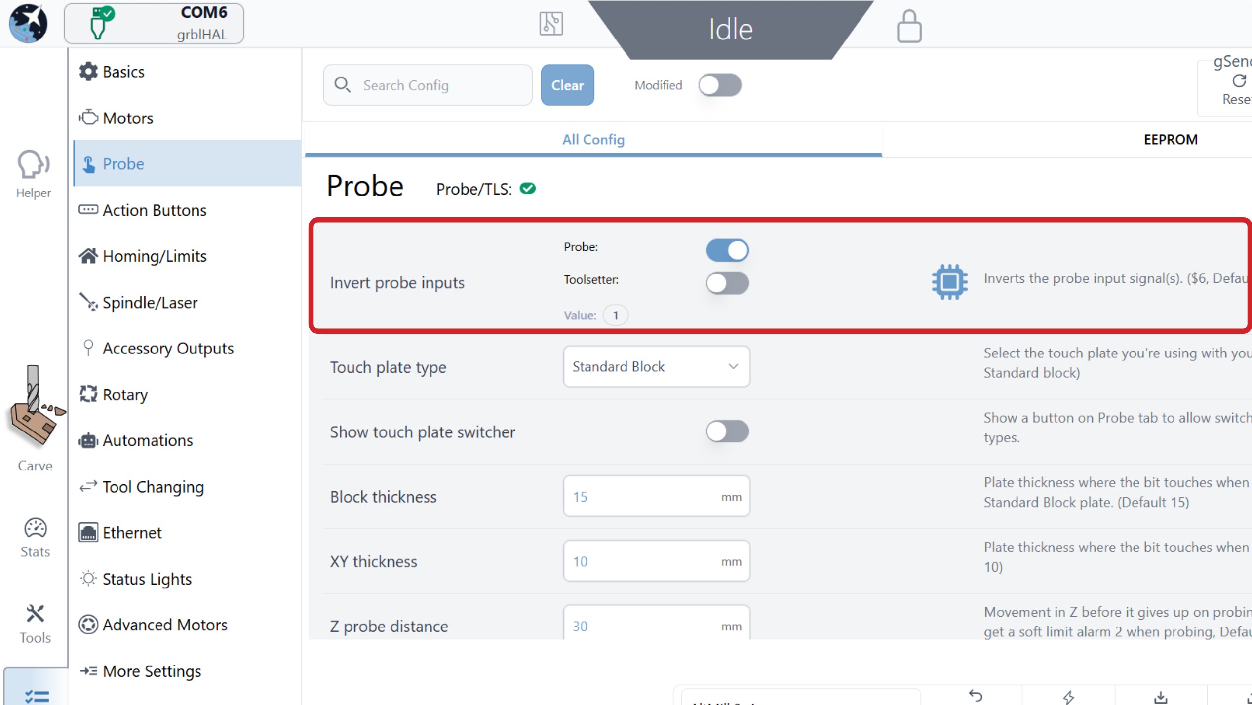

If you go to probe and find that there’s a touch being detected when there shouldn’t be, either the probe or the TLS signal needs to be inverted. Try combinations of toggling the $6 and $668 EEPROM values to the opposite of what’s currently set then check again. For other reading on touch plate setup, see our MK2 resources here: https://resources.sienci.com/view/lmk2-touch-plate/

Homing & Limit Switches
Any common limit switch is supported on the SLB: NC (normally closed) and NO (normally open) mechanical switches, NPN Inductive sensors, and more. You can wire one-per-axis, or two-per-axis if you’d prefer to have your CNC set up with hard-stops at the min and max travel. Some switches will already be able to plug straight into the white, 4-pin JST connectors for each axis (like our inductive sensors) – otherwise we’d recommend wiring to the green terminal connector (circled at the top of the picture).
Dual Y homing will be available in the future, but for now do NOT use the Y2 limit switch plug.
If you’re looking for advice on how to ensure you have reliable sensing:
  • Make sure the limit switches you’re using are precise and that they also stay consistent in different temperatures (the manufacturer should provide this information) otherwise the switch might activate 2mm away when you’ve got your shed heater on but 2.2mm away if you open the door
  • Mechanical switches can usually be wired as either NC or NO. If you have the option to choose:
    • NC is safer since the wires always carry a signal back to the controller, so you can be confident your switches will work but if your wiring is loose then it can cause errors at unexpected times
    • NO has the opposite problem where if a wire is loose then you’ll only find out once the CNC rams into itself during homing or running a job; some people prefer this since it’s easier to recognize the switch/wire is bad in the moment, but it’s less safe and can cause damage to some CNCs
  • Occasionally check your wiring by pulling or wiggling it to make sure nothing is loose – all switches share the same ground and VCC signals, plus individual limit signals, so a false trigger could ruin a job
  • Using shielded cable can help dissipate electrical noise in the wires and prevent unexpected triggers
Using the big green connector is the same as using the smaller white JST connectors, they are connected to each other on the board so it doesn’t matter which one you use. The terminal pinouts are VCC, X, Y1, Y2, Z, A, GND going left to right, and the JSTs are VCC, GND, N/A, LIM going top to bottom. The most common custom setup is shown below (NC switches or NPN sensors wired to the green connector).
By default, VCC outputs 5V. If you want to wire for a different setup, see below for other wiring variations:
  • NC (also already shown above), NC with hard-stops
  • NO, NO with hard-stops
  • NPN (already shown above), and NPN with hard-stops
If you’d like to use the white JST connectors instead, the wiring pinouts are below for both mechanical switches and inductive sensors. All VCC outputs can also be changed from 5V to 24V if you’d like (user-made video by SparksTech) by breaking the 0Ω resistor on R9 and creating a solder bridge across R10 (outlined in red in the middle of the first homing picture).
Limits Settings

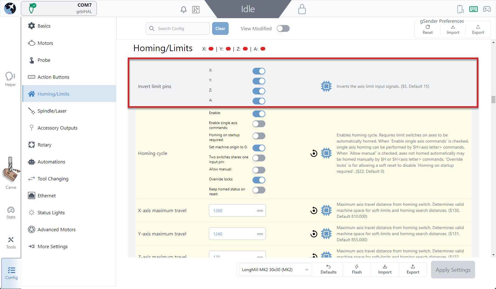

If you’ve set up your own NC sensors, the first thing you’ll want to do is invert all the limit pins for $5 like shown below. Don’t do this if you have the inductive sensors from Sienci!

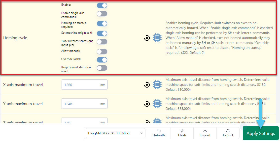

On top of the typical settings that the original LongBoard has when it comes to homing like homing speed and direction, the SLB brings along some new options that you can configure. If you’d like to match the SLB behaviour to the typical LongMill/grbl setup, then we’d recommend you enable all the settings shown in the picture (homing on startup, set machine origin to 0, and override locks), otherwise learn about all the settings in the table below.
Classic gSender

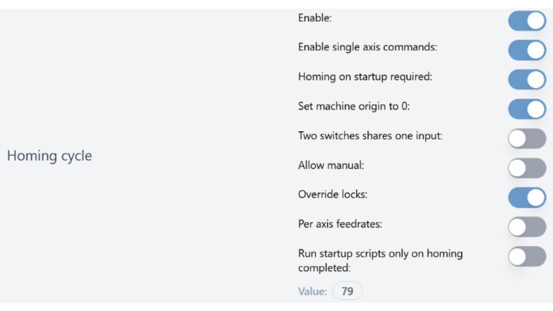

Setting Description
Enable Turns on homing
Enable single axis commands Allows special homing commands so you can, for instance, re-home only your Z-axis without having to re-home the whole machine
Homing on startup required Reminds you to home your machine every time you power it on, since CNCs typically lose their position when they lose power
Set machine origin to 0 Typically enabled so that re-homing re-zeros the machines location
Two switches share one input pin Enable if you plan to set up hard limits at the end of each axis
Allow manual If you want to home an axis that isn’t homed when you ‘Home all’
Override locks In case you’ve turned on ‘Home on startup’ but want to skip it in certain cases
Keep homed status on reset In a case where the machine is reset, it’ll try it’s best to maintain the machine position and not force you to re-home
Some other new settings that have been introduced include:

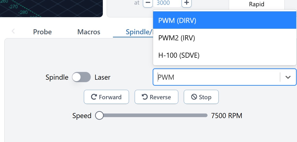

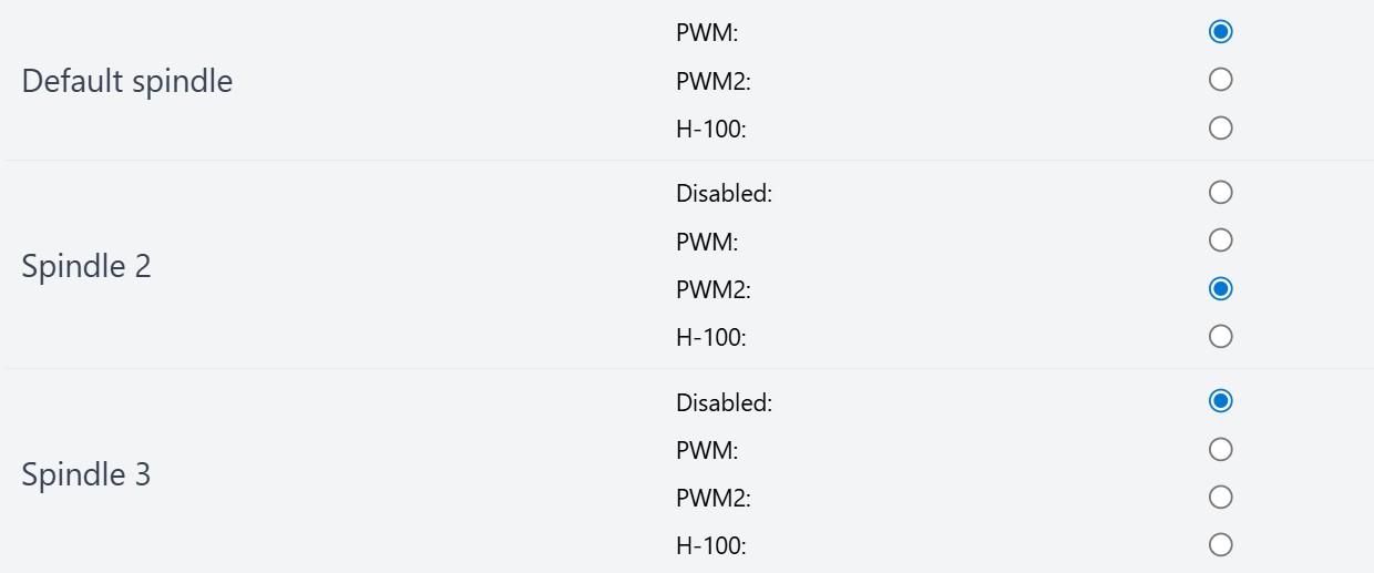

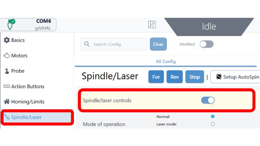

You can only control one at a time, so to select which one you’d like to control you can use the dropdown selector in gSender or use the selection commands. This selection will also apply when you send manual spindle commands in other ways like the console.
Current
Classic gSender

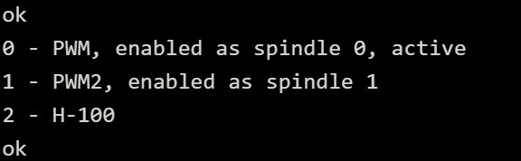

For other g-code senders, you’ll need to use the selection commands:
  • By default, the SLBs spindle output is set up as the “Default spindle” ($395), with the Laser output as “Spindle 1” ($511) and the RS485 as “Spindle 3” ($513)
  • Because the laser is set as “Spindle 1”, sending “M104Q1” will switch to controlling the laser
  • Similarly, “M104Q3” will switch to RS485 output, and “M104Q0” will switch back to the spindle output
  • If you ever want to check which output is currently being controlled in the console, you can send the “$spindles” command which will list all the options and which one is currently selected
Knowing all this, you can go into the EEPROM to change your selections for the Default Spindle, Spindle 1, 2, etc. to match how you tend to use your CNC. Then, you can use the dropdown in gSender or the g-code commands to switch outputs when you need to. Ensure that you only turn on ‘Laser Mode’ AFTER you switch over to the laser output, as well as turn off ‘Laser Mode’ BEFORE you switch back to any other output, otherwise you’ll see an error.
If you run into an issue where switching between outputs gets stuck, this can be fixed by power-cycling the board.

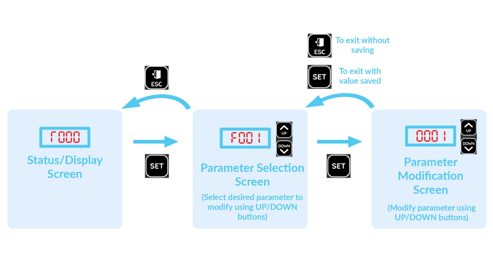

If you purchased a VFD that wasn’t pre-programmed from the manufacturer for your specific setup, then you’ll likely need to double-check some settings using your VFDs built-in keypad. Most VFDs share 5 similar buttons where you’ll press:
  1. PRGM/SET/PROG to enter into the settings menu
  2. Use the UP and DOWN arrows to cycle digits from 0-9 and use SHIFT/ to move left to edit higher digits
    • Use this to go to the setting you’d like to check
    • Example: if you start with “000” and you want to get to setting “023” then you’ll start with the right digit highlighted (000), press UP 3 times (003), then SHIFT to get to the next row (003), then press up twice more (023).
  3. Press SET/DATA to open up the setting
  4. Use the same UP and DOWN and SHIFT/← buttons if you want to change the setting value
  5. Press SET/DATA if you’d like to save the new value, or press PRGM/ESC/PROG to leave without saving
  6. You can go back to the setting to check that it’s been set correctly if you’re rusty on changing settings

  • $35 Spindle PWM min value = 0%
  • $36 Spindle PWM max value = 100%
  • $395 Default spindle: SLB_SPINDLE
  • $520 Spindle 0 tool number start = 0
  • $666 Using Add-ons not used yet
Verify these, then power-cycle your board to make sure the changes take effect. If you’re rather wanting to set up RS485 as default, then you’ll want to change $395 to one of the other options.
  • The list of already supported VFDs is the Huanyang v1, Huanyang P2A, Yalang YL620, H-100, and GS20 as noted in https://github.com/grblHAL/Plugins_spindle/tree/master/vfd. That doesn’t mean selecting these is guaranteed to work, rather that they tend to work for those generic models.
  • If your VFD isn’t listed or the other defaults aren’t working for you, you can select “MODVFD” to setup your own custom RS485 settings. Disconnect and reconnect in gSender to see these new settings. They’ll span $462-481 and include registers, command words, addresses, all values that you’ll have to consult your VFD manual for.
    Remember that your VFD will also require some setup through its own button interface or sometimes require jumpers to be placed correctly
  • Remember you can set up more than one option, for example you can leave the Laser as your default ($395), set the simple Spindle as your second option ($511), then RS485 as your third ($512)
  • In Step 4 of the Laser section, it explains the process of switching between output options
  • For more info, the letters next to each spindle in the dropdown indicates its abilities:
    • V: Variable Spindle speed supported
    • D: Spindle Direction (M4) supported
    • S: Spindle at speed feedback supported
    • L: Spindle can control a laser (requires laser mode to be enabled in firmware)
    • I: Spindle PWM output can be inverted
    • R: Range Locked (min/max not inherited from Config/firmware settings)
    • So for example, “DIV” means you can swap spindle direction, invert output, and have variable speed on that specific spindle.
    • Also, the list of spindles has a fixed order just for easy reference, otherwise the order they appear in has no other meaning
Find more information for VFD setup at https://wiki.printnc.info/en/electronics/vfd/config or https://github.com/grblHAL/Plugins_spindle/blob/master/vfd/

Short for “Tool Length Sensor”, this is a very common accessory for slightly more fancy CNC routers. Mounted somewhere the CNC can reach, they’re used as a reliable place to go to re-zero the Z-axis on jobs that require multiple tools/ tool changes. This is also handy when your original Z zero is lost because the material is cut away, a perk over a standard Touch Plate. TLSs are typically NC (normally closed) switches so that if the wire gets cut the machine doesn’t crash into the sensor. The TLS output on the SLB also provides 5V power for powered TLSs, the wire order being power, signal, gnd (top-to-bottom).

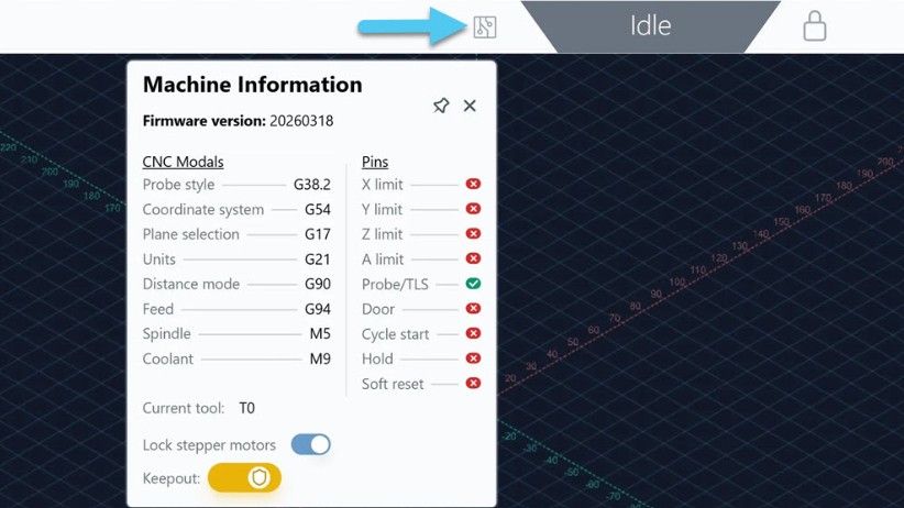

If your TLS is wired correctly, you should be able to press it and see the “PRB” status light toggle on or off on the SLB (either is fine, on is NO, off is NC). If you’re unsure with your wiring or your TLS has more than 3 wires, you can use a multimeter and check any two wires until you find a set that contact/open when pressed and those will be the ones you use for the signal and gnd; the third might be power. If you have 4 wires your TLS might have 2 switches, one that triggers when pressed down just a bit then the next one pressed in case of over travel. This would typically trigger an E-stop or Pause but you only really have to use the one that triggers first.
With wiring done, check in your g-code sender if the TLS signal is set up correctly. This signal is shared with the touch plate, so activating either of them should be recognized. gSender has a status light to help see this in the ‘Calibrate’ tab and in other senders it should appear as ‘P’ for probe. If the light in the sender turns on when the TLS is pushed, and also turns on when the probe circuit is connected, then the hardware (SLB and wiring) is working and that means the $ values have been set up correctly. If the signal is on and only turns off when the TLS is pressed, then go to the $668 firmware setting and toggle it to the opposite of what it was set to.
Current
Classic gSender
This flip is usually needed since the SLB defaults to expect NO inputs. Once this all seems to be working, see more documentation here on how to set up tool changing for your SLB (gSender tool changing feature) and make sure you select the ‘Fixed tool sensor’ option.

Driver Wiring
This takes the form of two independent plugs labelled for an “A-axis”, where you can plug in your:
  1. Motor driver to the drivers signals on the SLB (black plug)
  2. A-axis limit switch (white plug), and
  3. Additional power supply to your motor driver
Any motor driver that can be driven by Step/Dir common-cathode arranged signals will work as long as it’s rated for the stepper motor you’re planning to use. The black connector is a “Female IDC Flat Ribbon Cable Connector, 8 pins, 2 Row, 2.54mm Pitch”, but you can also use any 2.54mm spaced connector cables. Also if your limit switch doesn’t have a JST connector, you use the terminal connector ‘Limits’ A-axis output.
Below we’ve illustrated two examples that you can use to better understand how to create your own setup. One shows the TB6600 driver and uses the IDC connector with all the available connections running to the SLB. The other has the DM542 driver hooked up with single-wires and bridging between the ground pins. Either hookup method is fine no matter the driver, just note that different drivers will have their outputs in different orders. The drivers will also require you to use an appropriate power supply, manually configure the DIP switches for current or holding current, as well as set the microstepping (most times we’d recommend 1/8th).
  • D+ goes to DIR+
  • S+ goes to STEP+ or PUL+
  • 5V goes to EN+ or ENA+
  • GD goes to the Driver ground pins like DIR-, PUL-, etc.
  • AL- likely won’t be supported by your driver, but is an active-low alarm signal for the motor driver to tell the board if something has gone wrong similar to the E-stop
Once the wiring is complete, in your g-code sender check that the rotary is moving at the speed, distance, and direction you’d expect and that the limit switch is working if you have one. If there’s anything wrong you’ll want to check your typical A-axis settings for movement ($2, 3, 4, 37, 103, 113, 123, 133, and 376) and for homing/limits ($5, 18, 23, 44, 45, and 46). Note that some settings like $143, 153, 183, 193, 203, 213, 223, 338, 339 won’t have any effect on your setup since the 4th axis is an external stepper motor driver.
If you’re experiencing movement precision problems, check the 2nd point in the Troubleshoot Rotary section. Also check that you turn on “Steppers deenergize” for the A-axis, since most closed-loop motors need constant power to them to make sure that they make accurate movements.

Technical Reference
Connectors List
The SuperLongBoard comes with many inputs and outputs that are easy to wire in for CNC customization and accessory hookup by using pluggable terminal connectors. There are also a handful of other connectors used that are common and widely available for purchase. Below lists all connectors used on the board (male) with example links:
SLB EXT Plugs:
If you don’t happen to have these specific connectors on hand there are also common ‘hookup wires’ that ship with many electronics or Arduino kits that are 2.54mm pitch that you could also use to make many of the above connections.
Current Unused Ports
Right now there are a handful of plugs and pins on the SLB that technically don’t do anything useful yet which is why there’s nothing in the manual on it. The idea was that by adding in the hardware at the start, we could keep working on testing and implementing firmware to make more features available to all SLB owners without having to buy a new board. We’re very excited about it but ultimately can’t make any guarantees on what will and won’t ultimately work, so that’s why no features have been promised yet outside of what’s already been tested and delivered. These ports include the: Y2 Limit Switch, SaS Spindle pin, Pendant, SD card, Door, ADC, 40-pin AUX COMM Header, and AUX IO Header.
If you’re still interested in trying these out without our support or documentation, we have all our board designs and firmware code available online for reference and modification so you can feel free to try your own stuff and even contribute back to the project! For instance, you can see the 40-pin inputs and outputs in the full schematic PDF on page 19.
