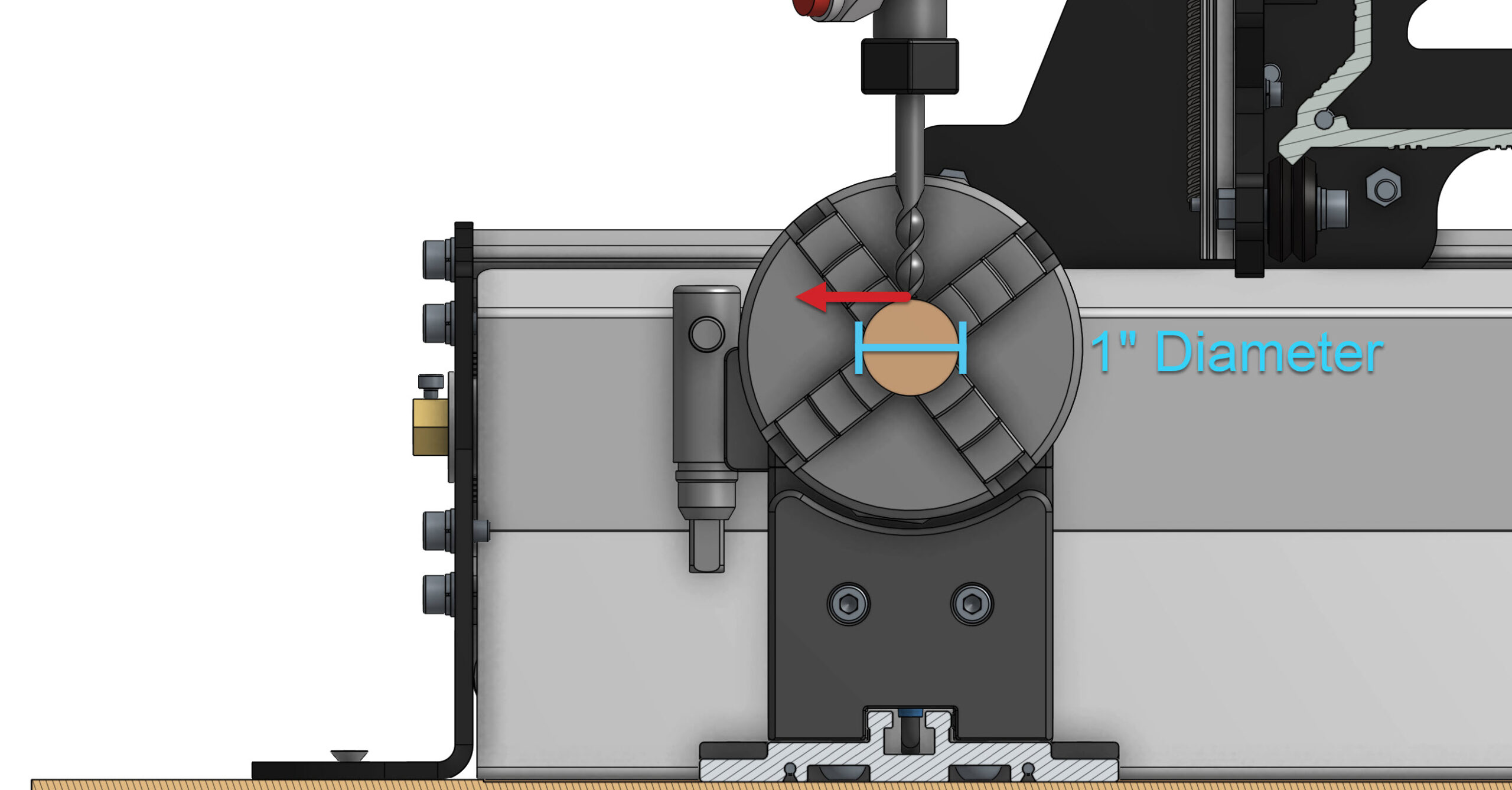

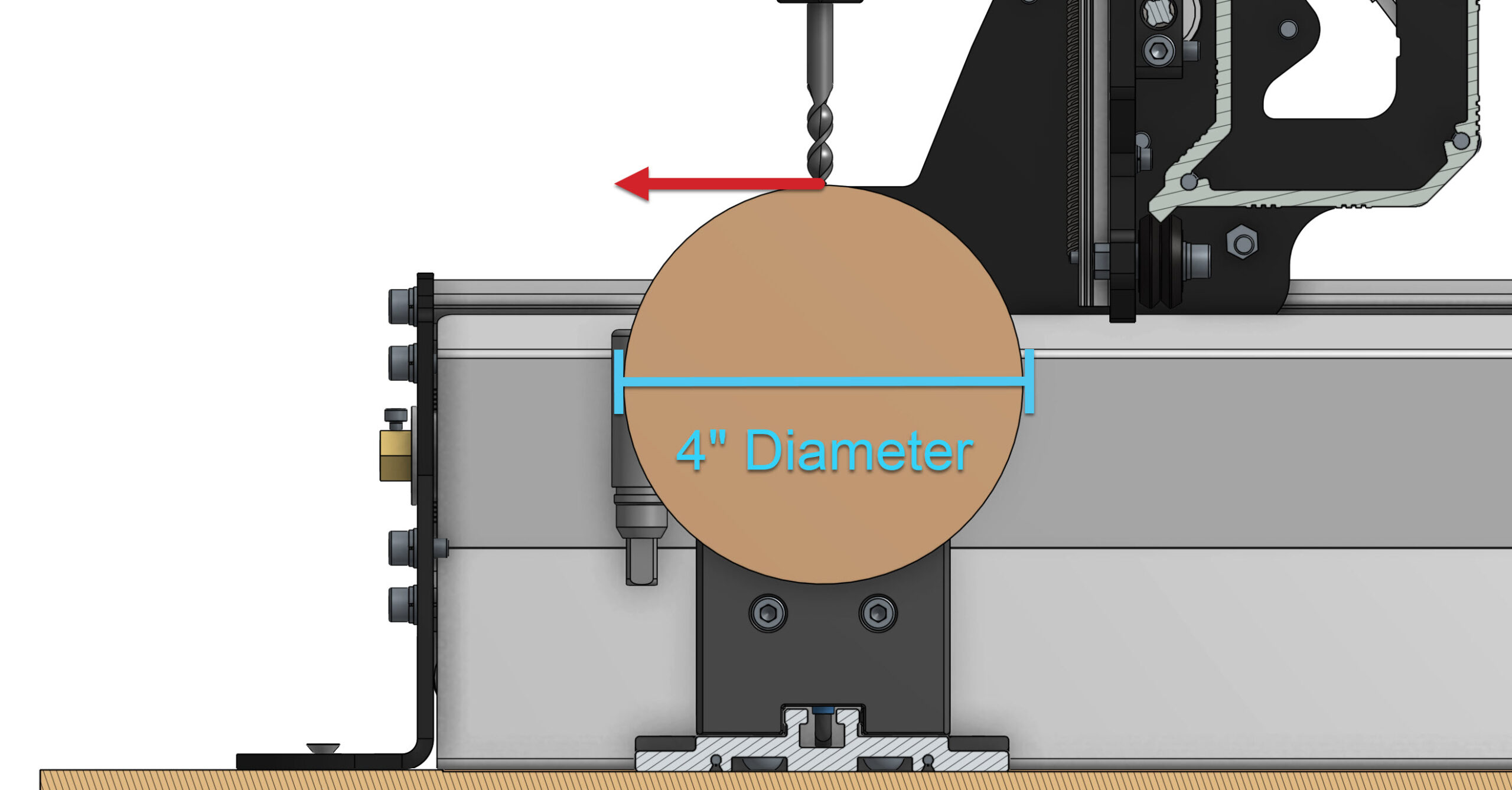

Let’s explore the relationship between feed rate and machining diameter.
Essentially, since our ‘feed rate’ is given by how fast the cutting bit travels linearly through the material, we’re concerned with the surface speed of the bit against the material while it rotates. This ‘surface speed’ is defined by:
Rotational Speed X Distance of the Bit from the Rotating Axis
(usually dependent on your stock diameter)
This relationship means that if your stock diameter is halved, then your feed rate for the A-axis/rotary axis should be doubled.

Using an example feed rate of 2000 mm/min, we get a rotational speed of (2000 deg/min) divided by (360 mm/rotation) to get 5.55 rpm, or 34.9 radians/min.
For 4 inch diameter stock, we can multiply this rotational speed (34.9 radians/min) by our radius (50.8 mm) to get a feed rate of 1773 mm/min. This isn’t exactly the feed rate we’re looking for, but is close enough that it won’t make much difference.
Once we move over to a 1 inch diameter stock, our true feed rate at the surface becomes (34.9 radians/min) X (12.7mm radius) = 443 mm/min feed rate, which is much too slow for what we’d typically use.
