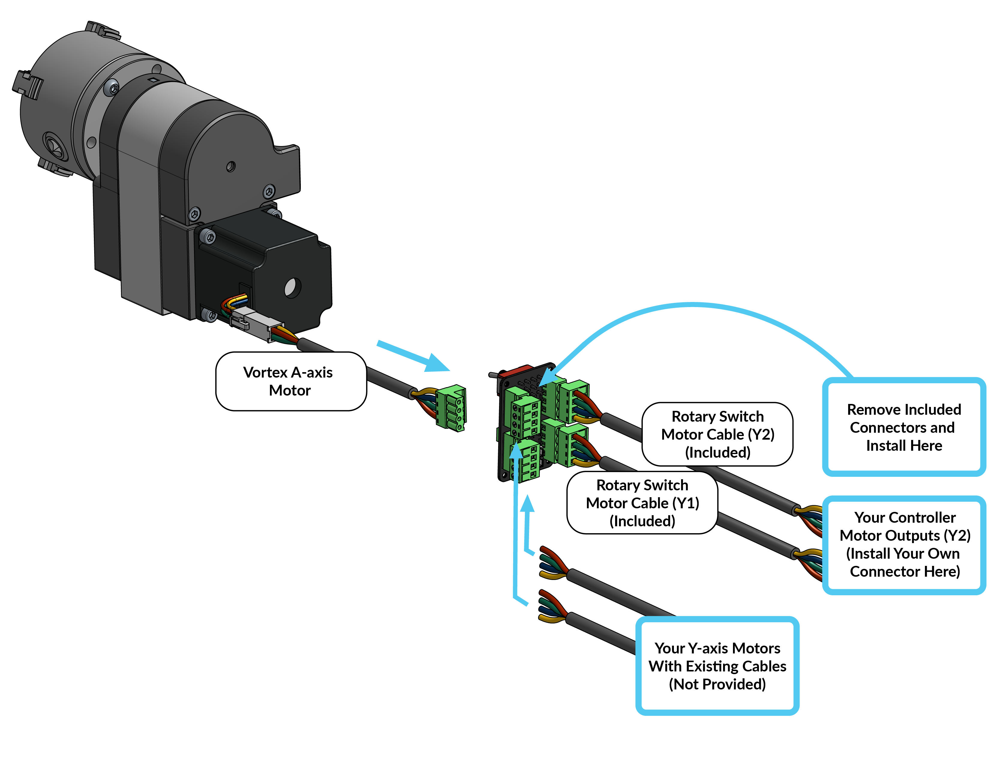

Wiring
A notable feature of the Vortex Rotary Axis is its ability to ‘intercept’ the Y-axis motor signal/power between the controller and motors. With the flip of this switch you’re able to enable use of an A-axis instead of your Y-axis. This is highly convenient for machines/controllers  limited with up to 3 axis of simultaneous control such as most popular grbl-based controllers.
If your controller happens to have support for an independent A-axis already, you’ll likely want to skip this section and wire the Vortex A-axis motor cable directly to your controller’s A-axis output.
Follow the diagram shown below to reconfigure your controller’s Y-axis wiring and ‘insert’ the Vortex’s switching module in between this connection. Depending on the connector type used on the motor cables for your machine, you may need to (destructively) remove and strip wiring to adapt this to the green terminal-style connectors used across the Vortex. Do this at your own risk as we cannot offer support for any faulty cable connections or repair to your machine’s factory condition.
An alternative way to do this non-destructively, is to purchase or create new wires with your Y-axis motor’s appropriate connectors, then purchase the appropriate connectors to interface with the controller-side of the Vortex’s wiring harness.
The Vortex features an integrated limit switch. This switch operates using a 5V, 3 pin connection, which may or may not be compatible with your controller. To wire this connector, you may choose to simply plug this into your controller while in use, or wire this in parallel somehow with an existing Y-axis limit switch on your machine.
The Vortex switching module includes three white JST XH2.54 connectors used for wiring the A-axis and Y-axis limit switches in parallel, so that either can be used without unplugging anything. If possible, you may want to crimp this type of connector onto your limit switch, and wire this accordingly. The Vortex kit also includes a limit switch interface cable that can be wired to your controller for this purpose.

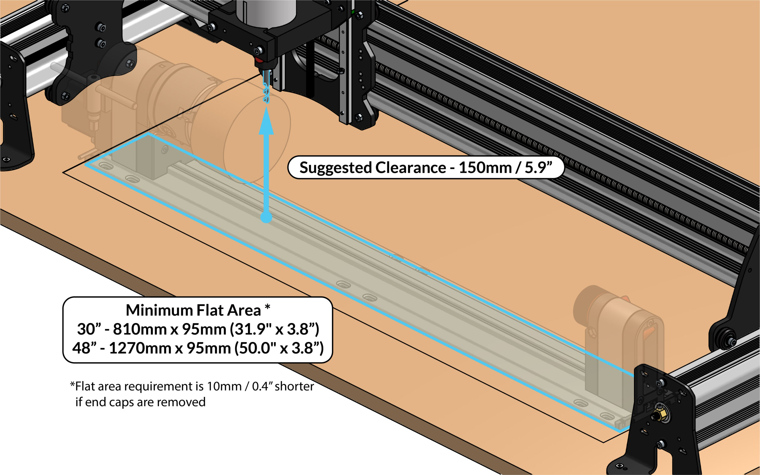

Physical Setup
The Vortex was largely designed to be very universal, mounting on any machine surface that can have a set of threaded inserts installed. The main considerations you’ll need to make are:
  • Does the X-axis beam/gantry of your machine allow for enough clearance to machine reasonable diameters of material on the Vortex?
  • Can you raise how far your router or router mount sits on your machine for extra clearance?
  • Is there adequate spacing to fit the Vortex between the left and right sides of your machine table.
For reference on making some of these checks, you can refer to the illustration below, as well as check out the open-source CAD model available here
