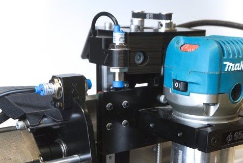

Limit switch / Endstop / Homing switch – Switches or sensors that are usually paired to each movement axis of the CNC. This is used to tell the machine how far it can move in either direction. Limit switches can be used for homing, as soft limits, or as hard limits.

Homing – If you have limit switches, this is normally run when you first connect to your machine, so it knows where its limits are. This can be handy during a power outage or for advanced jigging since your machine is able to remember where it ran a job.

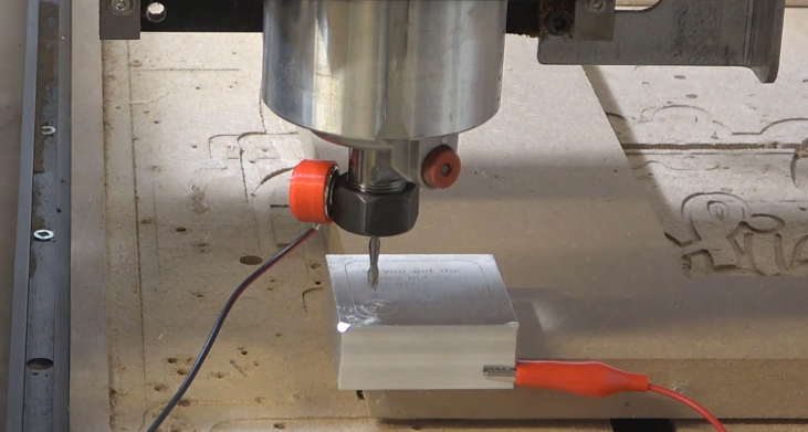

Probe – Usually using a touch plate to set the zero or origin on your material so you can run the job at the correct location. This can also become more complex by setting certain axes individually, using other conductive materials for location, or using a special sensor to compile height-maps, angles, and more.

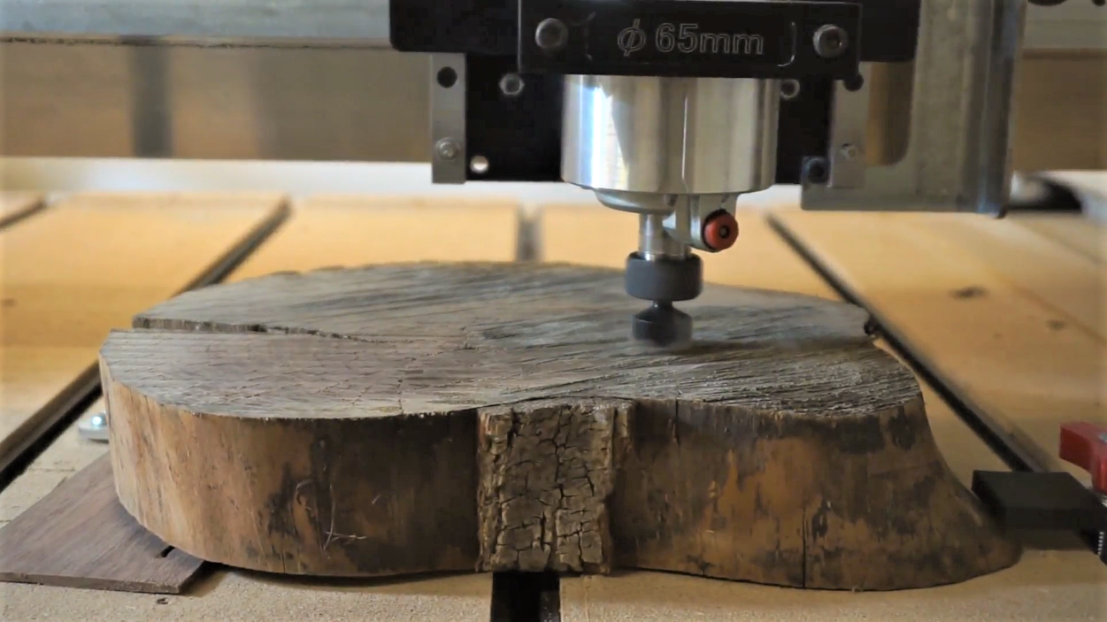

Surfacing – A job specifically used to flatten a piece of material. This can be a wood slab or the wasteboard itself, done during machine setup or maintenance to keep it level to the CNC’s mechanics. Typically you use a surfacing bit which has a larger cutting diameter.

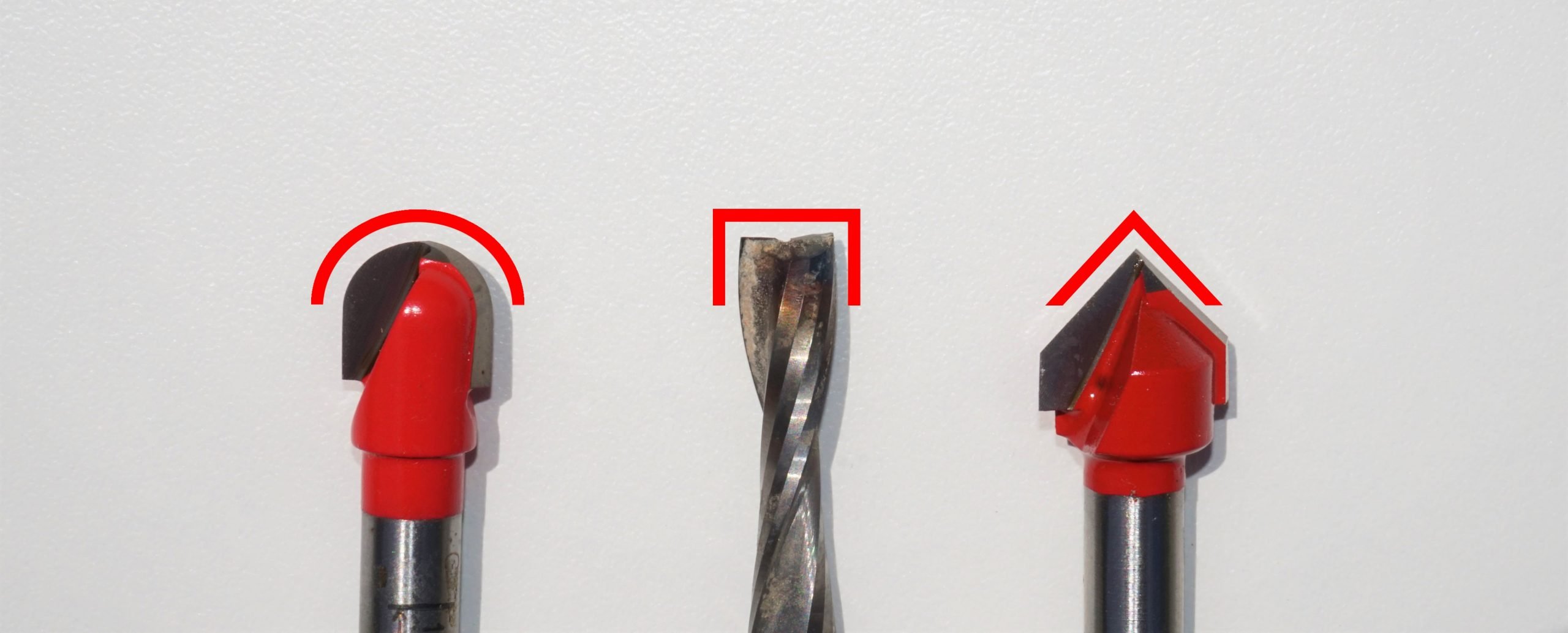

End mill – Bits with spiraled flutes, which can come in with many different tip shapes.
Flute – A groove on the cutting bit to allow for material to be ejected. Bits can have more than one flute, which increases the surface area of contact with the material.
Round groove / Juice groove / Bowl cutting bit – Has a semi-circle profile, which works well for carving rounded profiles.
Surfacing bit – Has a large cutting diameter, used to remove large areas of material at a shallow depth. This is used to flatten out material.
Tip / Flute shape (upcut, downcut, compression, straight, corncob) – The shape of the end mill you are using, which determines its application.
Flat end mills have a square tip. They can also have spirals (upcut or downcut), or be completely straight. These are good for general purpose milling, such as cutting out borders or straight profiles.
Tapered bits become more narrow at the tip, which allows for small details to be cut.
Ball nose bits are rounded on the tip, similar to round groove bits. They are used for reliefs and 3D carvings.
Upcut and downcut bits have opposite spiral directions, causing the material to be pushed either up or down respectively. Upcut bits are best for cutting materials that can melt onto the bit, such as plastics and aluminum, since these chips can be ejected out of the material. Downcut bits can be used for woods that can splinter easily, because they push the chips down which creates a cleaner finish.
Compression bits are a combination of upcut and downcut bits, with spirals in both directions providing a clean finish and also ejecting chips from the cutting surface.
Straight bits do not have any spirals, instead it has flat faces which run down the length of the bit. They are used for cutting plastics, woods and composite/laminate materials which are susceptible to fraying.
Corncob bits have a unique diamond pattern which allows for abrasive materials to be cut, suitable for composite materials such as PCBs and carbon fiber.
V-bit – Has a pointed tip in the shape of a ‘V’ and works great for cutting away as an engraving, making lots of different details especially for signs. They can also be used for inlays and chamfering and come in many angles such as 30°, 60°, 90°, and 120°.

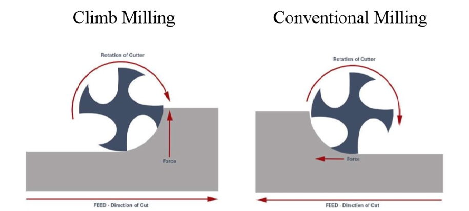

Climb milling – A milling technique in which the CNC machine is moving against the router / spindle rotation. This causes more cutting forces than conventional milling, but can provide a better surface finish. If climb milling, there must be compensation used to eliminate backlash.
Conventional milling – A milling technique in which the CNC machine is moving with the router / spindle rotation. This method eliminates backlash but can reduce tool life and surface finish due to chips and material rubbing onto the tool.

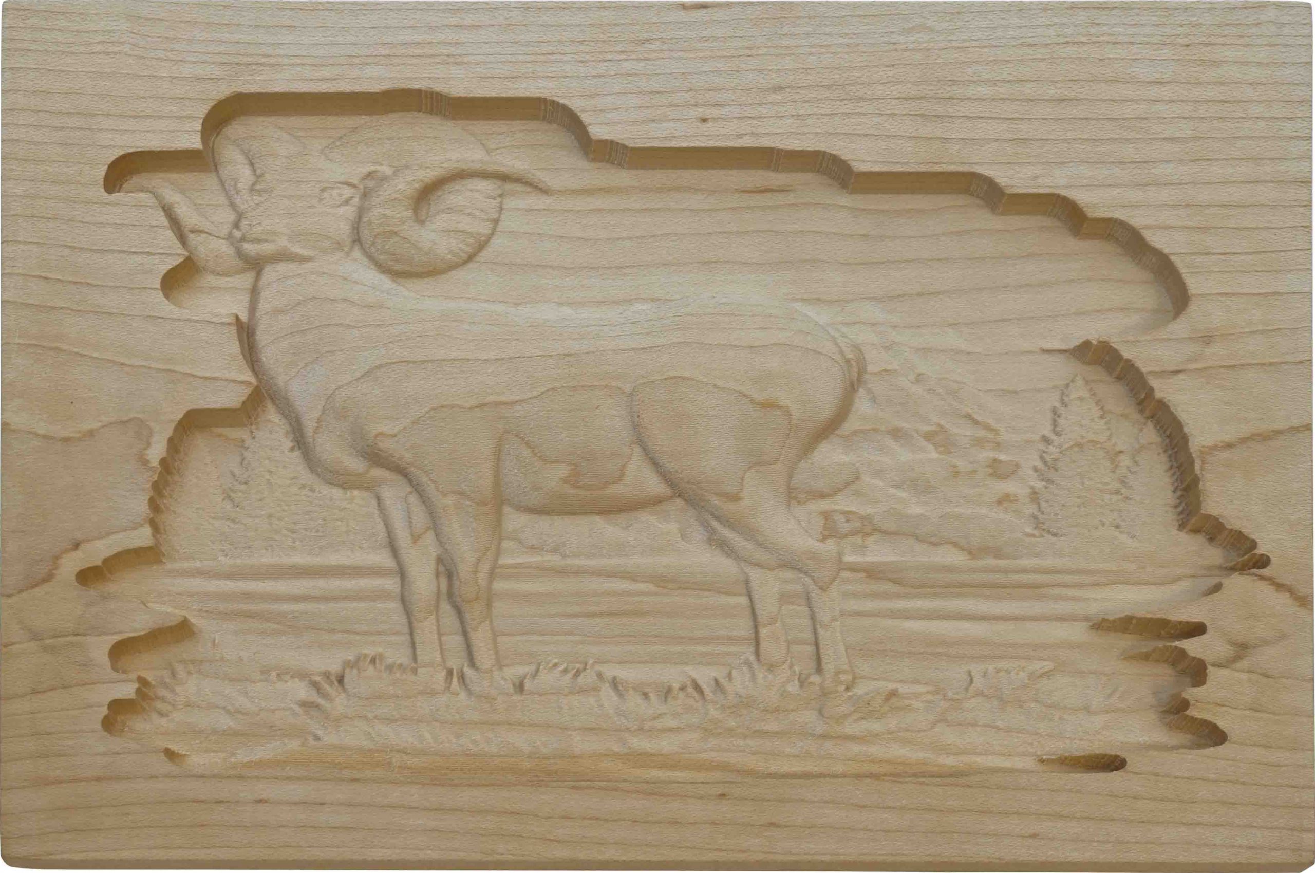

Relief cut – A type of toolpath where the machine cuts raised geometries from one side of the stock material. For example, mountain terrains are considered relief cuts, because of the slopes and valleys.

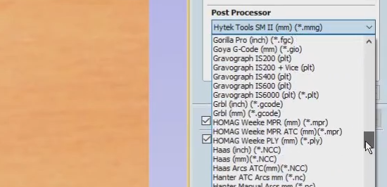

Post Processor – A “translator” which ensures your g-code is set to the correct language such as grbl. This is found in the CAM software and can be changed for each g-code file.

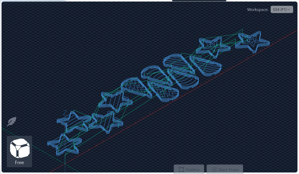

Visualizer – A program that shows the toolpaths of g-code files, illustrating how the machine will move during the job.

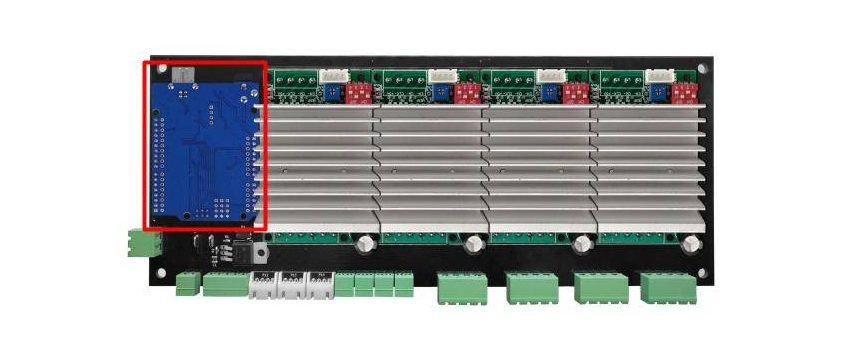

Arduino – A circuit board used for controlling electronics. It is an open source board, meaning people can freely modify and replicate its code and design.
DIP switch – A component on CNC control boards which sets the microstepping of the motor.
Driver – The small electronic boards that control the motors, containing the potentiometers and DIP switches. These boards are connected to the main control board electrically.
Electromagnetic interference (EMI) – Electrical noise or disturbance that can interrupt jobs or cause inconsistent, random behaviour on the CNC, such as stopping mid-way, changes in movement direction, and inaccurate cutting. It can come from the machine itself (router or spindle, motors) or the setup and environment (dust collection, electrical tools, magnets, power bar).
Firmware – The programming installed into electronics to enable basic functions, such as how to handle communications, hold external files, and store settings. Similar to an operating system of a computer.
IOT relay – A device used to automatically control power to AC powered electronics through g-code commands. Useful for controlling a router, vacuum, and lighting.
Microstepping – A way to control the accuracy of motor rotations, through breaking up motor motion into ‘steps,’ then adjusting how many steps complete a full revolution.
Potentiometer – A component on CNC control boards which sets the current going into the motor.
