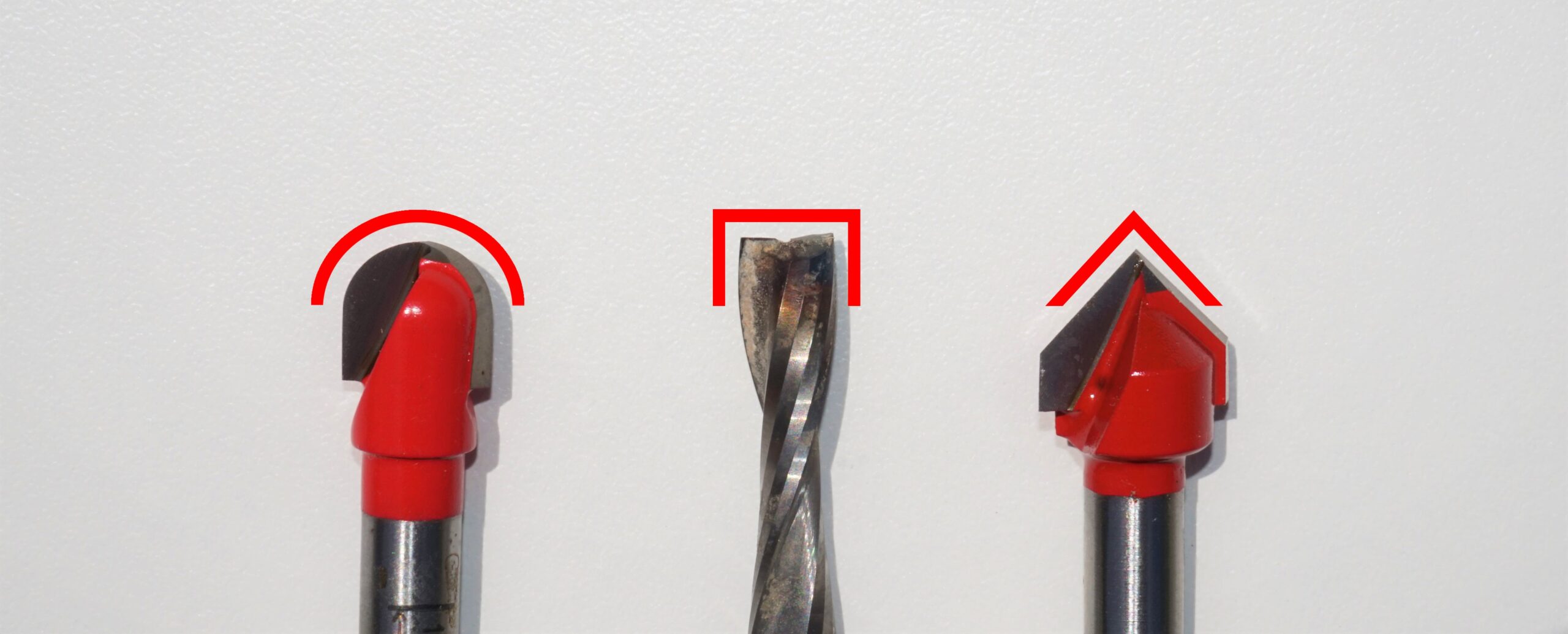

The biggest difference in cutting tools is their tip shape, this determines what application the bit can be used for. The three most common types are the ball nose, flat end, and v-bit (shown below respectively).

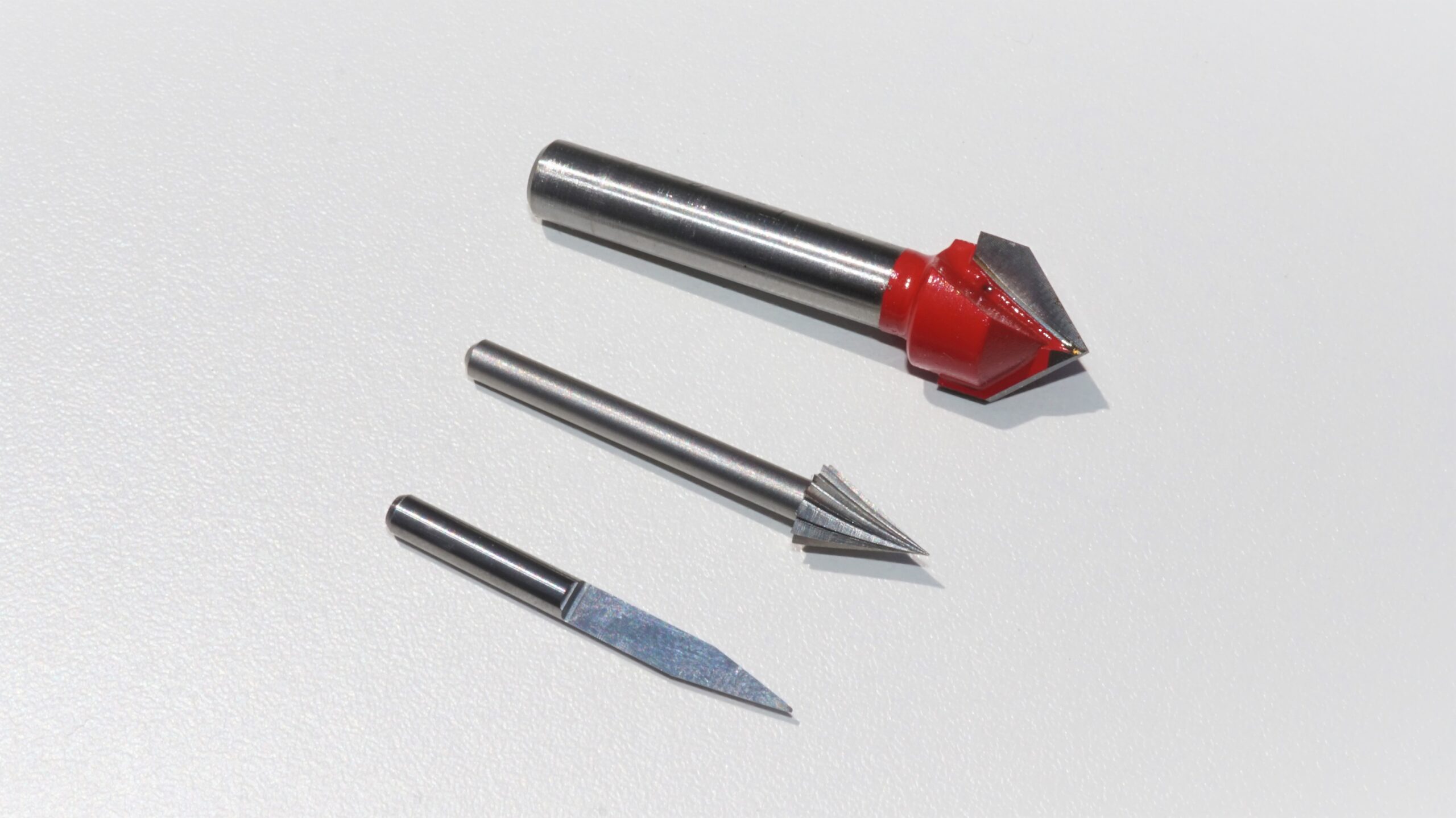

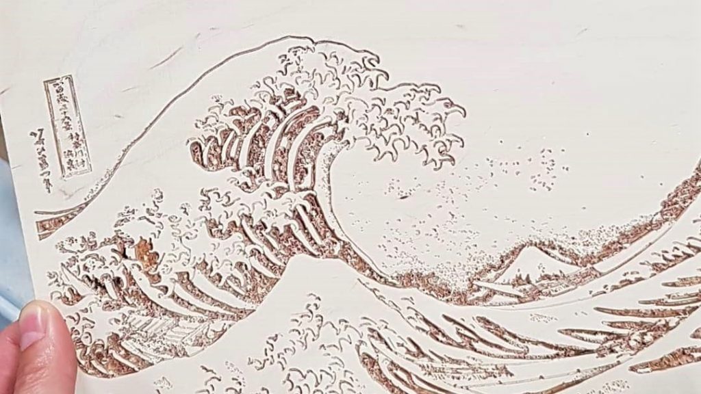

V-bit: v-bits have an angled tip that works great for engraving. They come in varying angles so that if you’re cutting a line with a certain thickness then a 60° bit will cut that line deeper than a 90° bit will; this variation can be used to great effect.
V-bits can be used for simple line-drawing engravings and are also commonly used for “v-carving” which varies the height of the bit as it cuts to change the width of the engraving. This can create detailed images and can also be used for stippling.

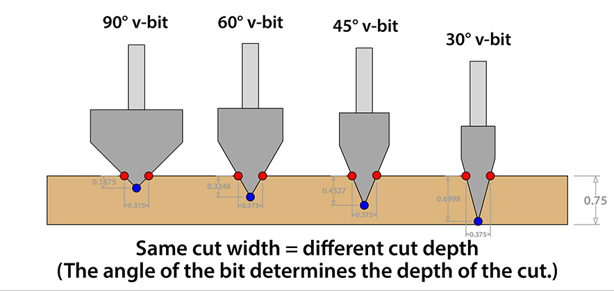

Here are some detailed charts from Learnyourcnc.com, illustrating how you can get finer detail with a smaller angle V-bit. In these examples, the RED dots represent an exaggerated vector line, while the BLUE dots show the cut depth.
This first image shows that using the same depth of cut will produce different cut width, depending on the bit you choose. A smaller bit is better for vector lines that are close together, to offer more detail.

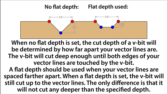

This second image shows that using a V-bit on similarly spaced vectors, will produce different cut depths, based on your V-bit choice. In this case, smaller bits will carve deeper, on similar vectors.
Not only do you set your vector line width and cut depth in your design software, but you can also set a flat depth. A flat depth will prevent the V-bit from cutting any deeper than specified, best used when your vector lines are farther apart than the bit you are using.

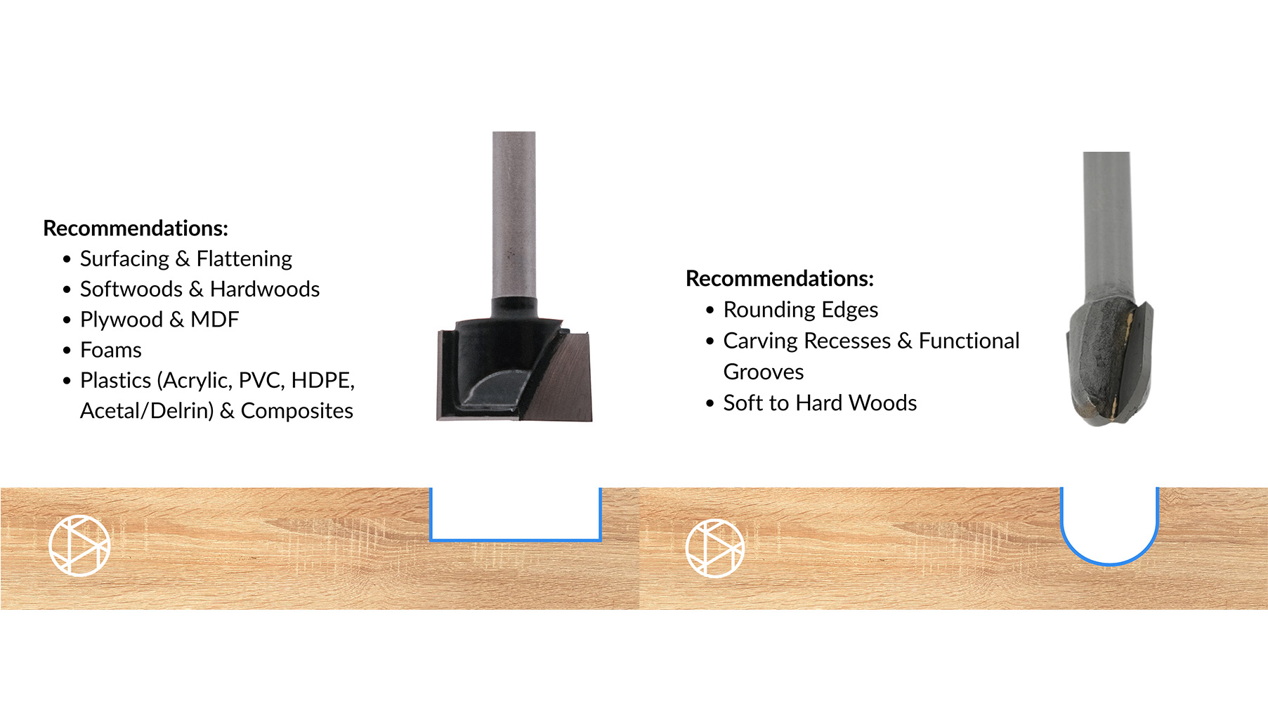

Flat end: this type of end mill simply has a flat or “square” tip profile and normally comes in the form of a spiral bit, but rabbit and dado bits also fall under this category. These cutting tools are the most common of any type due to their versatility for rapid material removal, pocketing, and generally being able to do most CNC projects you may have in mind. At the very least they come in handy if you’re considering levelling a large cut of material or need to cut the outer profile of a sign to separate it from the stock material.

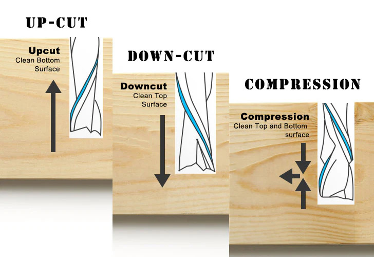

Flat end mills come in several different configurations. Upcut, downcut and compression bits all move chips a bit differently and can affect edge quality.
- An Upcut bit will pull chips upwards, resulting in a clean bottom or pocket, and great chip evacuation. The downside is it can cause tear out at the surface. Great for slots and deep pockets.
- A Downcut bit pushes chips downward, leaving a clean top edge but packing chips in the cut, so it’s best for shallow passes and profiles.
- A **Compression*** bit combines both (downcut at the top, upcut at the bottom), producing clean edges on both the top and bottom surfaces, making it ideal for plywood and laminated sheet goods in hobby CNC work when cutting all the way through. This image from findbuytool does a great job of showing what each bit type does and how it moves the chips.

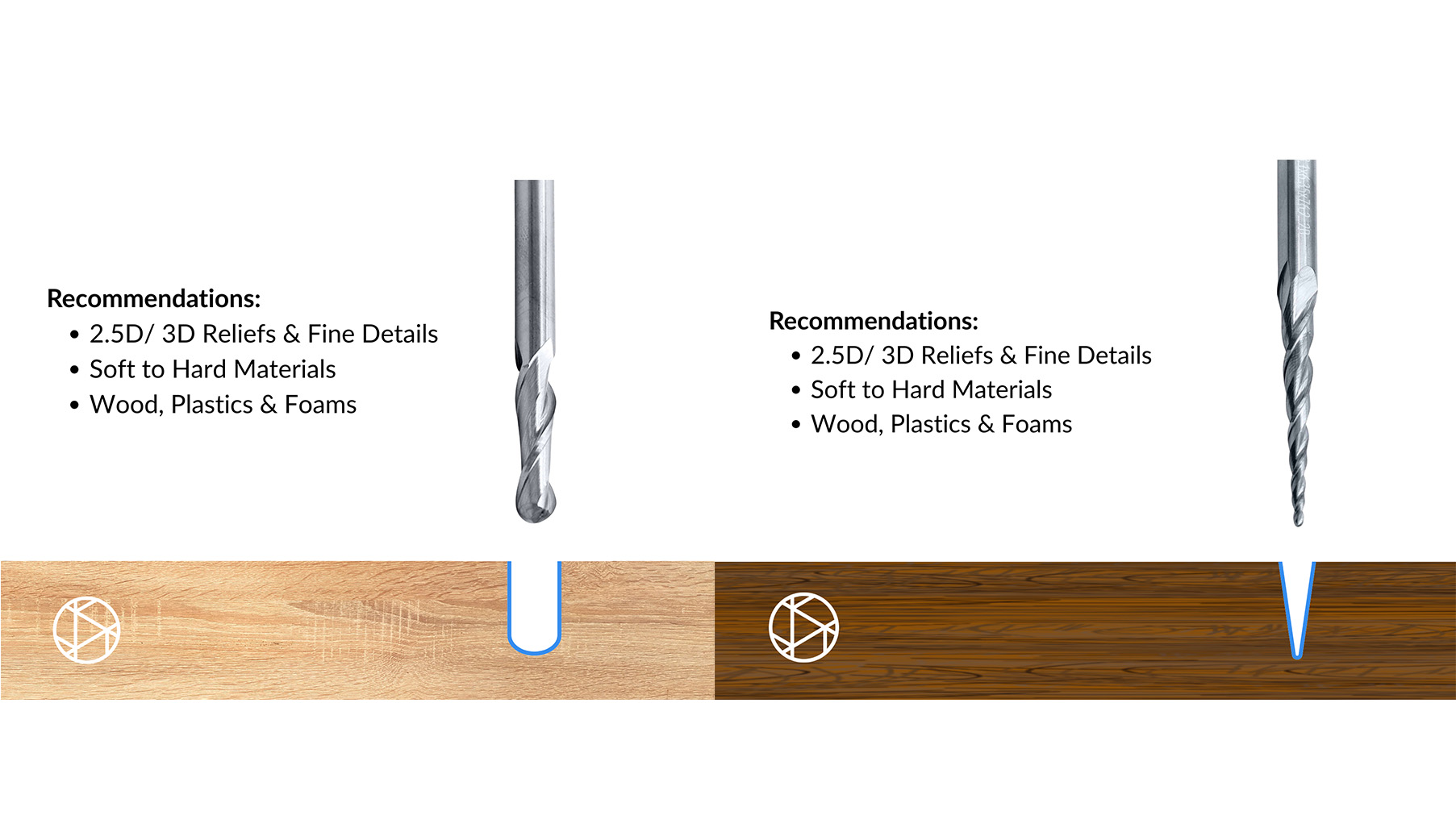

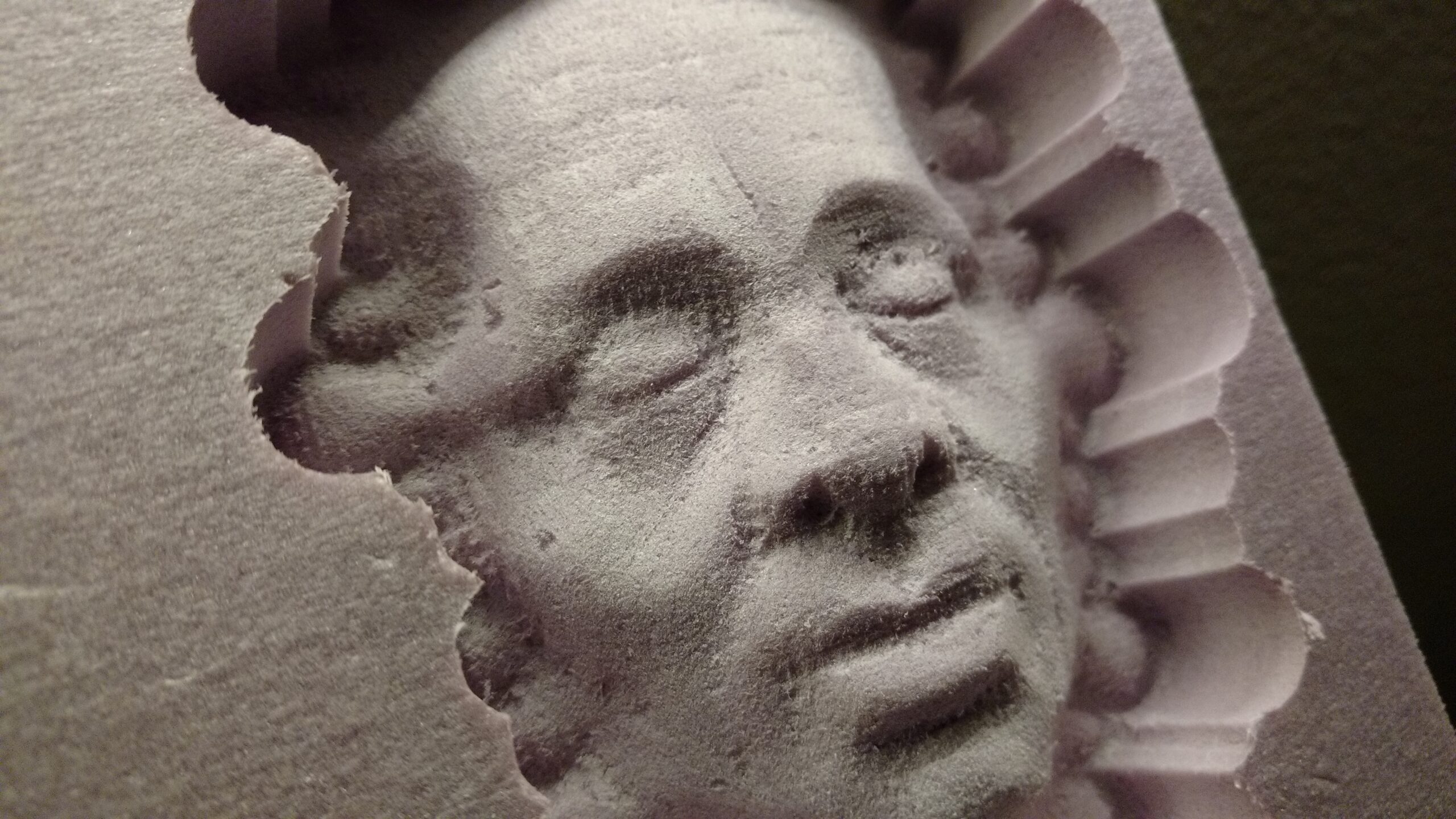

Ball nose: great for 3D / relief carving where your project contains contoured surfaces. By stitching many close passes of its rounded profile together the result can be a perfectly smooth, curved surface right off your machine.
A tapered ball nose bit has the same rounded tip but with tapered (angled) sides, which makes the tool much stiffer. You’d use it for deeper 3D carving, detailed work, and harder materials, where reduced deflection, better accuracy, and cleaner results are important. The trade-off is that the taper limits how close the tool can get to steep vertical walls compared to a straight ball nose. All this being said, one aspect these bits can’t handle is flat surfaces due to the “scalloping” they introduce. This type of carving is certainly more advanced than others but at the end of the day it certainly adds an extra dimension to your projects.

- For softer materials and woods, the spiral direction of the flutes will have a large impact on the surface finish of the material. “Up-spiral” or “up-cut” bits pull the chips out the top of the material which helps with chip evacuation but can cause fuzziness or burring to appear on the top edge as well. “Down-spiral” or “down-cut” bit are the opposite, pushing the chips down into the cut. This seems bad since the chips aren’t able to escape, but in certain situations they are advantageous to use if you want to avoid tear-out or burring on the top of the material.
One area where both up-cut and down-cut bits fall short is that when cutting thicker sheet material at full depth, they will cause tear-out on either the top or the bottom; the solution to avoiding this is a “compression” bit. Compression bits are a combination up-cut and down-cut bit which pulls both sides of the material towards the center. The only challenge is making sure the tool enters the cutting path correctly otherwise the up-cut half could pull up the material while the tool is still moving into position.
