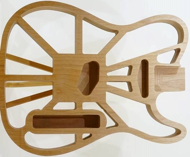

Wood
Wood is simply an amazing material. As it is a living, organic material, there are an infinite variety of woods and characteristics. We will talk a little about using wood with your CNC machine here.
General recommended starting feeds and speeds for 1/8″ and 1/4″ 2-flute end mills.
Start with these settings and adjust as needed—these are guidelines, not hard rules.
General recommended starting feeds and speeds for 1/8″ 2 flute flat end mills. Start with these settings and adjust as needed – these are guidelines, not hard rules:

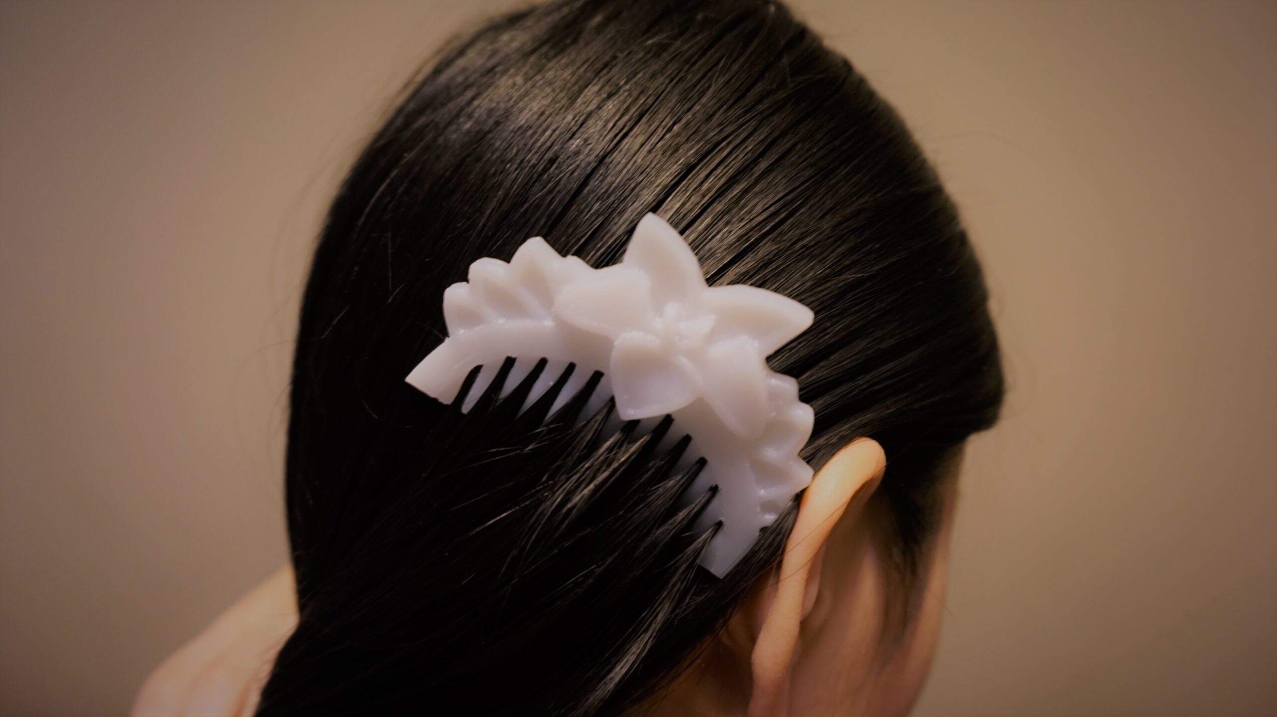

Plastic
Plastic is a material used everywhere in our modern world. Each type of plastic has unique properties that we must take into account when choosing our speeds and feeds.

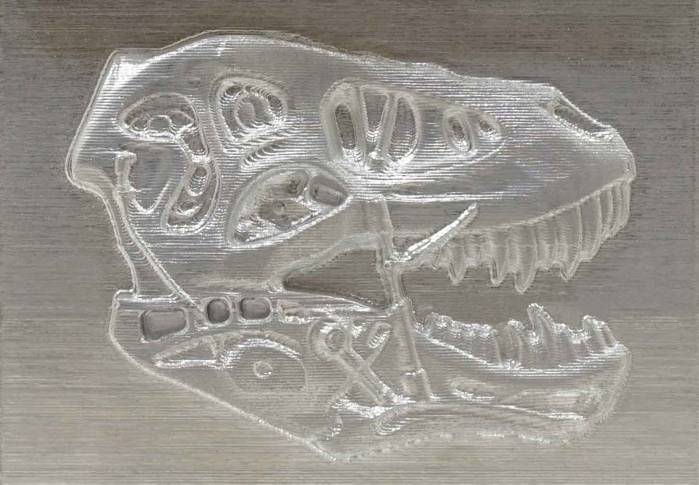

Acrylic / Polycarbonate
- Although acrylic and polycarbonate look almost identical visually, they have different properties. Most common issue with cutting acrylic and polycarbonate is melting as they have very low melting points.
- Reducing spindle speed can reduce heat build-up and prevent the chips from welding themselves onto your part of end mill.
- Acrylic, with the right settings, cuts incredibly easily. Typically, standard wood cutting spiral flute end mills will work fine. However, you may choose to use single flute end mills that are designed for plastics for better cuts.
- Polycarbonate tends to be more flexible plastic, making it more challenging to cut than acrylic. Properly securing your workpiece to prevent your material from flexing while cutting is important.
- It is advisable to use single flute end mills on polycarbonate as well.
ABS / PVC / HDPE
- These plastics are a joy to cut. With a sharp cutter, you these plastics cut like butter.
- Standard 1/8″ and 1/4″ 2 flute end mills work well with these materials, you can also find special plastic cutting end mills as well.
- If you experience melting, increase your feed rate or decrease your spindle speed.
- These plastics can gain a static charge and stick to surfaces.
- Laser cutting/burning PVC releases toxic gases and chemicals.
Delrin / Teflon
- Low friction plastics like Delrin (POM) is also quite easy to machine.

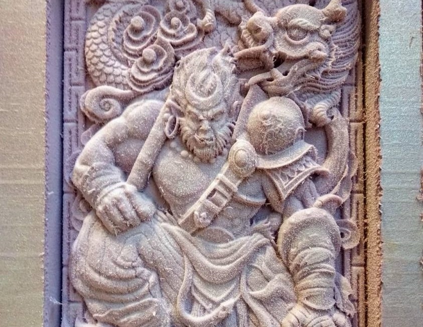

Foam
Foam, being a super soft material, is an easy material to cut. We recommend foam as a starting material to practice CNC programming. Foam also has many useful applications, such as in packaging, RC planes, drones, and more.
Rigid foam is the ideal foam material for CNCing, its closed-cell structure is strong enough to withstand cutting forces while being soft enough to cut through effortlessly. Most of the time, you can cut at full speed and full engagement with no issues, making it a fast way to draft out cuts. Soft foams come in many different densities and softness, which can affect cutting. These settings work with both 1/8″ and 1/4″ 2 flute flat end mills.
| Material | Feed Rate (mm/ min) | Plunge Rate (mm/ min) | Step Over | Step Down (mm) | Spindle Speed (RPM) |
| Foam (rigid closed-cell) | 2500 | 800 | 0.7 | 6 | 10,000 |
Rigid foams (polystyrene foam insulation)
- Because polystyrene is so soft, you can typically cut this material at full engagement. Keep your spindle speed low to prevent melting.
- Since it’s easy to cut, we recommend using it to practice CNC programming or as a drafting material.
- Foam dust is very fine and sticks to surfaces. It is recommended to use a dust shoe.
- Keep an eye on melted foam on your bits. You can clean them off with some acetone.
Soft foams (polyurethane)
- Polyurethane comes in a lot of different hardnesses and densities. Because it is not rigid, it can be pushed out of the way by the end mill rather than be cut. You may need to change your cutting direction, or speeds and feeds to accommodate.
- Consider using a corn-cob end mill, an end mill with little burred teeth rather than a standard fluted end mill. These bits take little tiny cuts out of your material rather than shaving away chips, preventing the foam from being pushed out of the way.
- Foam dust is very fine and sticks to surfaces. It is recommended to use a dust shoe. Keep an eye on melted foam on your bits. You can clean them off with some acetone.
