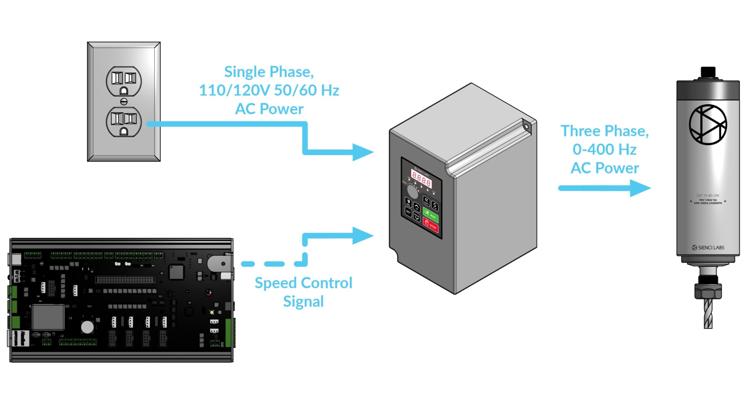

Spindles are the next step up in CNC cutting. A key difference between routers and spindles is that a router houses all of its electronics inside of itself and plugs into a wall outlet directly, but a high speed spindle contains only the motor and rotating elements, while an intermediate VFD (Variable Frequency Drive) unit is used to direct power from the wall outlet to the spindle motor.

  • Can be software-controlled (on/off, speed, direction)

Setup Plug-and-play Requires wiring/VFD
