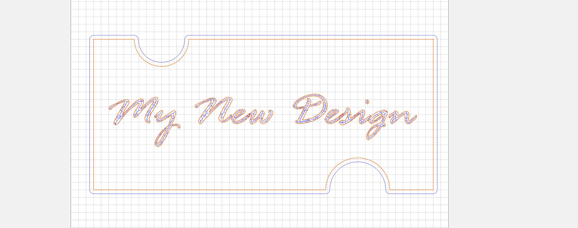

Design Software
A design is needed to create the toolpath. You can use a pre-made design or create one yourself. CAD software like Fusion 360 & SketchUp are useful for creating 3D files with complex shapes. Graphic programs like Adobe Illustrator or Inkscape are perfect to create files for signs and simple 2.5D carvings. Some programs like Vectric’s VCarve Pro & Aspire or Carveco combine CAD and CAM functionalities together.

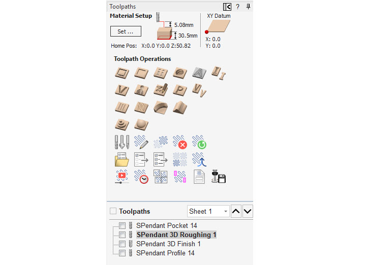

CAM Software
We’ll now switch to the CAM software. Remember those material dimensions you took earlier, you’ll now input them into your new file. Choose the X and Y location of the zero point in the software. The Z location will either be at the top or at the bottom of the material. The starting or zero point is where the machine will reference from. In the example below, you can see the zero starts at the same location in the software and on the material. This zero point will remain the same for the entire job. You will need to adjust your z axis zero if you change bits.
Import your design file into the CAM software. You’ll now choose the CNC toolpath. The shape and type of bit will determine the final look of your piece. In the image below, you can see different types of toolpaths available, and all of the things you can do with them, like save, export, recalculate, preview and more!
Choosing your CNC Tool
CNC bits come in a variety of shapes and sizes. You don’t need a specialty bit to get started. Common router bits are a great way to get your feet wet with machining without spending a lot of money. Common bit shapes are: V-bits; great for signs and lettering. Square End mills; used for carving pockets with flat surfaces. Ball nose and tapered bits; used for relief and detail carvings. Read more about Cutting Tools.
Creating Toolpaths
Select the vector lines you want to machine then select the CNC bit. Change any parameters such as feed and speeds for your machine and material. Information on feeds and speeds can be found HERE. The CAM software will calculate the toolpath. In the example below, the design is in orange, and the toolpaths are blue. Once you are happy with the design, export the g-code.
Exporting the File
With the design finalized, it’s time to export the toolpaths. For beginners, we recommend exporting toolpaths individually. Make sure you’ve selected the correct post-processor for your machine. Some post processors allow you to export all of your toolpaths together (for machines with Automatic Tool Changers), but for beginners, we recommend exporting each toolpath separately for now. Save or export your toolpath to a location on your computer. You can read up on Post Processors HERE.

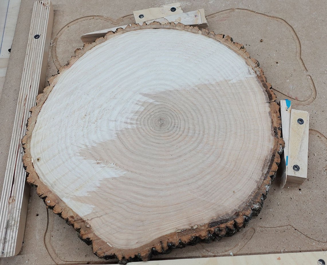

Clamping material to the work surface is necessary for a successful part. Clamping methods are determined by the design and material you are using. Below are common examples of clamping methods. Small items could be held in a vice with some care. Clamps can be made out of metal, plastic, or wood.
Clamping (Top & Side Pressure)
Clamps secure the workpiece to the CNC bed by applying pressure from above, the sides, or both. Top clamping holds material firmly in place and works especially well with upcut bits, though clamp placement must be planned carefully to avoid tool collisions. Side clamping applies pressure from the edges of the workpiece, making it ideal for flattening operations or 3D reliefs where the design reaches the material’s borders. Eccentric clamps or angled blocks are commonly used for effective side pressure.

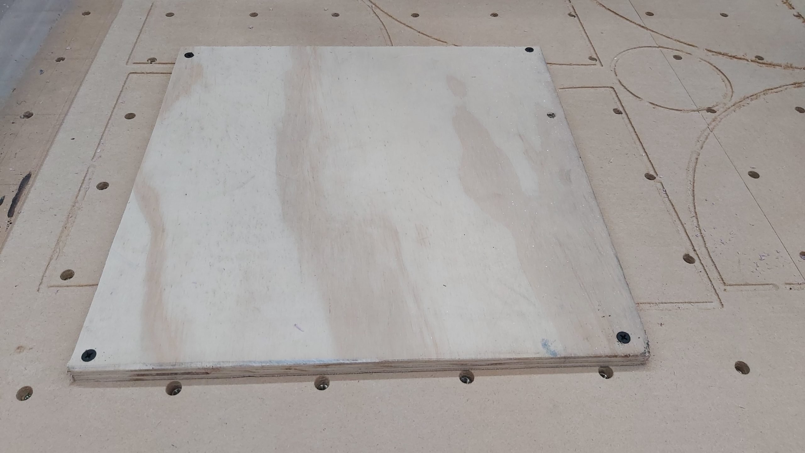

Screws
Screwing through your material and into the work surface is an excellent holding method. Extra care needs to be taken that you don’t run the bit through the metal screws.

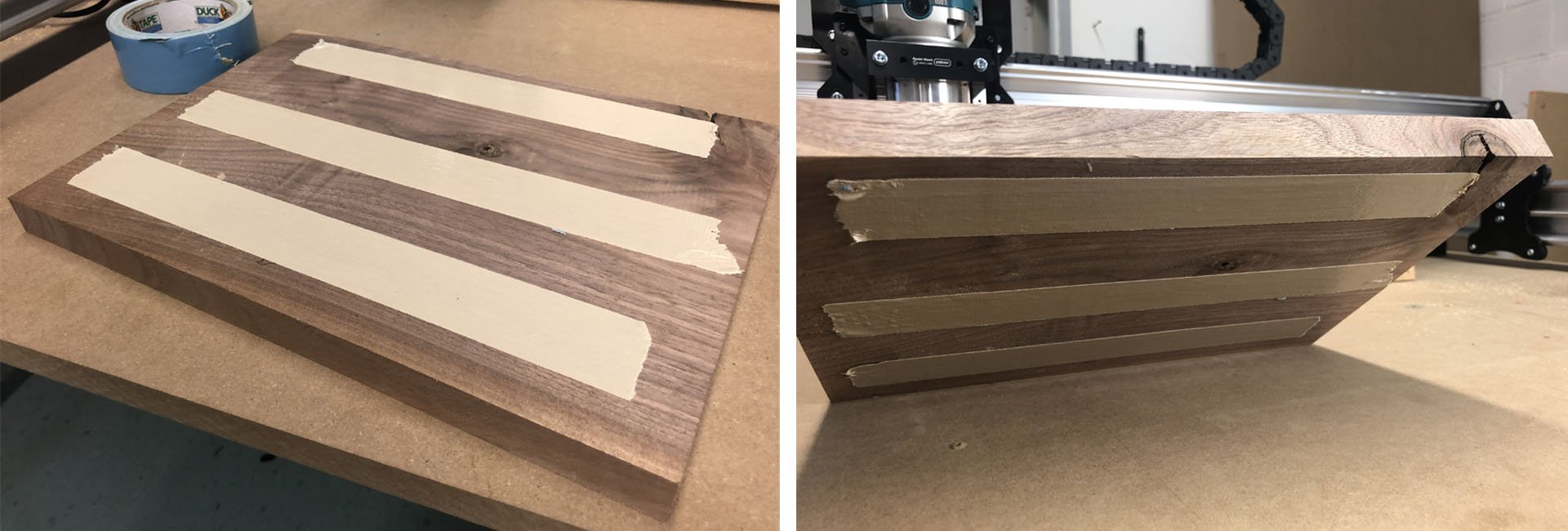

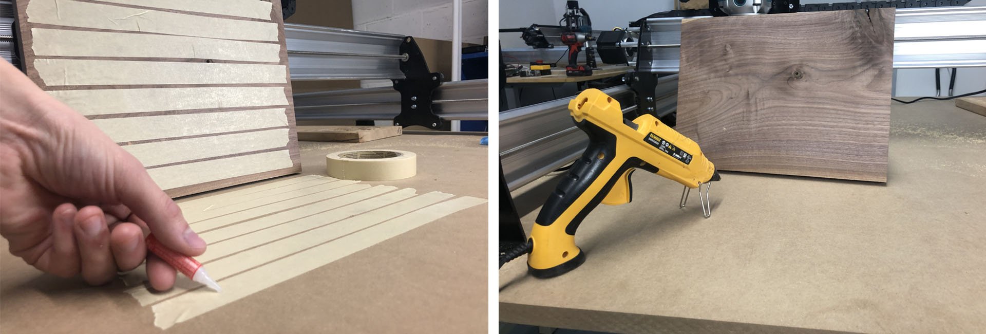

Tape and Glue
Tape is applied to the back of the workpiece and to the top of the work surface. Apply fast-acting glue to the work surface and place the workpiece on top with pressure until set. Once finished, remove the tape. Hot gluing your material to the table is also an effective way to hold the piece down when doing light machining.
Double sided carpet tape is very easy to use. It’s applied to the work surface, then the work piece is pressed to the table.

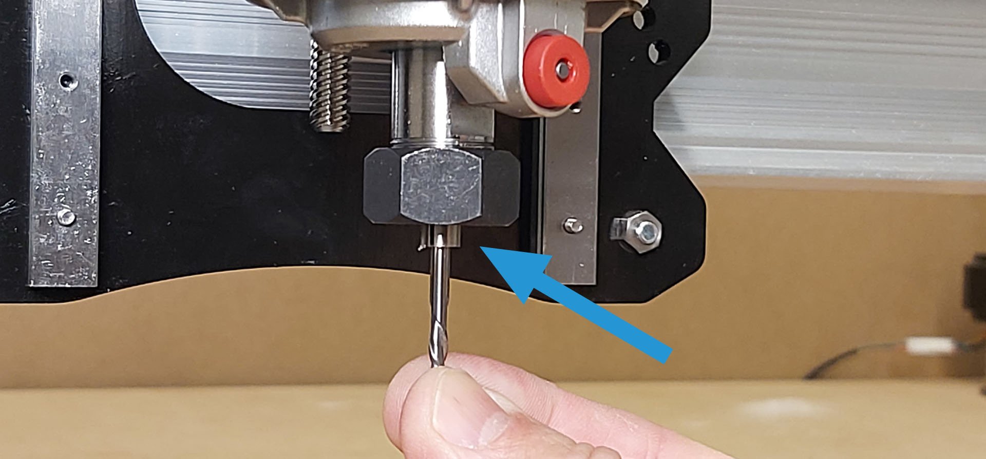

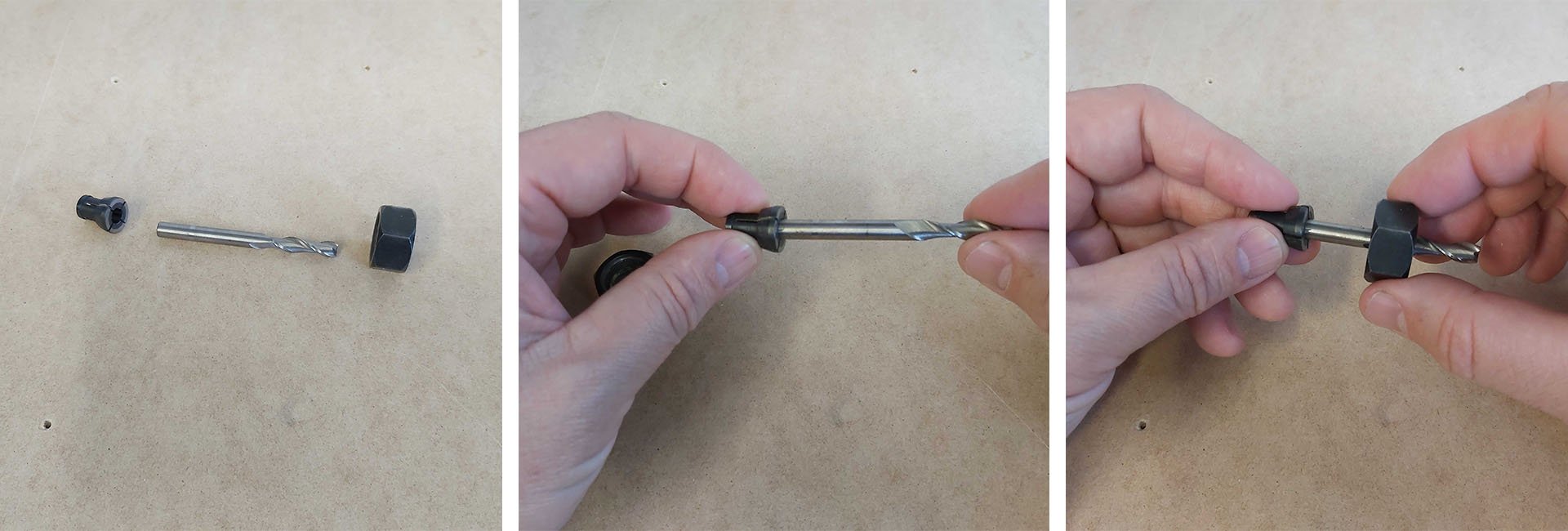

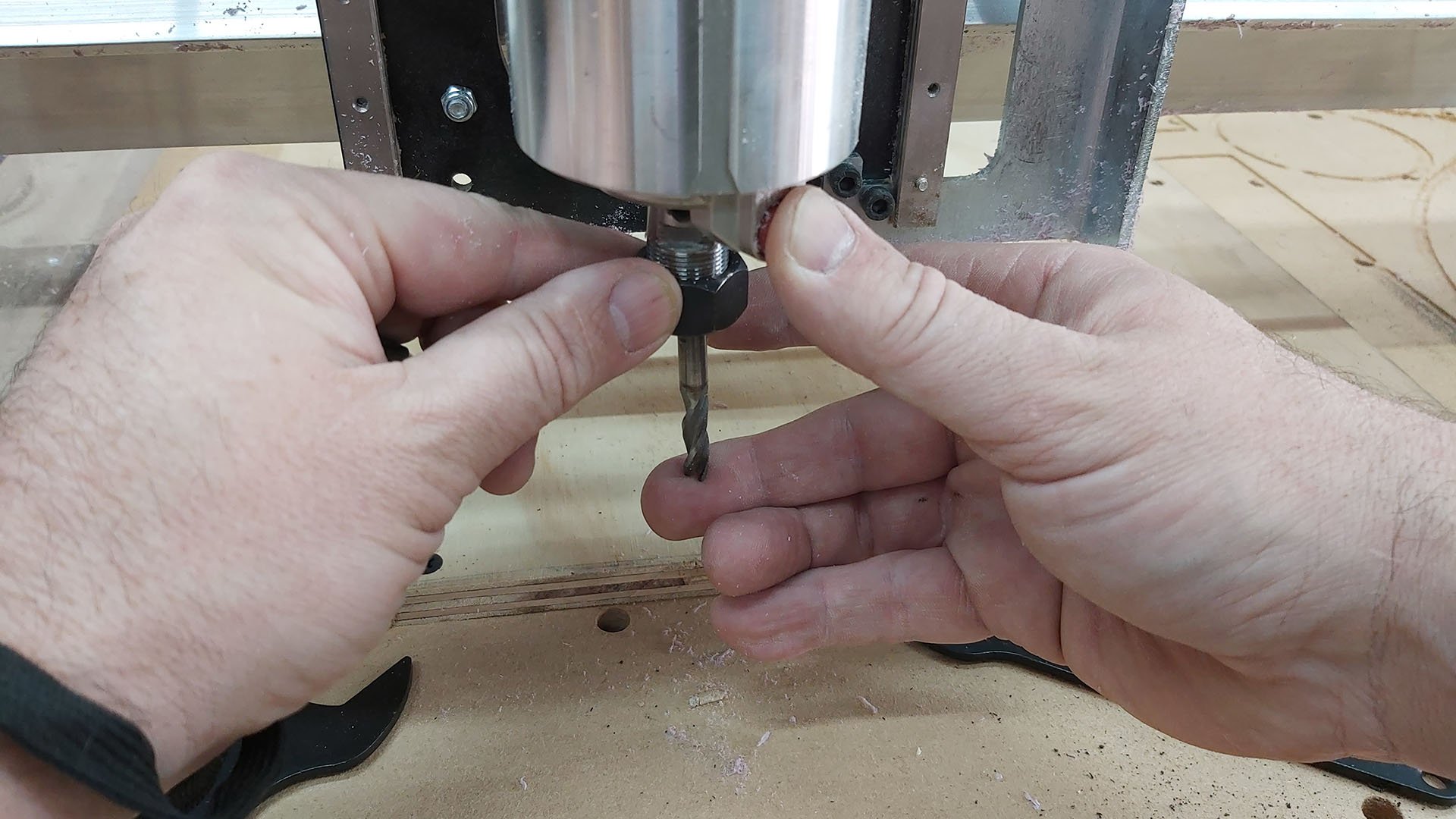

Installing the Cutting Tools

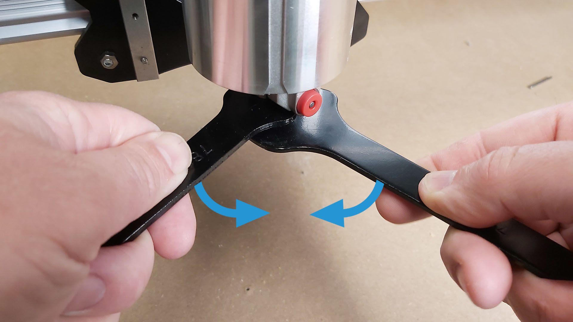

Bring the machine to the front so you have easy access to the router and collect the two wrenches that are included in the Makita box. If this is your first time using a router, look at the bottom where it has a large hex nut and notice just above this the two flats cut into the router shaft. You’ll be using the two wrenches here, one on the nut and one on the flats of the shaft, so the router can ‘clamp’ onto bits before cutting and then release them when you’re finished.

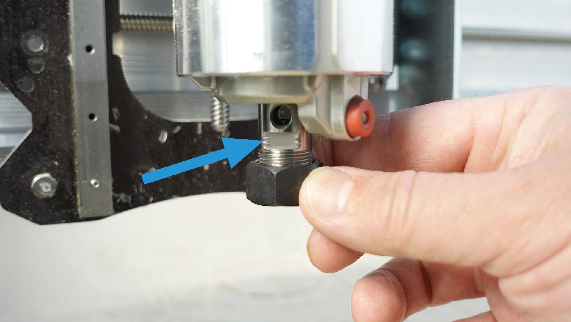

To loosen the collet nut, place the small wrench onto the router shaft on the left side. Place the large wrench on the collet nut on the right side. Squeeze the wrenches together till the collet nut is loosened.

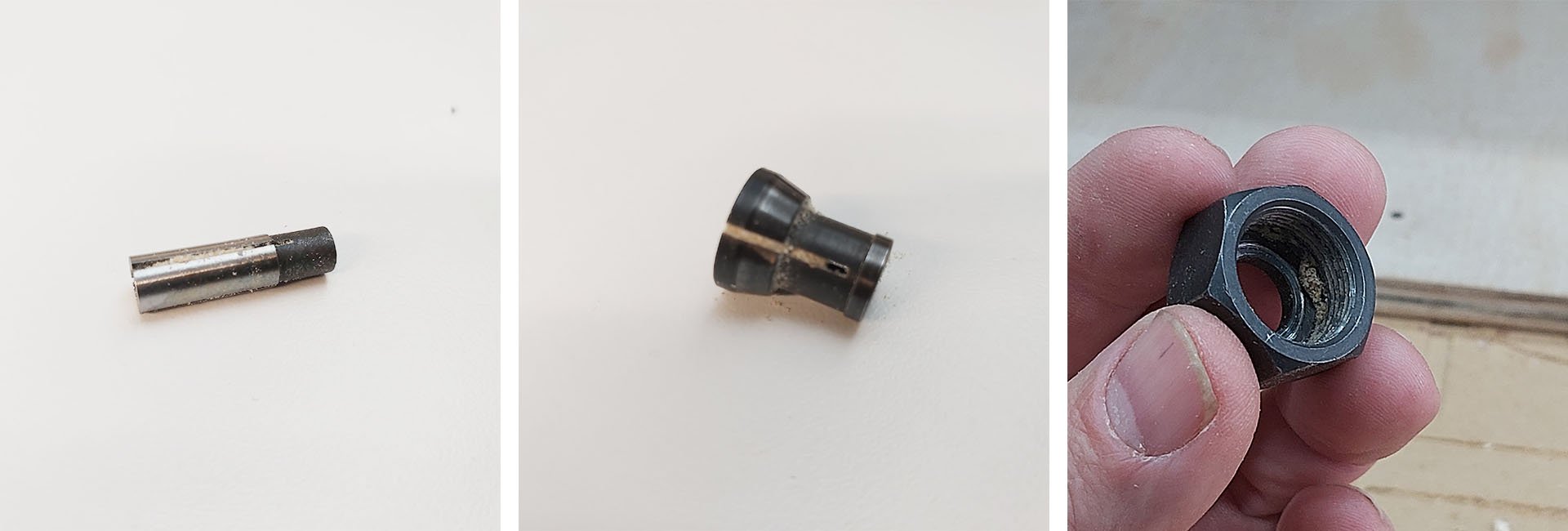

Always make sure the collet, the adapter, and the nut are free from debris before running. Dust buildup will prevent the collet from being tightened correctly and can ruin a workpiece. Dust can build in the inside corners of the nut and will prevent proper tension. Clean with a small tool or compressed air.
1/4” diameter straight bits can be installed into the collet first then inserted through the nut before installing into the router.

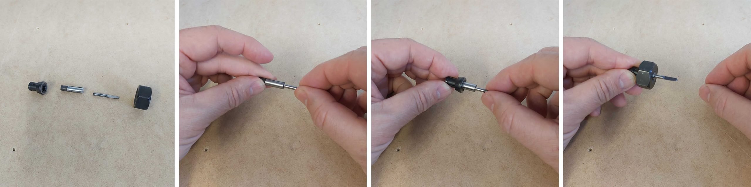

When using ⅛” bits, an adapter or ⅛” collet is necessary. Slide the ⅛” collet adapter into the standard collet, insert your bit, then place it into the collet nut and fasten to the router. The collet adapter should just peak through the bottom of the collet.
Some bits like v-bits or surfacing bits require the bit shaft to be placed through the nut first, then into the collet.

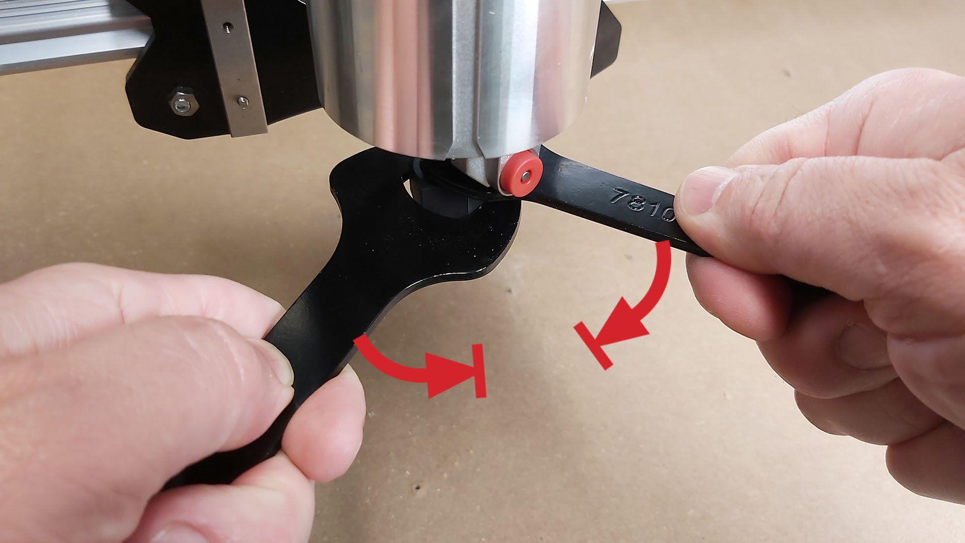

When installing the bits into the router, always tighten using the wrenches. The router can get damaged if you hold the button as you firmly tighten with a wrench. The button should only be used when you are hand tightening the collet, to hold the bit in place. Then finish securing your bit using the two wrenches. IDC Woodcraft has a great video outlining these sorts of things to watch out for.
To tighten the collet nut, place the small wrench on the right side of the router shaft. Place the large wrench on the collet nut on the left side. Squeeze together until the nut is tight, do not over tighten.

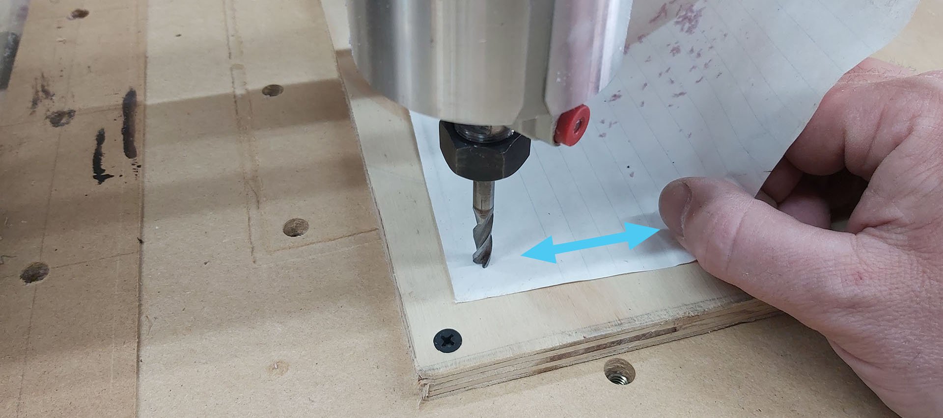

Manual Zeroing
Manually jog your machine to the starting location. Zero the X and Y locations. Below are two examples of typical start locations; bottom left corner or centre of the material.
Lower the bit to the material by jogging the Z-axis down. When you are just above the surface, change to precise jogging. Place a piece of paper under the bit. Move the paper back and forth and at the same time, lower the bit. When there is resistance sliding the paper, the bit is at the correct position. Zero the Z location in the software. Raise the bit, go to your X and Y starting positions and you’re ready to begin.

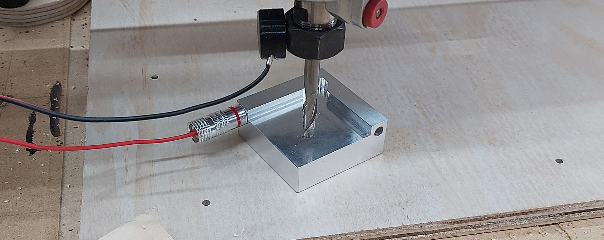

Automatic Zeroing
Automatic zeroing or “probing” works by touching a conductive plate with the bit on the machine, to set the corner of your workpiece as the zero. To find the XYZ axes, place the touch plate on a corner of the material and perform the XYZ probe operation. The router will automatically move through all three axes. It will touch on the top and two sides to accurately find the corner. Detailed information can be found HERE
When you only want to do a z-height probe, useful for multi-bit tool changes, flip the touch plate upside down. Use the Z probe function This will find the top surface of the material.

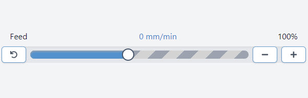

Feeds and Speeds Override
Sometimes when you start the job, you’ll need to make adjustments to the machine for proper chip load.
Feed Rate Using gSender
When a job has been started, gSender will show a feed adjustment control panel beside the machining time. Clicking on the plus or minus button will adjust the feed rate faster and slower, or simply use the slider itself.
It’s important to remember, however, that while you may want to modify the cutting feed rate for some cutting operations, the machine will continue using this feed rate override for subsequent cutting operations. For example, if you’ve overridden the feed rate by 200% while cutting the outline of your project at very shallow depths, you’ll want to reset the feed rate to its original speed before it next moves on to cutting out a pocket at a much deeper depth.
