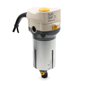

Sienci AutoSpin T1
Sienci Labs Store
The AutoSpin T1 is an enhanced trim router designed by Sienci Labs, capable of automated speed control like a spindle but also allowing for manual speed control with a dial. It uses a 1-1/4HP motor and can run between 10,000 RPM to 30,000 RPM. It is tuned for stable cutting speeds, suited for multi-hour projects on your CNC machine. We highly recommend starting off with manual mode to get the hang of the CNC workflow, then jump into spindle mode where you can automate your starts, stops and speed changes through g-code commands. The AutoSpin is currently only available for 110V/120V with a North American plug.

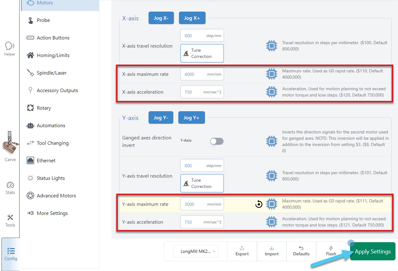

Some settings you might need to change are shown below. If you’re moving a specific axis of the machine and it’s ‘stalling out’/ not moving then you definitely need to update these values. You’d want to focus first on the ‘maximum rates’ (110 to 112), reducing the value for the stalling axis by increments of 100 until the problem goes away. If  this doesn’t work you can also try lowering the ‘acceleration’ values (120 to 122). Don’t forget to hit the Apply Settings button once any changes are made to these values.
