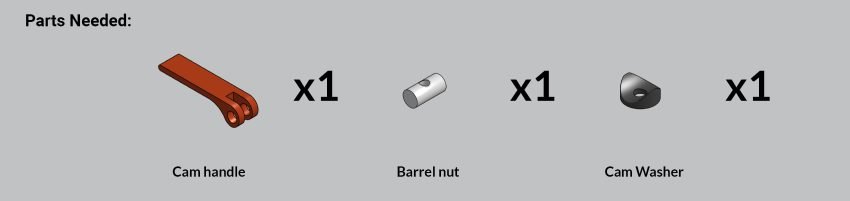

Insert the barrel nut into the cam handle, then place the cam washer underneath the cam lever.
Position the cam handle sub-assembly from the last step into the large rectangular gap in the tailstock body. Make sure the end of this lever faces opposite the large hole.

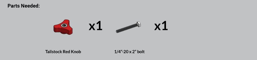

Thread the tailstock live center on to the loose 2” bolt until it is flush with the front cover.
Pass the 2” bolt through the side of the front cover then thread the knob on and tighten gently. You can keep the bolt in place by pressing it with your finger
