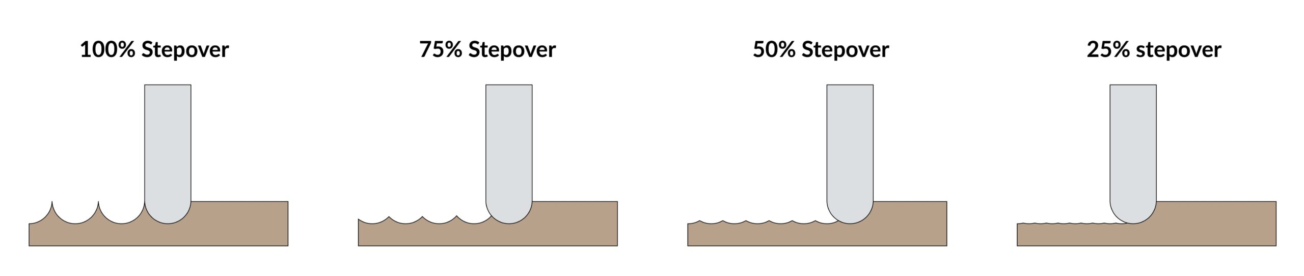

  • Step over: How far the tool shifts sideways between passes, often a percentage of bit diameter.

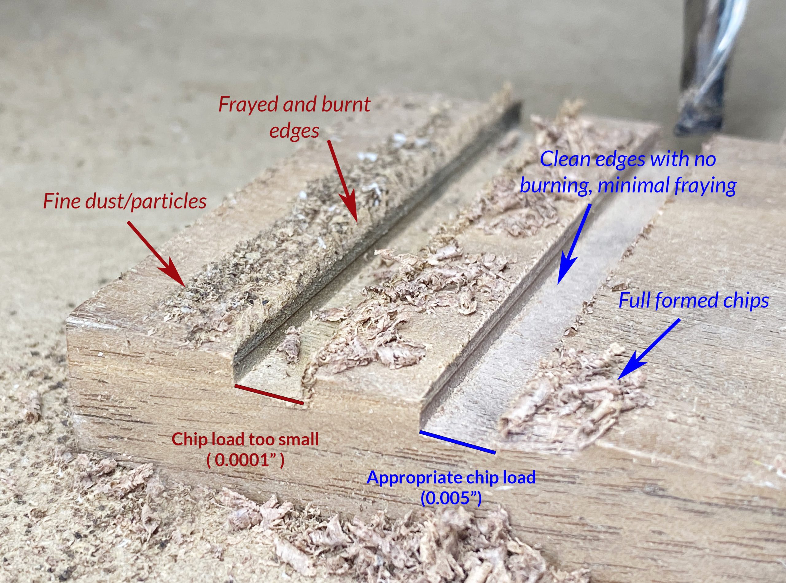

Setting too low Result
Feed rate too slow Bit rubs and overheats
Feed rate too high Bit breaks
Spindle too fast Burns/melts material
Spindle too slow Rough finish, chatter
Rule of thumb:
Higher RPM = smaller chips.
Higher feed rate = larger chips.
Aim for consistent, clean chip formation — not dust, not chunks.

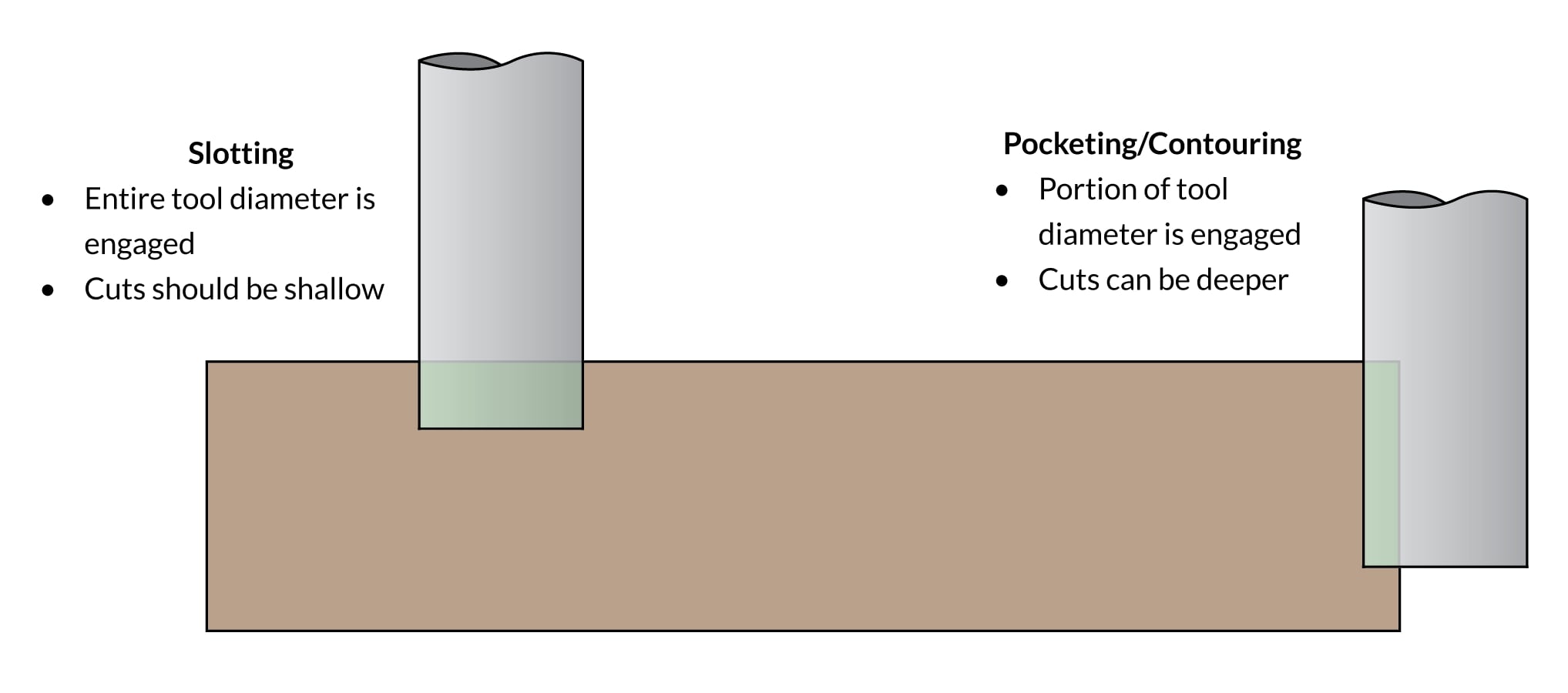

  3. Lastly, you’ll notice that for every tool in the tables the recommended stepdown (a.k.a. depth of cut) is larger for pocketing/contouring and smaller for slotting. This is because:
    • Slotting (cutting out shapes, profiles, engraving) cuts with the full tool diameter, putting more stress on the tool and machine, thereby requiring shallower cuts
    • Pocketing/contouring (surfacing, cleaning walls, clearing a specified area, 3D carving) cuts with usually less than 50% of the tool allowing deeper cuts

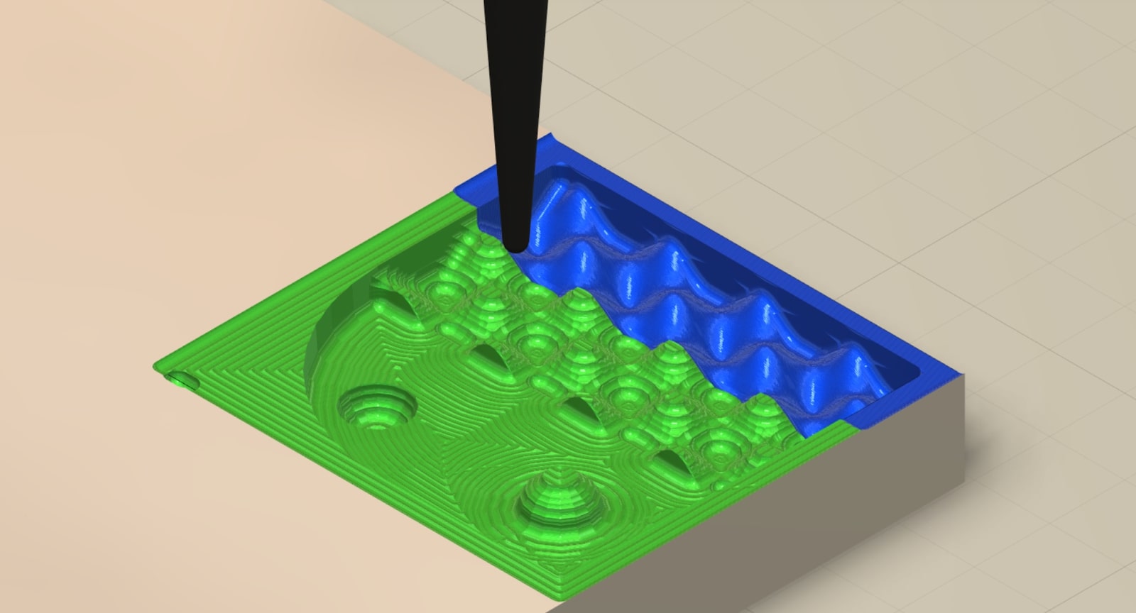

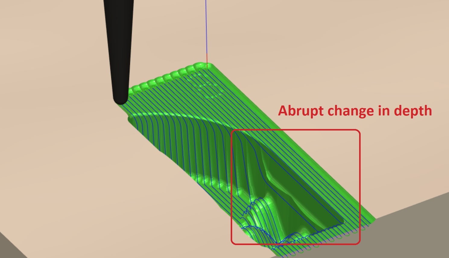

Tips and tricks for engraving or 3D carving these materials are:
  • Soft woods are very easy to cut, we encourage you to engrave as fast as you’re comfortable with to save time
  • You may consider skipping the roughing pass to save time if the deepest part of your engraving is less half the flute length of your tool
  • Many woods can be warped which causes engraving and V-carving details such as text to have inconsistent cutting depth. Surfacing the material before starting your job will help this by giving you a flatter surface to work with

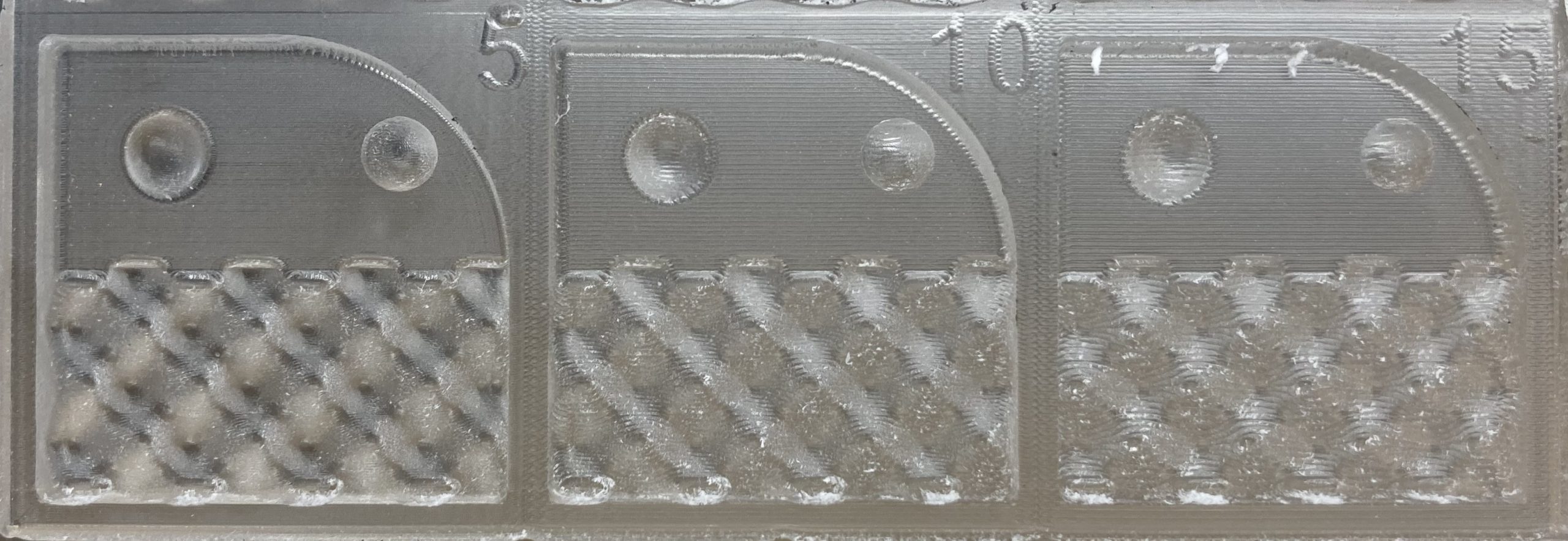

For cutting acrylic we highly recommend you use cast acrylic (usually has paper backing) instead of extruded acrylic (plastic backing). Cast acrylic will always have a better surface finish compared to extruded acrylic which is significantly more difficult to cut due to its lower melting temperature.
Machining on extruded (left) vs cast (right) acrylic using the same g-code

Chip load describes the size of each individual chip that is being cut by a single edge of your cutting bit.
This is a very sensitive parameter. If too small, the chips reduce in size to become dust which will wear out the bit and heat up causing burning. If too large, the chips become larger which results in the cutting bit being overloaded and unable to clear the chip out of the cut. The effects of chip load on cut quality can be seen below.
Two cuts with different chip load produce very different results

For slotting the cutting width will be fully engaged, meaning our cutting width or width of cut (WOC) will be equal to the tool diameter (ie. WOC = 0.25” if using a ¼” bit).
For pocketing our tool will only move over by some distance between passes, typically this distance should be about ~45% of the width of the cutting bit (ie. WOC = 0.25” x 45%=0.1125” if using a ¼” bit).
The illustrations below show the use of a tool in a high depth of cut, low width of cut scenario (left), as well as low depth of cut, high width of cut scenario (right). With the feed rate constant between these two cuts, they’ll both be removing the exact same amount of material in the same amount of time.
Since we know our desired feed rate (from our chip load calculation) and cutting width (depending on the cutting operation), we can calculate what our cutting depth should be if we’d like to keep our material removal rate below some reasonable amount. At this point, we’ve now gotten all of our cutting parameters necessary for setting up a cutting operation.

The first constraint to pay attention to is cutting width/stepover. This is a variable that we can typically change to control the rate of material removal but in 3D carving it’s directly tied to surface finish and is typically a small number (~5-15% depending on the size of the bit).
Acrylic carving with 5, 10, and 15% stepover (left to right)
When a ball end mill carves in several straight, parallel passes it leaves behind small amounts of material in the form of ridges – these are known as ‘cusps’. These cusps are the reason for the increase in detail/resolution with a lower stepover; as shown in the photo below, a larger stepover means larger cusps, while a smaller stepover means the cusps continue getting smaller until they’re imperceptible to the human eye. Obviously, with lower stepover, this means a greater number of passes, and a much longer total project time. You’ll need to decide how much detail you need, and how long you’re willing to run the project for. For example, for carving a 2″x2″ relief, you’ll probably want to use a low stepover amount such as 5-8% since this project won’t take more than an hour. If you we’re carving something much larger, you might want to set your stepover much larger and forego finer detail for a faster overall project time.

Cutting depth is the next variable to consider and in relief carving this is again something that you do not have much control over. This is because the tool will need to follow the contours of your 3D model which can vary considerably in depth.
Abrupt changes in depth / carving deep reliefs will increase tool load
The implications of the two constraints above are that tools will tend to be underutilized (removing too little material) on the shallow parts of the relief and struggle on the deeper / steeper parts (removing too much material). For wood based materials, you’re less likely to exceed the tool’s material removal capabilities on even the deepest parts of your relief without running into other constraints in your machine such as feed rate. On harder materials such as acrylic / aluminum however the spikes in material removal is a much bigger concern and is why roughing (with a very shallow depth of cut and minimal stock to leave) is a prerequisite for success.
Keeping tool load in check with separate roughing and finishing passes
