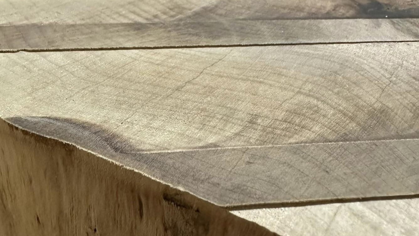

Sanding
Improve the appearance of your projects by removing fuzz off edges or smoothing rough surfaces left by the CNC. Sanding is also a necessary step to prepare for painting, colouring, or sealing wood.
| Goal | |
| 🖐️ General Cleanup Small fuzzies and sharp edges usually only need simple hand sanding to get the project looking right. |

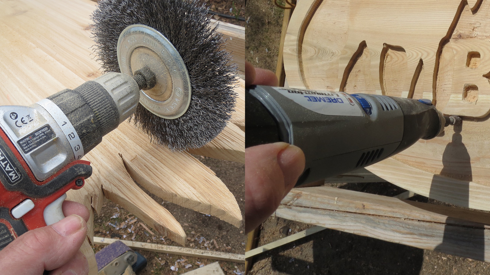

| ⛰️ 3D or V Carves Clean up fuzz in hard-to-reach spaces using a sanding mop on a drill or Dremel. |
| 💪 Tool Marks If you see deep ridges or scars left over from cutting, start off using power tools to save time sanding. |
| 🛠️ Other Methods Consider “raising the grain” to give wood faces a smoother, more professional finish. |

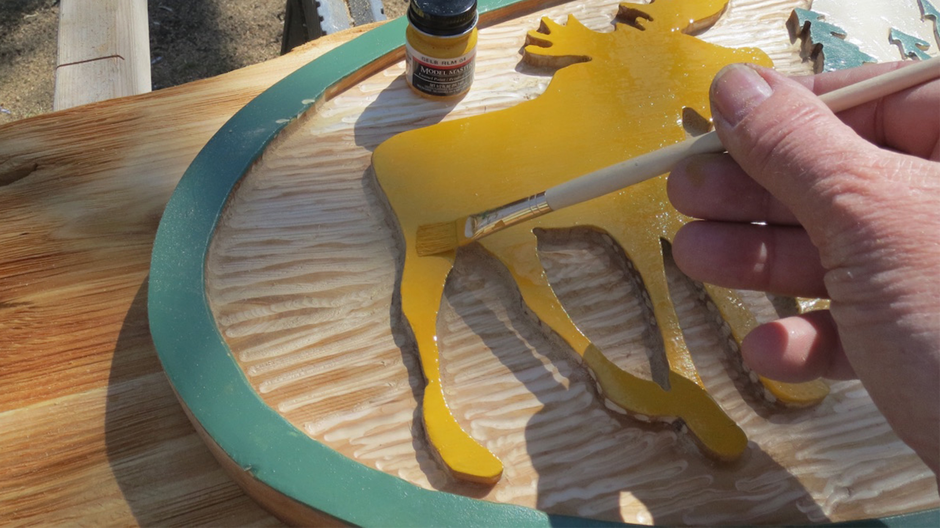

Colouring
Painting and staining not only protect your wood, but they allow you to get more creative with your projects by enhancing their appearance or colouring and highlighting the wood grain.
| Goal | |
| 🎨 Get Painting Even one simple colour can really make projects pop! |

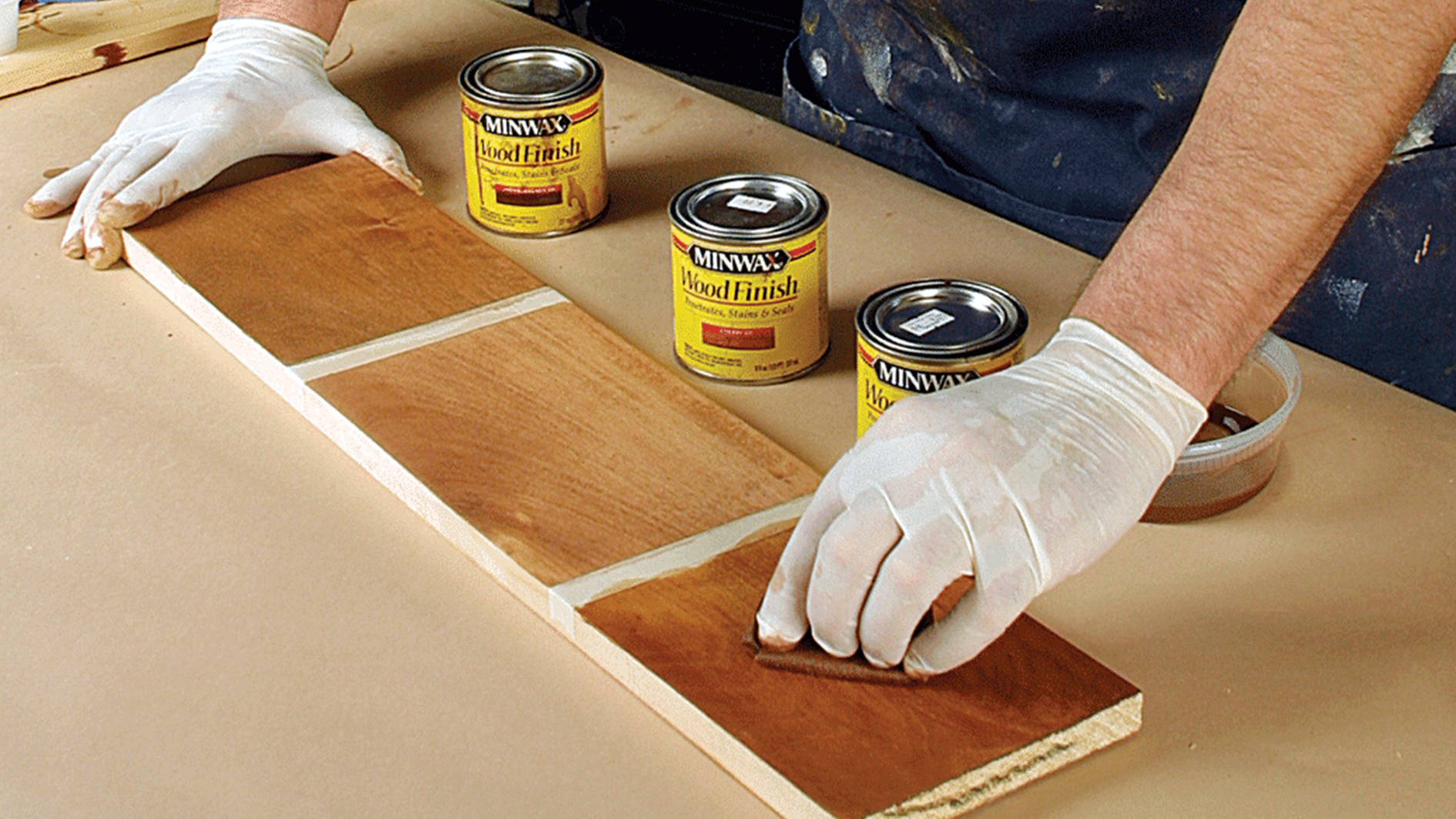

| 🖌️ Staining Enhance the grain and color of your wood while still providing protection and durability. |
You can also see Tips and Videos on Painting and Staining to get more comfortable with them.
Learn Sanding
Sanding is essential for smoothing rough surfaces left by the CNC process, removing imperfections, and preparing wood for finishing. When it comes to cleaning your projects, you can use different hand tools or power tools depending on the task, but no matter the approach you’ll want to start with the correct grit.
The “grit” rating on sandpaper describes if it uses larger, sharper particles or smaller, smoother ones and can range from “extra-coarse” to “ultra-fine” (30 to 1000+). The reason for these ratings is that sharper “coarse” sandpaper can make deeper scratches which helps to remove material faster to clean up large cuts or gashes, whereas using smoother “finer” sandpaper makes sense to use once you want the surface to start to look smoother and less ‘scratched’. This creates a process where you should:
- Look at your material and decide how much touching-up it needs.
- If it needs a lot, start with coarse sandpaper, if it needs a little use only fine sandpaper, and if you don’t know then choose a medium-grit sandpaper.
- If you started with coarse or medium grit, then consider sanding the whole material again but with a finer grit to continue to clean it up. For best results don’t skip grits, so if you were on coarse go to medium, and on medium go to fine.
| Sanding Level | Grit Range | Purpose |
| Rough / Coarse | 60-100 | Removes imperfections the fastest, like large burrs and rough edges, and great for further shaping the material. |
| Medium | 120-150 | Good for smoothing small bumps and dents and a good stopping point if you’re only aiming for a general-purpose sanding. |
| Fine | 220-320 | For detailed touch-ups, and also necessary if preparing for decorative coating staining, smoothing, or polishing. |

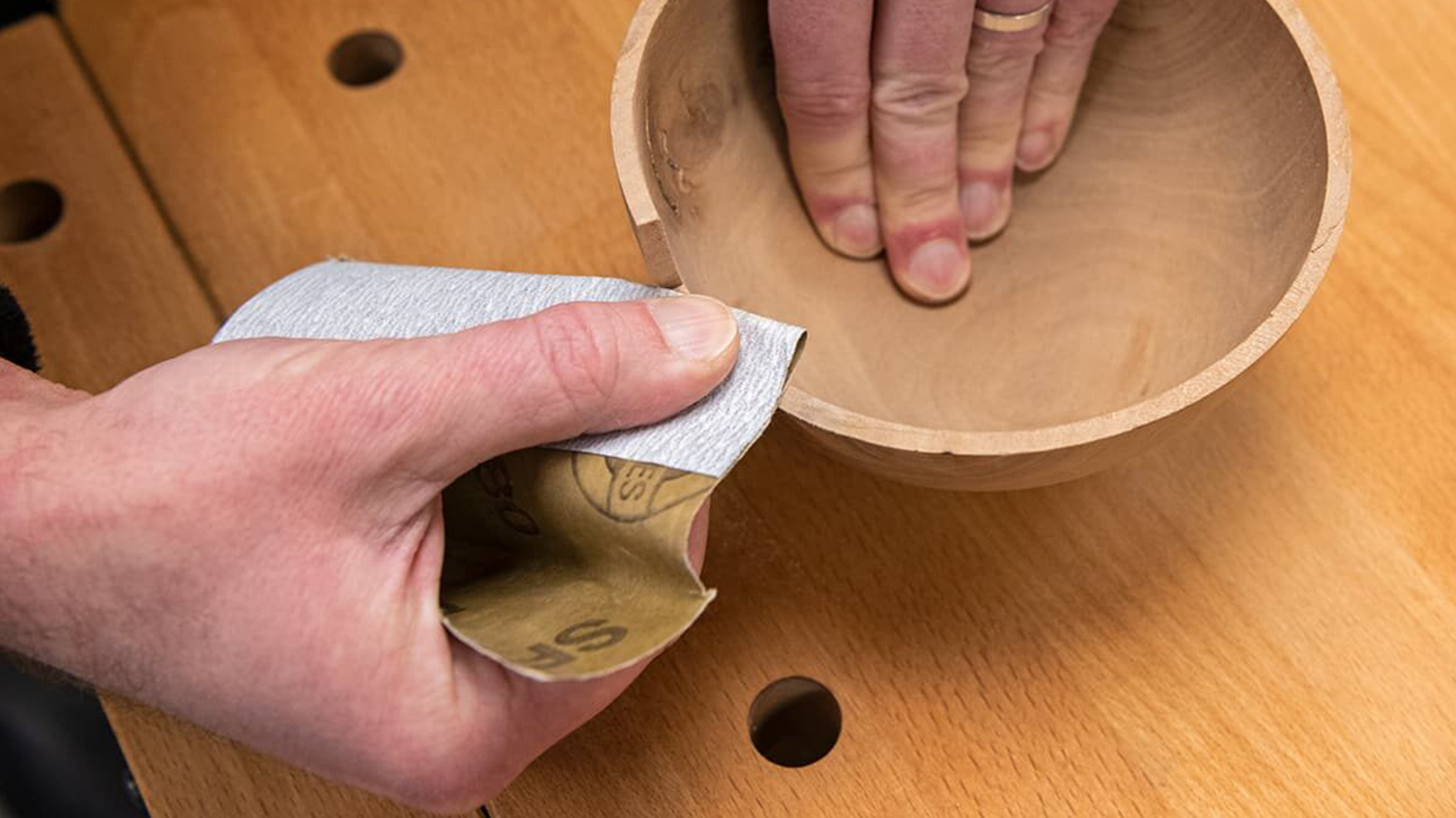

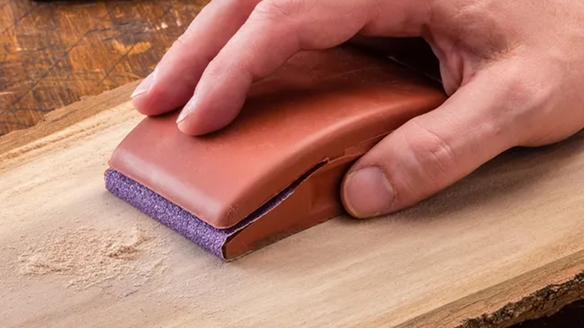

Hand Sanding
Hand sanding tools are ideal for precision work, tight spaces, or when you want more control over the sanding process.
Sandpaper: coated abrasive paper available in different grits. Comes in many shapes and sizes from sheets to discs to loops. You can fold it or cut it into smaller pieces to use by hand. Check out the grit guide for more.
- Usage: use lower grit for aggressive sanding and higher grits for finishing
- Types: aluminum oxide (general use), silicon carbide (wet/dry), garnet (fine finishing)

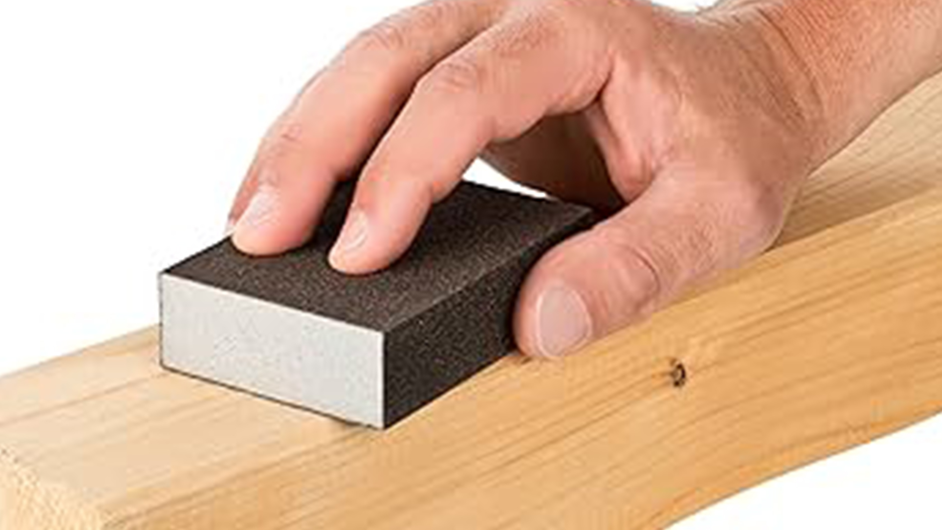

Sanding Block: a block used to hold sandpaper flat for even sanding. Cut a strip of sandpaper and attach to the sanding block. Fast & comfortable to use.
- Usage: prevents uneven sanding and helps apply uniform pressure
Sanding Sponge: flexible sponge coated with abrasive material. No sandpaper needed as it’s already on the sponge!
- Usage: ideal for contours, curves, and irregular surfaces

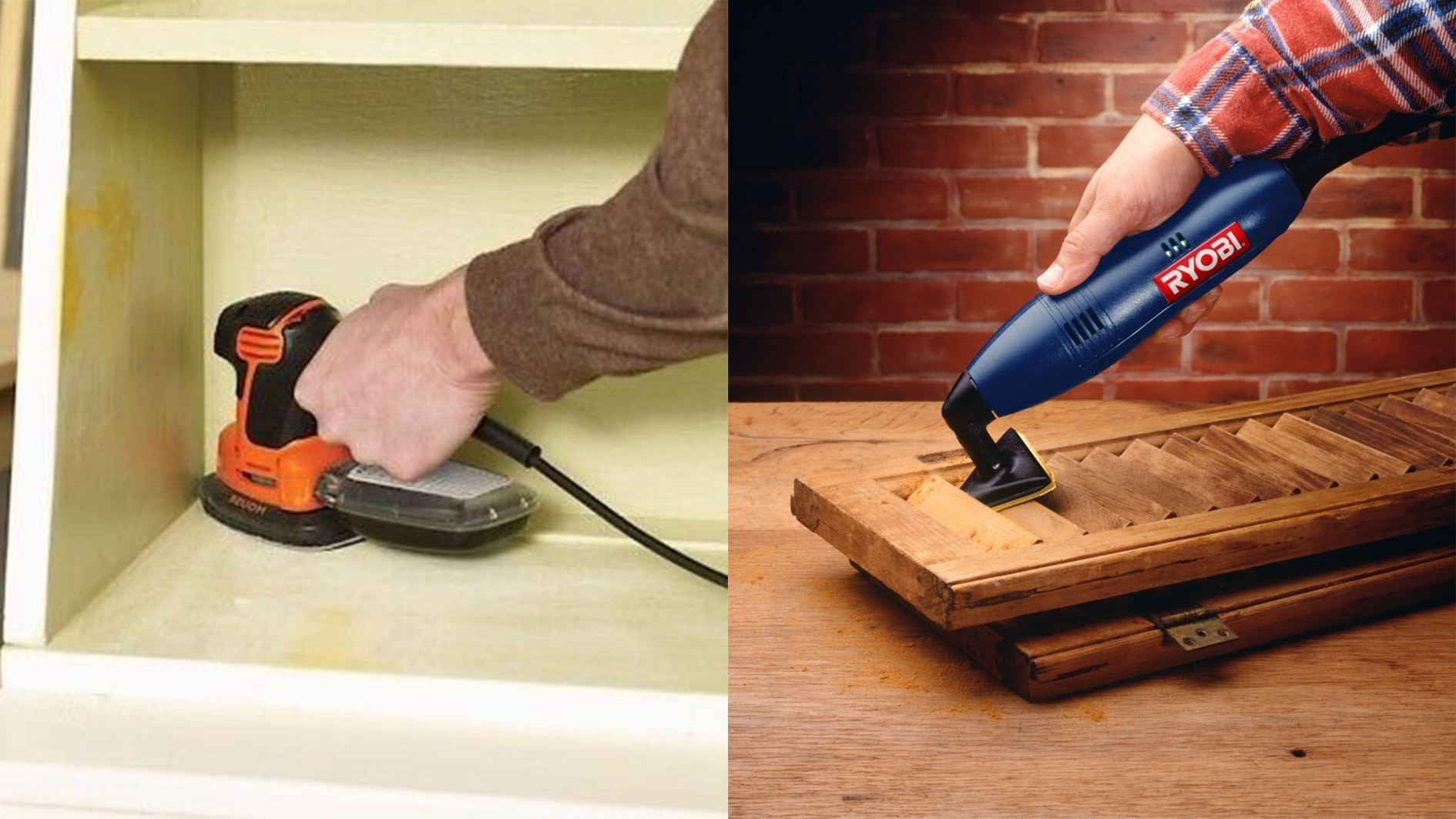

Power Sanding
Power tools are more ideal and make the sanding process faster for larger surfaces or more intensive sanding tasks. For instance roughing out larger pieces of furniture or signs, a project that has many cutting scars or stubborn ridges left over, or increasing efficiency on batch jobs.

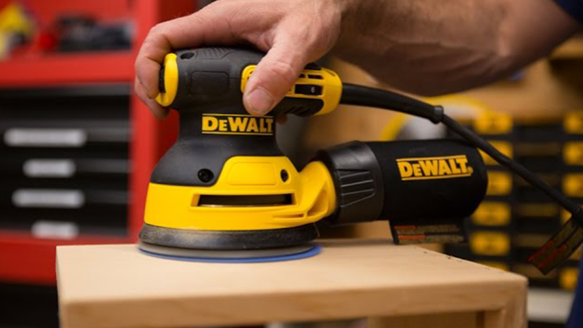

Orbital Sander: a handheld sander that moves in small circles. You can also get a random orbital sander, that moves randomly instead of in circles which makes for an even better finish.
- Usage: general-purpose sanding, producing a fine finish with minimal swirl marks
Detail Sander: small triangular-shaped sander that vibrates.
- Usage: designed for tight spaces, corners, and detailed work

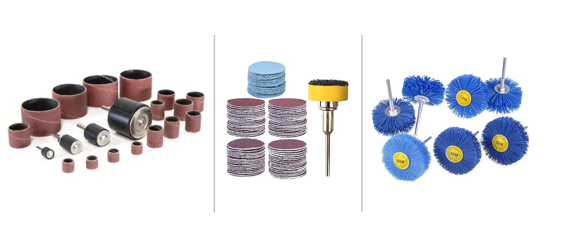

Dremel or Hand Drill: can use a drum, disc, or mop sanding attachment that fits into the Dremel or drill.
- Usage: use when light sanding is required or the surface is quite soft. Mops are great to get into tight spaces to remove wood fuzz.

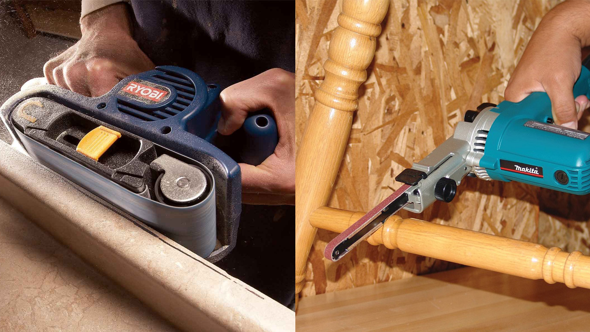

Belt Sander: uses a continuous loop of sandpaper. Can be a wide strip or thin wand unit.
- Usage: best for removing large amounts of material quickly and levelling surfaces
Stationary Disc / Belt Sander: uses a spinning disc of sandpaper, or a combo of belt and disc sandpaper. Can be mounted on a workbench or table and permanently hooked up to a dust collection system.
- Usage: suitable for rough sanding or shaping edges

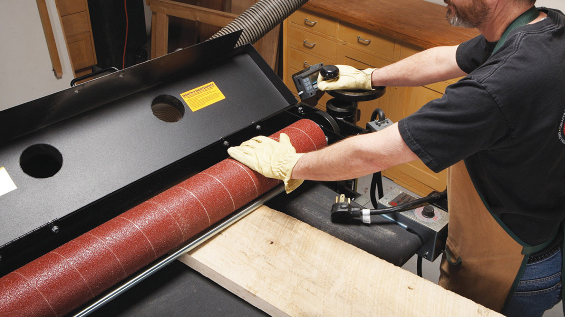

Drum Sander: a large, stationary sander with a rotating drum. Typically more expensive and used for more professional applications.
- Usage: ideal for sanding large surfaces such as wooden floor boards. Great for removing old paint, varnish, or discolourations and for levelling and smoothing large surfaces

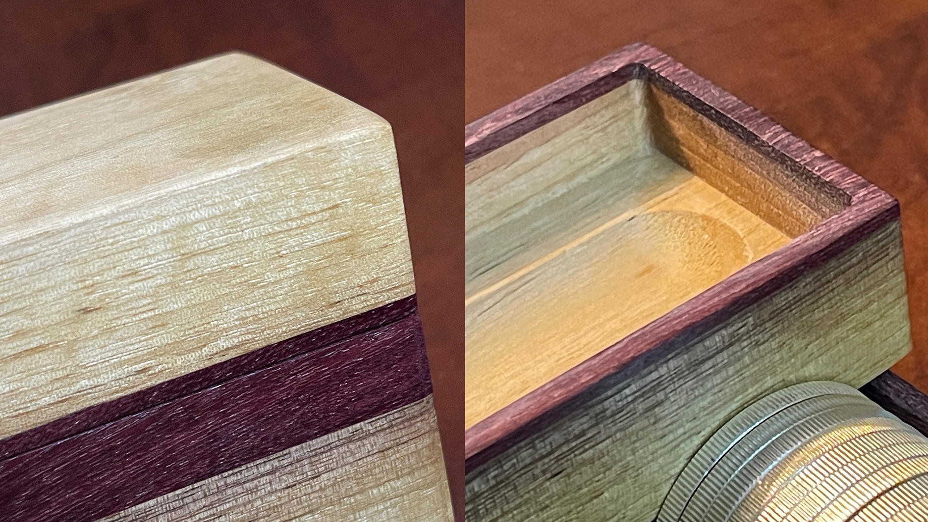

Learn Sealing

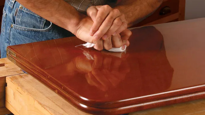

Finishing generally involves evenly applying a sealant, allowing it to dry, and lightly sanding between coats until it’s smoothed to your preference. Proper finishing not only improves aesthetics but also helps protect your project from cracks and splits, or fading with time. Once the sealant seeps into the exposed wood grains it becomes a barrier against dirt and moisture getting in and stops the inside of the wood from getting too moist or cracking from drying out.
The easiest way to seal wood is to simply coat it with an oil, even something simple like a food safe mineral oil or tung oil, but there are also many purpose-made sealants to choose from in the form of waxes, urethanes, and lacquers. Paint and Stain can also protect wood, but these usually require that you colour the wood in some way whereas sealers are clear or semi-transparent, preserving the wood’s original color and grain. Read the table comparing different finishes to help you decide what approach you want for your project, since you might decide you prefer paints or stains over sealants.

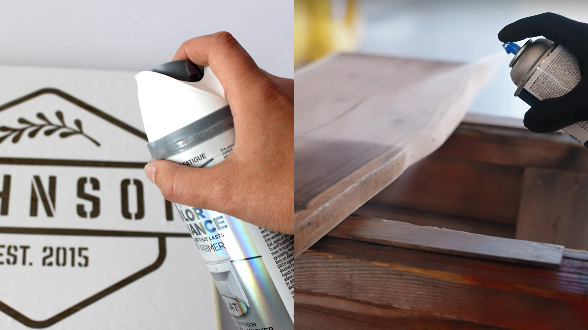

Spray Paint: an aerosolized paint that allows for quick, even application over a wide area. It is convenient for both small and large-scale projects where speed and ease of use are essential. You can get a grip attachment that helps hold the can better and dispense the paint smoothly.

Learn Painting
The obvious aspect of painting is that it provides many ways to customize the look of your projects. Whether you’re masking, blending, or layering, paint offers lots of versatility with its design possibilities. Less well known is that painting wood can also seal the surface against warping and mold, and create a more durable coating to prevent prevent chipping and cracks.
The most important thing to a successful paint job is surface preparation which is covered quite well in the sanding section. Depending on the material, you may also want to use a primer before painting, since these are designed to help the paint stick better to the surface you’re painting. Once the surface is prepared, simply apply the paint in thin layers, allowing it to dry and sanding in between coats.
Paints & Primers
| Primer Type | Finish | Best For |
| Acrylic Primer | Matte/Satin | General indoor and outdoor surfaces, wood, drywall, and plaster. |
| Oil-Based Primer | Smooth | Wood, metal, and surfaces prone to stains or rust. |
| Shellac Primer | Glossy/Matte | Sealing in odors and stains, providing a strong barrier on wood, metal, and plaster. |
| Paint Type | Finish | Best For |
| Acrylic Paint | Matte/Satin/Gloss | Small to medium projects, easy application. |
| Spray Paint | Smooth, Glossy | Large areas, quick coverage. |
| Latex Paint | Matte or Gloss | Projects requiring durability and flexibility. |
Step-by-Step Painting Process
- Get Equipped
Select your paint as well as brushes and other tools based on your project. - Prepare the Surface
Remove dust left after sanding by vacuuming or wiping it down with a tack cloth. Also, apply tape if you want to mask off any areas you don’t want painted. - Prime the Surface (optional but recommended)
- Choose the Right Primer: use a stain-blocking primer if the wood is knotty or has discolorations
- Apply an Even Coat: use a brush, following the wood grain
- Allow it to dry according to the manufacturer’s instructions
- Light Sanding: once dry, sand lightly with 220-grit paper and wipe away dust
- Apply Paint in Thin Layers
- Mix the Paint: stir the paint thoroughly with a stir stick or shake the can
- Apply the First Coat: use a brush for detailed areas and a roller or spray paint for flat surfaces. Apply thin, even coats
- Let it Dry: allow the paint to dry completely (usually 4–6 hours or per instructions)
- Sand Between Coats: lightly sand with 220-grit sandpaper for a smooth finish, then wipe away dust
- Apply Additional Coats: repeat the process until you achieve the desired opacity and finish (typically 2–3 coats)
- Final Sanding (320–400 Grit)
- This helps smooth any imperfections or raised grain caused by moisture in the paint before applying the final coat
- Apply Final Coat
- After applying the desired number of layers (typically 2–3), let the project dry completely before moving on to sealing
- Finishing Touches
- Remove Painter’s Tape: carefully peel off the tape to reveal clean edges
- Cure the Paint: allow the final coat to cure fully (up to 24 hours) before using or moving the piece
Painting Tips & Videos
- If you want to paint the inside of your carves, like painting a signature black while leaving the rest of the wood grain exposed, then you can either apply a mask before carving (like Oramask) or consider sealing the wood before cutting it on the CNC. Either technique can really help leave crisp lines where paint would normally “bleed” around the edges.
- Always paint in a well-ventilated area.
- Use quality brushes and rollers to avoid streaks and brush marks.
- Avoid applying thick coats to prevent drips or uneven coverage.
| Video Title | Description | Duration | Link |
| Which Spray Paint is Best on Wood Furniture? | This video explores different types of spray paints and their effectiveness on wood furniture. | 20 minutes | Watch Video |
| Using a Flat Roller to Paint a V-Carved Sign | A quick tutorial on how to use a flat roller for painting a V-carved sign. | 4 minutes | Watch Video |

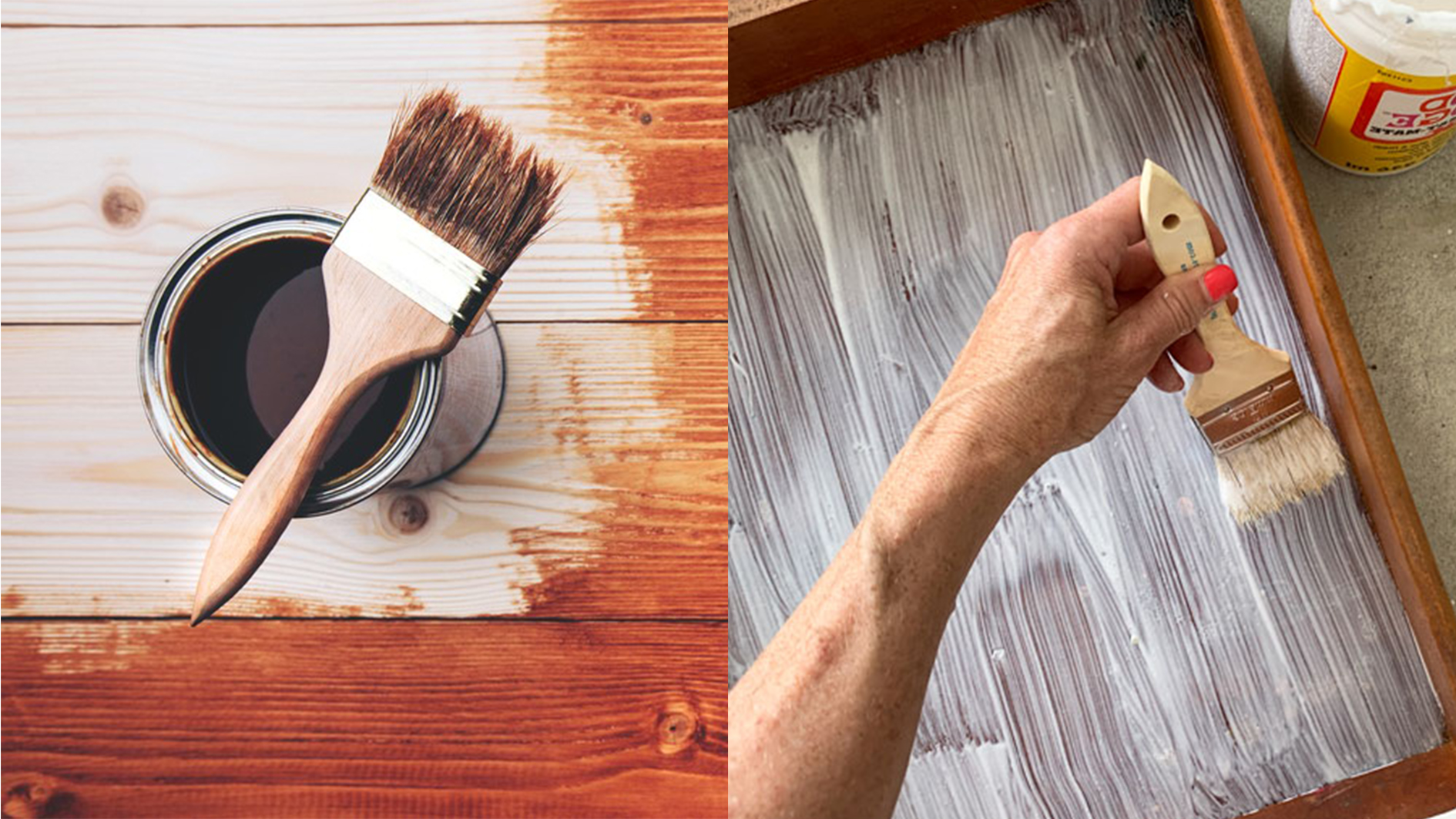

Step-by-Step Staining Process
- Get Equipped:
Select your stain as well as brushes and other tools based on your project. - Pre-Stain Conditioner (optional):
Use a wood conditioner on softwoods (e.g. pine, maple) to ensure even stain absorption. - Apply Stain with a Brush or Cloth:
Work the stain into the wood, following the grain. Wipe away excess after 5-10 minutes. - Let the Stain Dry:
Allow at least 4-6 hours (oil-based) or 1-2 hours (water-based) before applying a second coat or moving to the sealing stage. - Apply Additional Coats (optional):
If you want a deeper color, you can apply multiple coats, allowing full drying between each.

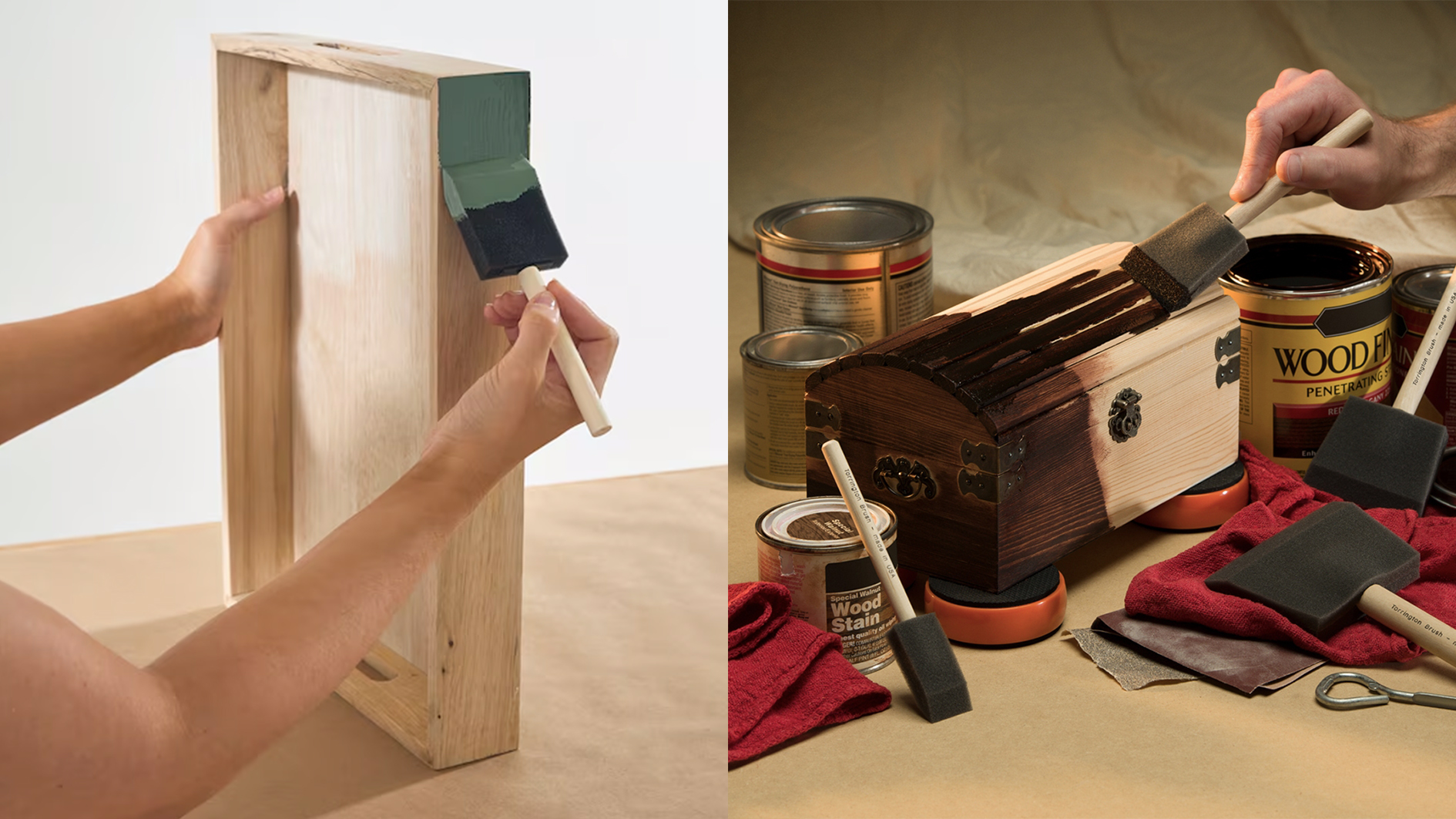

Paintbrush: a versatile tool with bristles made from synthetic or natural materials, used for applying paint, varnish, or stain. Brushes come in different shapes and sizes for various applications.
- Usage: best for cutting-in edges, detailed work, stencilling, and applying smooth coats.
- Types:
- Flat Brush: for large, flat surfaces and broad strokes.
- Angled Brush: for cutting-in and painting edges.
- Round Brush: for detailed or decorative work.
Chip Brush: an inexpensive, all-purpose brush with natural bristles. Not meant for fine finishes, but useful for rough surfaces or for applying glue and other adhesives.
- Usage: ideal for quick touch-ups, stains, or cleaning jobs.
- Types: disposable or reusable, usually made with natural hog bristles.
Detail Brush: a small, fine paintbrush used for precise work, such as painting intricate patterns, corners, or detailed trim.
- Usage: best for fine detailing, small touch-ups, and tight spaces.
- Types: synthetic or natural bristles, typically round or angular in shape.
Foam Brush: a foam pad on a wooden handle used for applying paint or varnish with minimal brush strokes. Ideal for smooth finishes and water-based products.
- Usage: great for spreading thin, even coats without leaving bristle marks.
- Types: disposable foam brushes are available in different sizes, typically ranging from 1 to 4 inches.
Stain Brush: a thick, wide brush designed for applying wood stains and varnishes. Has a high bristle density to hold more product and provide good coverage.
- Usage: apply stains and varnishes evenly over large surfaces.
- Types: available in various sizes and bristle materials, often 3–4 inches wide.

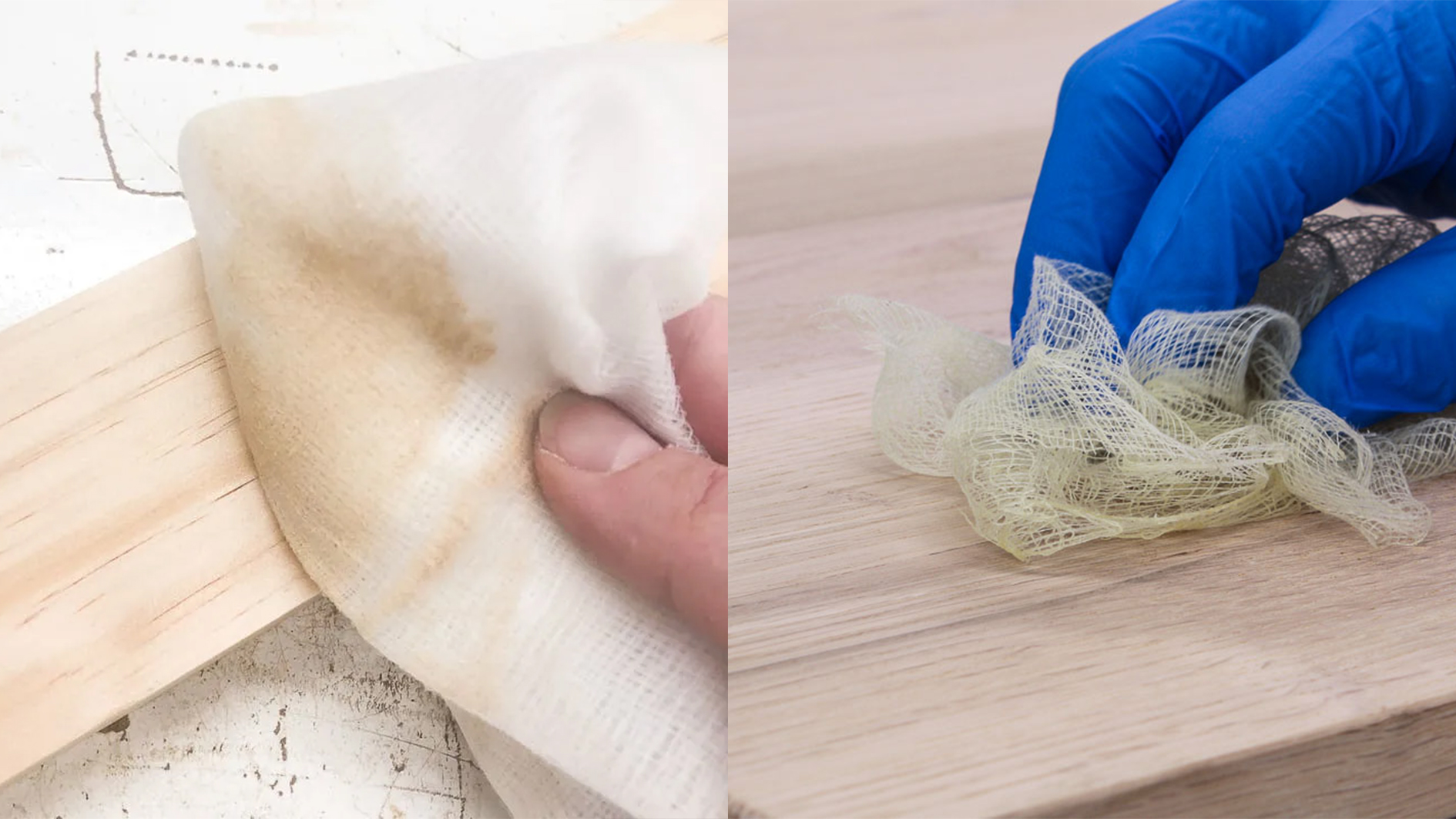

French Finishing
French finishing, also known as French polishing, is a traditional wood finishing technique that’s highly regarded for creating a high-gloss, lustrous, and deep finish on wood surfaces. This technique dates back to the 18th century and is typically used on fine furniture and musical instruments, like guitars and violins.
![[Finewoodworking.com(https://www.finewoodworking.com/project-guides/finishing/french-polishing-demystified)]](https://resources.sienci.com/wp-content/uploads/2026/02/cnc_ha_sf_frenchfin.jpg)
Using shellac, alcohol, and a rubbing pad to build up multiple thin layers, the end result brings out the rich grain and natural warmth especially on high-quality woods. Surprisingly, the delicate layers also combine to create a surprisingly resilient finish. The general process is as follows:
- Prepare the Wood
Sand the wood to a very smooth surface, progressing through grits from 120 up to 320 or even finer. Ensure the wood is free of any dust, scratches, or imperfections, as French finishing will highlight these. - Create the Padding
Make a French polishing pad, or “rubber,” by wrapping a small ball of cotton in a soft, lint-free cloth. The pad should be shaped so that it has a smooth, even surface to glide over the wood without leaving marks. - Apply the Shellac
Start by saturating the pad with a mixture of shellac and alcohol (typically a 1:1 ratio). Apply the shellac in long, sweeping motions, working in small circular or figure-eight movements to evenly coat the wood. Be careful not to press too hard, as this can damage the finish. Work in thin layers, allowing each layer to dry before applying the next. - Build Up Layers
Continue applying layers of shellac until the desired depth and shine are achieved. This can take multiple sessions, as each layer should be allowed to dry for at least 30 minutes between applications. For a rich, glossy look, French polishers may apply 10-20 layers of shellac. - Lubricate with Oil
To prevent the pad from sticking to the wood as you build layers, add a few drops of oil (such as mineral oil) to the pad. This will act as a lubricant and help achieve a smoother finish. Be sparing with the oil, as too much can dull the finish. - Finish and Buff
Once you’ve built up a sufficient number of layers and achieved a deep gloss, allow the finish to fully cure (which may take up to a week). Then, lightly buff the surface with a clean, soft cloth to remove any residual oil and enhance the shine.- French finishing works best on fine woods like mahogany and walnut.
- Avoid using the finish in high-moisture areas, as shellac can be sensitive to water.
By following this process, you can achieve a stunning, professional-quality finish with a deep, luxurious sheen that highlights the natural beauty of the wood.
Tip: practice on a scrap piece of wood to perfect your technique before applying French finish to a larger project.
