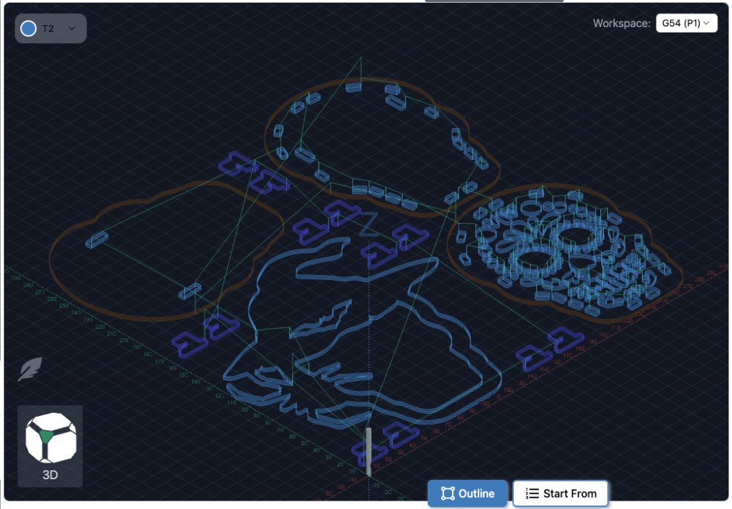

This is an image of the visualization available in gSender.

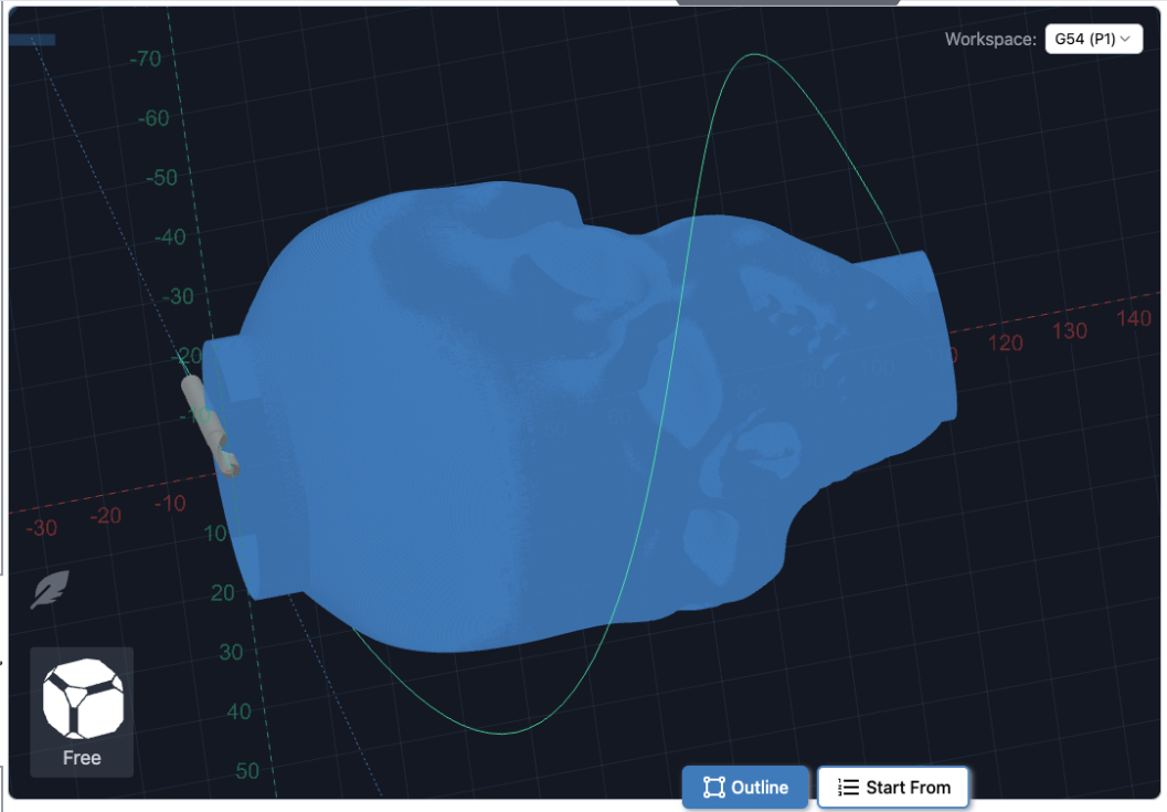

gSender also shows visualizations for your rotary files!
