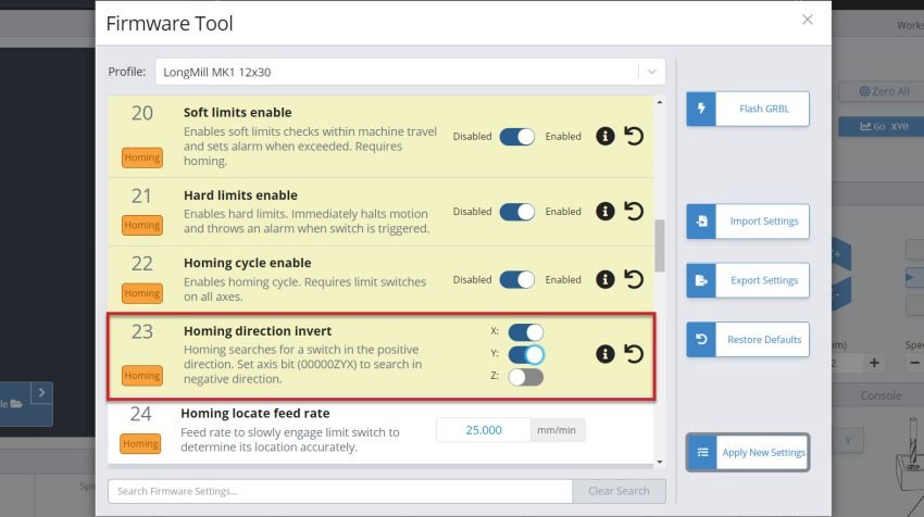

Step 5: Changing your settings for limit switches
If you received your machine before September 2021, you may need to update your LongMill’s firmware to the latest version to have access to all of the updates for your limit switches to work. At the time of writing, the latest version of the LongMill firmware is Sept 8, 2021.
To update your firmware, connect your machine to gSender, click on “Firmware”, and click on the “Flash grbl” button. Follow the prompts to install the latest version of the firmware onto your LongBoard.
Next, import our default EEPROM settings for your machine. Press “Restore Defaults” at the “Firmware” window. with limit switches. Use the “Import Settings” tool and update your EEPROM settings to the new defaults (link to download file coming soon). If you wish to make changes or adjustments, additional info about changing your EEPROM settings can be found further down on this page.
Recommended settings for sensors
Now that we’re working with the default settings, we will modify a few to make them work with the sensors.
- Enable Soft and Hard limits ($20 and $21)
- Enable Homing cycle ($22)
- Check Homing direction invert ($23)
- Check X and Y-axis travel limits ($130 and $131)

Homing direction
If you want to set your home at the front left corner and have installed your inductive sensors to match, you will need to invert your X and Y-axis. By default all axes will home in the “positive” direction which is typically Right (X), Away (Y), and Up (Z) so toggle these as needed for your setup.
