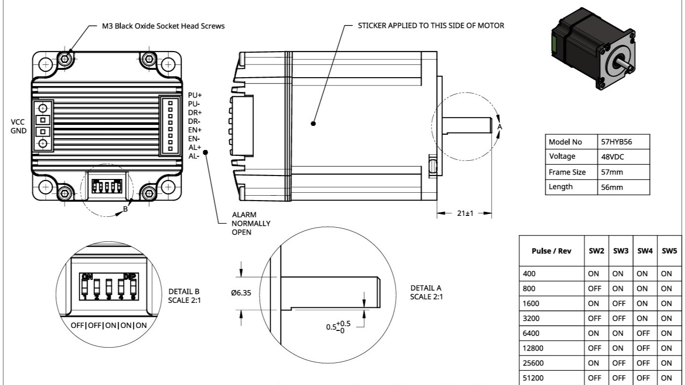

Closed loop stepper motors function by receiving a certain number of ‘step’ pulses from the controller which ultimately determines how much and how fast the motor the spin. ‘Microstepping’ is a setting/configuration which will ultimately determine how much the motor spins for a given number of pulses or ‘steps’ sent to the motor.
By default all the motors are set to use 1/16 microstepping, with the DIP switches at the rear of the motor set to 1-Down 2-Down 3-Up 4-Up 5-Up.
Do not adjust DIP switches if you’re not sure what microstepping is, or if you do not have a reason to change them.
The first switch #1 is only used to invert the direction of the motor if needed. The table in the drawing above shows the various switch positions for a given microstepping value.
