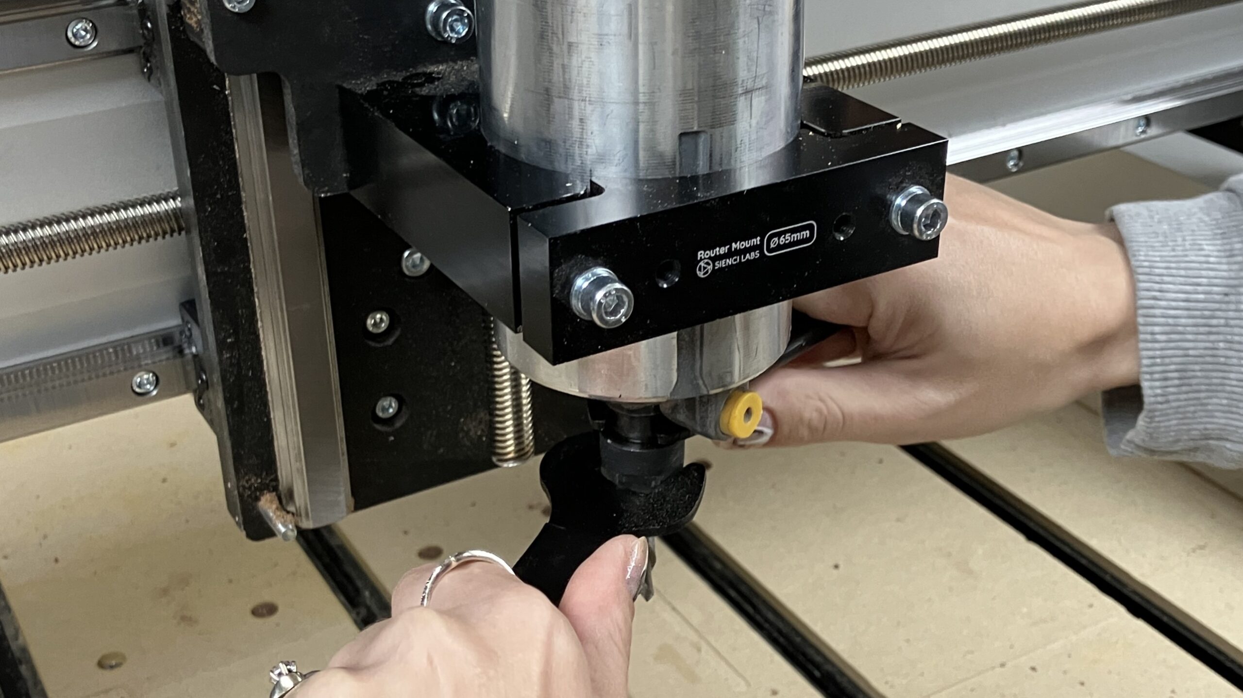

  1. Grab the 22mm surfacing bit from your Starter End Mill pack, which came with your MK3 Beginner’s Kit.
  2. Learn how to install and remove tools on your AutoSpin. Then install your surfacing bit.
  3. Turn ON your AutoSpin router, and make sure it is set to “S” for spindle mode.

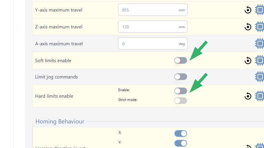

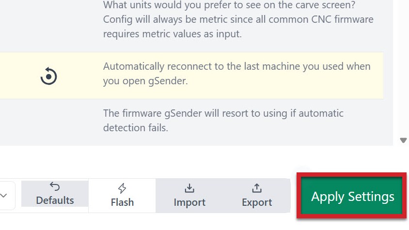

  7. Open the Config tool, and under Homing/Limits, disable the hard and soft limits. You will get an Alarm 2 if soft limits are enabled and you won’t be able to surface your spoil board.
    Press Apply Settings, then turn OFF/ON your SLB-LITE controller.
  8. Reconnect to gSender.

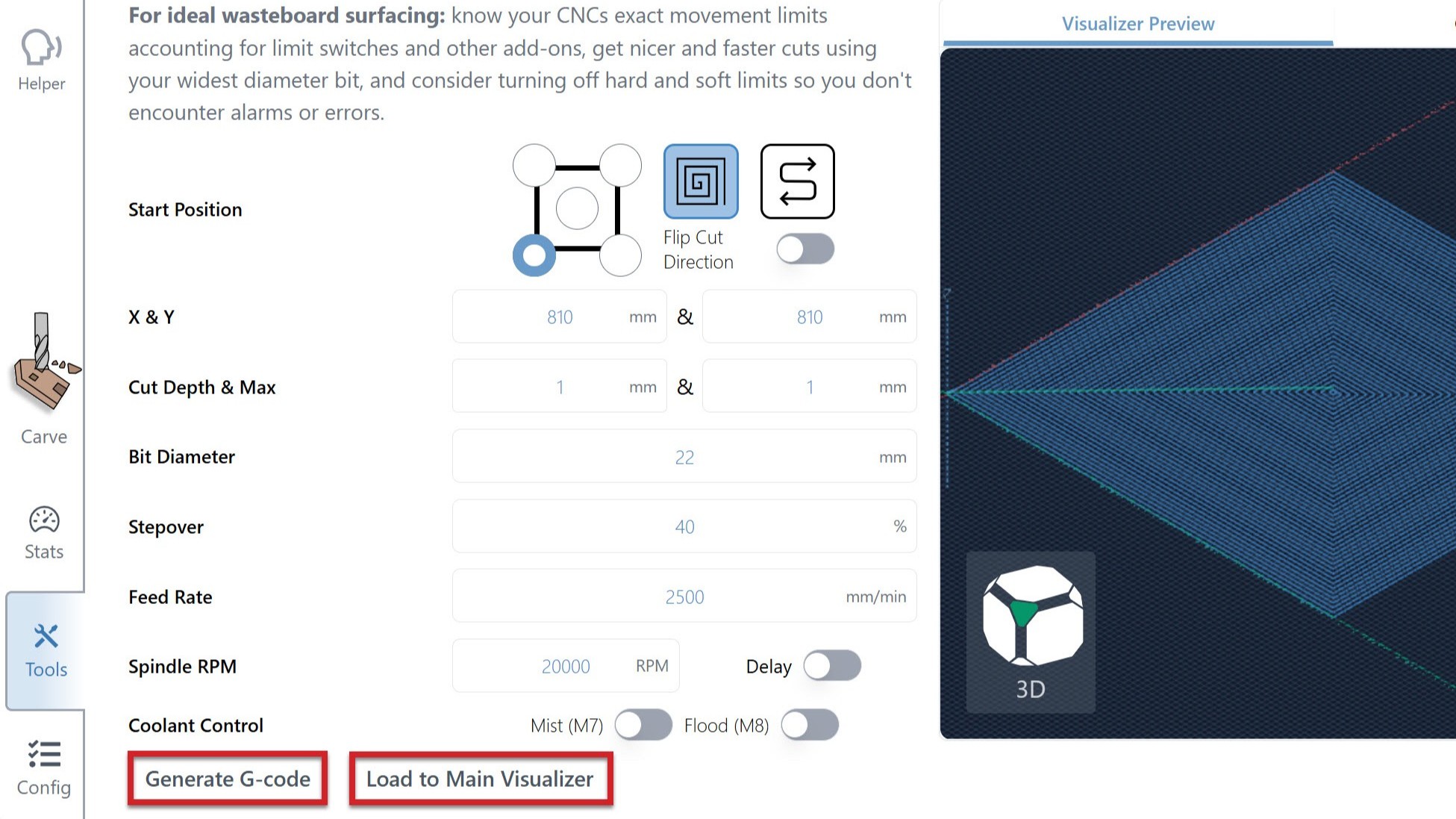

  12. On the sidebar, navigate to Tools, then select Surfacing.
  13. You will find the Wasteboard Surfacing settings, adjust as needed.
    Start Position: Where to start surfacing, usually it’s where you zeroed your machine.
    • Select the bottom left corner of the square, corresponding to the front left of the machine
    X & Y: Surfacing dimensions, how large you want to surface.
    • Use the values determined in Step 9
    Cut Depth & Max: Depth of cut per pass & total depth cut into the wasteboard
    • Set both at 1mm (0.04″)
    • Cut depth larger than 1mm can result in an uneven surface
    • Max can be doubled if your wasteboard is very warped or has deep imperfections
    Bit Diameter: Diameter of cutting tool installed
    • Set to 22mm
    • If you use another surfacing bit, will need to change this value
    Stepover: Percentage of cutting tool area that’s overlapping
    • Use 40%
    • Larger stepover will result in a longer cutting time and a smoother finish, whereas smaller stepover will result in a rougher finish.
    Feed Rate: How fast your machine moves, to bring material through the cutting tool.
    • Use 2500 mm/min
    Spindle RPM: How fast your spindle/cutting tool rotates.
    • Use 20000 RPM

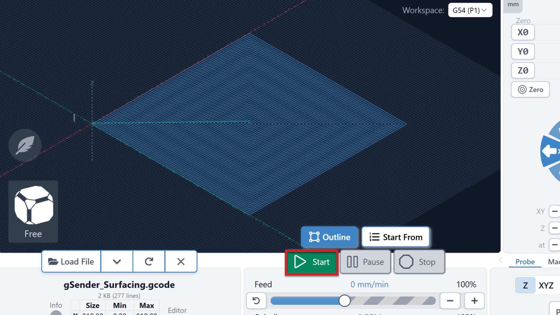

  14. Once you adjusted the settings, click Generate G-code to view the toolpath on the right side of the window.
  15. Click Run on Main Visualizer to load the file onto gSender.
  16. Attach your hose to the MK3 dust shoe, and turn on the dust collection to minimize MDF dust in the air.
    ⚠️ Regardless of whether you have a dust shoe, it is recommended to at least run a hose to a vacuum, since as MDF particles are quite fine and can jam up machine components.
  17. Put on a mask or respirator. Then on gSender, you can press Start
    The router should start spinning up on its own, and the machine should start moving and cutting your wasteboard!
  18. Once surfacing is complete, go into Config and enable the Soft and Hard Limits again and press Apply Settings.
Turn OFF/ON the controller to have the changes take effect.

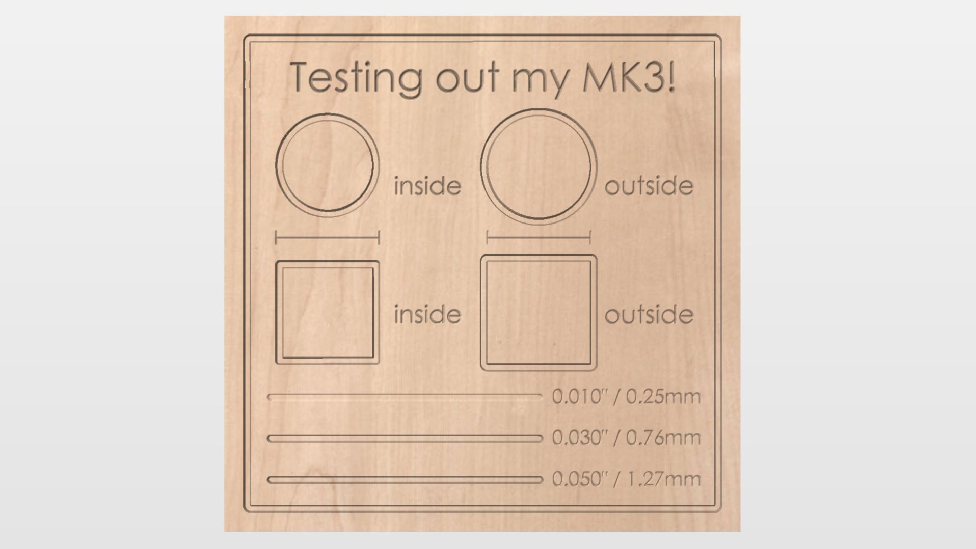

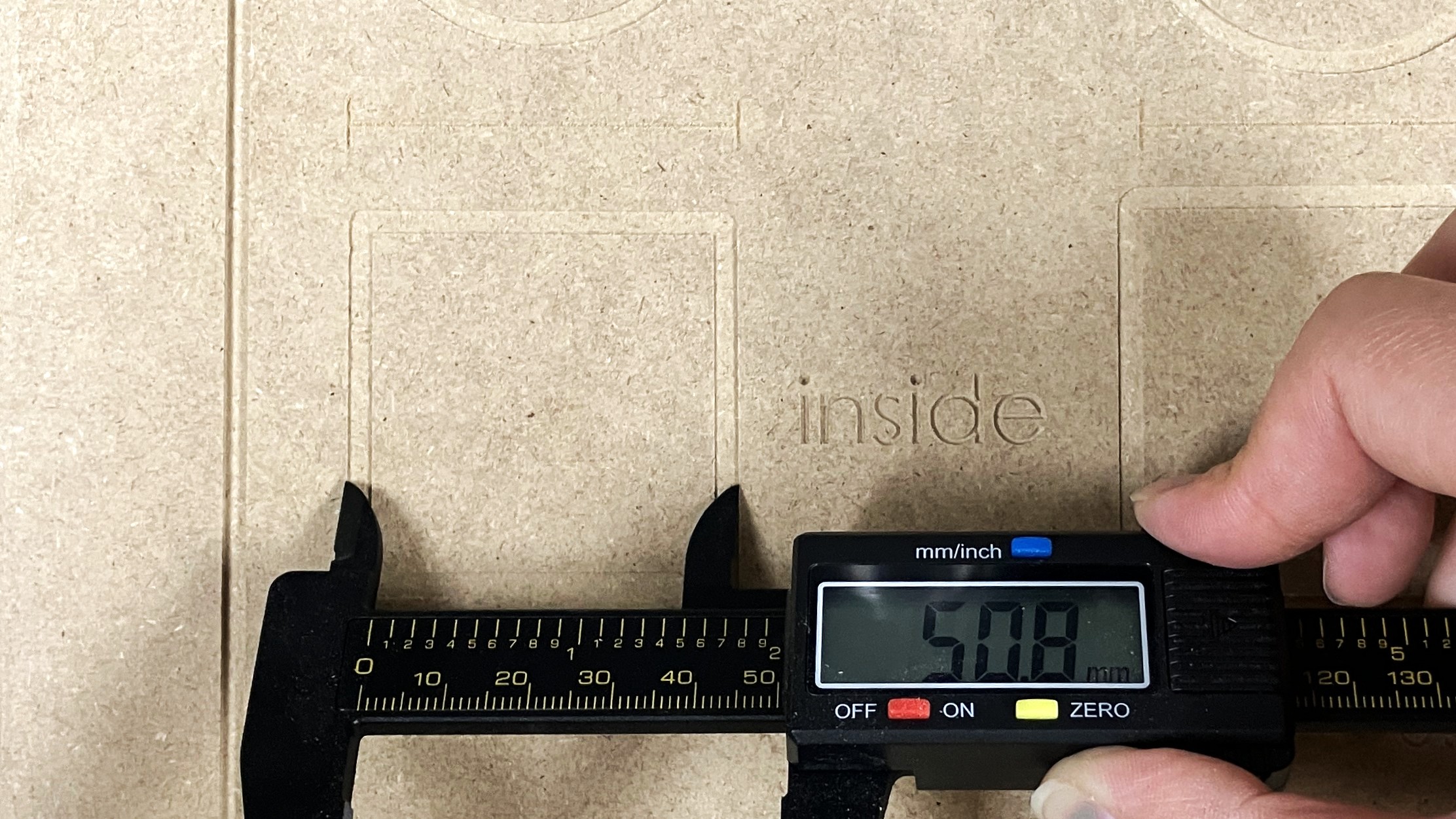

Our first project will be a short diagnostic test carve.
This should highlight any cutting issues happening in X, Y and Z axes. Look out for:
  • Roundness and squareness of the shapes
  • Accurate cutting depth at the 3 lines
  • Shapes are correctly offset from the 2″ long line
    • Inside means the outer contour of the shape is bound within the 2″
    • Outside means that the inner contour of the shape is bound by the 2″

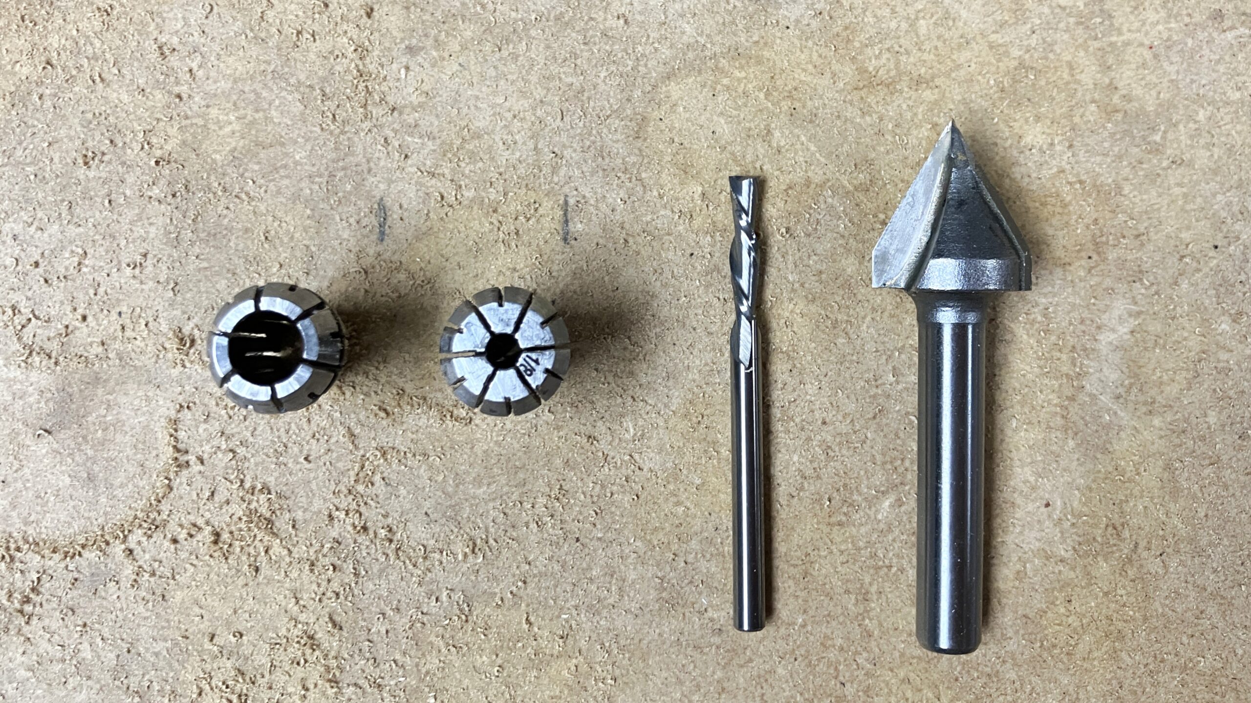

  • Find these tools from the Starter End Mill pack and AutoSpin box that came with your Beginner’s Kit.
    • 1/8″ flat end mill
    • 60 degree V-bit
    • 1/4″ ER11 collet
    • 1/8″ ER11 collet

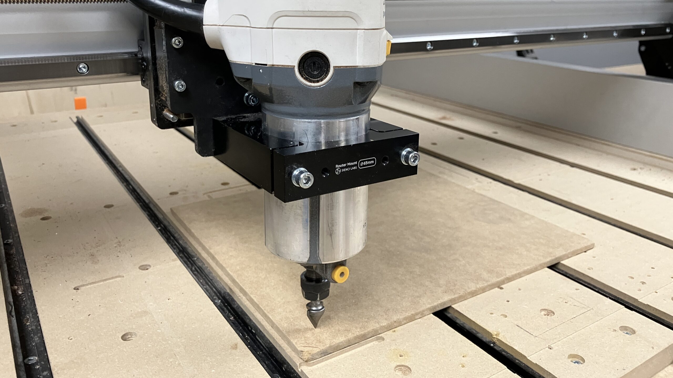

  1. Secure your material with workholding clamps, tape, or another method. It should be relatively square and flat on your wasteboard.
  2. Install the 60 degree V-bit and 1/4″ collet onto your AutoSpin. If you need a reminder on how to do this, see this page.
  3. Connect to gSender. Clear any alarms by pressing and releasing the E-stop on your SLB-LITE, then press Click to Unlock Machine on gSender.
  4. Home your machine.
  5. Jog your machine so the V-bit is at the front left corner of your material, and the V-bit touches the material surface. Then zero your X, Y and Z.
    • Zero manually – Set it at the corner if your material is exactly 10″x10″. In the picture below, our material is larger than 10″x10″ so we’ve set the zero slightly away.

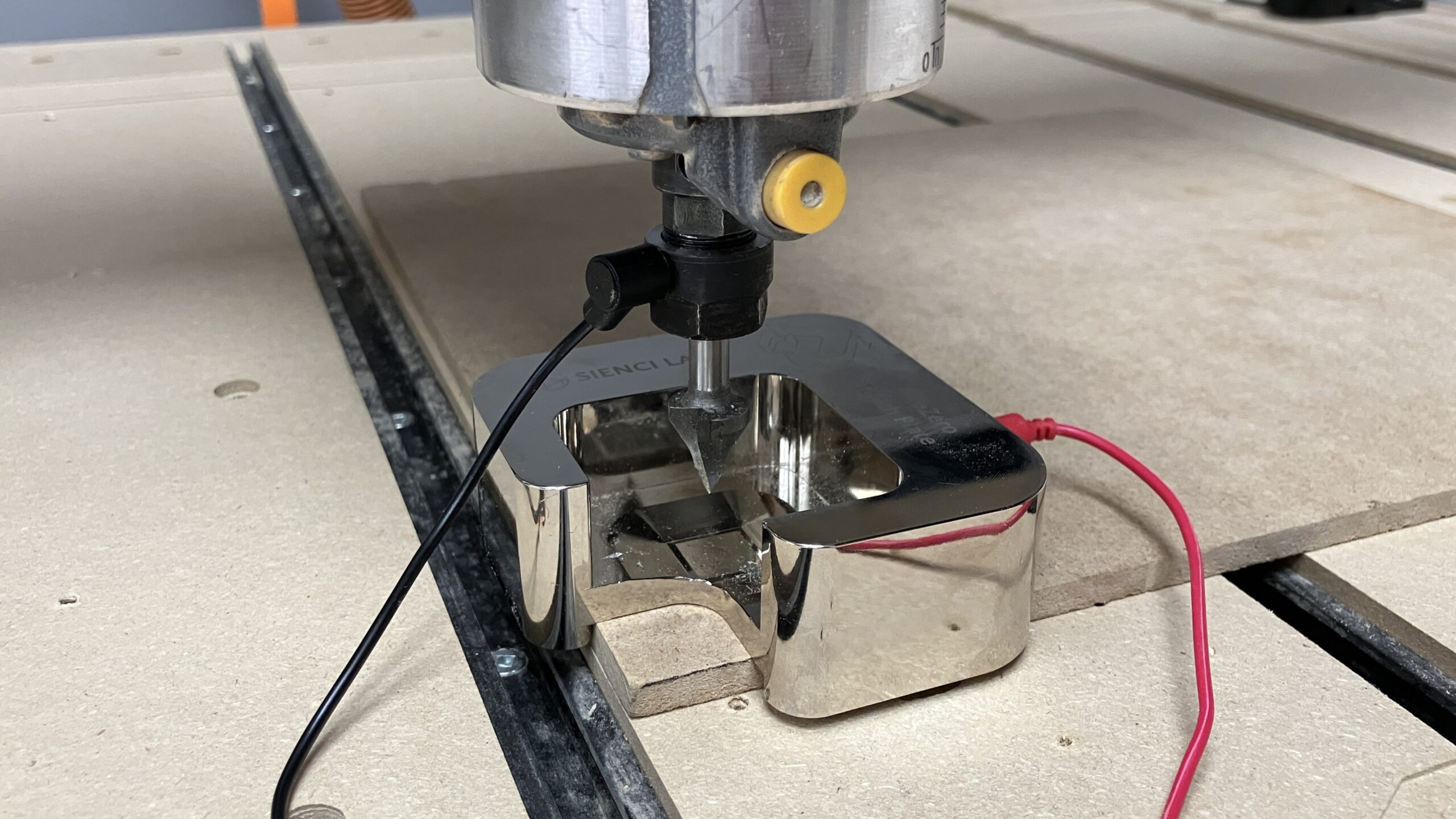

    • Zero using AutoZero touch plate – place the block at the front left corner, select XYZ then press Probe. Contact the end mill and touch plate together to verify continuity, then press Start Probe! Once complete, remove the AutoZero and the magnet from the router.
  6. Jog your machine upwards, then install the MK3 dust shoe.
  7. Check that your AutoSpin router is ON and it is set to Spindle Mode (S) on the dial.

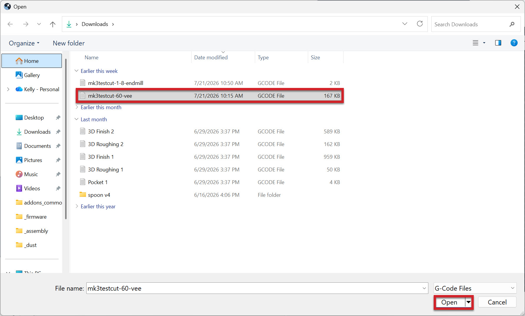

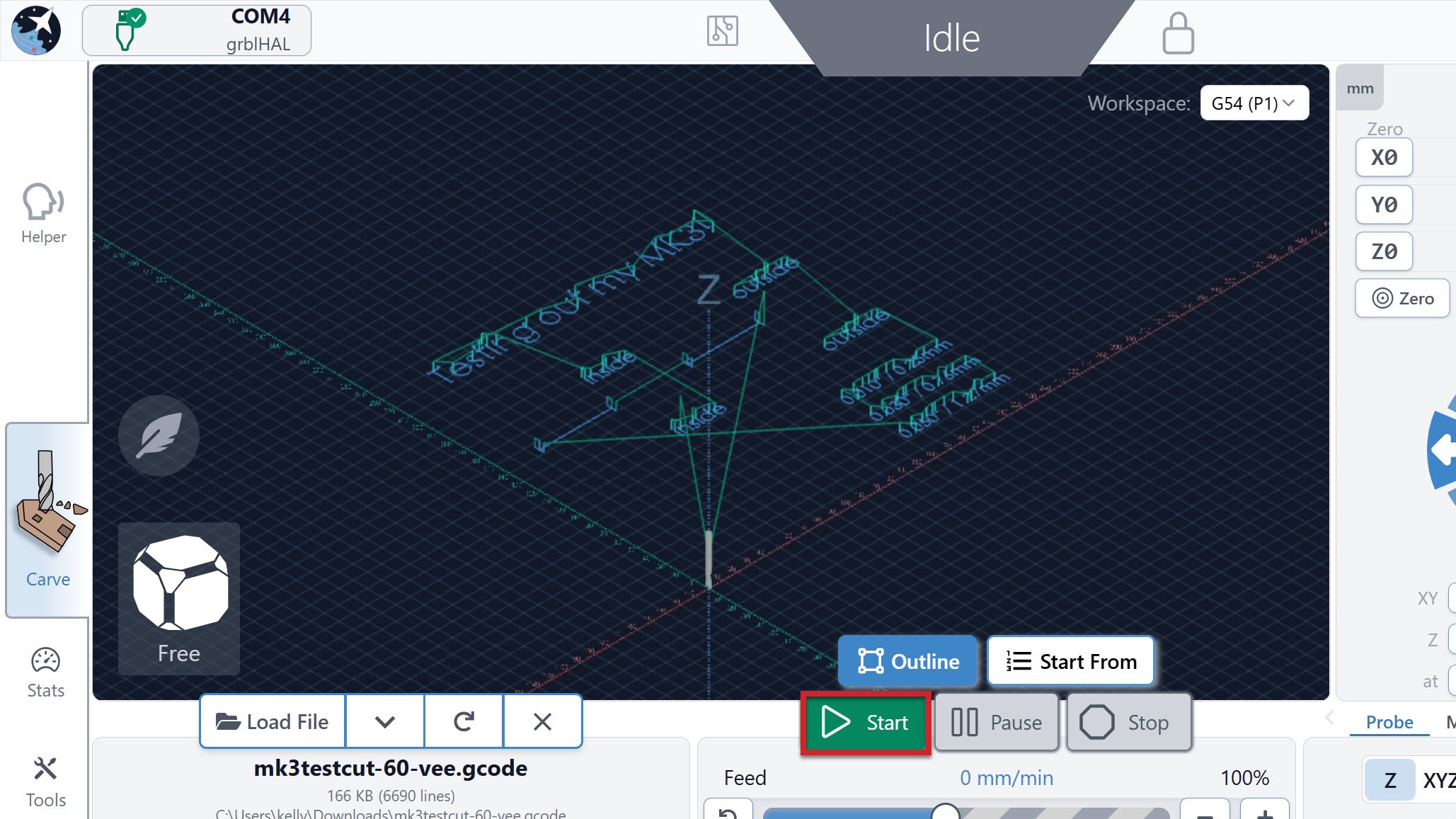

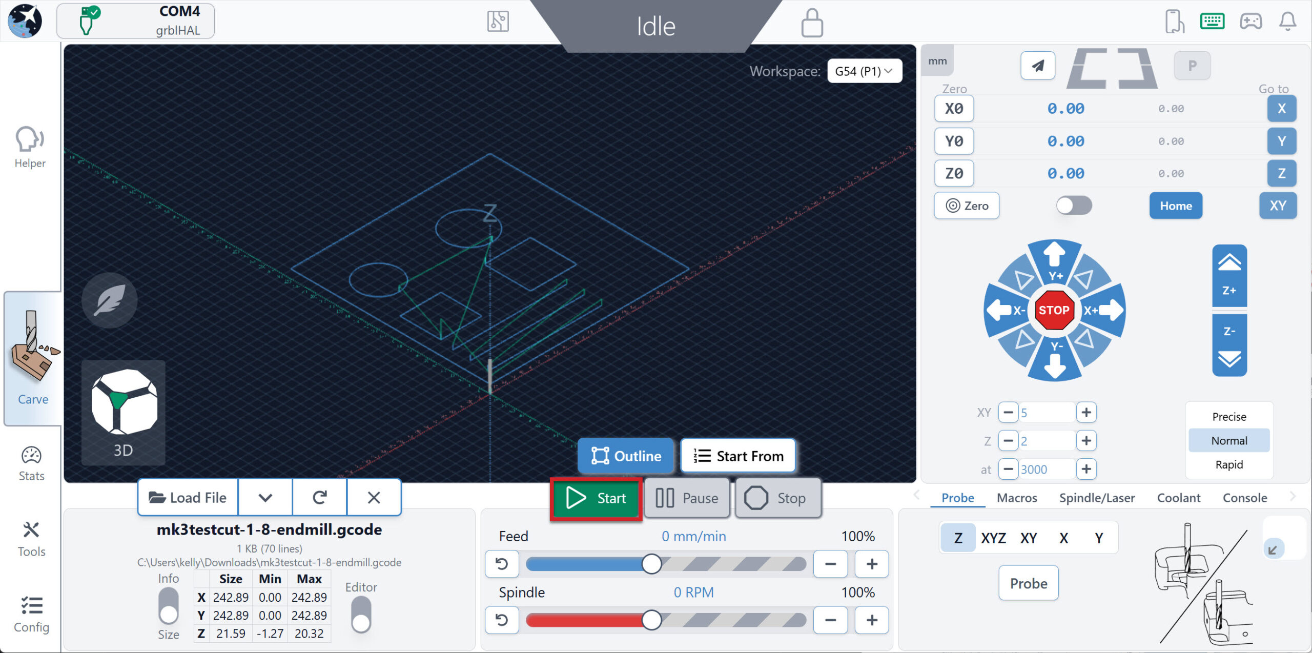

  8. We are almost ready. Press Load File and select the mk3testcut-60-vee file. Then click Open.
  9. Run the job by pressing Start! This job should only take a few minutes.
  10. Once the job is complete, jog the machine up and towards you, so you can change your tool.
  11. Grab the 1/8″ flat end mill and 1/8″ collet. Change out the tool.
  12. Then zero the Z-axis ONLY, at the uncut surface of your material.
    • DO NOT zero the X and Y. Both g-code files use the same XY origin/zeros.
  13. Press Load File and select the mk3testcut-1-8-endmill file. Then click Open.
  14. Run the new job by pressing Start! This job is also very short.

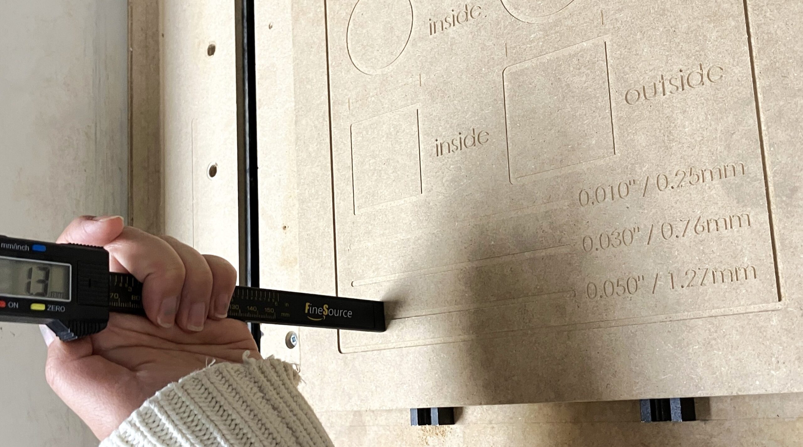

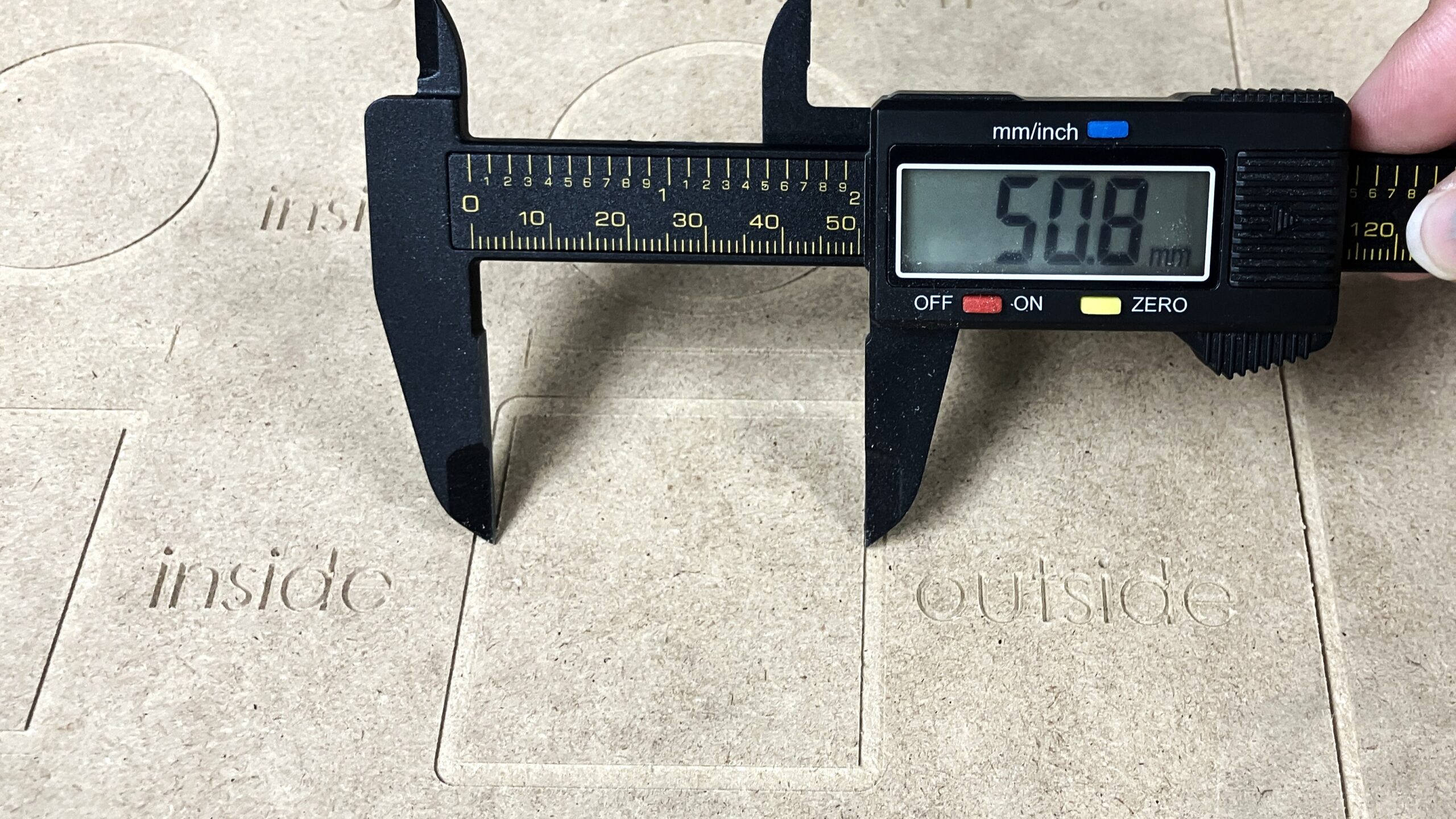

  15. Once complete, brush off any dust and take out your calipers. See if your machine is in tip-top shape. You should expect a tolerance of +/-0.1mm.
