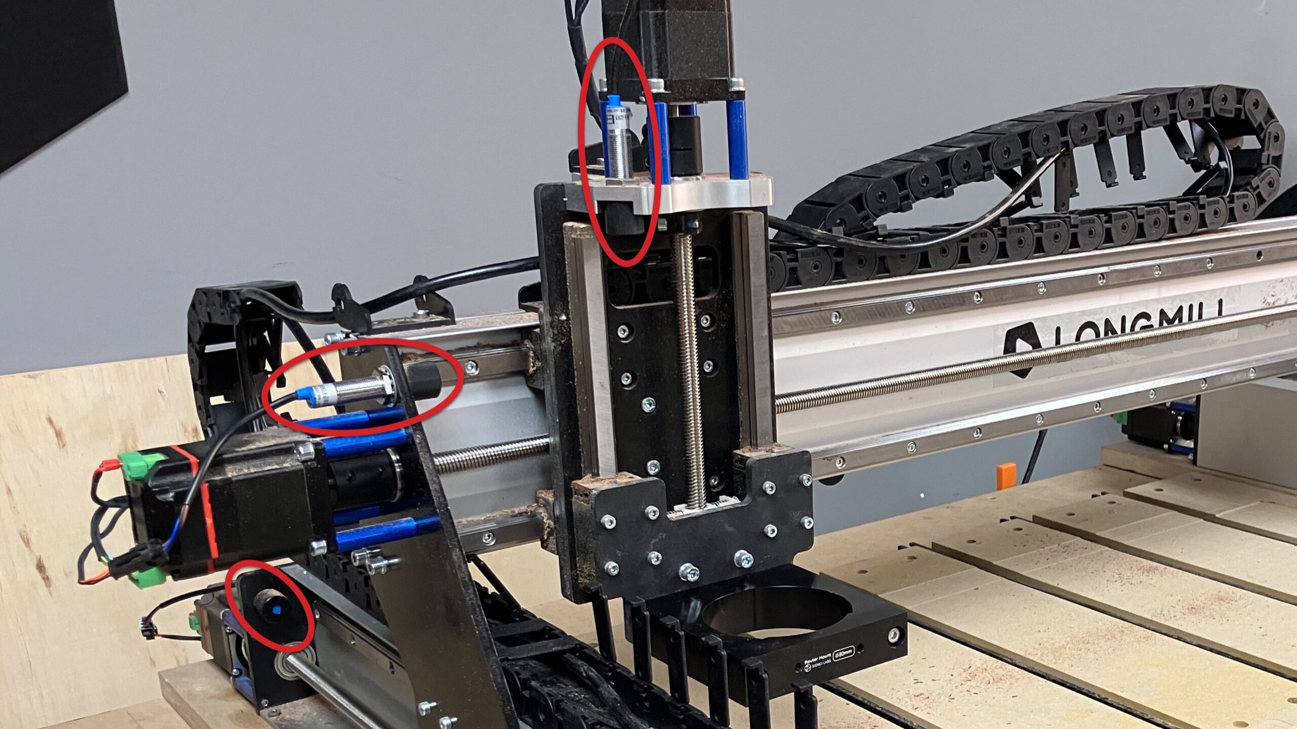

Limit switches are common CNC accessories that allows you to set and reference to a “home” position. This feature is helpful in achieving greater positional accuracy, since your machine can run jobs at a known location each time.
The LongMill MK3 comes with limit switches, and the included SLB-LITE controller comes pre-programmed to use those limit switches out-of-box. The specific limit switches we use are inductive sensors, which are triggered when metallic objects (like our gantries) come near their detection distance.

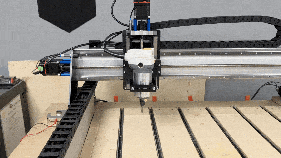

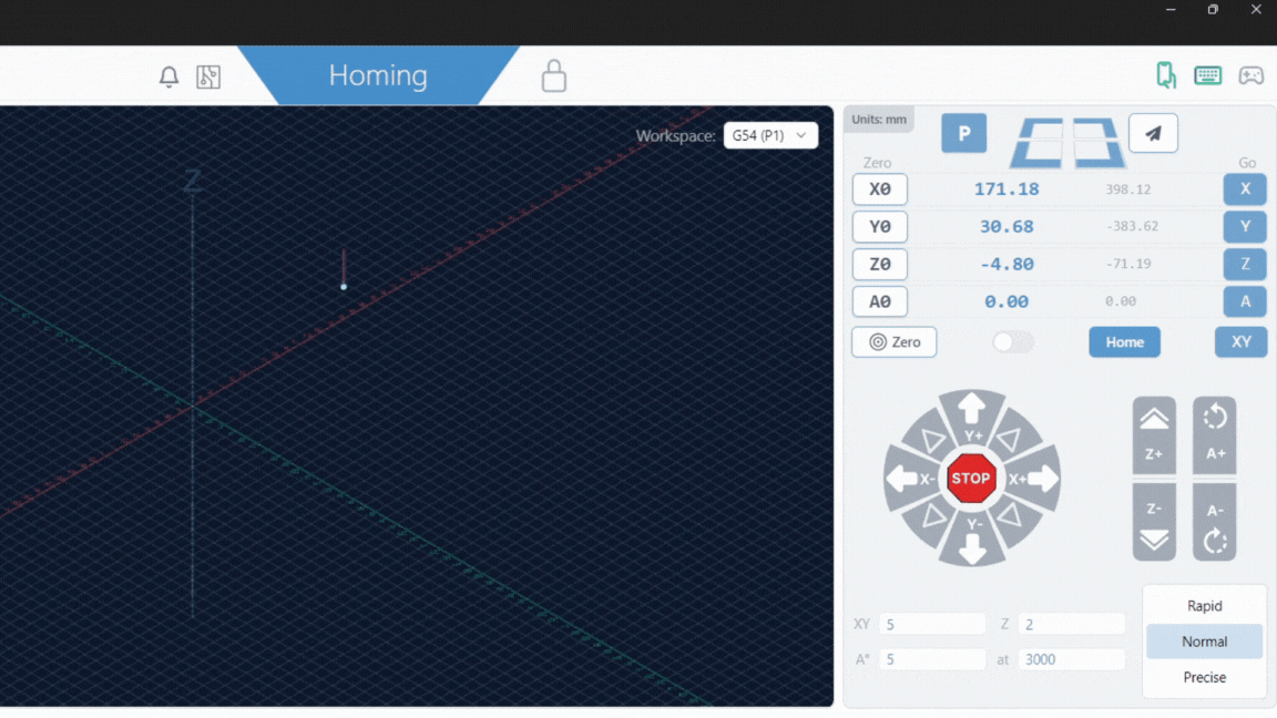

In order to use your limit switches, you need to “home” your machine each time you power it on. After connecting on gSender and resetting the E-stop, you can press the “Home” button to begin the homing cycle.
During the homing cycle, the machine will do the following:
  1. Move towards the limit switches in each axis
  2. Get triggered once it gets close enough to the limit switches on each axis
  3. Set the home position (grey machine coordinates turn to zero)
By default, the home position is set where the limit switches are. On the LongMill it will be the left-most, top-most, back-most corner of your machine.
