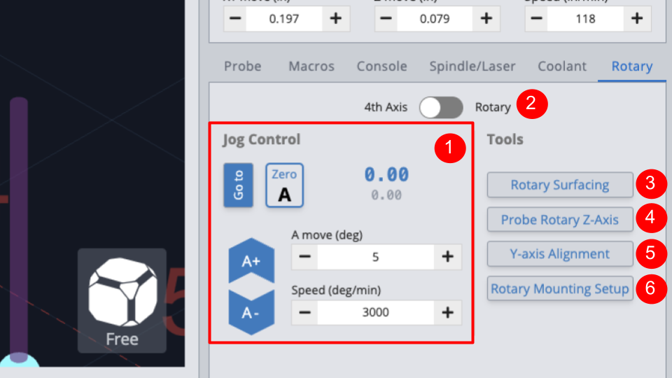

Enabling Rotary Controls
Navigate to the gear at the top right of gSender, where you will find the rotary settings. Here you can toggle the rotary controls to make them visible on the main page.
Once the toggle has been turned to display, you will see an additional tab at the bottom right of the window, called Rotary. With this tab you can:
- Jog Control – Rotate the A-axis, go to Zero, set Zero, and adjust speeds
- Rotary Mode – Switch to Rotary Mode or 4th Axis Mode
- Open Loop Vortex → use Rotary Mode
- Closed Loop Vortex → use 4th Axis Mode
- Rotary Surfacing – Wizard to turn square stock round
- Probe Rotary Z-axis – Automatically probe to find the Z-axis
- Y-axis Alignment – Automatically probe to align the Y-axis along the A-axis
- Do this before switching to Rotary Mode
- Not accessible when Rotary Mode is enabled, should disable rotary controls
- Rotary Mounting Setup – Drill holes in your wasteboard to mount the track
