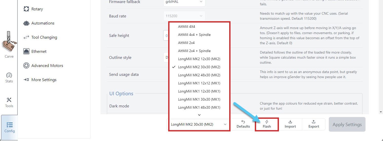

Once you’ve completed the installation, open gSender and connect to your machine. Open the Config Tab on the left side then check that you’ve selected your specific CNC in the profiles drop down so that the correct firmware is flashed. Click the Flash button to bring up the confirmation prompt.
NOTE: If you’ve made custom changes to your machines firmware that you don’t want to lose, use the ‘Export Settings’ button to save your settings to a file that you can then reload when flashing is complete.

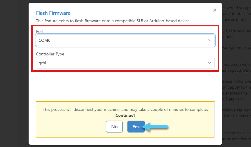

Select your current Port and keep the controller type as “grbl”. When ready, click the ‘Yes’ button to flash the latest firmware.
You will need to reconnect once you see the process is complete.

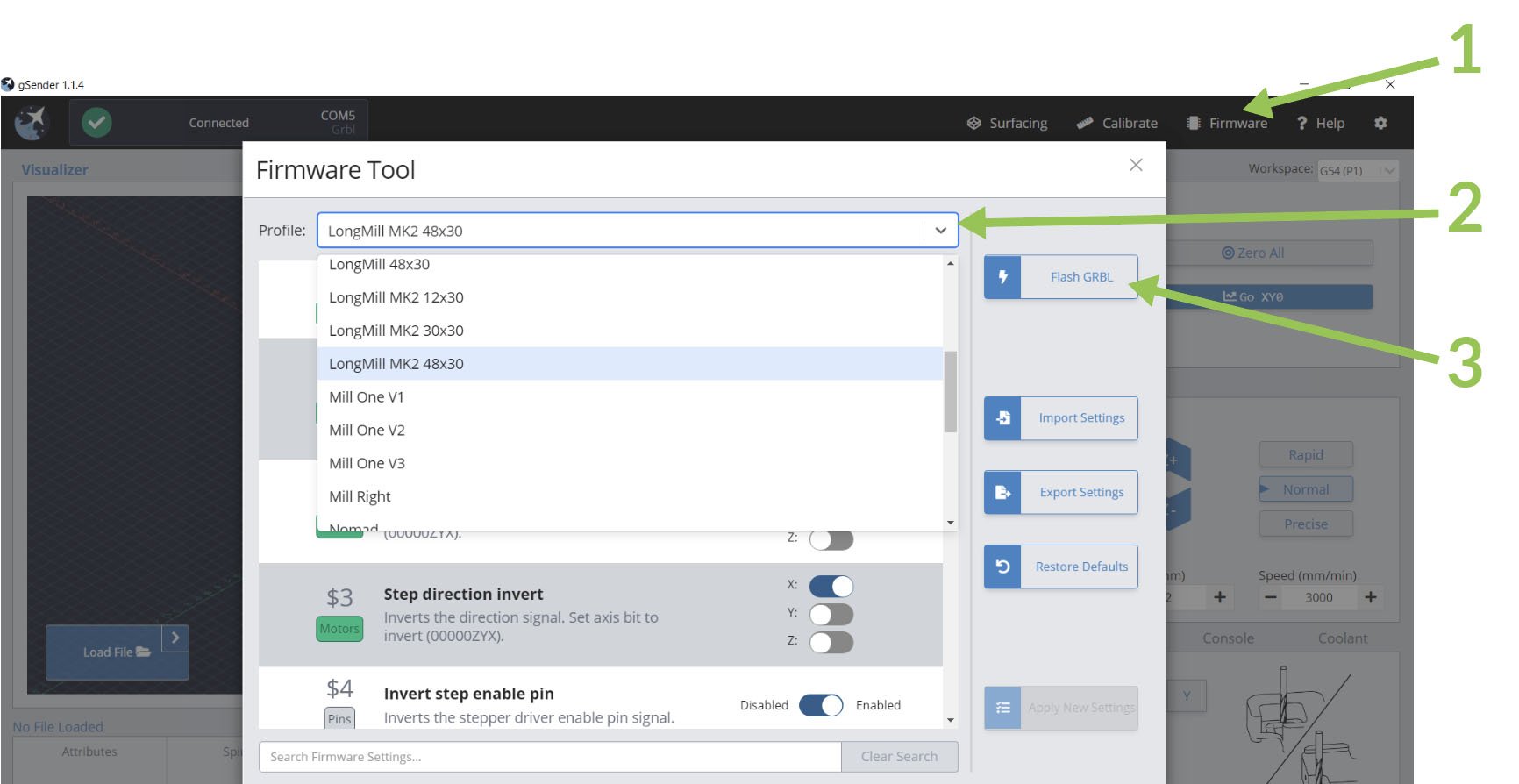

Once you’ve completed the installation, open gSender and connect to your machine. Open the ‘Firmware’ tool and check that you’ve selected your specific CNC in the profiles drop down so that the correct firmware is flashed. Click the “Flash grbl” button to bring up the confirmation prompt.

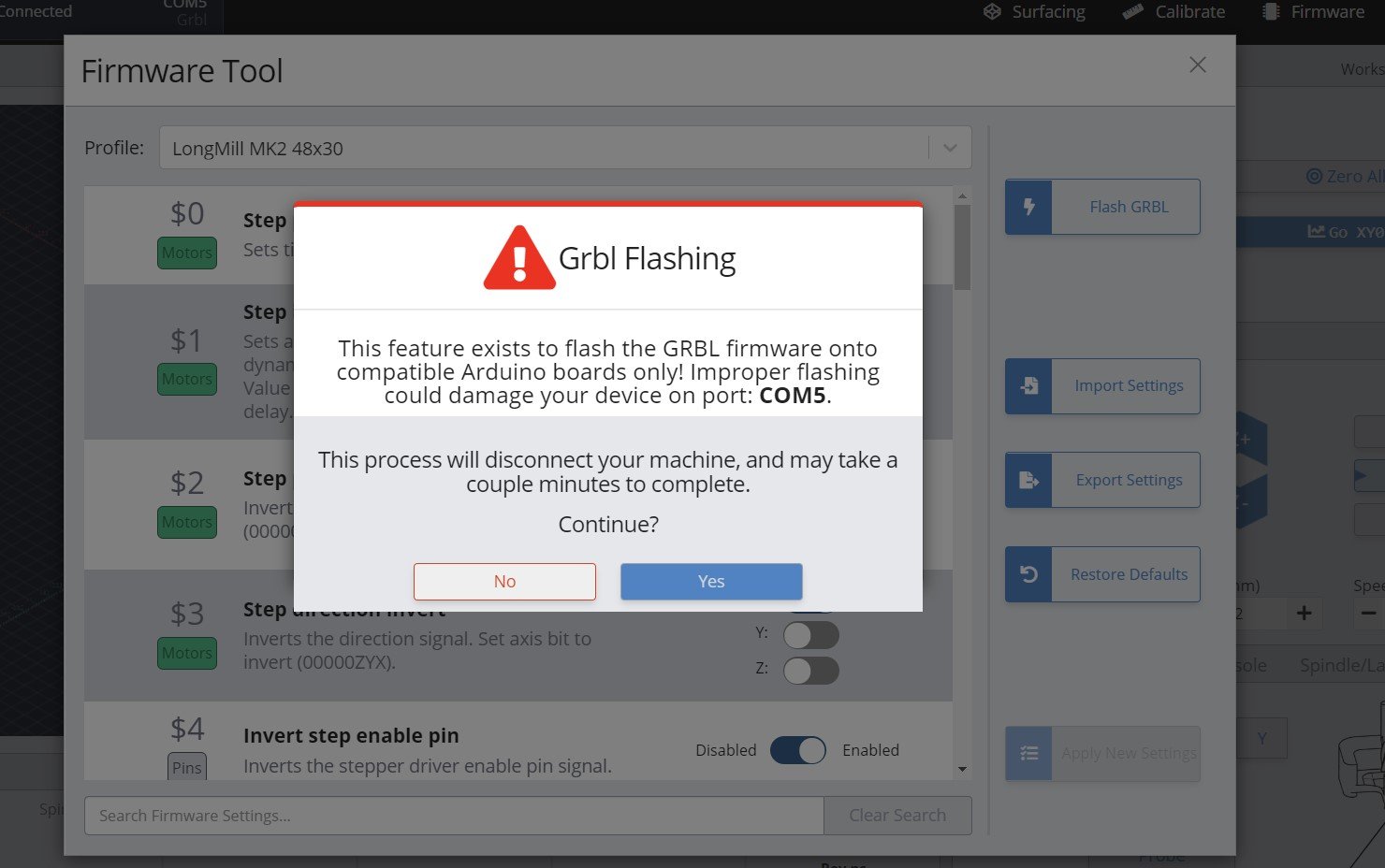

You will see a warning about the risk of flashing the firmware. If you own a LongMill and have not made any modifications to your control board, there is almost no risk in completing this process. Press ‘Yes’ to continue.

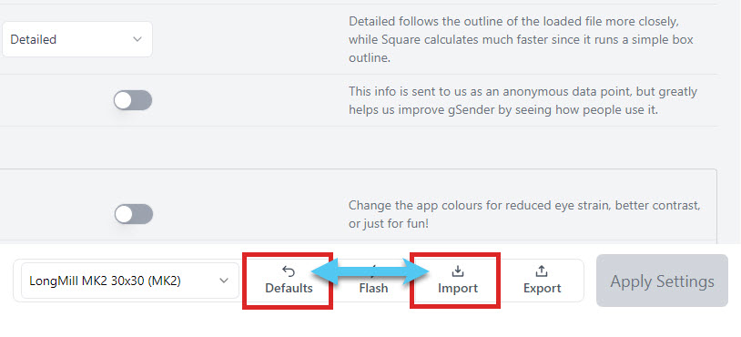

To make sure your machine is properly set up with all the default settings, go back to the Config Tab and press the Defaults button, then click Restore Defaults.
If you previously exported your own custom settings, you can instead click the Import button to load your original settings back onto your machine. Navigate to the Carve Tab, and try jogging to ensure the machine is working properly.
