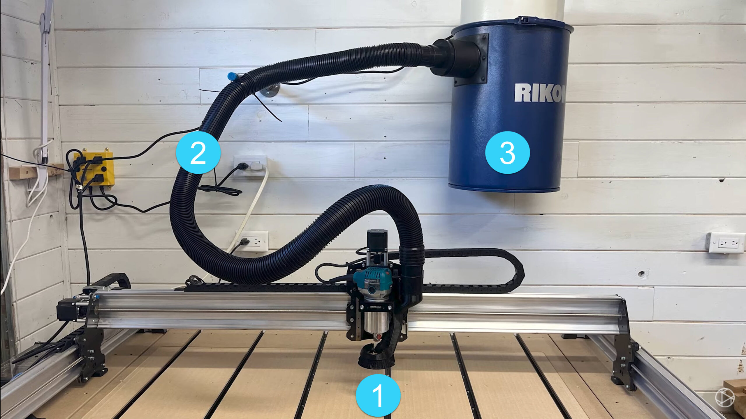

CNCs can create a lot of mess just like many other shop tools. Think about the chips and dust you can create drilling a single hole or cutting a piece of wood in half and then stretch that out over hours of constant cutting on a CNC machine. Not only can this add up to a very large mess, but it’s also not good for your health or your CNC’s health, since important parts can get gummed up with dust over time and impact cutting performance.
This is where a ‘dust collection’ system can help out. CNC dust collection systems are very similar to what you’d normally see in a woodworkers shop. Starting at the cutting head you have a:
- Dust Shoe which tries to contain the dust where the cutting is happening
- Hose that the dust can flow along
- Some type of Vacuum System that creates the suction to carry the dust away from the dust shoe
There are also other options not covered on this page like building an enclosure for your CNC or running it in an open-air environment. These should still be used alongside a dust collection setup, but can be fine short-term to reduce setup complexity.

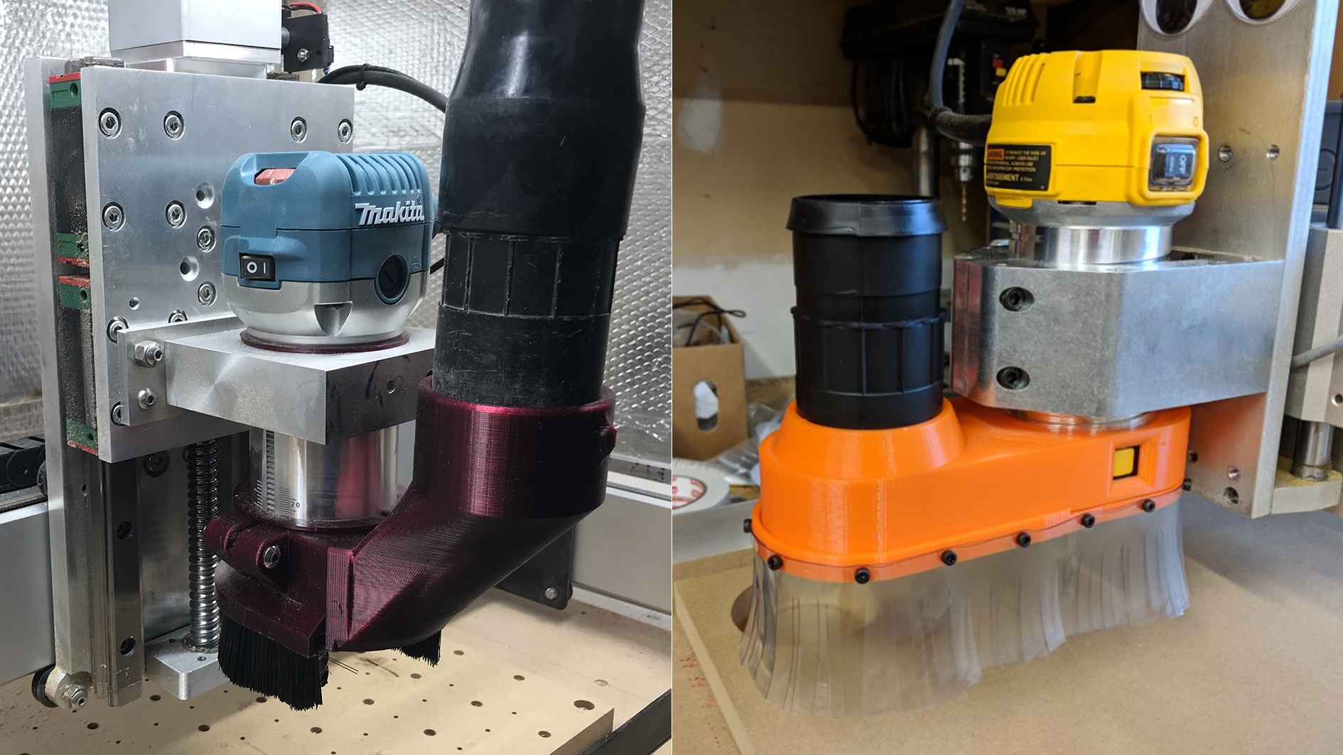

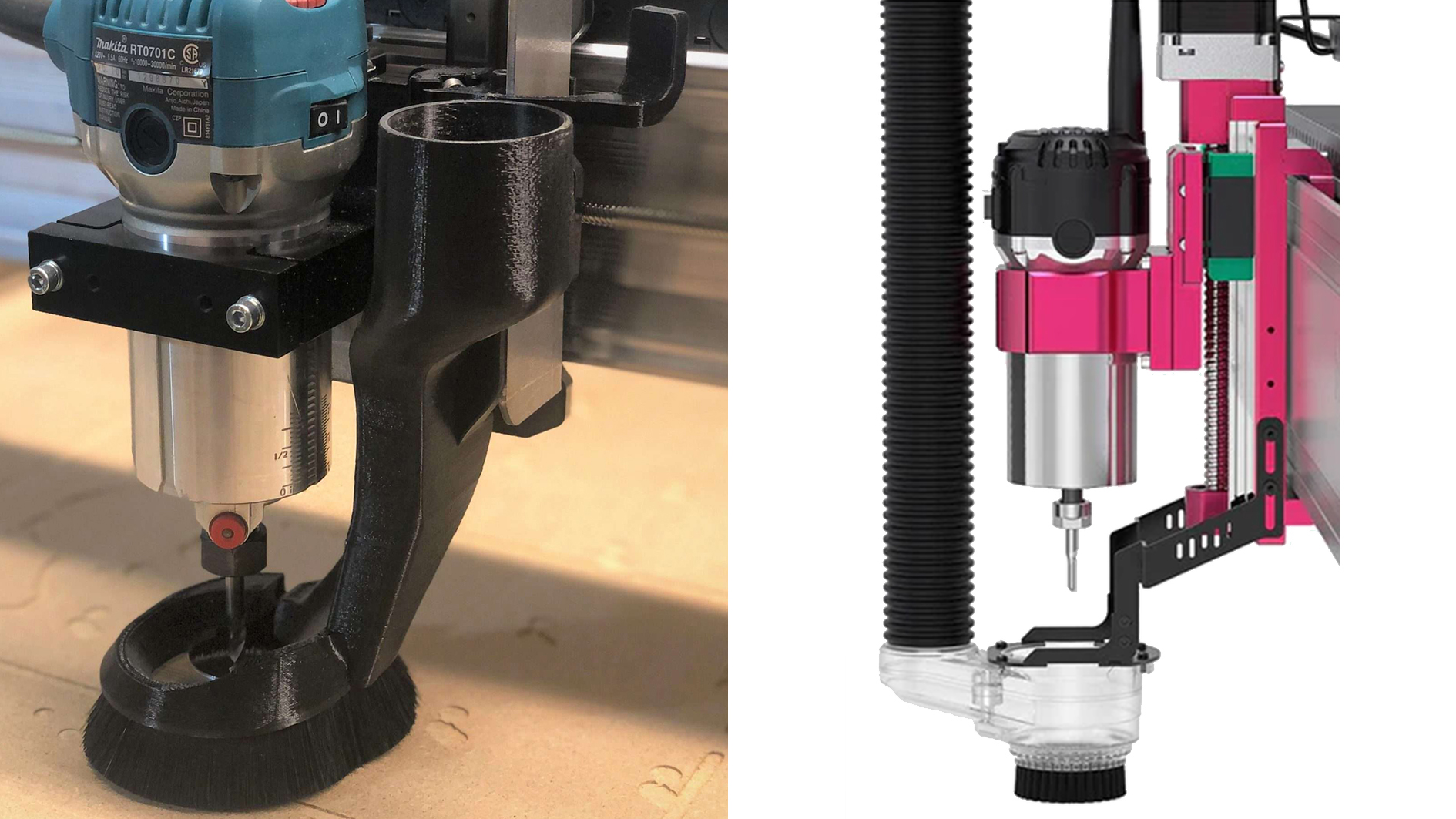

Fixed vs. Adjustable Dust Shoes
The design of your dust shoe can greatly affect how well it collects dust for you particular application. There are hundreds of different designs for dust shoes, however, one of the largest differentiators is whether it is fixed or adjustable. These two styles are also sometimes referred to as Z-axis dependent / bound / tethered vs. Z-axis independent / unbound / free.
Whether a dust shoe is fixed or adjustable depends on how it’s mounted:
- A fixed-style dust shoe is mounted to the Z-axis or the router body on the CNC. This means that when the Z-axis moves up or down during cutting the dust shoe moves up and down with it.
Source – https://community.carbide3d.com/t/hall-of-dust-shoes/7717/20?page=2, https://maniacallabs.com/2019/02/25/CNC-dust-boot-for-dewalt-router/ - An adjustable-style dust shoe is typically mounted to the X-axis of the CNC. This means that it never moves unless you manually change it’s position, allowing the Z-axis to raise and plunge during cutting while the dust shoe stays in the spot you set it. It can be held in place with strong magnets for quick and easy adjustments as in the left image, or secured with a couple bolts as shown in the right image below.
Source – https://www.nymolabs.com/products/CNC-dust-shoe-only-for-nbs-6040-nbx-5040
For general purpose cutting, we recommend using an adjustable dust shoe as it is significantly better at collecting dust and debris, and relies less on how powerful your vacuum system is. It’s also much better suited toward flat or sheet material which is the type of material that’s most commonly used by hobby CNC users for sign-making and v-carving.

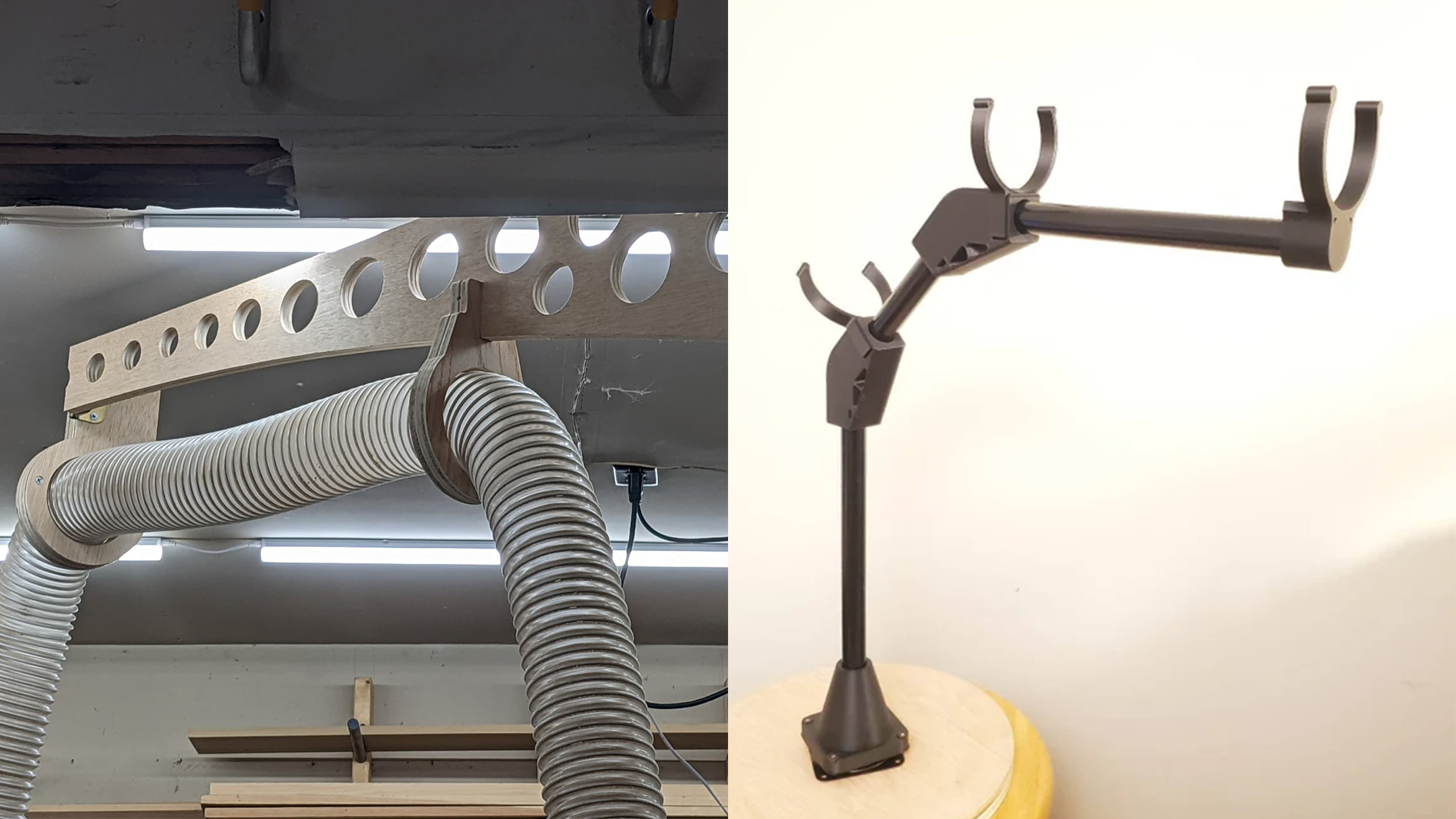

Hanging Your Hose
It’s best practice to have the dust collection hose hang above the dust shoe so that it doesn’t put any pressure on the router or get caught up in your work. You can simply hang it from the ceiling or use a more advanced solution like an articulating arm. Make your own, or grab one from Etsy!

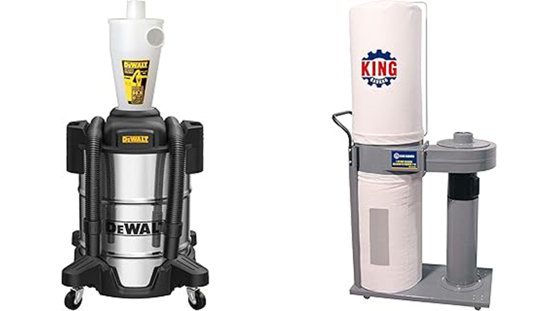

Choosing a Vacuum System
Your dust shoe and hose will need a source of suction. Most times an existing dust collector or Shop-Vac with a cyclone separator will be able to fit the bill since these systems are set up to run for many hours and provide reasonable suction. You may want to check your system’s CFM and suction lift specifications to see if they would work well with your dust shoe and hosing.
1. Shop Vac
A shop vac is a versatile, high-suction device primarily designed to pick up larger particles, such as wood chips, sawdust, and even liquid spills. It is the most common type of dust collection used in the hobby CNC space. With many affordable options available at many large box stores, you can get setup and running right away with a shop vac. You can move it around the CNC or build a dedicated space for it.
| Model | Description | Link |
| WEN VC9209 | 10-Amp 9.25-Gallon 6.5 Peak HP Wet/Dry Shop Vacuum | Buy Here |
| Uline Wet/Dry Vacuum | 10 Gallon, Stainless Steel | Buy Here |
| Rigid Wet/Dry Vacuum | 10 Gallon, 6HP | Buy Here |
| Vacmaster Professional | 8 Gallon, Hepa Filter | Buy Here |
| Hercules | 12 Gallon, Dual Hepa Filter, Noise adjustable | Buy Here |

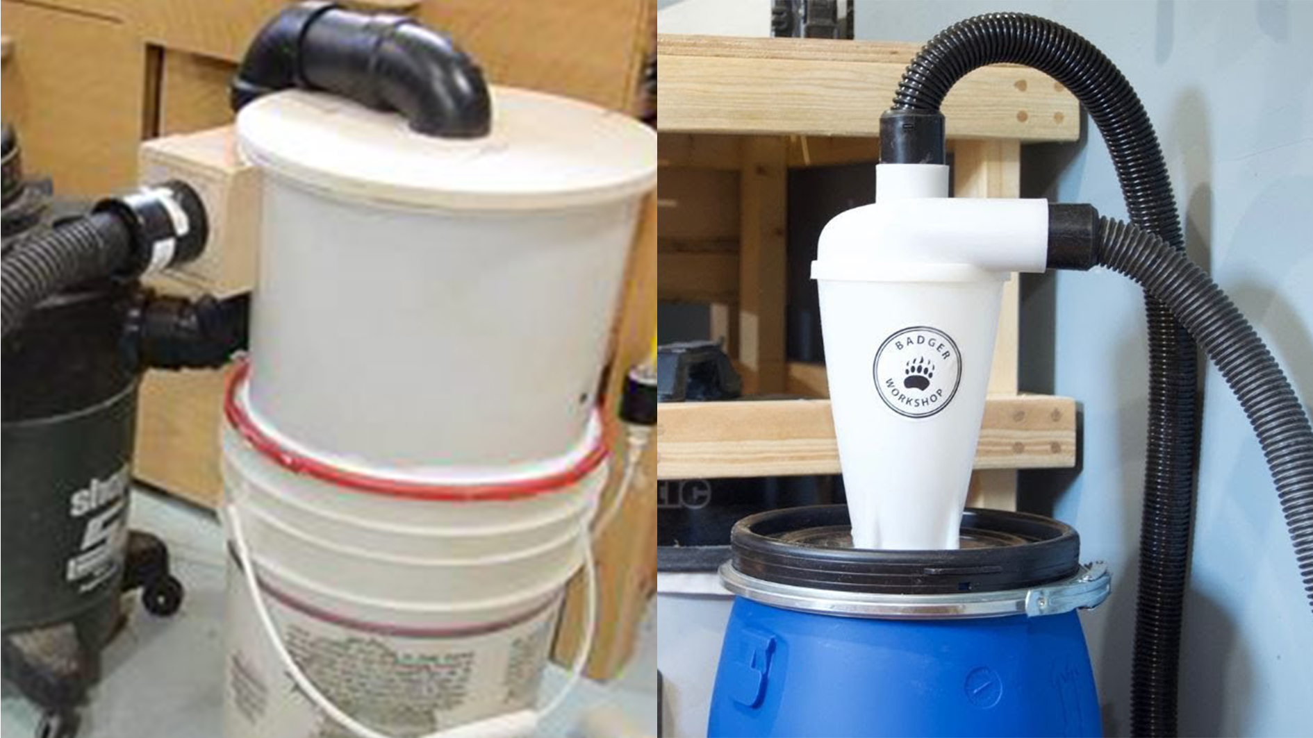

Adding a Cyclone to your shop vac can also drastically reduce the amount of filters your shop vac or dust collection system uses. This ‘second stage’ works by using centrifugal force to separate most dust and debris into a bin below while the lighter, cleaner air is directed upwards, often passing through a secondary filter for finer particles. This process improves efficiency, reduces filter clogging, and extends the lifespan of the dust collection system.
Many users will make their own, or you can purchase a pre-made one.
| Video Title | Duration | Link |
| How do Cyclone Dust Separators Work? | 5 min | Watch Here |
| Adding a Dust Separator to a Shop Vac | 12 min | Watch Here |
| Dust Cyclone Separator Cart | 15 min | Watch Here |
2. Dust Collector
A dust collector is designed to capture greater volumes of dust and wood chips typically generated from large CNCs and woodworking tools. It is a more powerful and specialized system compared to a shop vac. It is often stationary and connected onto multiple tools.
| POWERTEC | 1 HP Dust Collector with 1 Micron Dust Collector Bags | Buy Here |
| WEN | 5.7 AMP 660 CFM Rolling Dust Collector | Buy Here |
| Grizzly G0944 | 1-1/2 HP Wall-Mount Dust Collector with Canister Filter | Buy Here |
| Grizzly G0548ZP | 2 HP Canister Dust Collector w/Aluminum Impeller | Buy Here |
Choosing the System
- Use a Shop Vac if you need portability and versatility for general cleanup or larger wood particles and debris. Most people start here as it is most economical and simple to setup and get going.
- Choose a Dust Collector if you have a dedicated woodworking shop with stationary tools and need continuous dust collection. If you are already a woodworker and have a shop, you may already have one of these.
Features Comparison
| Feature | Shop Vac | Vacuum w/ Cyclone Attachment | Dust Extractor |
| Best For | Small to medium CNCs, shorter jobs, spot cleaning, larger debris | Capturing large volumes of dust and debris before it reaches the filter | Large CNCs, long/large jobs, fine hazardous dust from sanding |
| Suction Power | High suction, lower airflow | Moderate to high suction, depending on base vacuum | Moderate suction and airflow |
| Filtration | Basic or HEPA; limited fine dust capture | Improved dust separation; filters last longer | HEPA filtration for very fine dust |
| Airflow (CFM) | 100-200 CFM | 100-400 CFM (based on vacuum used) | 400-1000 CFM |
| Portability | Portable | Fixed or portable; may require more space | Often fixed, tool-compatible |
| Hose Size | 1.25–2.5 in. | 2–2.5 in. (varies by vacuum) | 4–6 in. |
| Dust Shoe | Compatible with smaller, lightweight shoes | Works well with most CNC dust shoes | Designed for larger, high-capacity dust shoes |
Each of these systems has its strengths, costs, size, and power requirements. Often woodworkers start with a simple shop vac and build up to a combination of shop vac & cyclone or a dust collector system. Add in a dust extractor to your shop, and you’ve created an optimal setup for a safer, cleaner workshop.

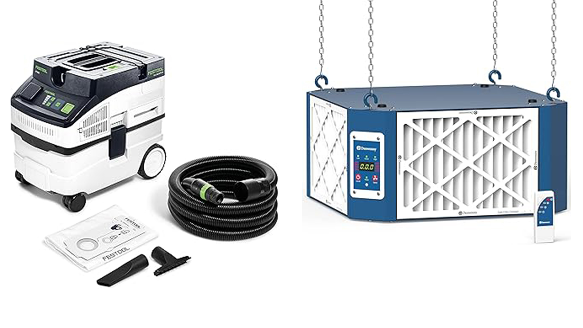

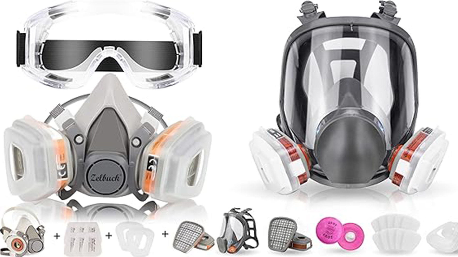

In general, you can protect yourself on 3 basic levels:
- Level One – Prevent dust from entering your body. Your nose and mouth should be covered with a high quality dust mask or respirator with a minimum rating of N95.
- Level Two – Grab the dust at it’s source. Your project should have a good dust collection system, to remove as much dust at the source as possible, before the particles have the chance to become airborne. This type of protection ‘collects’ the dust at the source.
- Level Three – Clean the air. Your workshop can add more protection against those fine particles by using a dust extraction system to catch any particles your dust collector misses. This type of protection ‘extracts’ fine dust particles from the air in your shop.
Regularly cleaning work surfaces, machines, and the floor will also help minimize any dust that could be kicked up by new projects. Working with a door open or an exhaust fan in a well ventilated area is also a great way to reduce your exposure to hazardous fine sawdust materials. We recommend using at least level one and two while operating your CNC.
To investigate more safety guidelines, check out the Important Safety section!
Adding a Dust Extractor
A dust extractor is a specialized type of vacuum designed to capture fine, hazardous dust, often with more precise filtration systems than typical shop vacs. Dust extractors are especially useful for capturing finer particles, such as those from sanding or cutting engineered woods, concrete, or other materials that release smaller, respirable dust.
Note: A dust extraction system is used in your shop, not on your CNC and must be used alongside a dust collection system
- Power and Filtration: Dust extractors typically come with HEPA filtration or very fine filters capable of capturing particles as small as 0.3 microns, which is essential for protecting respiratory health.
- Airflow (CFM): Dust extractors usually have moderate CFM, around 100-200, similar to shop vacs, but the focus is on high-quality filtration rather than raw suction power. Many models also have automatic filter-cleaning features.
- Portability: They are generally portable and compact, making them easy to connect directly to handheld tools (like sanders or circular saws) for on-tool dust collection.
- Best Use: Dust extractors are best suited for capturing fine dust particles from sanding, concrete grinding, or other tasks that create hazardous, respirable dust.
| WEN AF1270 | 4.2-Amp 3-Speed Remote-Controlled Industrial-Strength Air Filtration System | Buy Here |
| Fein 9-20-27 | Turbo Vacuum, 5.8 Gallon, HEPA filter | Buy Here |
