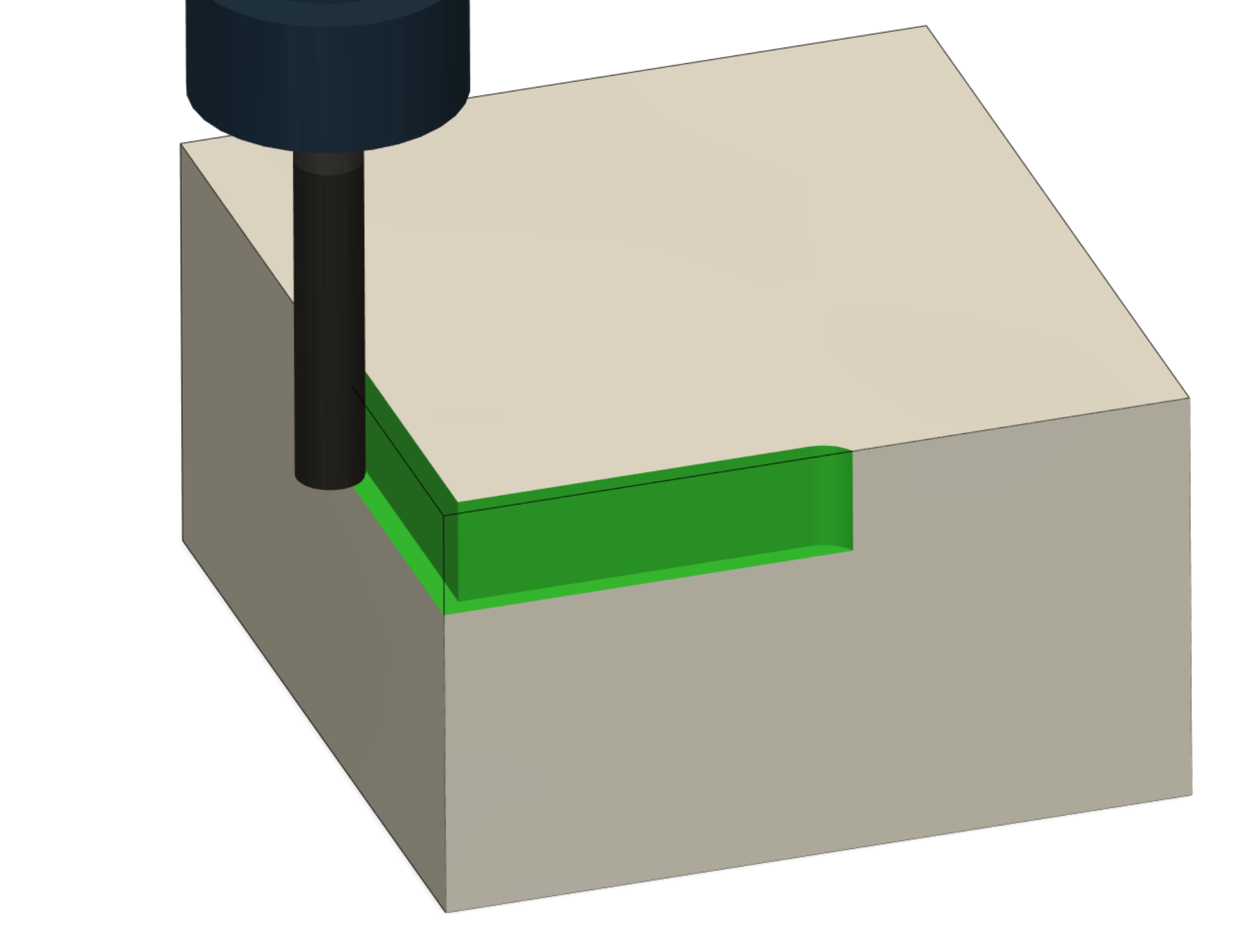

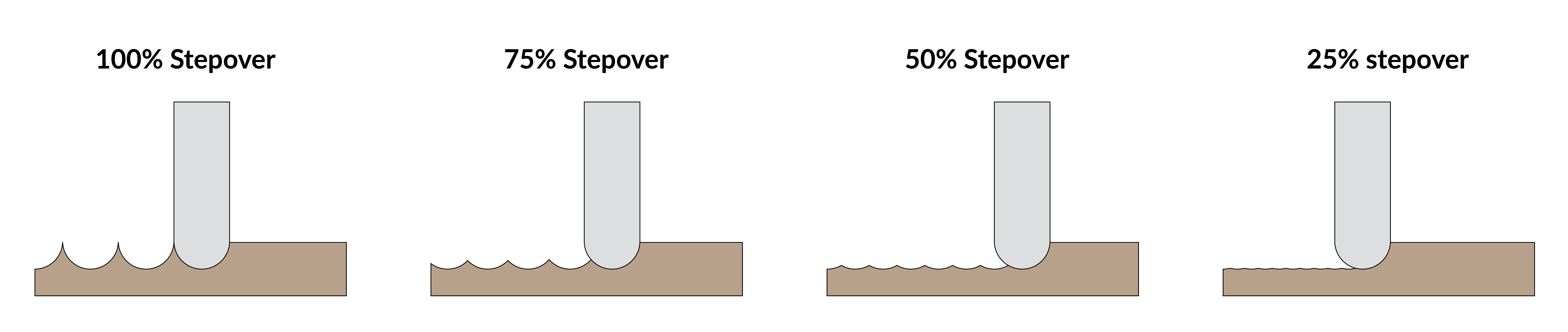

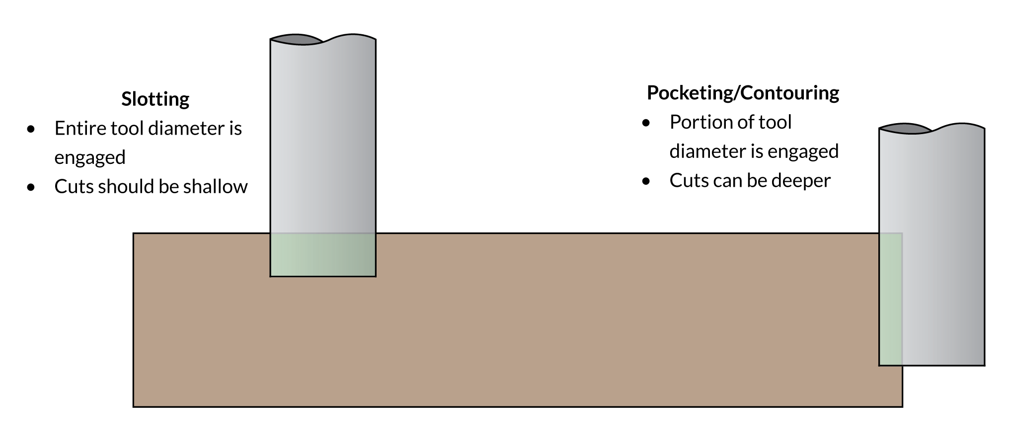

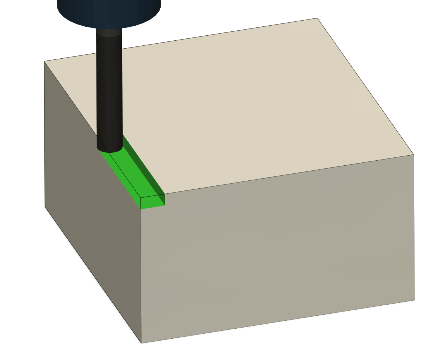

  4. Lastly, you’ll notice that for every tool in the tables the recommended stepdown (a.k.a. depth of cut) is larger for pocketing/contouring and smaller for slotting. This is because:

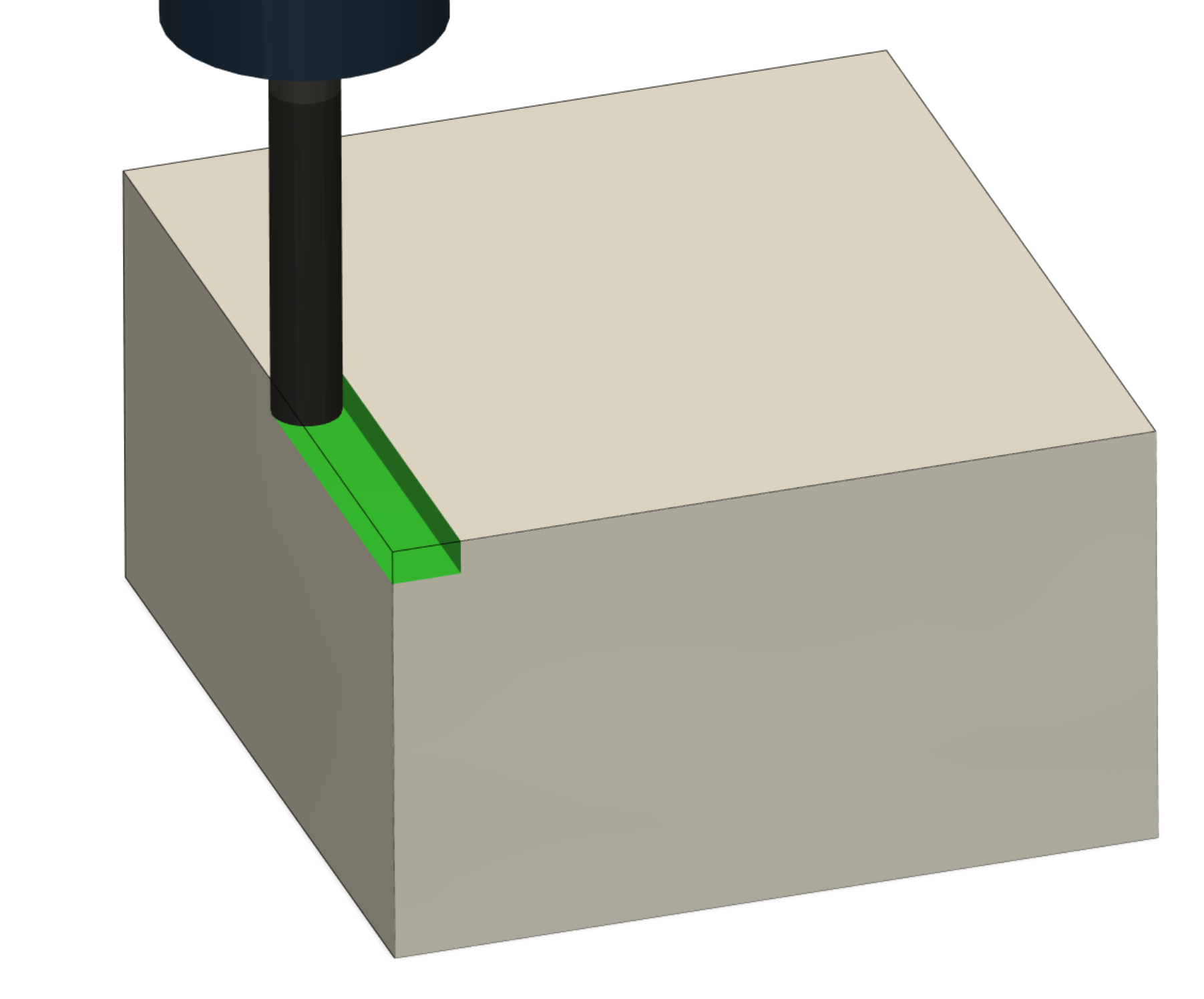

    • Slotting (cutting out shapes, profiles, engraving) cuts with the full tool diameter, putting more stress on the tool and machine, thereby requiring shallower cuts

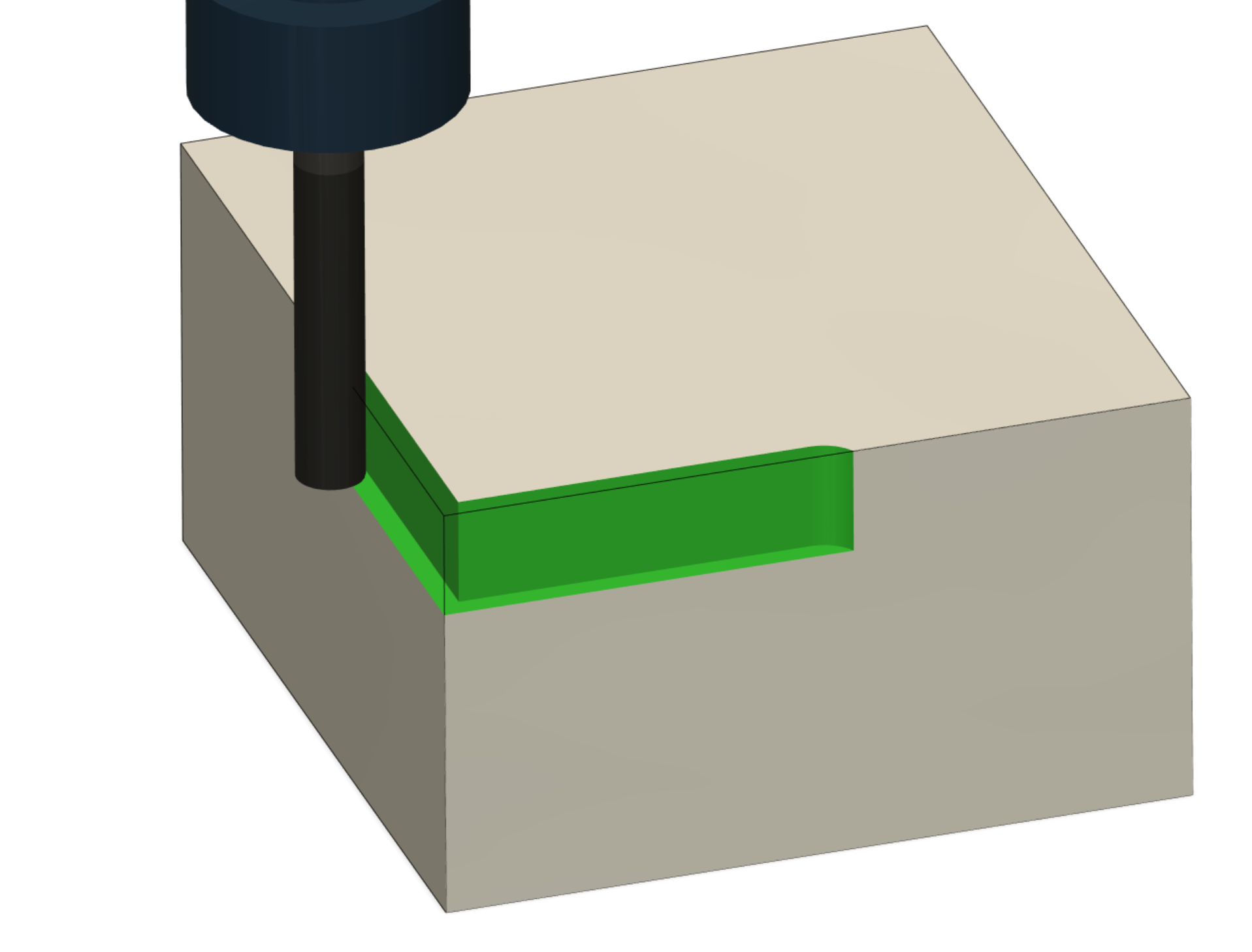

    • Pocketing/contouring (surfacing, cleaning walls, clearing a specified area, 3D carving) cuts with usually less than 50% of the tool allowing deeper cuts

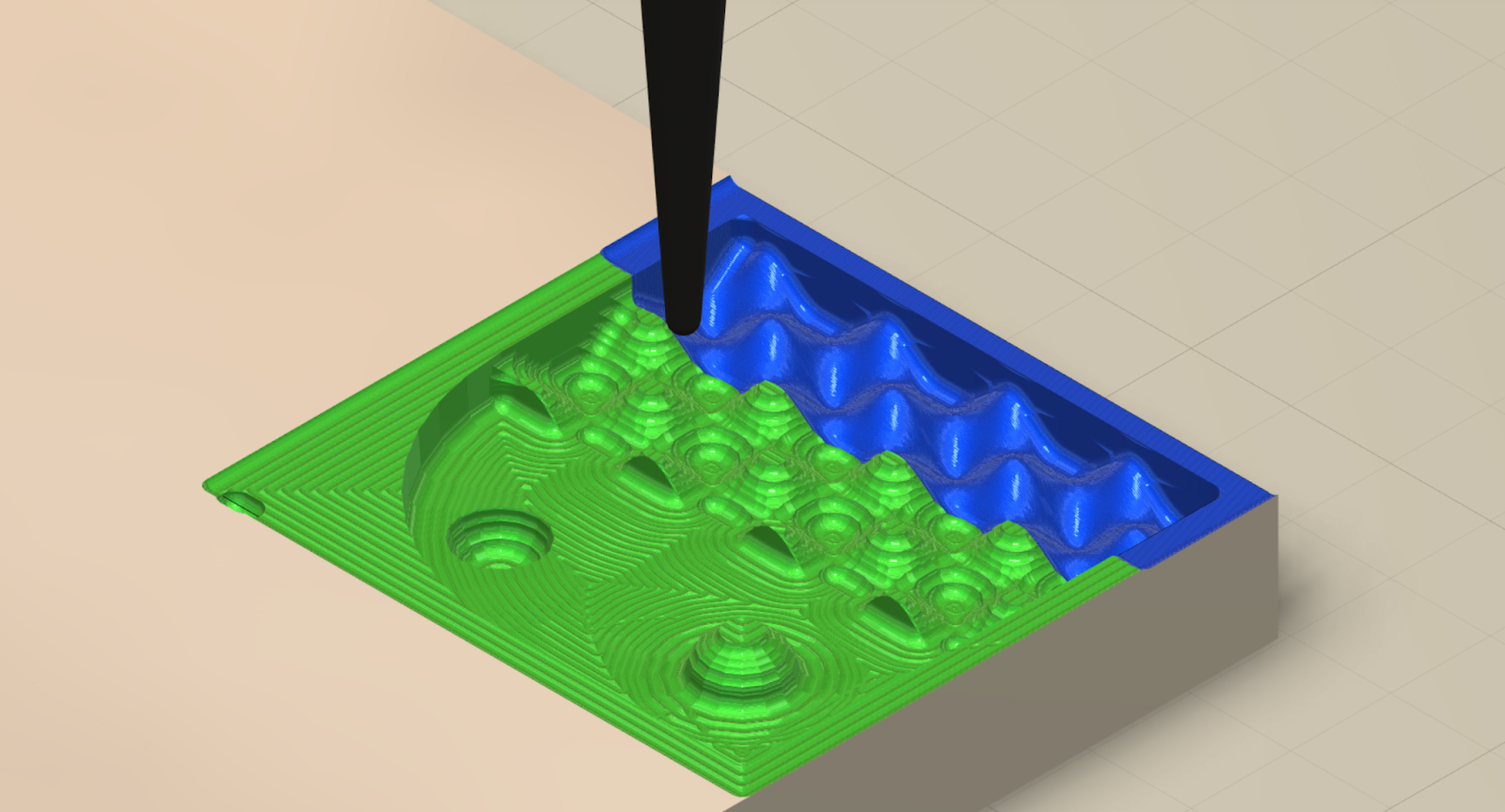

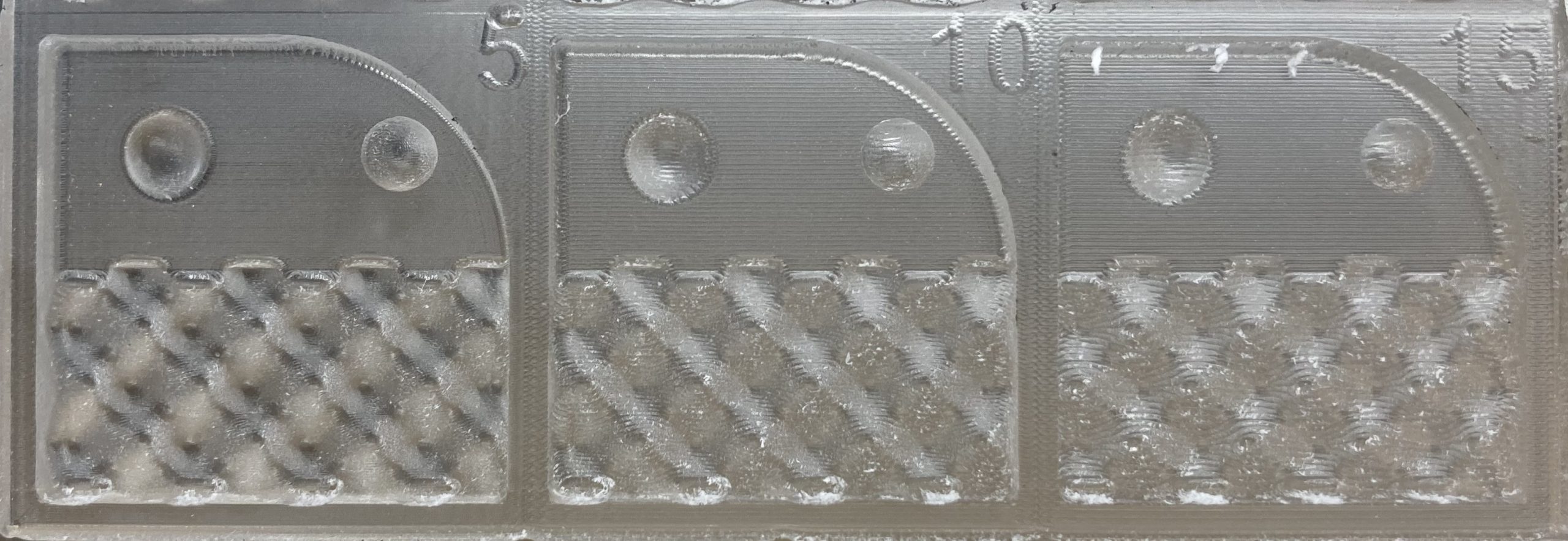

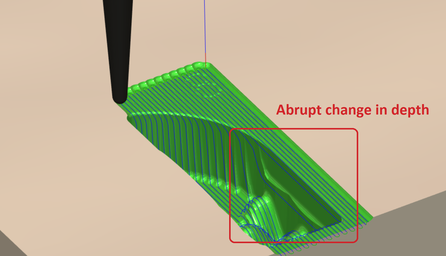

Tips and tricks for engraving or 3D carving these materials are:
  • Soft woods are very easy to cut, we encourage you to engrave as fast as you’re comfortable with to save time
  • You may consider skipping the roughing pass to save time if the deepest part of your engraving is less half the flute length of your tool
  • Many woods can be warped which causes engraving and V-carving details such as text to have inconsistent cutting depth. Surfacing the material before starting your job will help this by giving you a flatter surface to work with

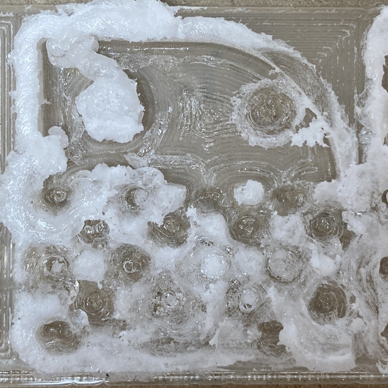

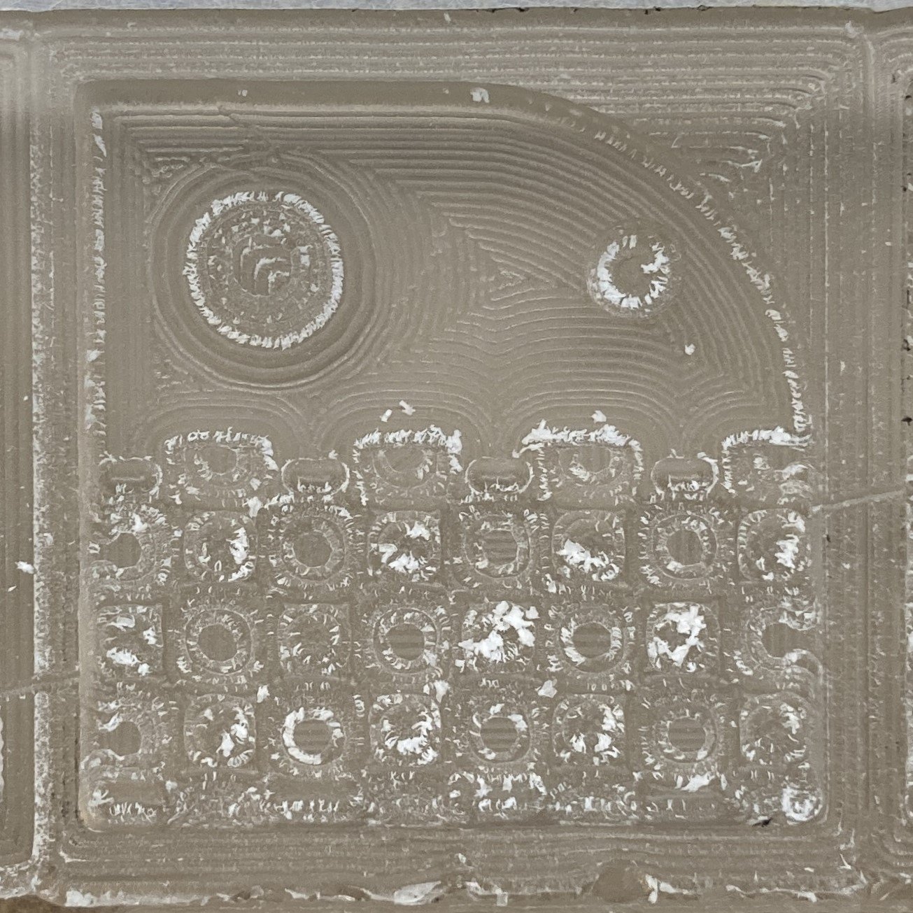

🧴 Plastics (Acrylic, PVC, HDPE, Acetal/Delrin)

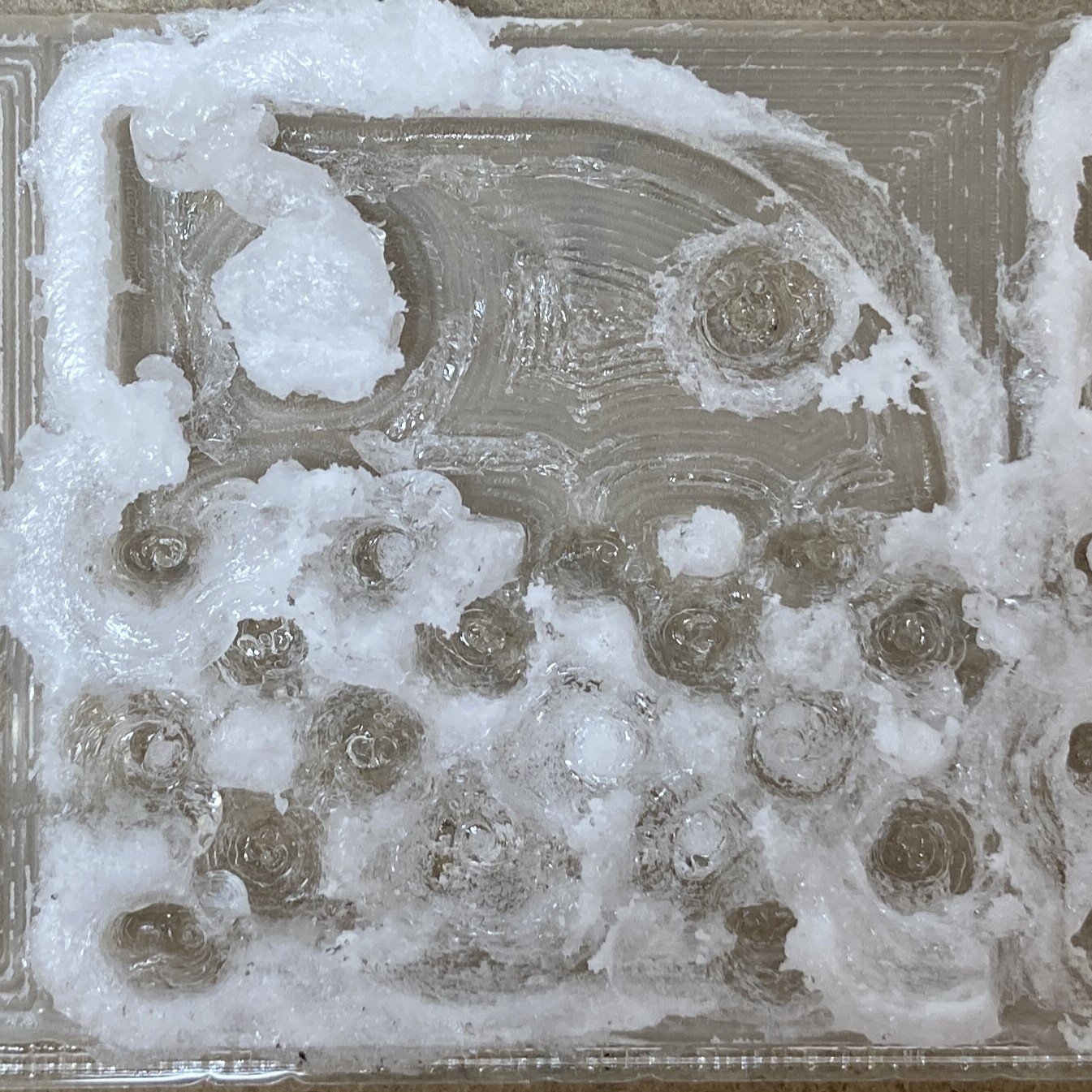

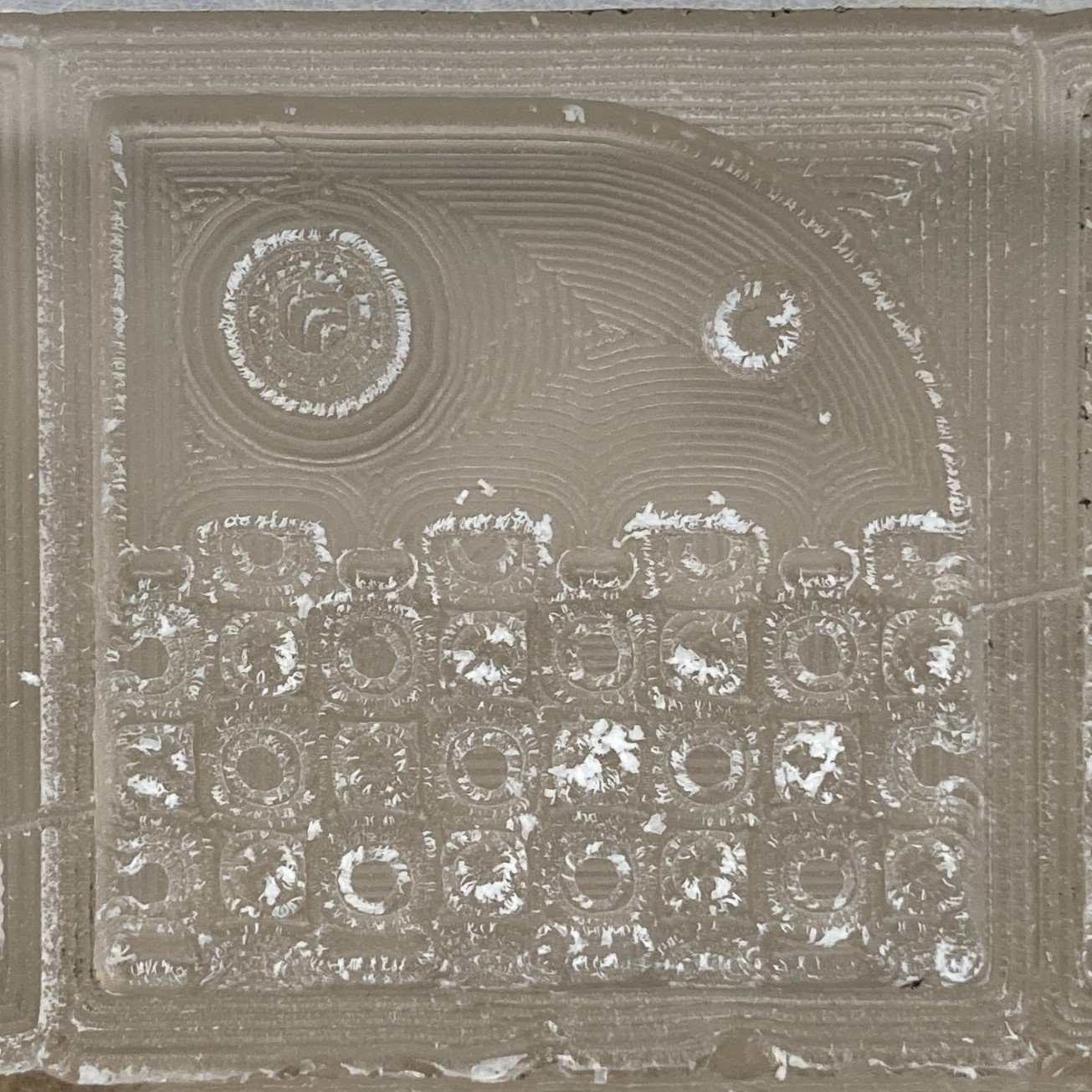

Plastic is a material used everywhere in our modern world with each plastic having unique properties impacting their cutting characteristics and strategy. Some are quite easy to cut like ABS, PVC, HDPE, and Delrin/POM while others like acrylic or polycarbonate can be more moderate in their cutting difficulty, similar to hard woods. Plastics also present the challenge of being more prone to melting and ‘gumming up’ the cutting bit.
For cutting acrylic we highly recommend you use cast acrylic (usually has paper backing) instead of extruded acrylic (plastic backing). Cast acrylic will always have a better surface finish compared to extruded acrylic which is significantly more difficult to cut due to its lower melting temperature.
Machining on extruded (left) vs cast (right) acrylic using the same g-code
General tips and tricks for these materials are:

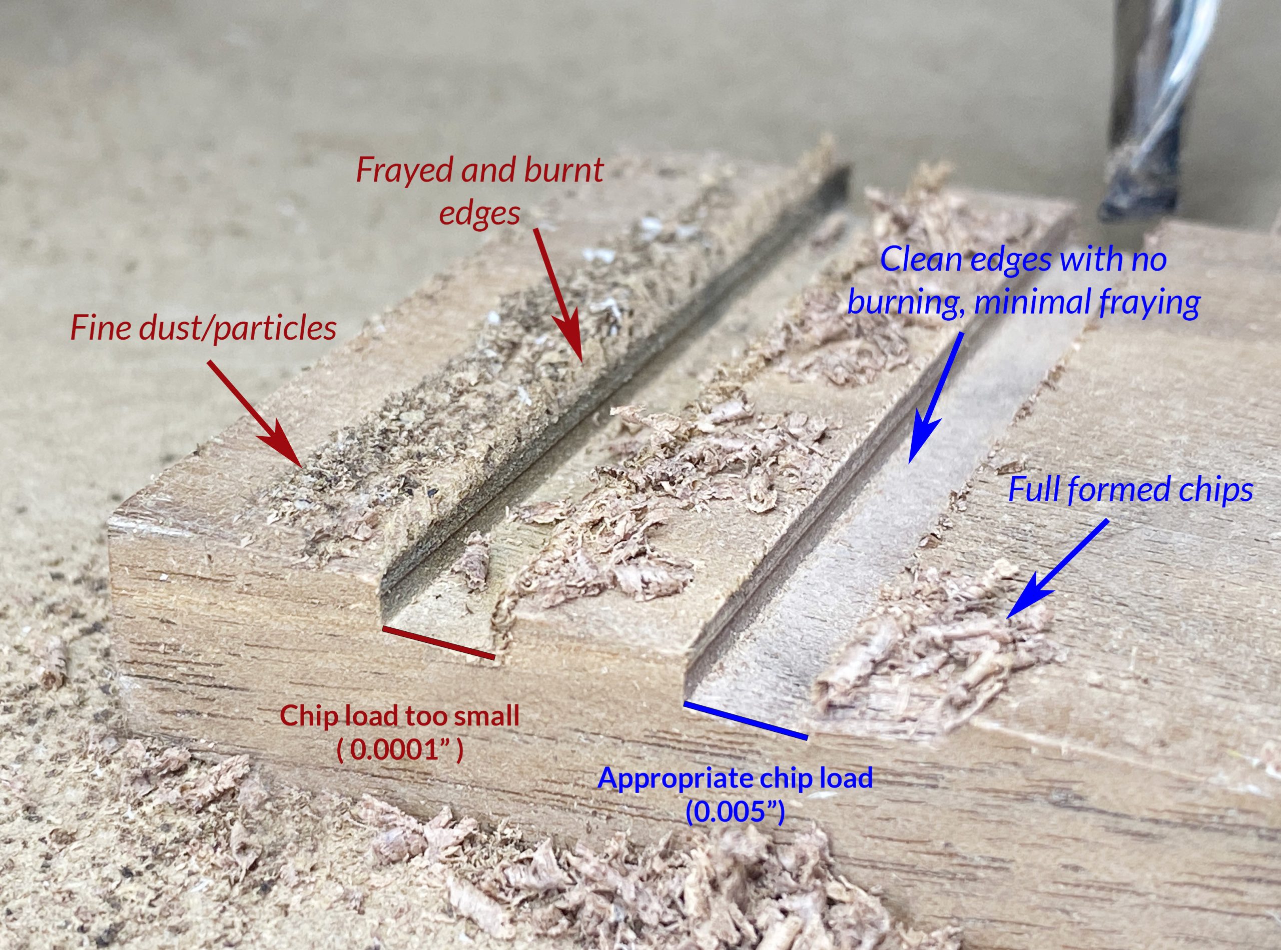

  • A sharp cutter will help give you a nice cut and surface finish, specialized plastic cutting end mills will also give better results
  • To help mitigate melting/gumming with acrylic or polycarbonate it’s advised to use upcut single flute cutting bits running at a low router speed to help clear chips; standard 2 flute end mills should work well for ABS, PVC, HDPE, and Delrin/POM
  • If you find chips sticking to the cutter or melting onto the material, try increasing your feed rate or decreasing the router speed
  • Specifically for acrylic, avoid taking straight plunges into the material since this will typically cause melting or fracture the material
  • Always perform a roughing pass using a flat end mill / tapered ball end mill (with the roughing settings below) with a 0.15-0.3mm stock to leave setting before performing the finishing pass. This will dramatically improve the surface finish of your engraving and reduce the chance of melting
  • If melting is still observed for acrylic, try decreasing the feed rate (this goes against the general tips we have for plastics but slowing down the rate at which material is removed is the most reliable way we’ve found to prevent melting)

Chip Load ✂️
Chip load describes the size of each individual chip that is being cut by a single edge of your cutting bit.
This is a very sensitive parameter. If too small, the chips reduce in size to become dust which will wear out the bit and heat up causing burning. If too large, the chips become larger which results in the cutting bit being overloaded and unable to clear the chip out of the cut. The effects of chip load on cut quality can be seen below.
Two cuts with different chip load produce very different results
To calculate chip load there’s a simple formula shown below. Since we usually know the number of flutes our cutting bit of choice has, we can modify either feed rate or router speed/RPM to reach the chip load we want. In some cases the speed of the router might not be fast or slow enough to reach the desired chip load so we could change the cutting bit to have more or less flutes to accommodate that. Another approach would be to change the diameter of the bit, thus calling for a different chip load and making it more feasible for the router speed or feed rate you have available.
Chip Load  = ( Feed Rate ) / ( Router Speed x # Flutes )
For example, if we’d like a chip load of 0.0031”, we can run a 2 flute end mill at a speed of 17000 rpm and feed rate of 105.4 inches/min (2677.16 mm/min) to achieve this.
Chip Load  = 0.0031" = ( 105.4 ipm ) / ( 17,000 RPM x 2 Flutes)

Material removal rate asks the question “how deep can I cut?” Now that we have our targeted chip load and calculated feed rate and router speed we can move onto figuring out the last pieces of the puzzle: depth of cut and stepover.
Naturally we can assume that the more material we cut in a given time, the more strain is placed on the machine and router. If we can quantify how much material is getting removed in a given amount of time, we can aim to keep this within a reasonable amount – this is what the material removal rate metric does. The standard units for material removal rate are in volume per minute – either inch3/min or cm3/min.
Shown below, the formula for material removal rate depends on feed rate, cutting width, and cutting depth. Cutting width will depend on whether you’re slotting (cutting out pieces of things, cutting lines and shapes, etc.) or pocketing (making large holes, cutting out pockets, bowls, etc.) since the full width/diameter of the cutting bit will either be fully engaged (slotting) or partially engaged (pocketing).
Material Removal Rate  = Feed Rate x Cutting Width x Cutting Depth
For slotting the cutting width will be fully engaged, meaning our cutting width or width of cut (WOC) will be equal to the tool diameter (ie. WOC = 0.25” if using a ¼” bit).
For pocketing our tool will only move over by some distance between passes, typically this distance should be about ~45% of the width of the cutting bit (ie. WOC = 0.25” x 45%=0.1125” if using a ¼” bit).
The illustrations below show the use of a tool in a high depth of cut, low width of cut scenario (left), as well as low depth of cut, high width of cut scenario (right). With the feed rate constant between these two cuts, they’ll both be removing the exact same amount of material in the same amount of time.
Since we know our desired feed rate (from our chip load calculation) and cutting width (depending on the cutting operation), we can calculate what our cutting depth should be if we’d like to keep our material removal rate below some reasonable amount. At this point, we’ve now gotten all of our cutting parameters necessary for setting up a cutting operation.

The first constraint to pay attention to is cutting width/stepover. This is a variable that we can typically change to control the rate of material removal but in 3D carving it’s directly tied to surface finish and is typically a small number (~5-15% depending on the size of the bit).
Acrylic carving with 5, 10, and 15% stepover (left to right)
When a ball end mill carves in several straight, parallel passes it leaves behind small amounts of material in the form of ridges – these are known as ‘cusps’. These cusps are the reason for the increase in detail/resolution with a lower stepover; as shown in the photo below, a larger stepover means larger cusps, while a smaller stepover means the cusps continue getting smaller until they’re imperceptible to the human eye. Obviously, with lower stepover, this means a greater number of passes, and a much longer total project time. You’ll need to decide how much detail you need, and how long you’re willing to run the project for. For example, for carving a 2″x2″ relief, you’ll probably want to use a low stepover amount such as 5-8% since this project won’t take more than an hour. If you we’re carving something much larger, you might want to set your stepover much larger and forego finer detail for a faster overall project time.
Cutting depth is the next variable to consider and in relief carving this is again something that you do not have much control over. This is because the tool will need to follow the contours of your 3D model which can vary considerably in depth.
Abrupt changes in depth / carving deep reliefs will increase tool load
The implications of the two constraints above are that tools will tend to be underutilized (removing too little material) on the shallow parts of the relief and struggle on the deeper / steeper parts (removing too much material). For wood based materials, you’re less likely to exceed the tool’s material removal capabilities on even the deepest parts of your relief without running into other constraints in your machine such as feed rate. On harder materials such as acrylic / aluminum however the spikes in material removal is a much bigger concern and is why roughing (with a very shallow depth of cut and minimal stock to leave) is a prerequisite for success.
Keeping tool load in check with separate roughing and finishing passes
