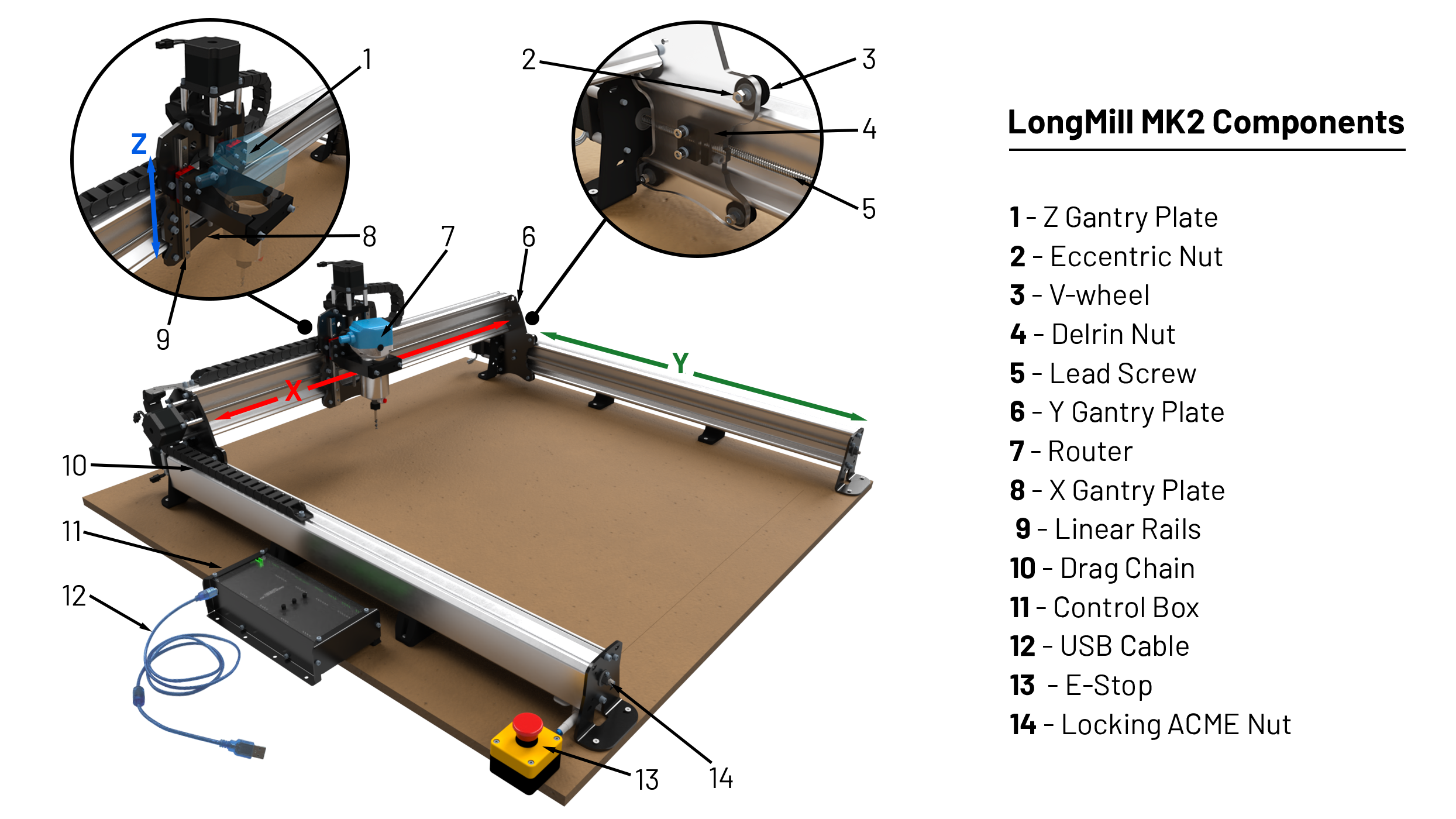

Anatomy
The MK2 is a 3-axis CNC that comes in two sizes. Each axis is lead screw driven to increase rigidity and maintain great accuracy in the X-axis (cutting left-to-right), Y-axis (forward and backward), and Z-axis (up and down, cutting into the material).
12x30
Machine Size (WxDxH): 1130 x 591 x 424 mm (44.5 x 23.3 x 16.72″)
Cutting Area (WxDxH): 820 x 358 x 114 mm (32.3 x 14.1 x 4.5″)
Recommended table size (WxDxH): 2’x4′
30x30
Machine Size (WxDxH): 1130 x 836 x 424 mm (44.5 x 42.9 x 16.7 “)
Cutting Area (WxDxH): 820 x 872 x 114 mm (32.3 x 34.2 x 4.5″)
Recommended table size (WxDxH): 4’x4′
48x30
Machine Size (WxDxH): 1603 x 836 x 424 mm (63.1 x 42.9 x 16.7 “)
Cutting Area (WxDxH): 1280 x 872 x 114 mm (50.4 x 34.2 x 4.5″)
Recommended table size (WxDxH): 6’x4′
Outside of the mechanics of the MK2, the general remaining systems to keep in mind are its:
- Control Box: handles motor movements and other I/O so needs to be kept near the machine as well as accepts incoming power from a power supply and USB signals from a control computer so should be kept near to those as well
- E-stop: the safety and power switch so keep it in an accessible location to ensure it’s easy to press in an emergency
- Drag chains & wires: handle all the important power and data transmission so should be given space for proper routing, movement, and strain relief to avoid fraying or cause erratic machine behaviour
