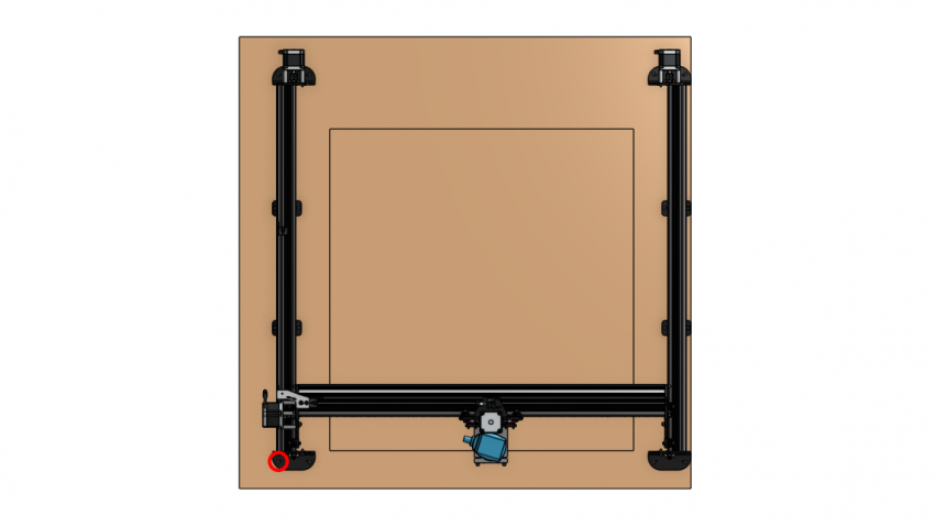

First we’ll be mounting the whole right-side of the machine into place. Each foot has two primary holes for mounting (red circles) and the steel end feet have a backup set (orange circles) built-in to allow you to make adjustments in case you find that you made a mistake later on.
Start with the steel end feet using 2 screws per foot and ensuring they’re aligned to where you want your machine to be. If you’d like to pre-drill the holes to avoid shifting around that’s an option as well.
Next screw in the middle feet on the right side. Don’t ream down as hard on the plastic feet as you did on the steel ones.
At this point the right side of your machine will be fully secure. When mounting the left side, we’ll want to ensure it’s mounted parallel to the right side and also that the back feet are aligned to each other. You can see in the diagram below why mounting the rails both parallel and in-line is important to ensure the CNC isn’t overly stressed and also cuts how you expect it to.
Checking for ‘squareness’ can happen many different ways depending on your tools at hand. For example, if your right side was attached 90° to your table front, then make another 90° mark for the left side to reference using a straight edge and a carpenter’s square. If you have a friend to help you, the steel end feet also have a small notch built-in that can allow you to run a measuring tape under the X-rail from the top left to bottom right foot and top right to bottom left foot. Adjust the left side until these two measurements are equal and that’ll ensure your machine is mounted square.
A third option is to use the ‘XY Squaring’ tool that’s built into gSender. This tool is probably too fancy for most people but it’s one of the most accurate ways to check the squaring on your machine. You can read how to use it here if you’re interested and then come back to continue assembling once you’re done: https://resources.sienci.com/view/gs-additional-features/#xy-squaring
Once you feel confident in the foot placement, drive the first screw into place on the front left foot:
Then jog your machine to the rear and drive in another screw on the back left foot:
Now double-check that everything is looking correctly aligned before completing the mounting. At this point if there seems to be an issue don’t sweat it, the second set of holes on the steel end feet will allow you to make small changes in how the machine is mounted. Once you’re happy, jog the CNC roughly to the middle and finish securing the remaining foot holes:
Followed by the second screw for each foot. Once complete, Congrats! Your machine should now be fully secure and square to its mounting surface.
