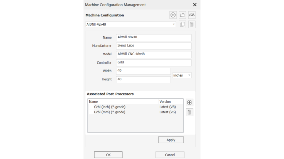

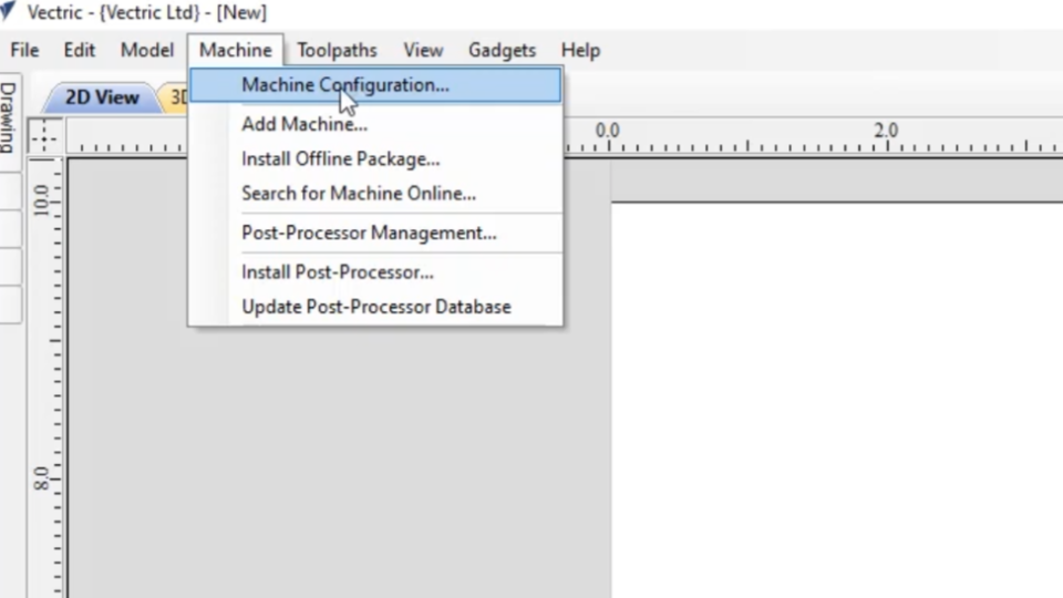

Vectric VCarve
If you are using Vectric VCarve, you can create a custom machine configuration file for your AltMill. Go to Machine, and in the drop down select Machine Configuration.
Please refer to the image below to fill out the configuration. For the latest version of VCarve, please input all the AltMill accelerations as 1500 mm/s².
