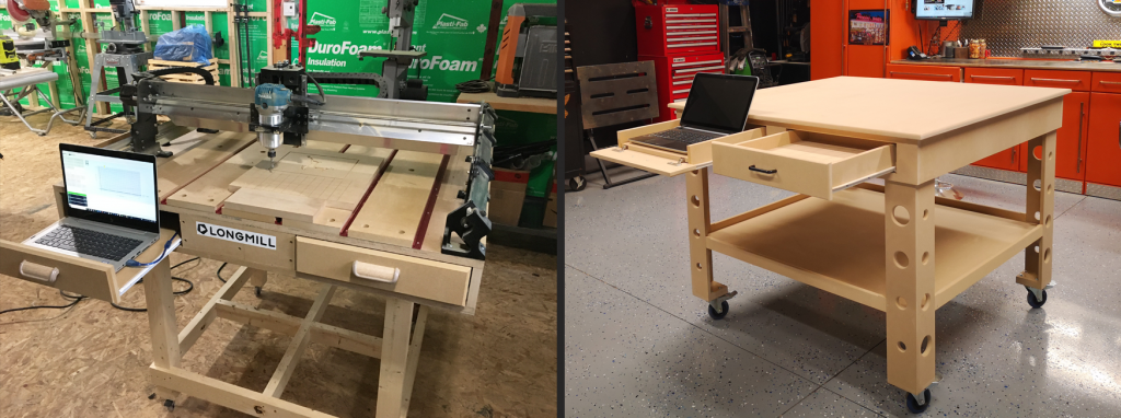

Drawer Storage
Another widespread concept is the idea to add pull-out drawers to the underside of the table in order to act as storage for the control box, a tethered laptop, or any of the dedicated tools or cutting bits used for the LongMill. The designs shown were done by Derek and Robert respectively:
Original posts:
- https://forum.sienci.com/t/what-are-your-plans-for-a-table/95/18
- https://forum.sienci.com/t/what-are-your-plans-for-a-table/95/63
Similar posts:
- https://forum.sienci.com/t/waste-board-with-t-slots/225/2
- https://www.facebook.com/groups/mill.one/permalink/900949107043088/

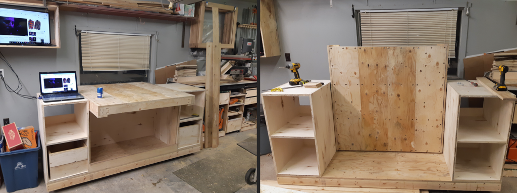

End Grain Cutout (Greg)
Greg had been commissioned some work and realized how beneficial it would be to orient any given board stock vertically so that he’d be able to machine the end grain. This especially comes in handy when using the LongMill to create CNC joinery. He modified his existing table to have a cutout portion for attaching boards, while maintaining the remaining surface for normal cutting (as he explains in his post):
Original post: https://forum.sienci.com/t/modification-for-end-of-board-machining-end-grain/235
Pivoting Table (Kris)
Kris never mentioned much about his design, however it’s really well laid out to orient the LongMill horizontally when attaching stock material or running the machine, while enabling him to rotate everything out of the way so that he can have more space to work in his shop when he needs it. The additional shelving is also useful for added storage and to act as an additional work surface:
Original post: https://forum.sienci.com/t/what-are-your-plans-for-a-table/95/49
