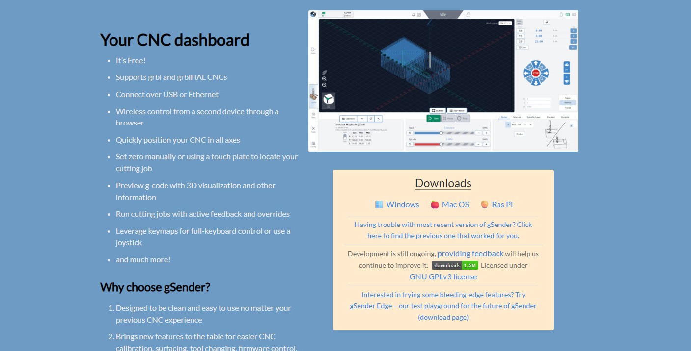

To manipulate your LongMill and send it files, you’ll need a g-code sender which acts as the control software. We recommend using gSender, which is what we’ll be using to show the next couple of steps and in the remaining part of the assembly.
gSender works with any operating system: Windows / PC , Mac, Linux, and more. If you are not sure which type of Windows you are using, you are most likely using a 64 bit computer. You can try both and see which one starts.
You can download gSender here: https://sienci.com/gsender/ Choose the download for you, and if you get stuck you can always reference here for more help: https://resources.sienci.com/view/gs-installation/

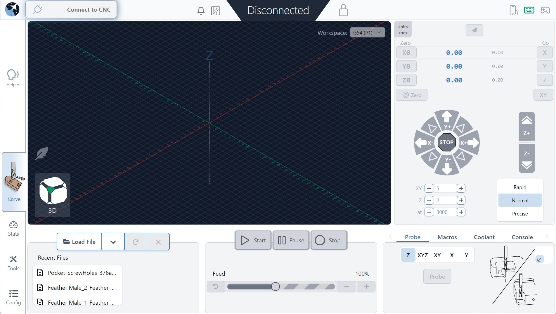

You should be greeted with a screen that looks like this. It can take several extra seconds to load if you have Microsoft real time virus protection on your computer. This scan delay should only happen the first time you turn on your computer.

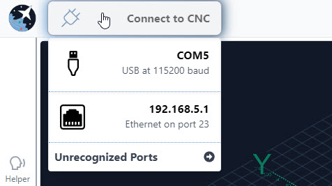

Once that is done, hover over the Connect to CNC button at the top left corner of the screen and click the first option. Sometimes there’s more than one port available, so you can either unplug the other items you have plugged in, or you can try connecting to each one to see which one is your LongMill (note that it’s recommended to connect this way on your first setup even if you’re planning to use Ethernet in the long-run).

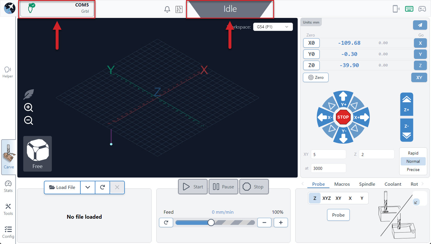

Once you’ve selected the port, your machine should be connected. If your machine is powered on, you will usually hear a gentle hiss and a thump noise when the machine connects which is a nice audible confirmation. If you don’t hear that sound, make sure you have released the E-stop so power is going to your machine – indicated by and orange power light on your control box.
After a moment you should see the plug icon turn green with a checkmark, the status bar at the top, middle change from Disconnected to Idle, and all the controls in the app become coloured indicating that they’re ready to be used.

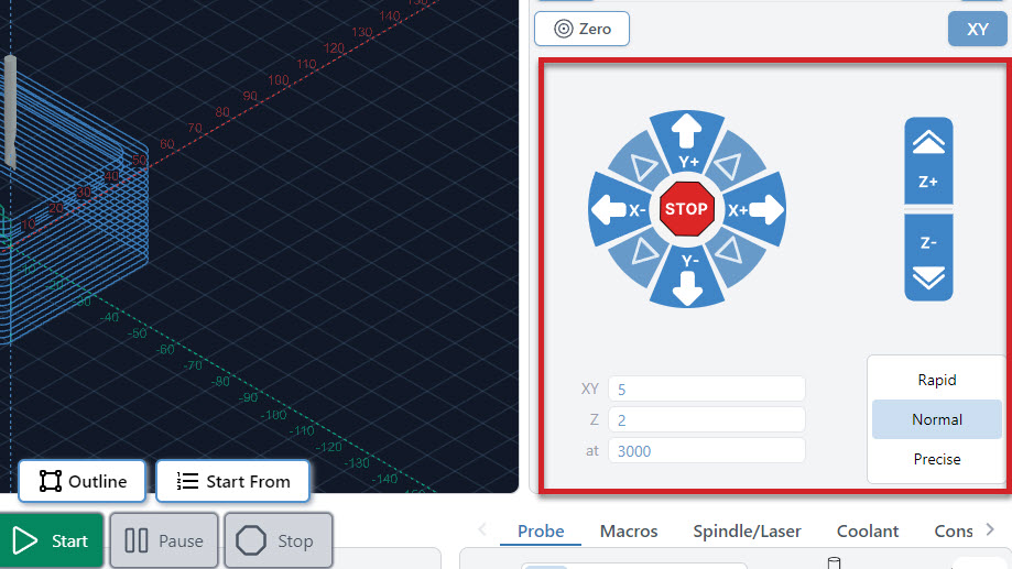

You can now try playing around with moving the machine. You can jog the machine in the direction you want within the “Jog Control” section on the right side. It’s alive!
You can choose the amount that the machine will move in the XY directions by changing the “XY move”, the amount in the Z direction with “Z move”, and the feed rate / speed of movement with “Speed.” gSender has defaults for large, medium, and small movements that you can switch between by pressing the “Rapid”, “Normal”, and “Precise” buttons.
Also, if you prefer inches instead of millimeters you can also switch over using the gear icon on the top right of the gSender window.
