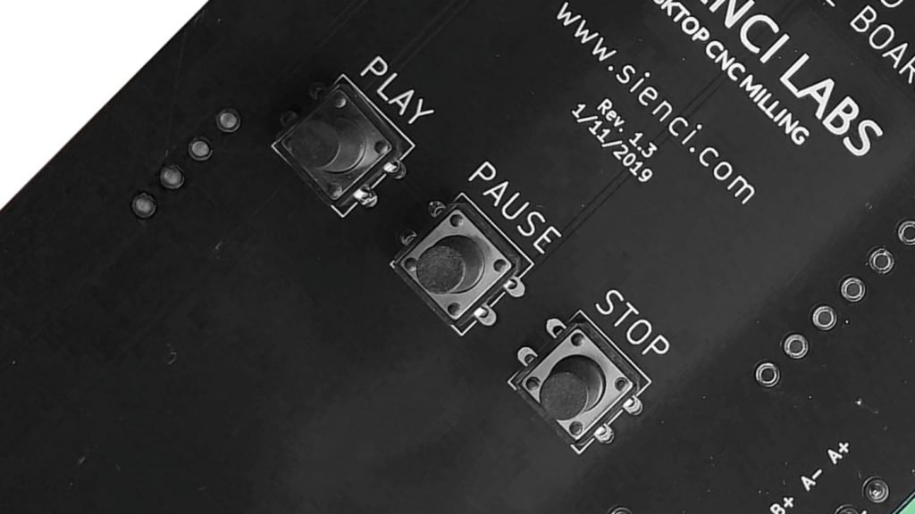

You can check the version of your LongBoard on top of your control box.

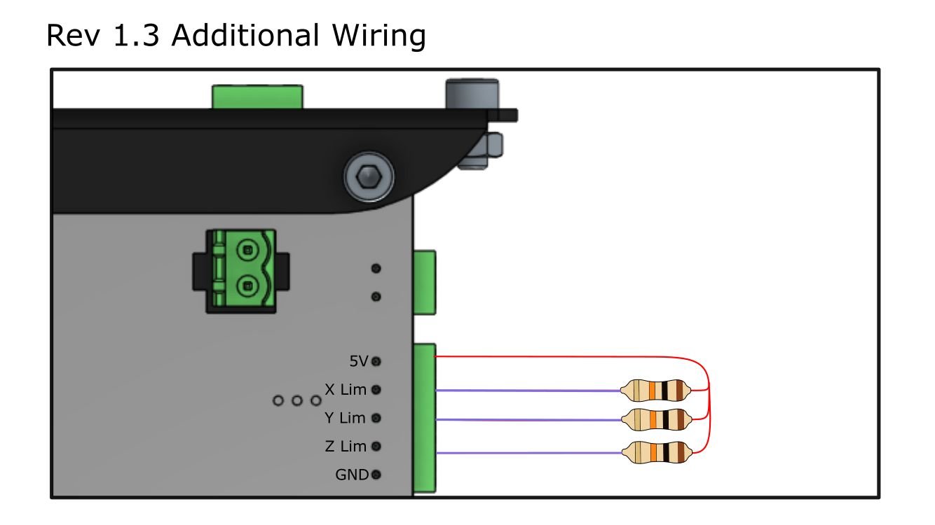

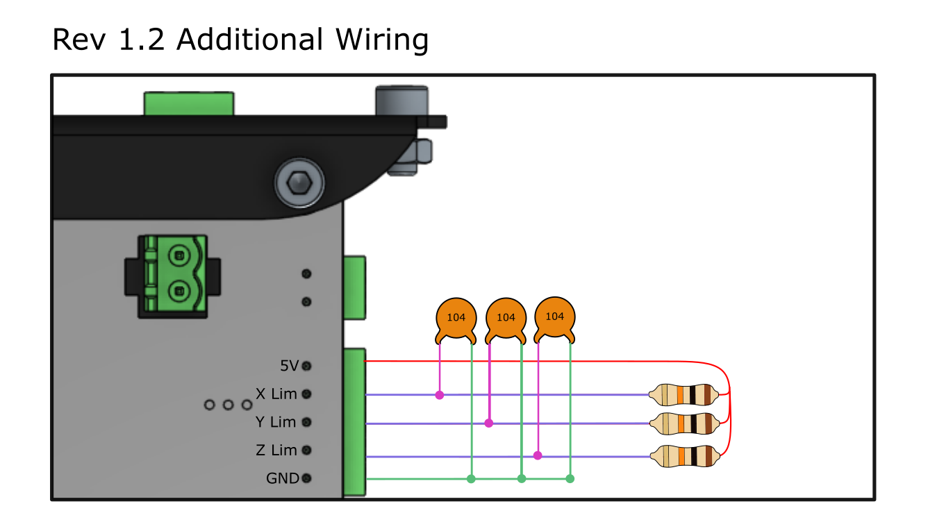

If you have a Rev 1.2 or 1.3 LongBoard, it is necessary to attach the resistors and/or capacitors as specified. Refer to the diagrams below for the additional wiring. The red 5V line is used to produce the noise filtering effects via capacitor and to establish the correct voltage via resistor.
The limit switches must also be included as described in the previous diagrams, making connections between their respective signal line and ground. In Rev 1.2, you wire the limit switch between the resistor and the capacitor. In Rev 1.3, you wire the limit switch between the resistor and the signal pin.
Rev 1.3
Rev 1.2
Before you solder anything, make a plan and dry fit all these components into their approximate locations. Once you have settled on their placements, you can solder your circuit together.

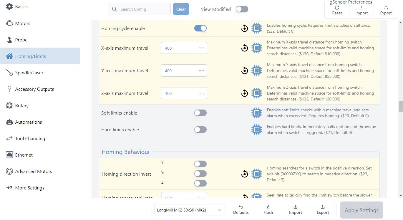

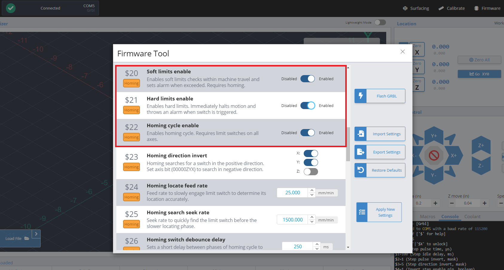

$20 and $21 – Soft limits and hard limits enable
If you have two switches per axis, use $20=0 and $21=1 to enable hard limits. If you have one switch per axis, use $20=1 and $21=0 to enable soft limits.
$22 – Homing cycle, boolean
By default, your LongMill is set to $22=0, disabling the ability to use the homing cycle. Activate homing by sending the command $22=1. When homing is activated, every time your machine is connected, your machine will ask you to home the machine as a safety feature. You can home your machine by sending the commandย $H through the console, or use the “Home” button on your g-code sender.

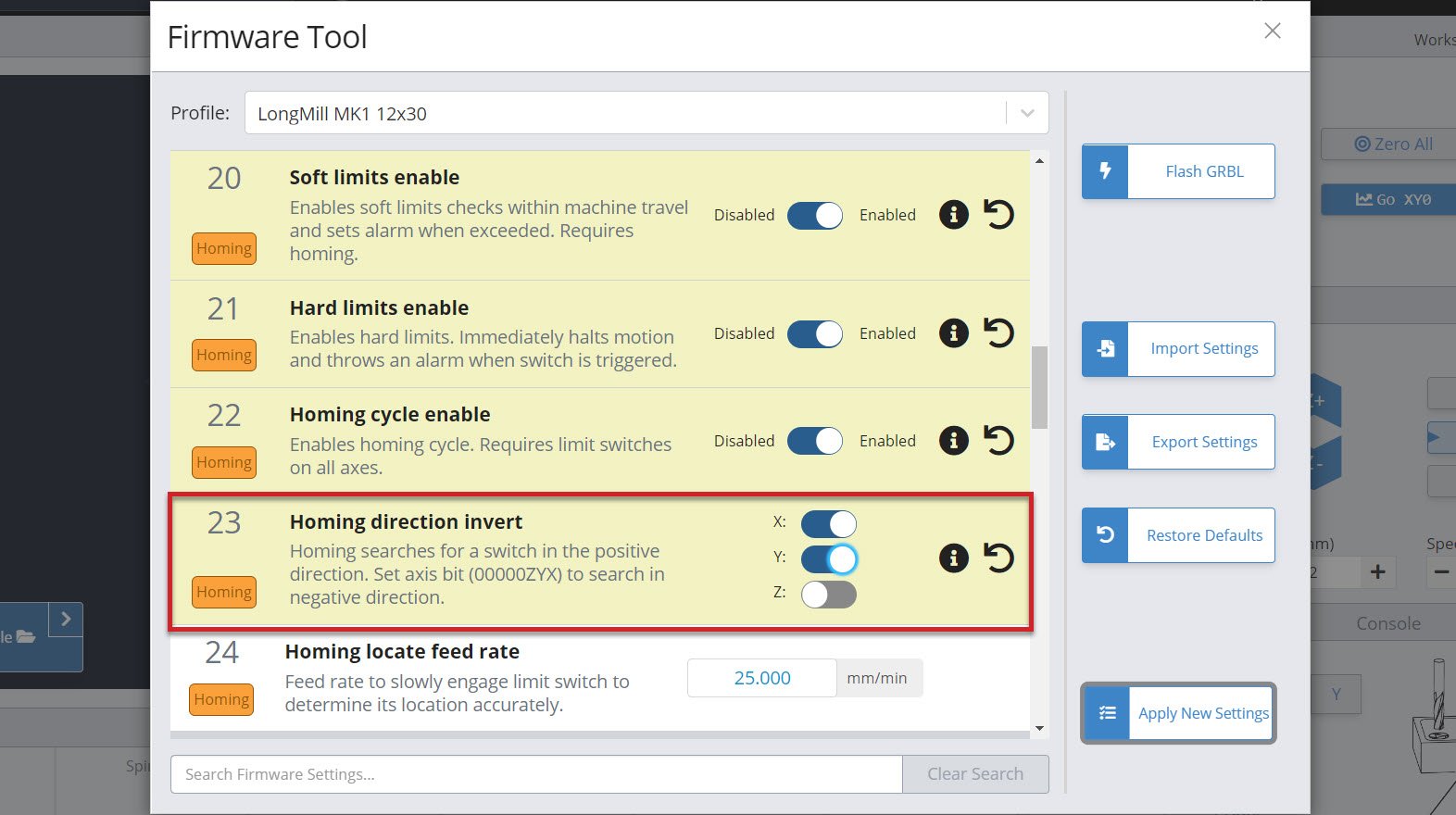

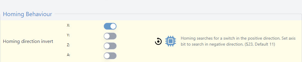

$23 – Homing direction invert, mask
By default, your LongMill is set to $23=0. This setting is used to select the direction that the machine moves to home each axis. By default, when $23=0, the machine will move home up in the Z direction, and then to the upper left corner (moving towards the left on the X-axis and moving up to the top on the Y-axis).
In some cases you may want to change the direction that you want to home, either based on the location of your limit switch and the way you want to set up your workflow. For example, if you have a square at the bottom left corner of your machine where you can set a corner you can set rectangular material on so that you can repeat the same job over and over again, you may want to invert the Y-axis homing direction so that your machine homes to the bottom left corner of the machine.
Setting Value Mask Invert X Invert Y Invert Z
0 00000000 N N N
1 00000001 Y N N
2 00000010 N Y N
3 00000011 Y Y N
4 00000100 N N Y
5 00000101 Y N Y
6 00000110 N Y Y
7 00000111 Y Y Y
When looking at the table on inverting each axis, setting value 3 inverts the direction of the X and Y homing directions. So by sending command $23=3, the X-axis and Y-axis homing directions will be reversed and the machine will home in the bottom left corner.
In gSender, you can use the toggles instead to change the direction of each axis.
