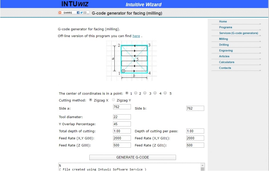

I used a g-code generator from INTUWiz (http://www.intuwiz.com/plane.html#.Xidt8sjYouV). Here are the settings I used for the 30×30 size:
The center of the coordinates is in a point: 1
Side a: 762
Side b: 762
Tool diameter: 22
Y overlap percentage: 45
Total depth of cutting: 1
Depth of cutting per pass: 1
Feed rate (X,Y G00): 2000
Feed rate (X,Y, G01): 2000
Feed rate( Z G00): 500
Feed rate(Z G01): 500
You can also use a different program if you want and cut a shallow pocket of the size you need.
