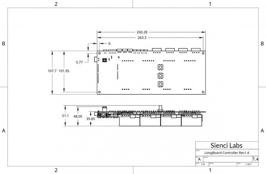

Dimensions
For 3D models of the LongBoard, please visit our open source documentation page for access to files if you wish to acquire additional dimensioning: https://resources.sienci.com/view/lmk2-open-source/

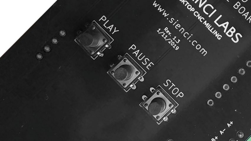

Play, Pause, and Stop Buttons
The LongBoard comes with three buttons on the top of the controller that can be used to control the machine during its operation. Pressing these buttons will trigger the control software such as UGSPlatform to perform an action.
These buttons may be useful for some users as it allows you to play, pause, or stop a running job without touching the computer.
Play:
NOTE The machine must be paused in the middle of a job for the play button to work. The play button can be used to resume a job that has been paused.
Pause:
The pause button will pause a running job. Pressing the play button will resume the job.
Stop:
The stop button will stop a running job. Once you press the stop button, you will not be able to continue a job. When you press the stop button it will also throw an alarm and you will have to reset your connection with UGS or perform a “soft reset”.
