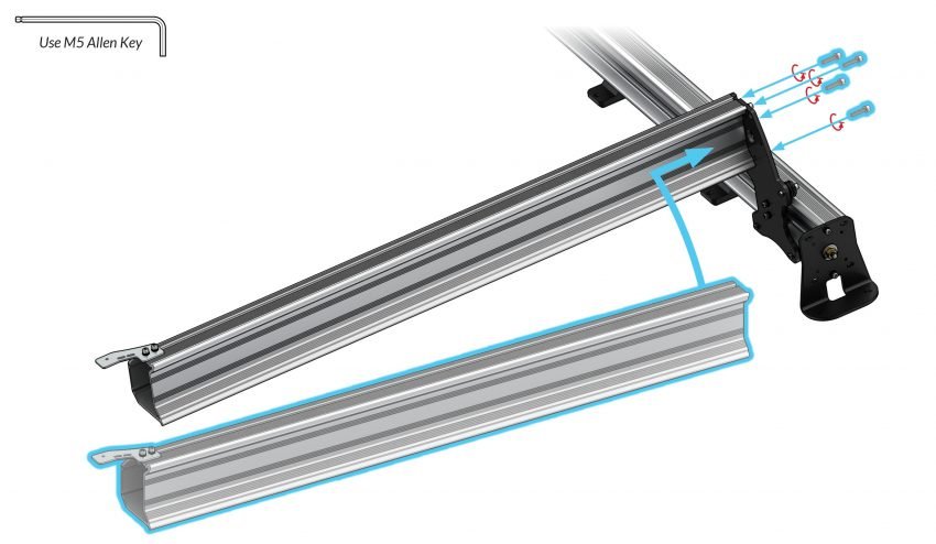

Lift the right side of the X-axis rail up to meet with the matching holes on the right Y-axis gantry plate to assemble them together. Bolt these together using four M5-25mm bolts. Positioning is easy since the shape of the rail matches the shape of the plate top.

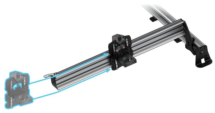

Slide the XZ-gantry onto the X-axis rail. The v-wheels should sit on the pointed edges on each side of the X-axis rail (pictured).
Lift the left side of the X-axis rail up to meet the left Y-gantry assembly. The drag chain mount is there to assist you with positioning by acting as a rest against the top of the plate while you bolt the plate to the rail. Fully fasten using four M5-25mm bolts.

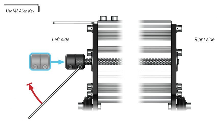

At the left side of the X-axis rail, slide the coupler on until it bottoms out on the lead screw. Firmly secure the coupler at the set screw using an M3 Allen key.
Just like for the Y-axis, use both hands on the right side to thread a locking ACME nut into the lead screw so that it pulls it flush to the flange bearing and brings the coupler flush against the other bearing. While holding this tension in place, firmly tighten the set screw on the ACME nut. This makes another ‘bolted sandwich’ where everything should be touching bearings (as pictured) and the lead screw should only be allowed to rotate, and not move side-to-side.
