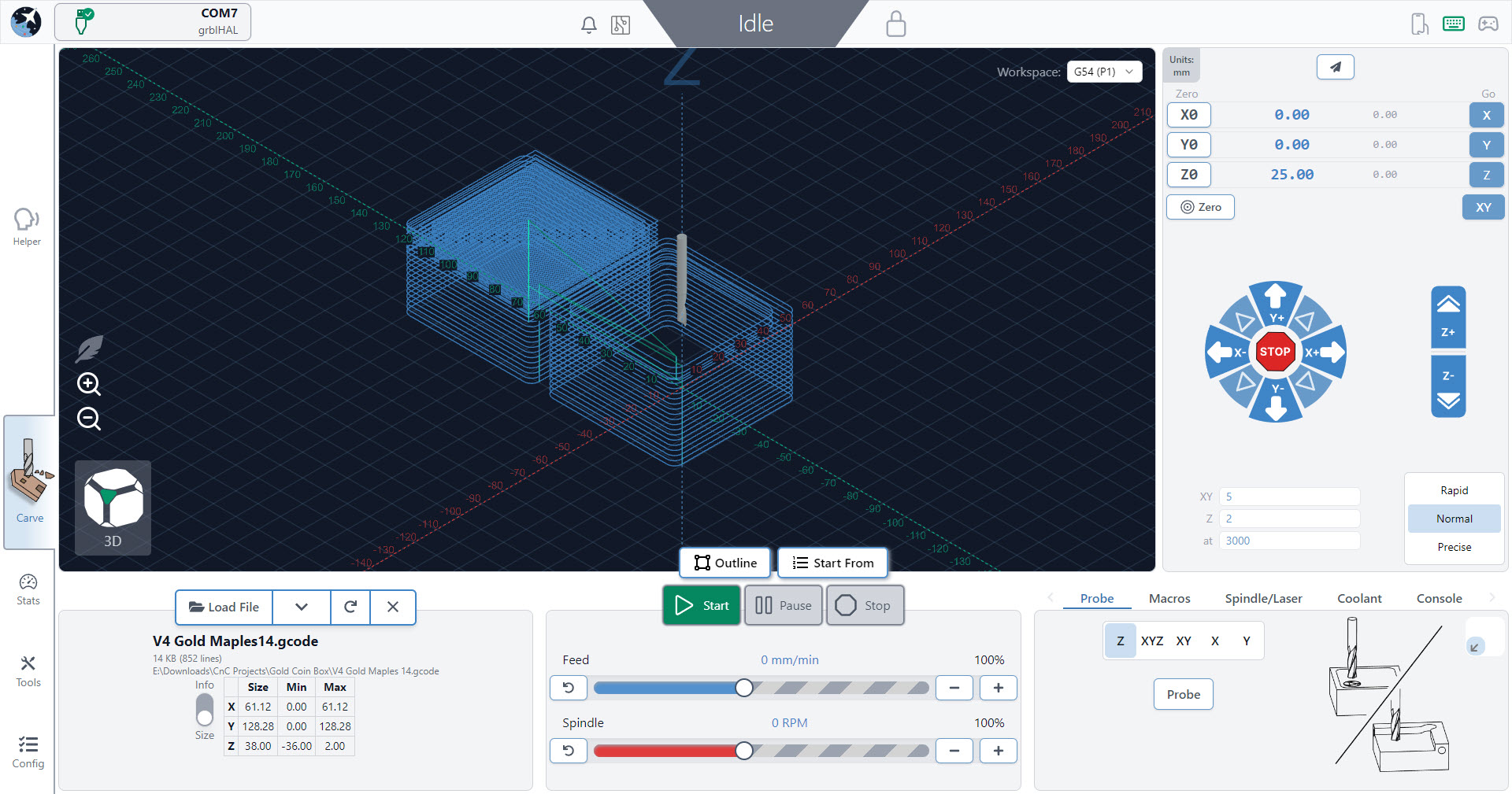

CNC Interfaces
Many of our software picks don’t tend to have a built-in machine interface so we have a couple of independent programs that we’ve found work well. For most users, we recommend using gSender as the go-to interface software:
  • This is an open source program developed by us, Sienci Labs, which you can download for free here: https://sienci.com/gsender/
  • We used to recommend highly some other senders, but hearing about their flaws we decided to make gSender as a solution to all the feedback we received
  • Detailed instructions on how to use gSender can be found here: https://resources.sienci.com/view/gs-installation/
  • gSender is designed to work right out of the box for the LongMill
The full list of grbl-compatible senders is generally maintained here: https://github.com/gnea/grbl/wiki/Using-Grbl but we’ve put together a more digestible list that you can reference below of the ones we’ve gone through and personally experimented with. All of these work well in most capacities and are easy to learn and pick up:
Name Type Difficulty
(1-4)
Notes Compatibility Price
gSender Interface 1 A reliable and lightweight sender based on CNCjs that’s easy to use and has novel expanded features All desktops Free
UGS Interface 2 A good default machine interface that’s lightweight but has good functionality All desktops Free
CNCjs Interface 2 Another great interface option that can be more reliable on certain systems since it’s not Java-based All desktops & Online Free
OpenBuilds Control Interface 2 A newer software that seems to be promising in it’s reliability and additional features All desktops Free
Easel 2D Design, 2D CAM, Int 1 Works directly through Easel in your browser. Quite minimal but can get the job done Online Free
VTransfer Interface 1 Only packaged with Vectric products. Has almost no features so it’s pretty limited Windows Free
bCNC 2D CAM, Int 3 The go-to by many when setting up their CNC to run off a Raspberry Pi. Reliable and python-based All desktops Free
gSender
gSender (https://sienci.com/gsender/)
This software is designed to be clean and easy to use no matter your previous CNC experience. It has a variety of features such as macros, CNC calibration, surfacing, tool changing, and firmware control. gSender supports many grbl-based machines and works out-of-the-box on the LongMill CNC.
