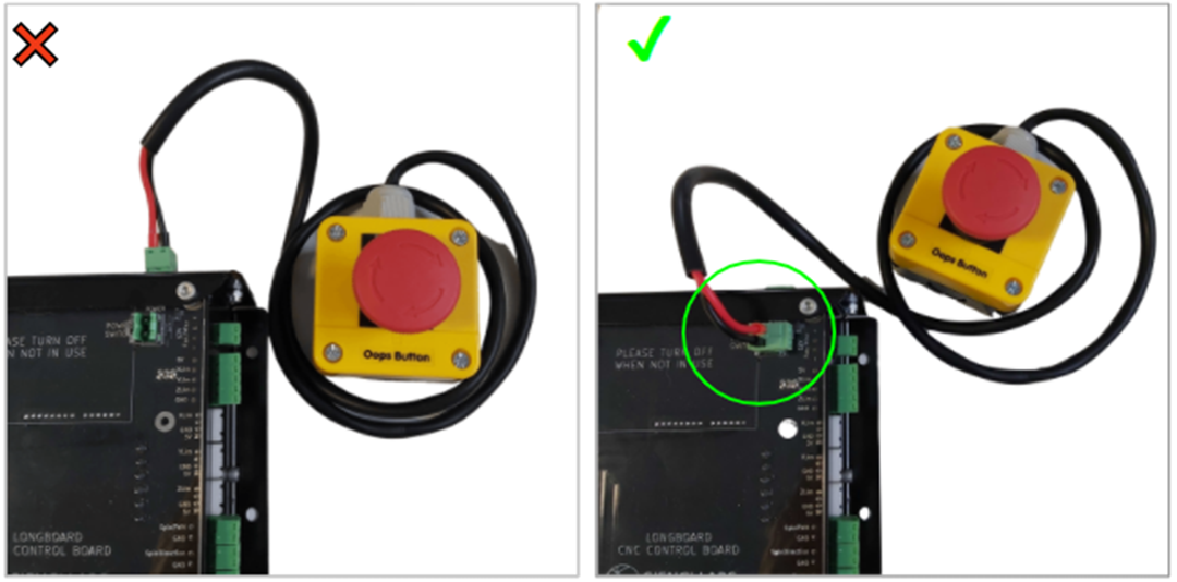

Controller does not turn on
- First, ensure that your LongMill’s power supply cable is connected to the wall and power brick correctly. If you have an E-stop, check that the button is released by twisting it counterclockwise and if you have a power switch, ensure it’s toggled on.
- Make sure your power supply brick is plugged into a 100V-130V AC outlet. If you do not have this AC voltage available in your area, you’ll need to use a transformer to step down to 110/120V.
- Check that the E-stop is plugged into the top of the LongBoard, and the power supply is plugged into the side of the LongBoard.

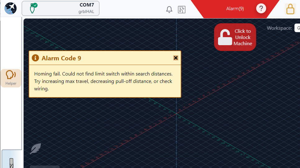

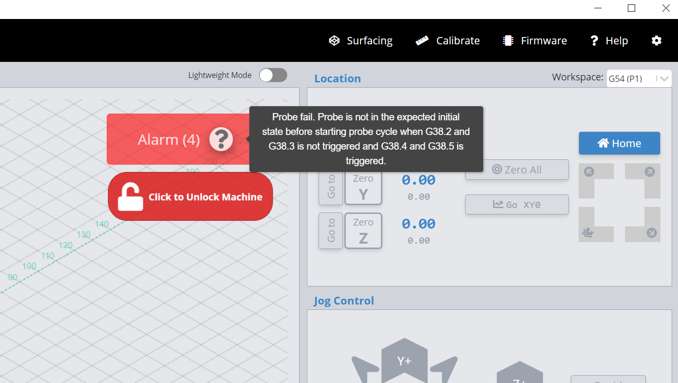

The software says ALARM
Something’s happened during the operation of the machine which was unexpected so it’s decided to lock itself just in case.
- Something’s happened during the operation of the machine which was unexpected so it’s decided to lock itself just in case.
- If your machine has ‘homing’ enabled, this will cause the controller to start in an alarm state upon connecting to prompt you to run the homing cycle, so this is normal.
- In gSender, you can click or hover over the question mark symbol to bring up more information about the alarm.
- Click the ‘Unlock’ button below the alarm in gSender to bring it out of the alarm state and back into its ‘IDLE’ state.
- In some cases, your EEPROM settings (the machine settings) have changed. Make sure they are correct by referring to the default EEPROM settings.
- If it continues to go into an ALARM state under similar conditions in the future, check that no wires or hardware have come loose and that there’s nothing externally affecting the movement of your machine.

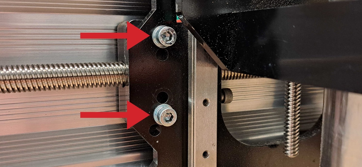

- Loose screw: loosen the two M5-25mm screws that hold the Delrin anti-backlash nuts slightly for the axis which the lead screw is on and run the machine back and forth. This will align the lead screw and the nut. Re-tighten the screws once the wobbling as gone away. Also check the ACME locking nut and coupler on both ends of the screw are firmly tightened and sandwiching the lead screw properly.

- The EX coupler for the extension kit is quite a bit thicker and it needs a lot more force to apply the right tension to the motor. Try to tighten the set screw as hard as you can, you might need a longer Allen key to help with this.
- Loosen the acme nut so it’s resting against the washer but not putting any lateral pressure of the inner race against toward the gantry.
- Make sure the two mounting nuts that hold the blocks to the gantry are only tightened till snug.Ā Do Not over-tighten them. It will put unwanted pressure on the lead screw.

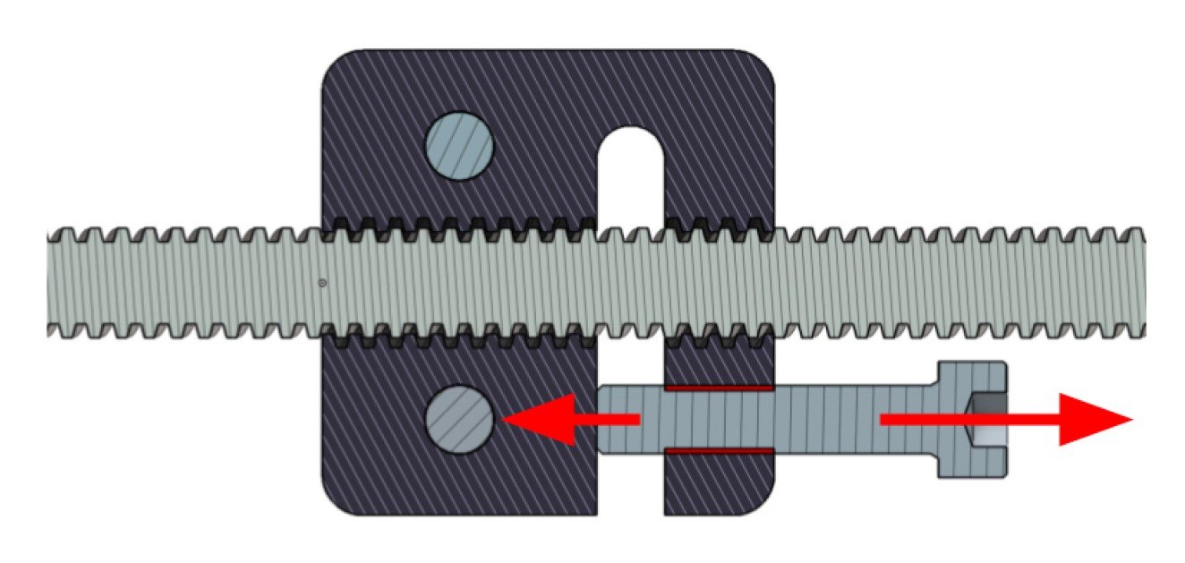

- Loosen the set screw on the anti-backlash blocks using the set screw shown below. The lead screw should rotate by hand easily at this stage. If not, make sure the mounting bolts and acme nut are adjusted as noted above. Tighten the set-screw a 1/4 turn at at time till the lead screw rotates by hand with some difficulty. Any tension on the lead screw will be adjusted by the set screw.

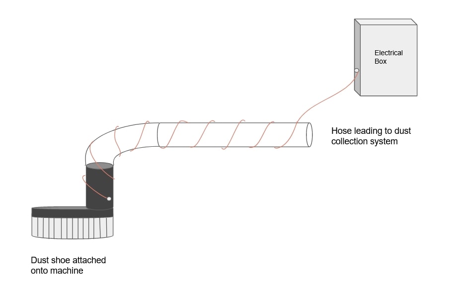

Before diving in, one of the most common sources of disconnections is a loose Arduino inside the control board in which case you can follow the guide below or use a non-conductive tool to push the Arduino back into place through the bottom slots of the controller.
When your machine disconnects during use, it’s important to keep an eye out for common patterns/situations when it happens:
- Sometimes subtle things like a slightly loose USB cable connection, power connection, using other power tools at the same time as the machine, etc. can cause disconnects to happen. In these cases, consider checking your other machine connections, using newer cables, putting your machine on a dedicated circuit, or if you have a newer board with Ethernet then consider switching over to gain a more reliable communication connection.
- If you notice that the machine only disconnects during longer jobs, it is possible that your computer is causing the USB to ‘sleep’ and disconnect from your machine.
- If you were using a dust collector/vacuum, try running the machine with them off to see if disconnections keep happening. If the machine no longer disconnects, you can likely conclude that static build up or interference from your dust collector is the cause. Another easy way to know if your dust collection might be causing issues is if you occasionally get static shocks when you touch the shoe or hose, which points to large static buildup likely affecting your machine.
- If you have other appliances, tools, or electrical strains on the same circuit as your machine, or your home/shop does not have reliable power in the form of blackouts or brownouts, it is possible that power fluctuations are causing your machine to skip, disconnect, or stutter.
If there don’t seem to be any specific patterns in these disconnection occurrences, there is most likely some EMI (electromagnetic interference) to blame, a.k.a. electrical noise. These unexpected electrical signals can find their way back to your CNC controller and disrupt it’s on-board electronics, affecting how reliably your CNC can cut projects for you.

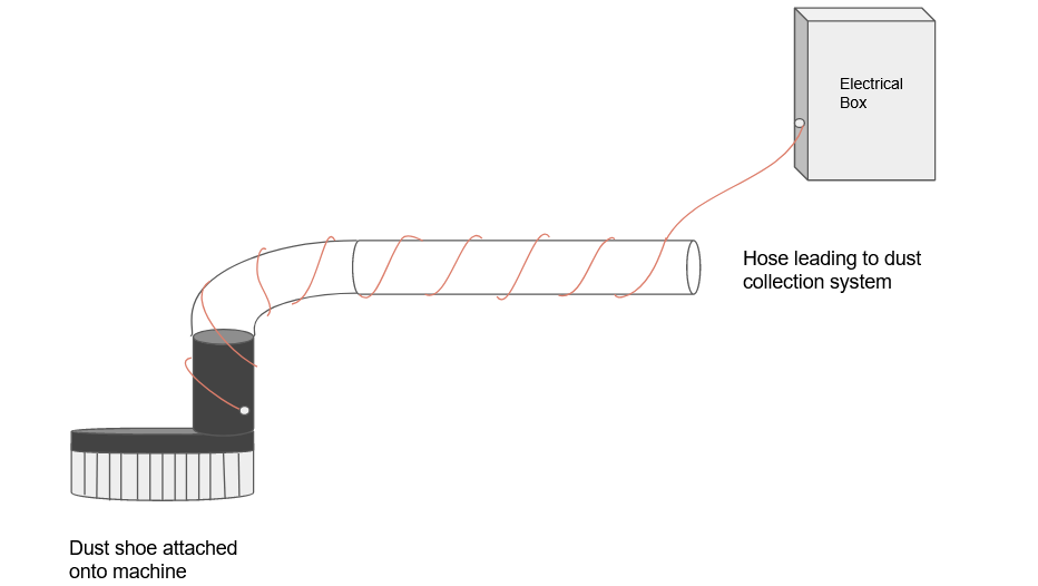

Conditions which will typically cause EMI to present itself include:
- Having other tools like vacuums, motors, and other electronics running on the same circuit.
- Cutting/surfacing materials that tend to accumulate static charge such as MDF, epoxy, or other plastics
- Using a low-quality dust collector that’s not appropriately grounded
- Using a low-quality hose that isn’t anti-static or doesn’t contain an inner metal wire spiral
- Running your CNC in a humid environment
- Have incorrectly wired ground lines to your garage or shop
If you’re still unsure, we’d recommend going through each section below since eliminating any possible source of EMI is the best course of action to get reliable results.

Machine disconnects when using a dust collector
The most common solution for preventing static buildup is by having an escape path for built-up charges. Using a ‘ground point’ works because it’ll be a path of least resistance which stray charges will prefer to take instead of sticking around.
If you plan to try this, ensure that you only use one ground point for your entire machine setup (including dust collection). For example, if your home has just one electrical panel, you can ground it on that or the attached ground stake outside. This avoids possible ground loops which can create additional interference.
It is highly recommended that you have your dust collection and your machine on a separate circuit.
- Using bare solid copper wire between 10 to 18 AWG, wrap the wire around the body of the dust shoe and hose securely. Make sure the wire will not get caught in any moving parts during use. Fasten one end of the wire at the dust shoe end, and the other fixed directly to the ground stake or other grounded item such as an outlet box, electrical box, or grounded 3-prong power bar.
- You can also pick up something like the Grounding Kit that’s offered by Lee Valley. This is a collection of essentially speaker wire, twist-on wire connectors, and some screws: https://www.leevalley.com/en-ca/shop/tools/workshop/dust-collection/parts-and-accessories/62616-grounding-kit-for-dust-collection-systems?item=03J6201
