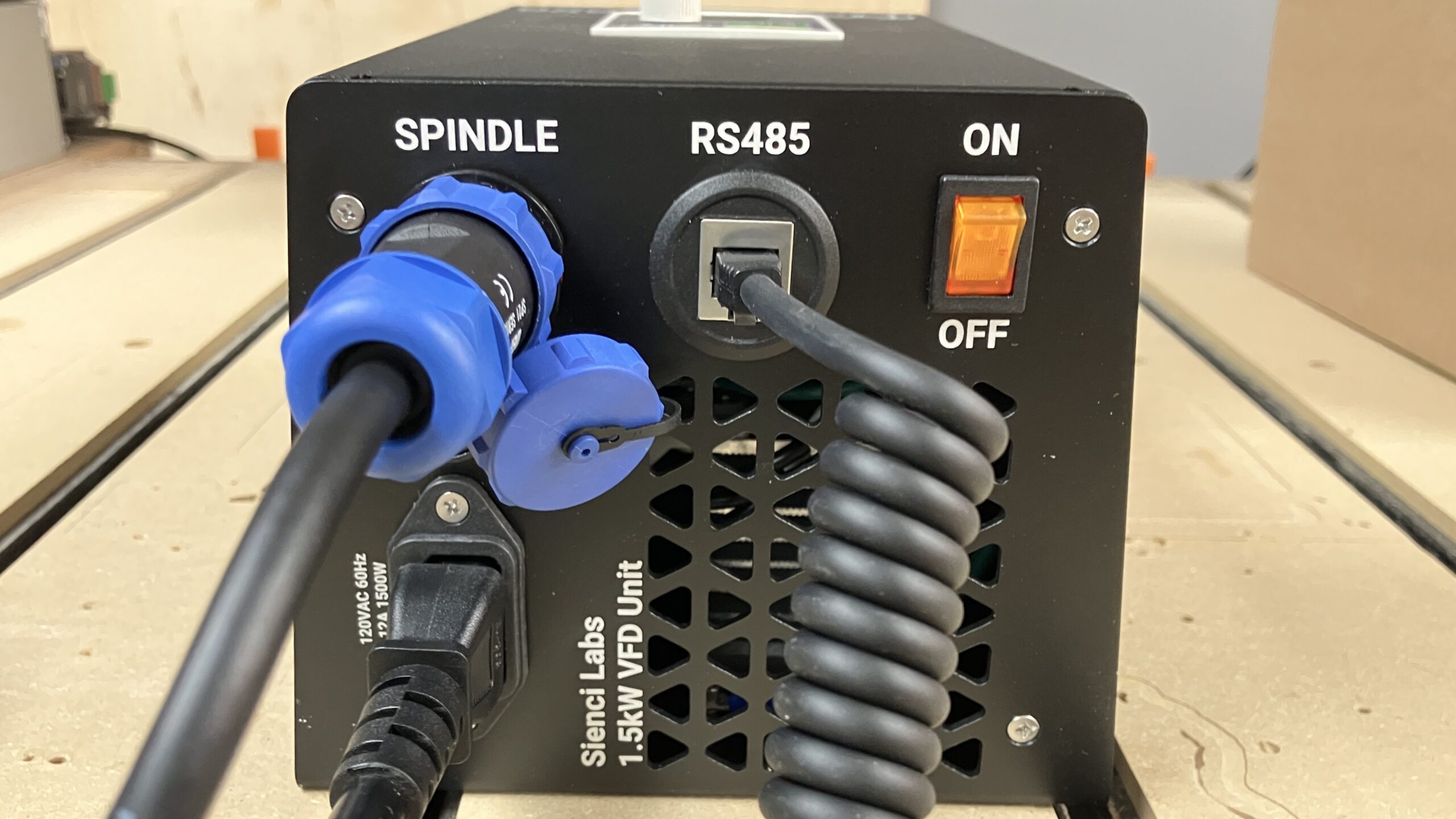

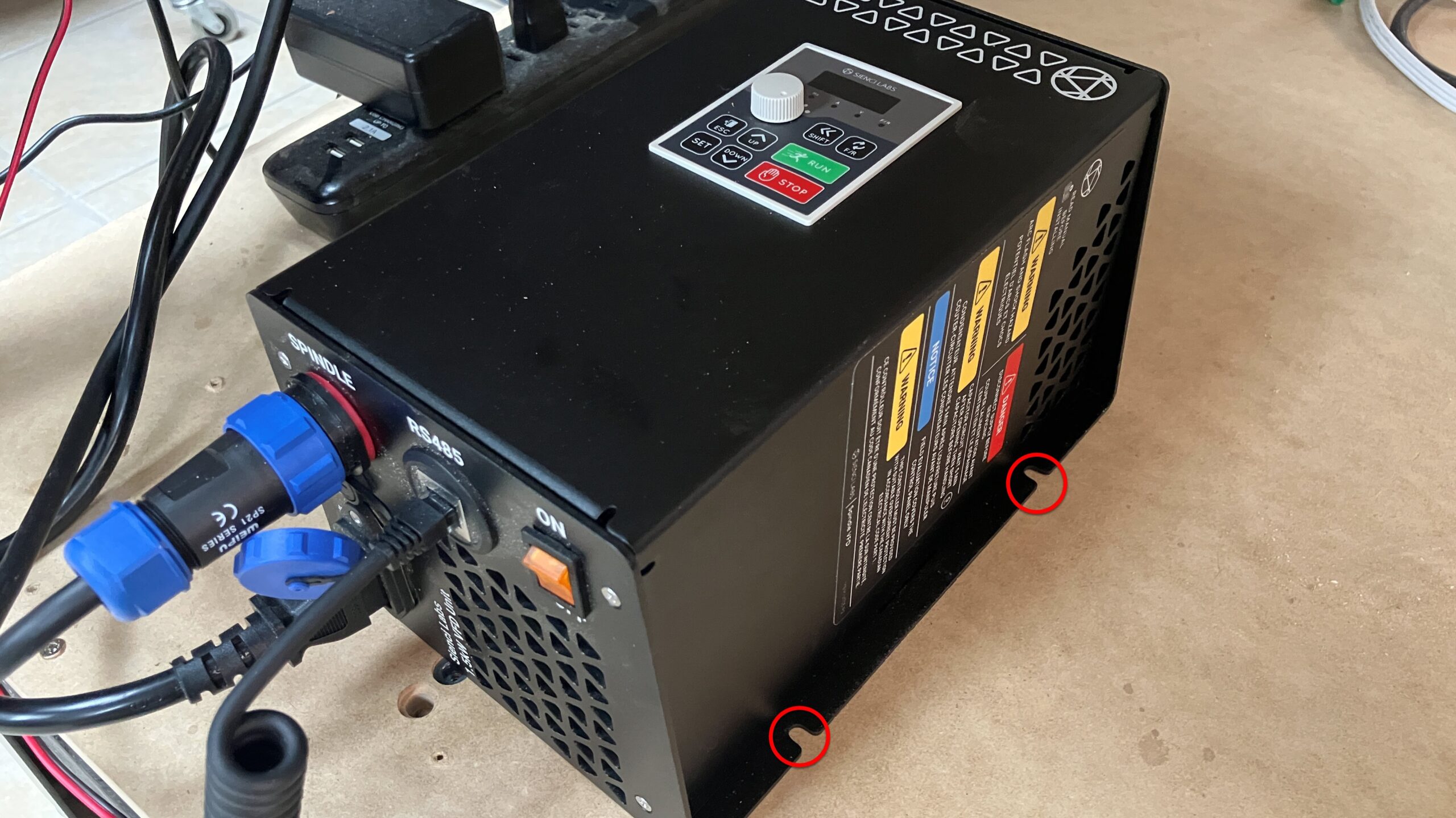

VFD components, labelled
***Throughout this assembly, do not disconnect any of the VFD wiring! Miswiring can cause operation errors and damage to the device.

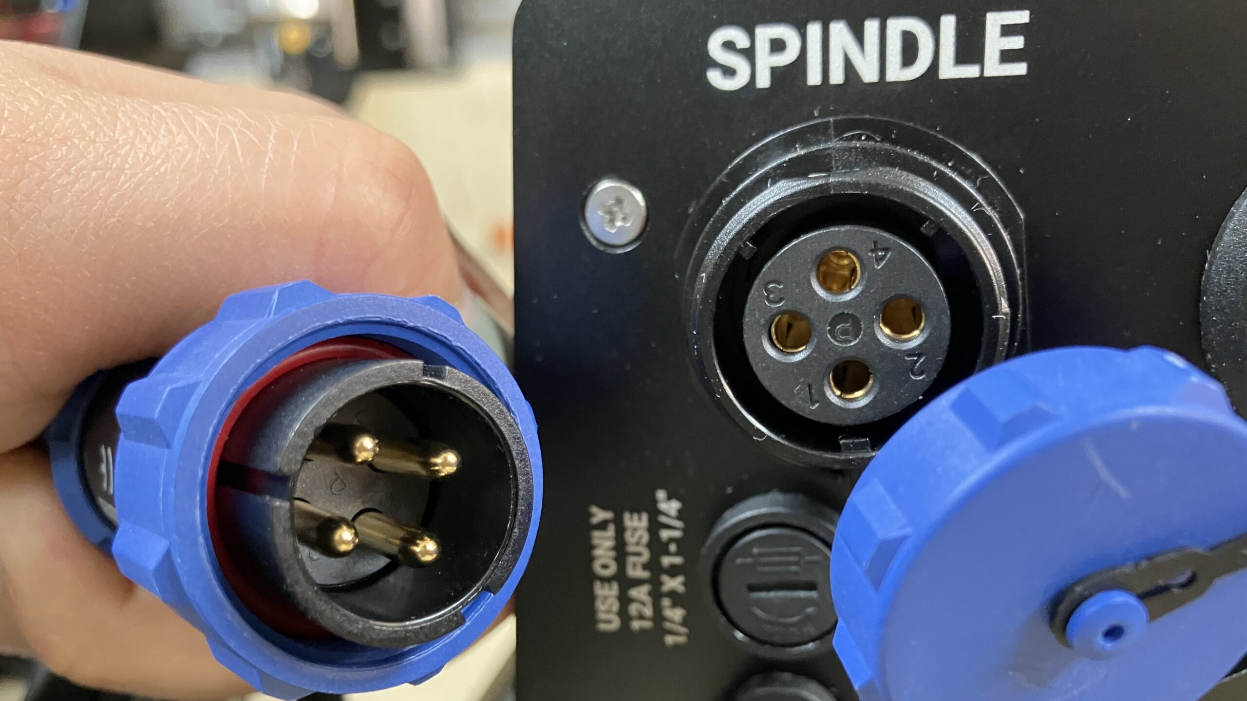

  11. Plug in the spindle cable connector into the top of the spindle.
    Spindle cable connected

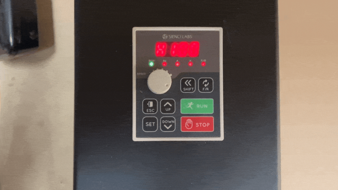

  14. Plug the VFD into power, the VFD screen should blink on with red text.
    VFD powered on

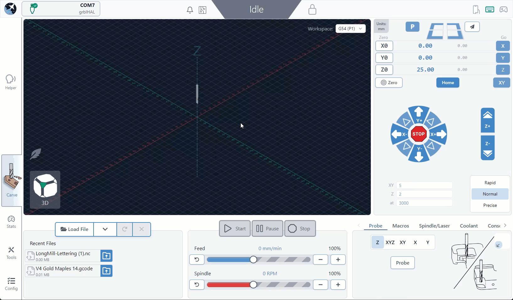

  15. Turn ON the controller using the power switch and make sure the E-stop is released. We will now move to setting things up on gSender.

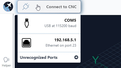

1. Connect to the machine in gSender.

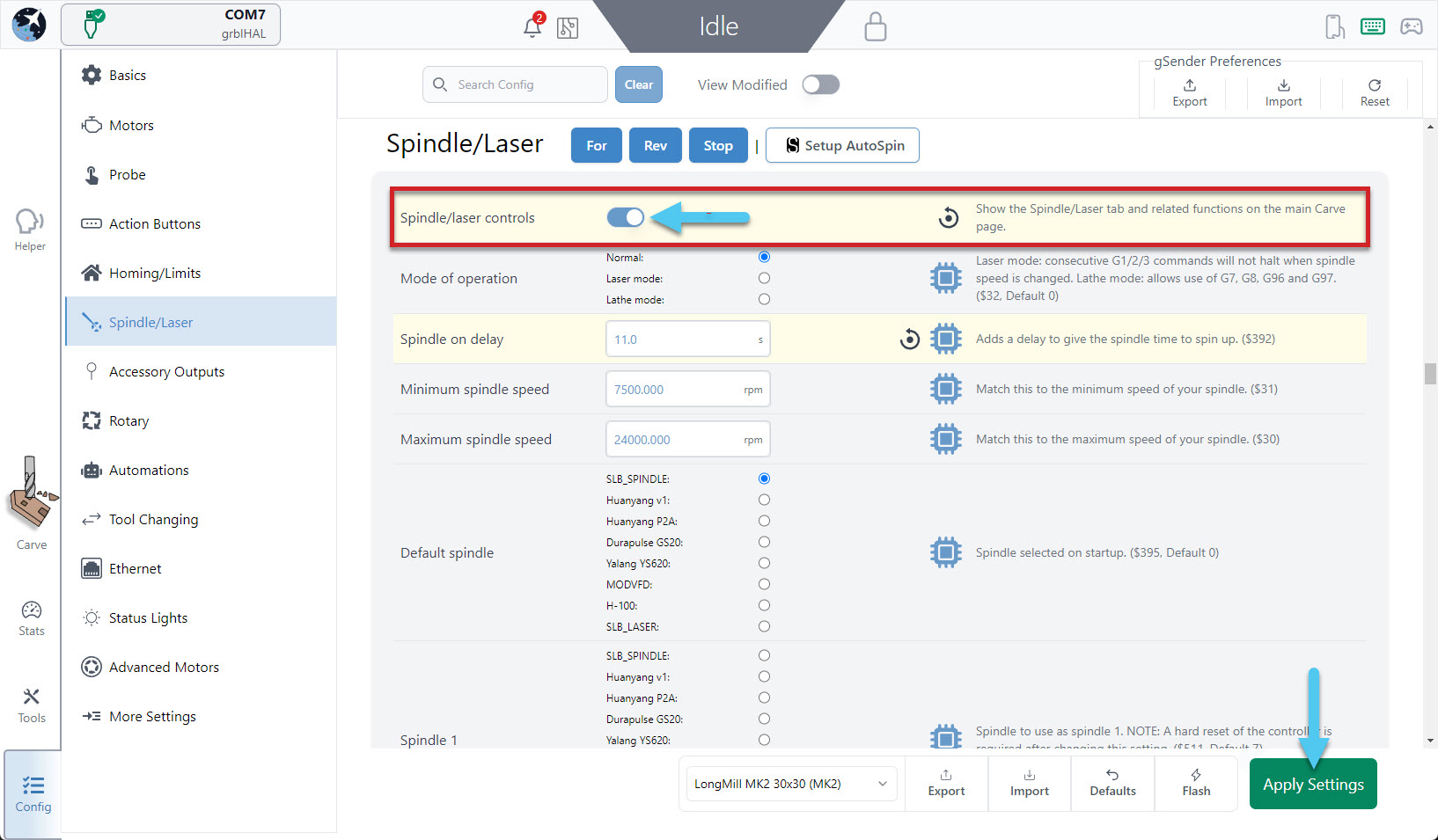

4. Once you completed the steps in the installation wizard, go to Config, to the Spindle/Laser section, and enable these functions by flipping the enable Spindle/Laser toggle to turn them ON. Don’t forget to apply your new settings!

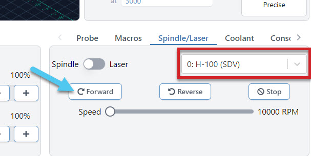

6. At the ‘Spindle/Laser’ tab, check that ‘H-100’ is selected. Then use the slider to the lowest speed, and press the ‘Forward’ button to test out the spindle. Check that it is spinning in the correct direction. Press the ‘Stop’ button to stop the spindle. You are almost ready to start CNCing with the spindle!

4. Go to Config, to the Spindle/Laser section, and enable these functions by flipping the enable Spindle/Laser toggle to turn them ON. Don’t forget to apply your new settings!

1. Connect to the machine on gSender. Make sure that you are connected under the “grblHAL” firmware.

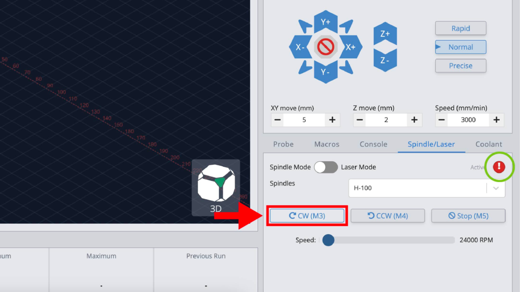

4. At the ‘Spindle/Laser’ tab, check that ‘H-100’ is selected. Then use the slider to the lowest speed, and press the ‘CW’ button to test out the spindle. Check that it is spinning in the correct direction. Press the ‘Stop’ button to stop the spindle. You are almost ready to start CNCing with the spindle!

To run the file connect to gSender and press ‘Load File’ at the bottom left corner. Select the file and you should see a ‘Start Job’ button appear, go ahead and click that.
