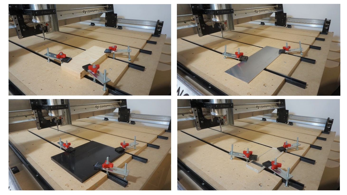

The T-Clamp System
T-clamps are simple and reliable workholding tools that are used alongside T-Track tables. We’ve come up with T-clamps that work for various metals, plastics and woods, and hold down materials from 0.1″ to 1″ thick. These clamps are ideal for holding down small to medium sized pieces of material and also leverage their plastic ends to ensure you’re covered in case you cut a little closer to the clamp than you expected. Inside the package you’ll find:
  • Steel clamps (x6)
  • Knobs with inserts (x6)
  • 3D printed end caps (x6)
  • Hex head machine screws (x12)
  • Flat washers (x6)
  • T-track rails (x6)
  • Wood screws (x100)
To assemble the T-Clamps:
  1. Push the plastic end cap onto the steel clamp – the end with two holes. It should have a slight wiggle but should not be easy to remove.
  2. Fasten a hex bolt onto the other end of the clamp. We recommend the hex head to be facing upwards so that it easily slides into the t-track, but you can change it if desired.
  3. Slide the other hex bolt through the clamp slot, with the hex head facing down. Bring the washer and knob from the top, so that the washer is contained between the clamp body and knob.
  4. Now you can slide the downward facing hex bolt onto the t-track and locate the clamp for mounting material.
To use the T-Clamps:
  1. Slide the hex bolt head through the t-track so that the entire clamp is on the table.  You may need to adjust the bolt and knob to have it fit onto the table.
  2. Place your workpiece onto the table.
  3. Move and adjust the clamp to push down onto the workpiece, ensuring that the end cap side of the clamp is lower than the bolt end. Tighten both bolts until snug. Position the clamps so that there is enough space for your cutting job on your workpiece.
  4. Push your material to check if it is secured onto the table. If not, use more t-clamps or other workholding methods.
