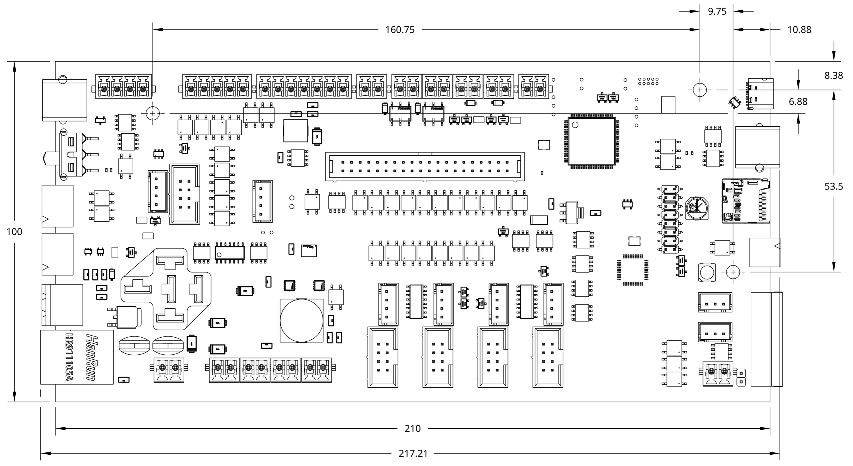

See overall dimensions of the SLB-EXT below:

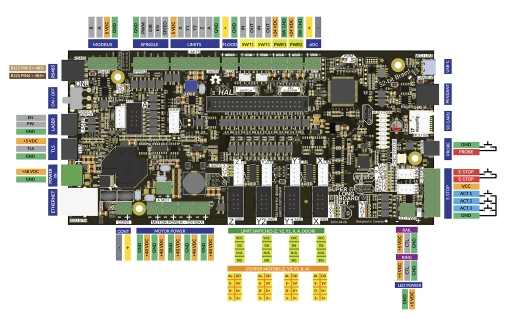

Board Pinout
The SLB-EXT needs a 48V, 12.5A power supply to correctly run all stepper motors at their rated current alongside the other onboard accessories. The board can also support 36V power, should that be necessary.
Downloadable PDF of the pin layout
Connectors List
The SLB-EXT comes with many inputs and outputs that are easy to wire in for CNC customization and accessory hookup by using pluggable terminal connectors. There are also a handful of other connectors used that are common and widely available for purchase. Below lists all connectors used on the board (male) with example links:
- Power in: 2-pin 5.08mm pitch Pluggable Terminal Block (x1)
- X, Y, & Z-axis Motor Signal: 2×4-pin 2.54mm pitch Female IDC Flat Ribbon Cable Connector (x4)
- Motor Power: 2-pin 3.81mm pitch Pluggable Terminal Block (x5)
- E-stop, AUX Limits: 7-pin 3.81mm pitch Pluggable Terminal Block (x2)
- Touch Plate, Flood out, Switch, Aux Power, LED Power, ADC: 2-pin 3.81mm pitch Pluggable Terminal Block (x8)
- RGB LED Strips: 3-pin 2.5mm JST XHP (x2)
- XYYZA Limit Switches, Door: 4-pin 2.5mm JST XHP (x6)
- Laser, TLS: 3-pin 3.81mm pitch Pluggable Terminal Block (x2)
- Spindle: 5-pin 3.81mm pitch Pluggable Terminal Block (x1)
- RS485: 4-pin 3.81mm pitch Pluggable Terminal Block (x1)
- Aux Spindle, Pendant: RJ25 Phone Jack
- A-axis: 2×4-pin 2.54mm pitch Female IDC Flat Ribbon Cable Connector (x1)
- AUX COMM Header: 40-pin 2.54mm pitch GPIO Cable (x1)
Downloadable PDF of connector list

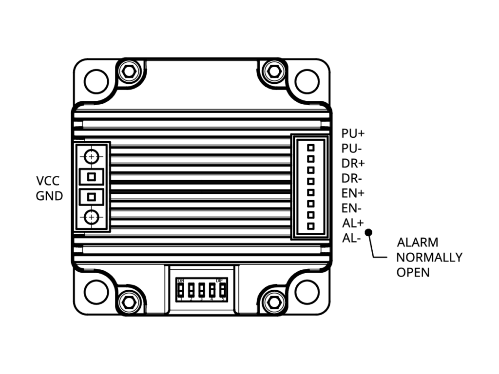

Unlike the regular SLB controller which has its own integrated motor drivers, the SLB-EXT controller is designed to control external motor drivers. In the case of the AltMill, these external motor drivers exist on the motors themselves. There are two connections being made between each motor and the SLB-EXT controller.
First is the supply of 48V DC power that powers the motor’s drivers. This connection has two cables, with the red being positive and black being negative.
Second is the signal connection made between the board and each motor driver. These signal connections utilize differential signals with twisted pair cables to ensure maximum signal reliability. There are four key connections (using two cables each) which do the following:
- STEP/PULSE is used to instruct the motor driver how many small steps or increments to spin
- DIRECTION is used to instruct the motor driver which direction to spin
- ENABLE is used to either enable or disable the motor. When the emergency stop button is pressed, all motor drivers are disabled as a redundant safety mechanism in addition to cutting power to each driver. In normal operation, all motors are always enabled to ensure the machine’s position cannot change due to outside forces such as gravity, cutting forces, or being bumped into.
- ALARM is used by the motor driver to let the controller know that an error has occurred and the machine’s motor has lost its position. When this happens, the controller will flash an ‘Alarm 10’ and perform an emergency stop to prevent any possible damage. This will not happen in regular use, but if the machine somehow ran into an obstacle (or itself), the motor(s) involved will shut itself off and send this alarm signal. If this happens, please see our troubleshooting guide Alarm 10 – Motor Troubleshooting
