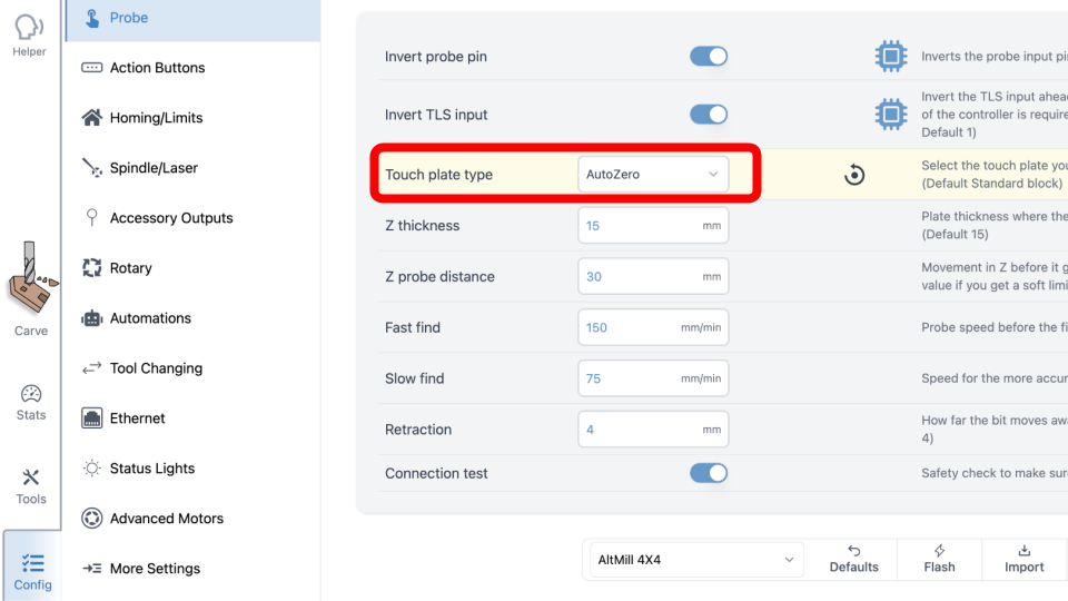

gSender 1.5.0 and above
On gSender, go to Config ➜ Probe ➜ Touch plate type: AutoZero
If you find that the machine is moving strangely during probing, make sure the correct touch plate type is still selected.
Press ‘Apply Settings‘ at the bottom right of the screen to confirm this change.

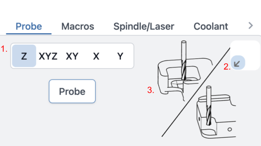

Go back to the ‘Carve’ screen.
The ‘Probe’ tab at the bottom right of the screen should now be updated. Notice the following features:
1. You can select which axis to probe in
2. You can select which corner you want to probe your material at
  • Default is bottom left corner of your material
3. Images of the AutoZero indicate how to position your cutting tool to perform probing for the specific axis

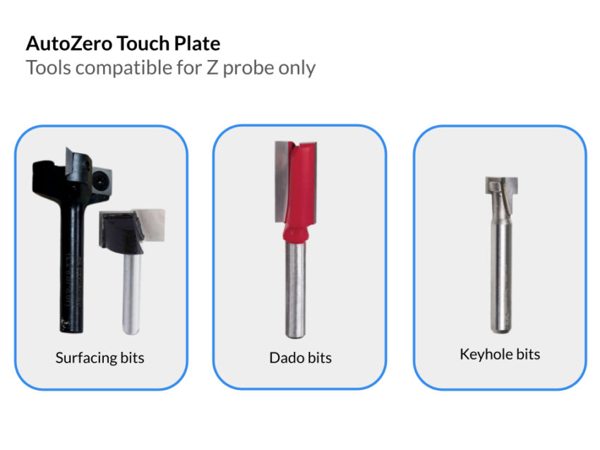

2. Some bits may be incompatible with the AutoZero, or may only work with the Z-probe.
