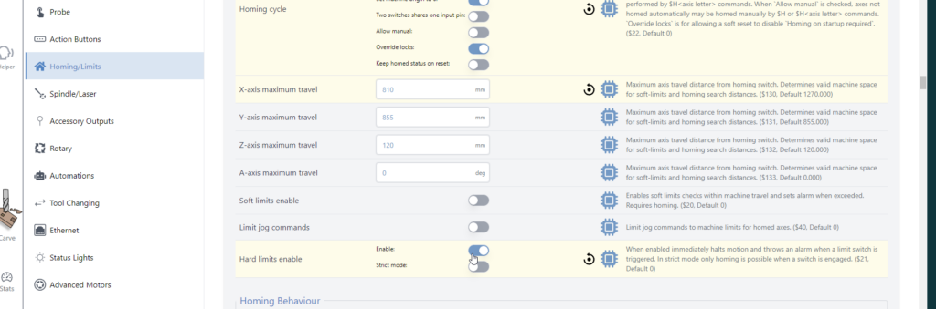

Machine is hitting the bumpers even though the sensors are set up
Check that the $22 homing cycle settings in the ‘Firmware’ tool are correct. If so, and you are still having issues, reposition the sensors to be further out from the gantry or end plates.
Correct default limit switch settings for homing

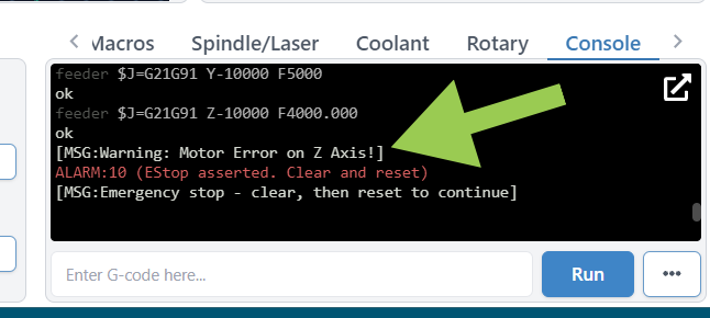

Alarm 10 during homing
If the machine throws an Alarm 10 error code, it’s likely one of the sensors have not been triggered and the motor has hit it’s extent.
To check what motor has been tripped, click the Console tab in the lower corner of gSender. Above the Alarm text in red there will be a message text that will say which motor was affected.
