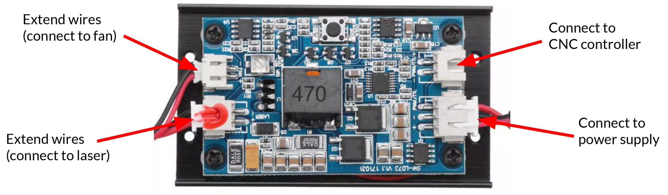

Installing a laser onto your LongMill is fairly easy. There are just three connections to make. If any of your wires are too short, you can lengthen them with butt splices or solder them with heatshrink for a more secure connection.
1) Connect the laser to the driver
Typically there will be two pairs of wires, one to power the laser diode and another to power the cooling fan. You can extend these wires to route them through your CNCs drag chains.
2) Connect the driver to the controller
The laser driver will have a + and – input for PWM (sometimes it’s marked as TTL) that can be wired into the LongBoard controller on the Spindle PWM port (marked as SpinPWM). Use a flat head screwdriver to attach the wires to the terminal connector on the LongBoard and ensure you get the polarity correct otherwise the laser won’t work.
3) Connect the driver to its power supply
Use the power supply that came with the laser driver, plugging the power connector into the indicated socket on the driver.

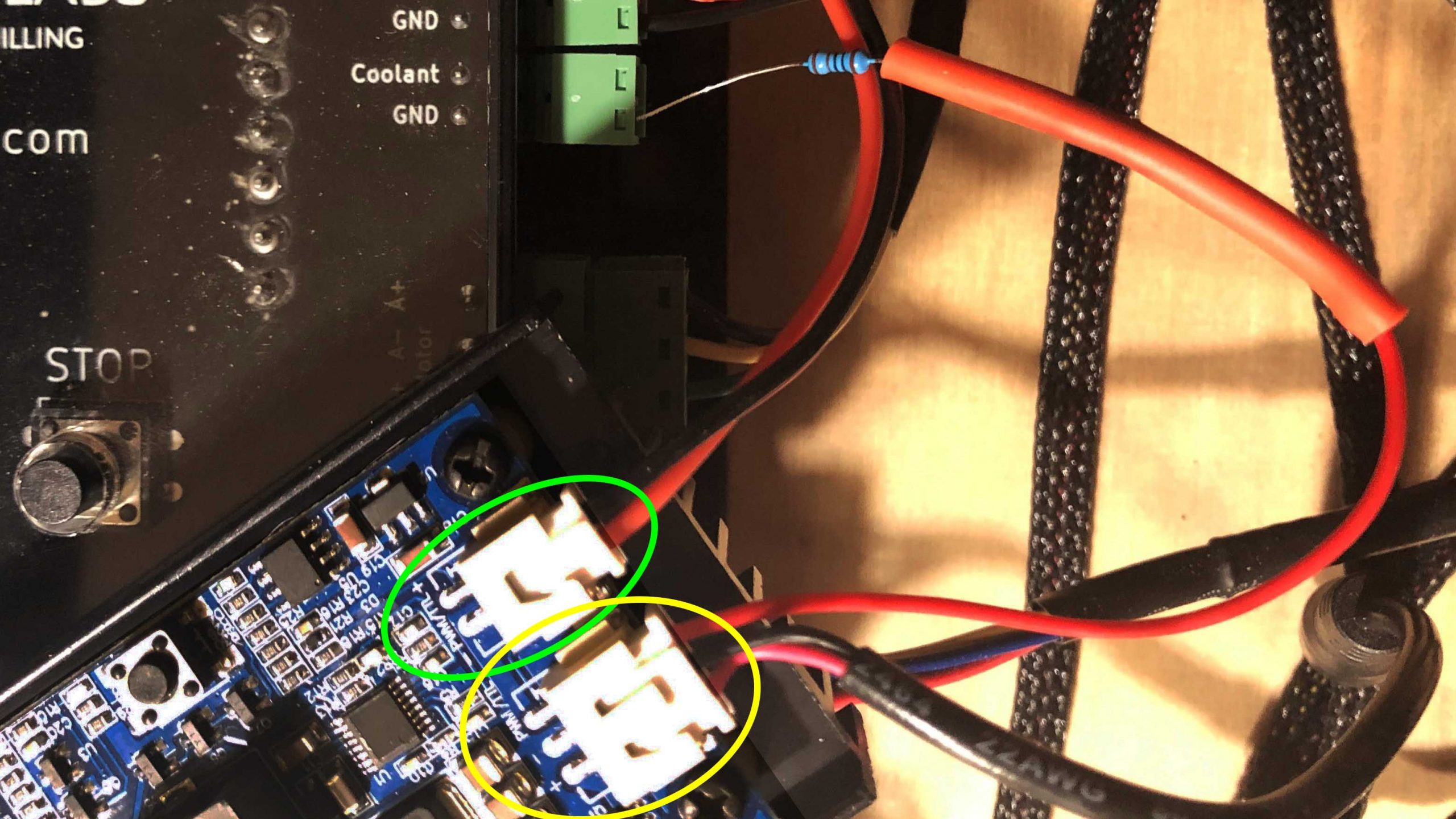

Additional step
As reported by members of our community, some laser drivers (like the common Banggood SW-LD75 V1.1, bought as a package #: LA03-5000) require an extra step since their internal circuitry is a bit wonky. This involves picking up a 1kΩ resistor and wiring it up from the PWM pin on the driver board to any GND connection on the LongBoard. In the case of the picture below, you can see that the free pin on the 3-pin power connector (circled in yellow) is being used rather than splitting off the PWM+ wire on the 2-pin signal connector (circled in green). That wire then has the resistor soldered on and follows to the GND connection for Coolant in this case.

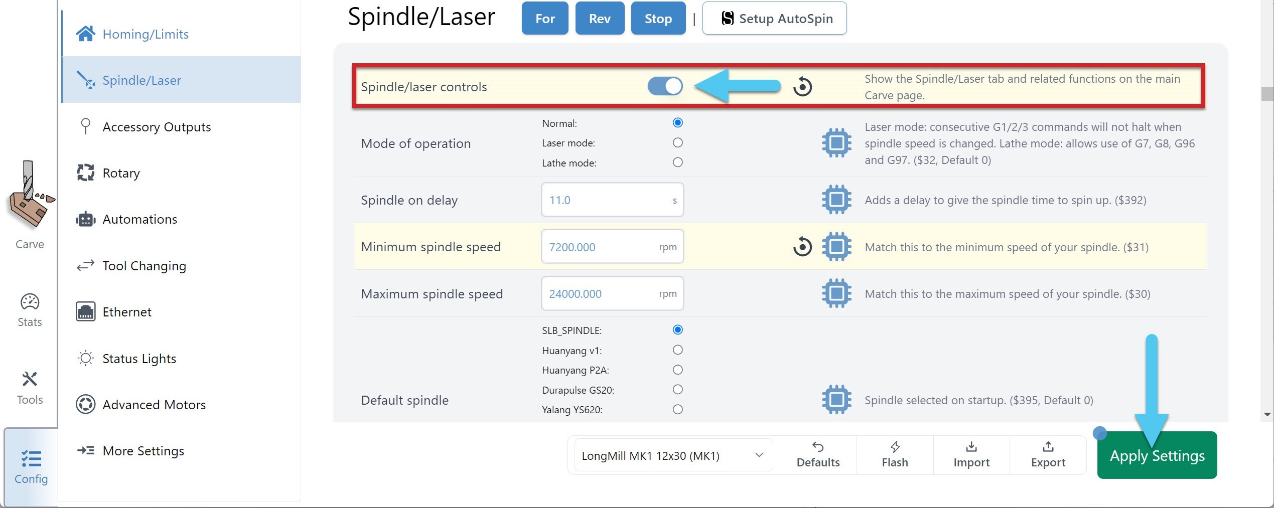

All g-code senders will have a way to access your LongMill’s settings – whether via a Firmware settings window or a Console. If you run your LongMill with a spindle, want to note down the current spindle settings because you’ll either need to use them when making your laser g-code, or if you change the values as outlined below then you’ll need to change them back later. You can do this in the Console by typing “$$” and hitting the Enter or Send key. Write down the values for $31 and $32 from the list that appears.
You can find all the info about grbl and how “laser mode” works on this page: https://github.com/gnea/grbl/wiki/Grbl-v1.1-Laser-Mode. The key takeaways are that you’ll need to alter three machine settings to prepare your CNC for using a laser:
  1. Set the maximum spindle speed ($30) to a value of 255, or send the command $30=255. Lightburn documentation recommends using 255 or 1000
  2. Set the minimum spindle speed ($31) to a value of 0, or send the command $31=0
  3. Enable laser mode ($32) by setting it to a value of 1, or send the command $32=1
The machine firmware will now know that it’s running a laser via the SpinPWM connector.

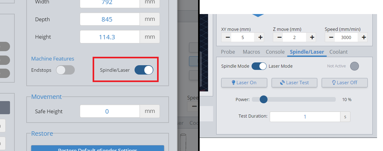

  1. To disable laser mode, send the command $32=0. Using the Spindle/laser toggle in gSender does this automatically

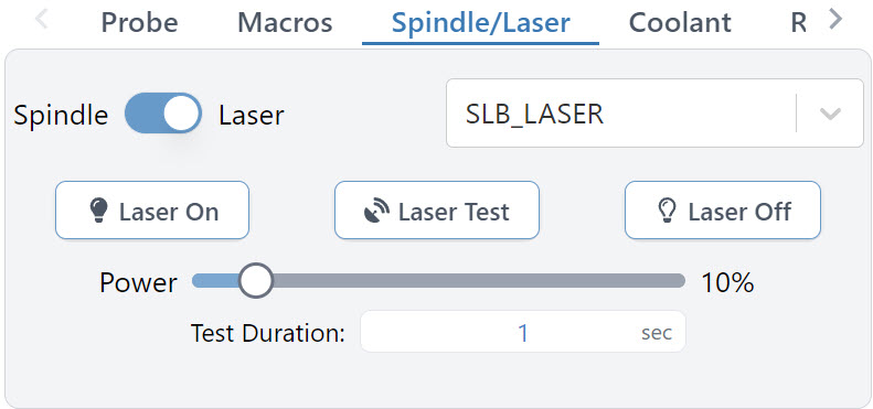

There are a couple test commands you can use to verify that all your wiring and firmware changes have gone as expected. Please be very cautious and aware when testing your laser. Wear eye protection, specifically laser safety glasses, so they’re hugging your face to protect from both direct and indirect laser light, ensure there’s clear signage to warn and protect possible onlookers, have some material beneath your laser that won’t burn easily for when you power it on, and have your hand over the disable switch for your laser power supply so that you have a hardware switch if anything goes wrong.
Test-firing a laser using grbl requires three things:
  1. An ‘ON’ signal (M3)
  2. A power amount (S10). This is at 10% for safety and testing purposes
  3. A movement command. This is a grbl safety feature that disables laser operation unless the CNC is moving
If you’re using gSender the Laser On, Laser Test, and Laser Off buttons will take care of these commands for you, just be sure to set the power to 10% and the Test Duration to around 1-2 seconds. For other g-code senders, you’ll test the laser using the Console input to your LongMill.

Bringing all these commands together you get the full command “G1 F1 M3 S10” which you can enter into the Console to initiate the test and “M5” which you need to enter into the console to turn the laser back off. If this testing is successful for you, then try sending another test at a different power (for example “G1 F1 M3 S5” for 5%) to make sure the laser beam has visibly changed intensity which confirms it’s receiving a good signal.
*Keep in mind that these commands are for a Maximum Spindle Speed of 100, if it’s 255 for example then you’ll want to use “G1 F1 M3 S25” for 10% laser power.
