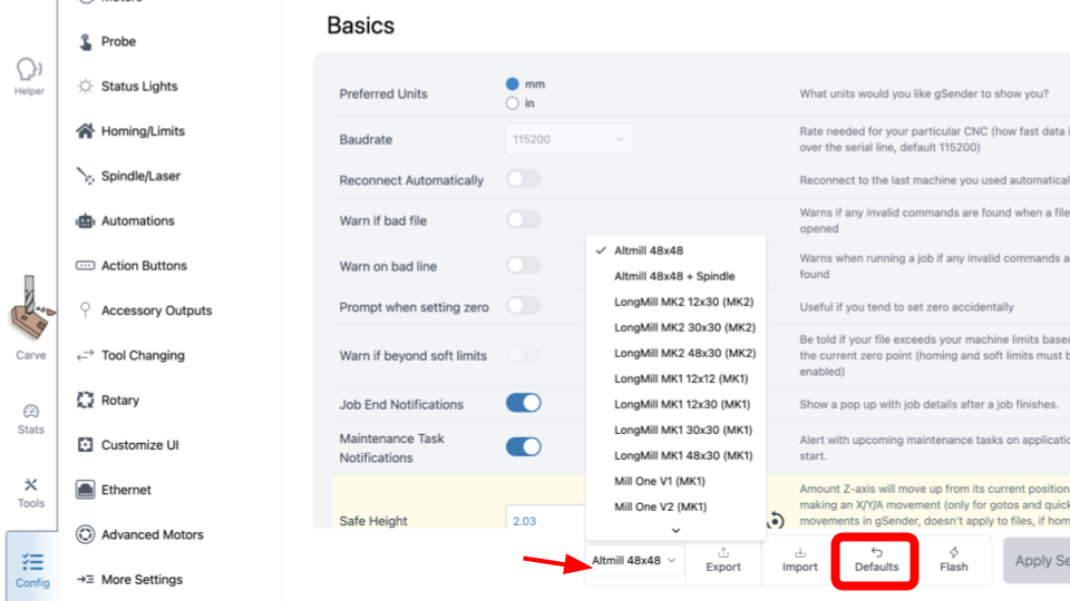

Restore Defaults
Restoring defaults means that you are reverting the controllerβs firmware settings to their original factory values. This may be helpful in a large variety of scenarios, like if the machine is stuck in the homing cycle, if an axis is travelling inaccurately, and if limit switches are triggering too late.
There are two ways to do it: either through the Console or through Firmware Tools/Config.
Console
- Click console in the bottom corner
- Type $RST=$
- Click ‘Run’
- Turn OFF and ON your controller to have the settings take effect
Firmware Tool/Config
1. If you are on gSender 1.4.12 or lower go to ‘Firmware’ on the top of the screen. Select your machine profile in the dropdown, then press Restore Defaults.
If you are on gSender 1.5.0 or higher, go to ‘Config.’ Select your machine profile in the drop down, then press Apply Settings.
2. Once it has processed turn OFF and ON your controller to have the settings take effect.

1. On gSender 1.4.12 or below, go to ‘Firmware.’
On gSender 1.5.0 or above, go to ‘Config.’
2. Press ‘Export Settings’ to save your current firmware settings as a text file – this is your backup in case something goes wrong.
3. Select the correct profile for the machine you own, then press ‘Restore Defaults’ – this ensures that you are starting off your testing with factory firmware settings (this is equivalent to the $RST=$ method shown above).
4. Adjust the settings as needed, referring to the resources pages and/or tech support guidance.
5. Press ‘Apply Settings’ and test machine functionality.
6. If things are working as expected, export your updated firmware settings as a new, separate file.
7. Apply the settings from your new file whenever you need, by pressing ‘Import Settings’ – this will overwrite the existing firmware settings on your controller.
