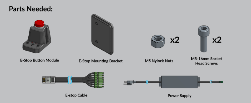

The E-stop is located in the SLB-EXT box.
Fasten the E-stop to the VFD Mounting Bracket on the side of the left table leg, using two (2) M5-16mm socket head screws.
If you did not purchase the Spindle Kit, you will use the E-stop mounting plate provided in the SLB-EXT box to fasten the E-stop to the side of the left table leg. The E-stop Mounting plate is inserted into the left pocket from the inside of the Table Leg with the two holes oriented toward the back of the machine.
Fastening E-stop into E-stop mounting bracket
Insert M5 nylock nuts into the E-stop mounting plate. Use two M5-16mm socket head screws to fasten the E-stop to the mounting plate.
Nylock nuts into E-stop mounting plate
E-stop installed on left side table leg

Plug the green connector of the E-stop cable into the port labeled E-stop on the right side of the controller, and the other side of the cable into the E-stop.
Green connector plugged into controller
Jack connector plugged into E-stop

Plug the green connector of the 48V power supply into the port labelled Power.
Plug the power supply into a 110V outlet.
Power supply connector into SLB-EXT
