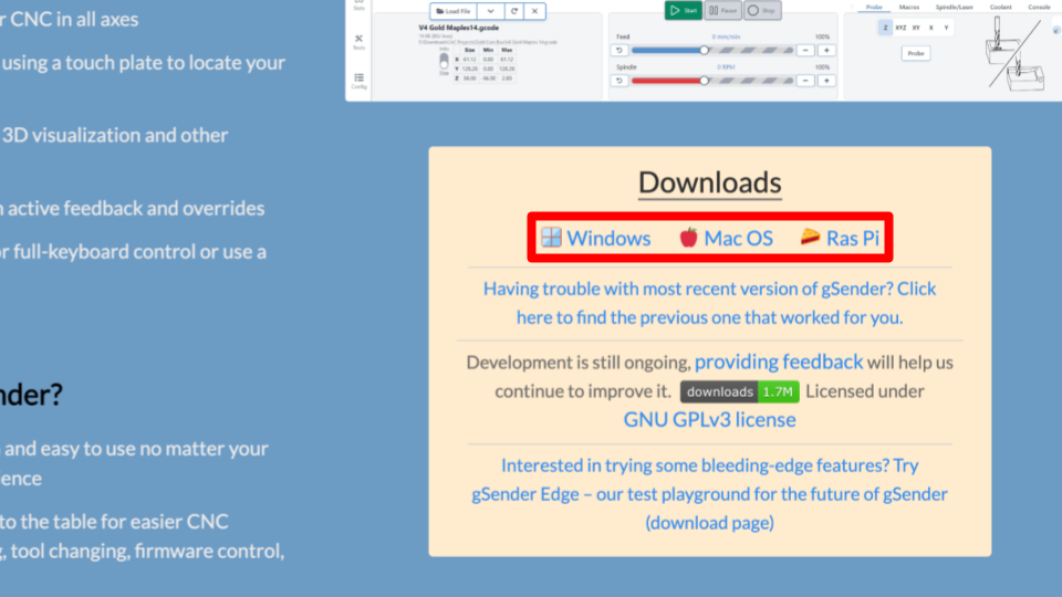

At this stage you will be using your computer (like the gControl panel) to test out the machine’s movement and sensors. If you have the gControl panel, gSender is already downloaded and installed, and you can go to this section.
Download gSender through this page by selecting your computer’s operating system.
Then install the application, we have a guide on this in our gSender resources page which also covers some potential problems you may encounter.

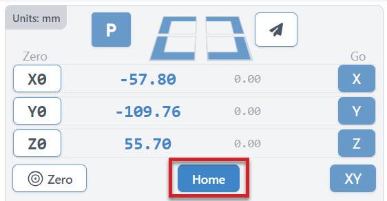

If all seems to be functioning properly, we will now test the homing functionality. You must home everytime you connect to gSender, otherwise the machine does not know where the bounds of travel are.
Click the ‘Home’ button, this will cause the machine to move:
1. Upwards, stopping at the upper Z limit. Note: If you see an Alarm 10 after the Z-axis moves to the top, you will need to adjust the sensor. Follow the instructions here.
2. Diagonally to the back left corner of the machine, stopping at the X and Y limits. Note: If you see an Alarm 15 after the Y-axis moves, please follow the instructions here.
Homing controls for all axes
If you’re still seeing an error, press the E-stop button to cut power the motors, then gently turn the left or right Y-axis ball screw to make sure the left and right Y-axis gantry plates are equally close to the left and right inductive sensors, then release the E-stop button to power on the motors and try again.
