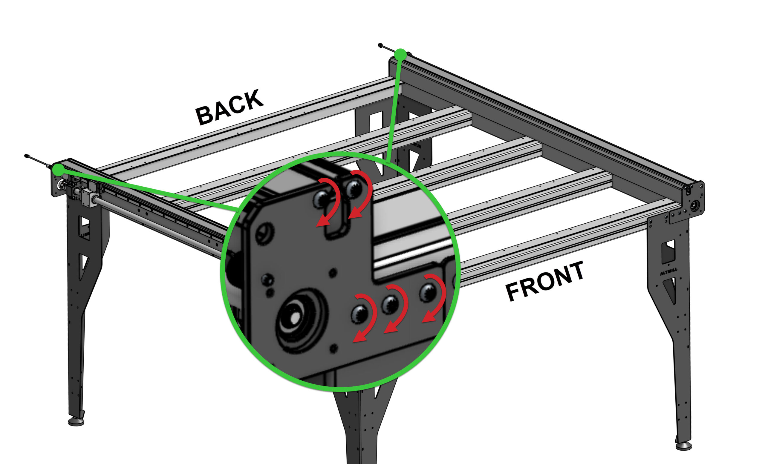

Finally, with the motors fully mounted, finish securing the back end plates on the table.
Now that we have our motors mounted, let’s do a final fit check. On both Y-axis sides, ensure that:
1. The motor coupler is centered to the circular cutout on the Y-end plate
2. The table leg does not interfere with the Y-end plate
Please re-assemble the table legs and Y-end plates until the components are properly aligned as specified in the check. You can loosen the fasteners, then slide the components into place before securing them again.
