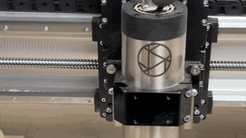

- All couplers have been fully tightened on both the motor shaft and ballscrew sides

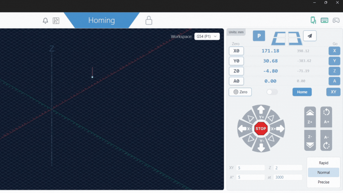

- Machine is able to successfully home without alarms or errors
- Jog the machine away from the X, Y and Z sensors
- Then press “Home”
- If you encounter alarms or errors see this troubleshooting page
Default homing at back left corner on AltMill
