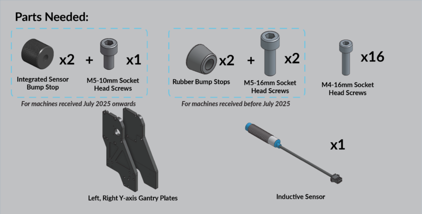

Remove the clear plastic wrap surrounding the linear bearings and ball screw nut.
Remove the plastic clip supporting the ball screw nut.
Support clip removal
Take note of the difference between the left and right side Y-axis gantry plates. The large hole indicates the left Y-gantry.
Additionally, take note of the Y-gantry plate orientation. In the image below, the front of each plate is pointed toward the center of the image.
Left and right Y-axis gantry plates with forward direction pointed toward center

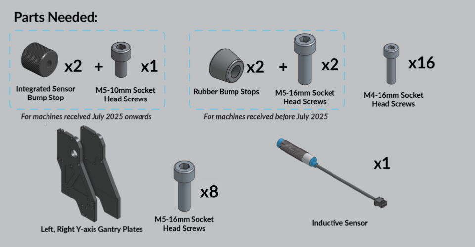

Rest the reference edge of the Y-axis gantry plate on the top face of the two linear bearings. Use M4-16mm socket head screws to fasten the plate to the linear bearings. Start with two (2) screws, installing one screw in each bearing before moving on to install the remaining six (6) screws. Leave the eight (8) screws loose at this point to allow for easy installation of X-axis rail in the future.
Repeat the process on the other side of the machine.
Y-gantry plate reference edge sitting on linear bearings
Y-axis gantry plate, linear bearing M4-16mm screw location, leave loose
Push the Y-axis gantry plate to the front of the machine, hard-stopping on the bump stop.
Push the ballscrew nut toward the front of the machine and align the threaded holes of the nut with the mounting holes of the Y-axis gantry plate.
Install four (4) M5-16mm socket head cap screws through the Y-axis gantry plate into the ball screw nut, leaving the screws loose at this point to allow for easy installation of X-axis rail in the future.
Aligning Y gantry to aluminum ball screw nut block
Y-axis gantry plate fastened to ball screw nut using M5-16mm screws, leave loose
Y-axis gantries pushed against front bump stops

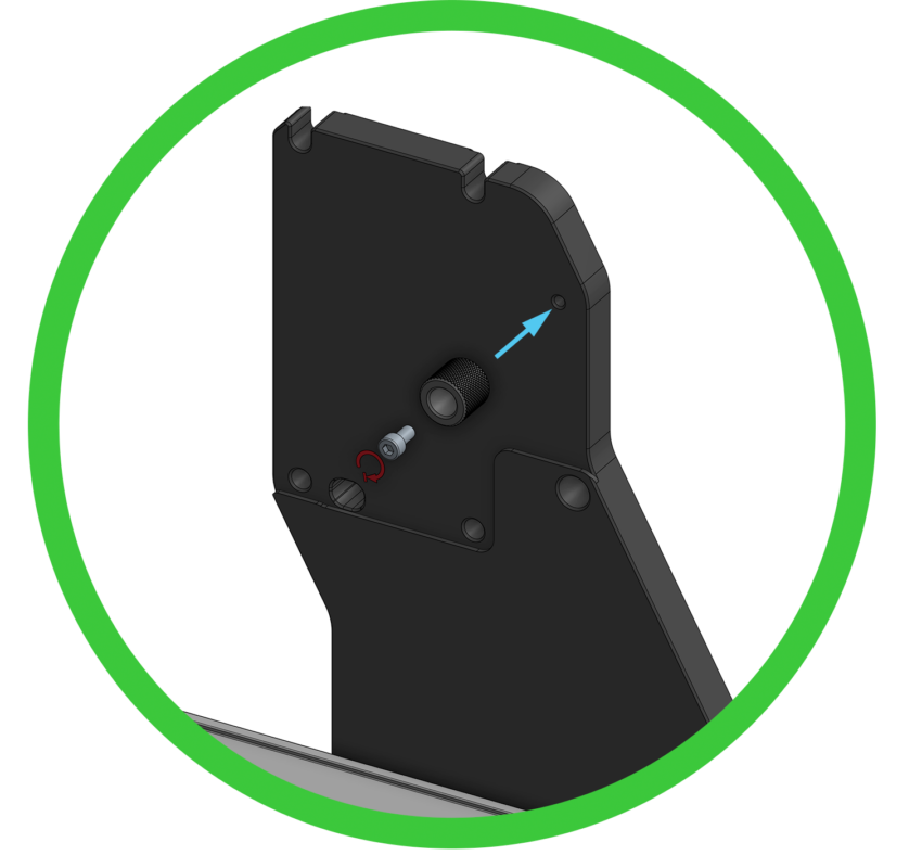

Install one bump stop into the right-side Y-axis gantry plate using an M5-10mm socket head screw as shown below.
Installing single integrated sensor bump stop onto right Y-axis gantry plate

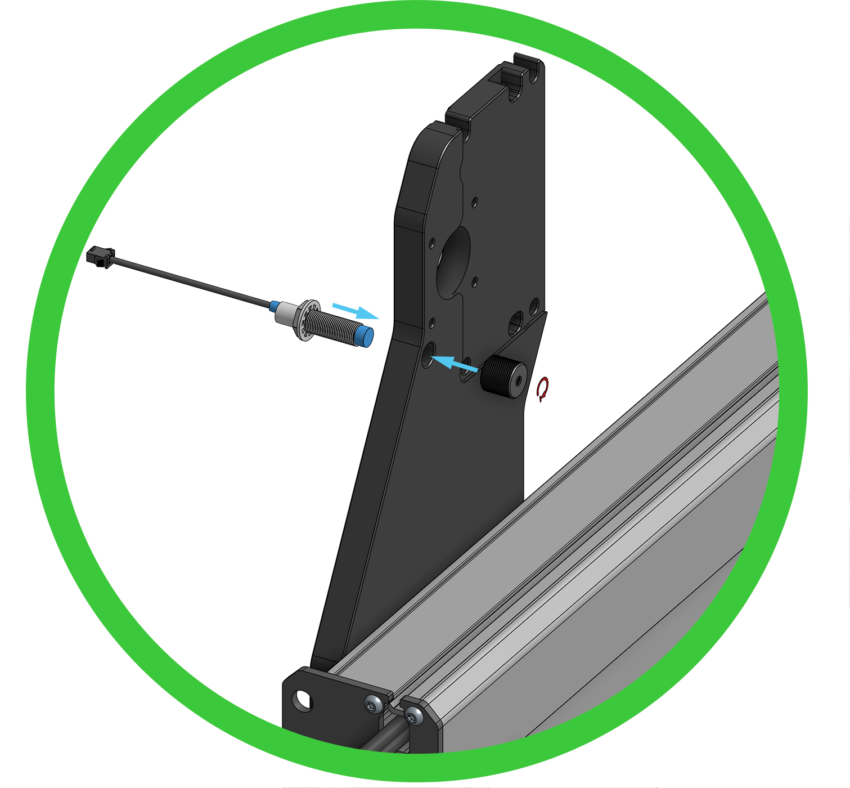

Prepare one inductive sensor by threading a nut onto it approximately 45mm / 1.5 inches, and add a lock washer.

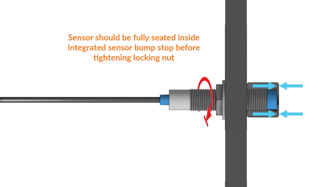

Pass this inductive sensor through the hole of the left side Y-axis gantry plate, and install the remaining integrated sensor bump stop over the end of the sensor as done before. Ensure the integrated bump stop is fully seated on the end of the sensor similar to the previous two sensors already installed.
Installing integrated sensor bump stop over X-axis sensor
Pass the sensor through the left Y-axis plate, and install a lock washer and a nut onto the sensor to clamp it onto the plate.
The sensor can not stick out past the bump stop. Recess the sensor stick-out distance by 1mm – 2mm from the face of the bump stop. You can use the flat face of the provided wrench to place on the bump stop face and use as a reference for sensor stick-out.
This step is important as it ensures the sensor will not be damaged when the X-axis gantry plate contacts the bump stop during use.
X-axis sensor installation
