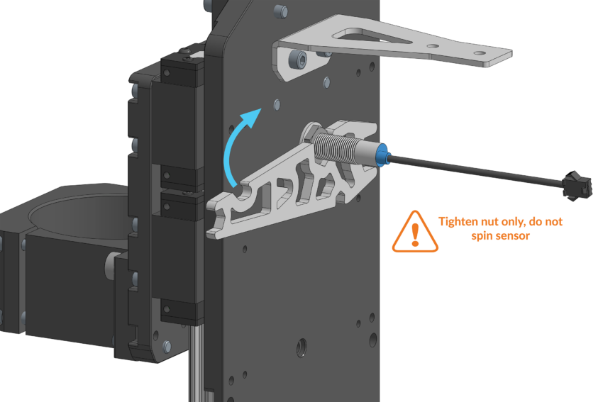

Prepare the last inductive sensor by threading a nut onto it until it reaches the middle of the sensor, and add a lock washer.

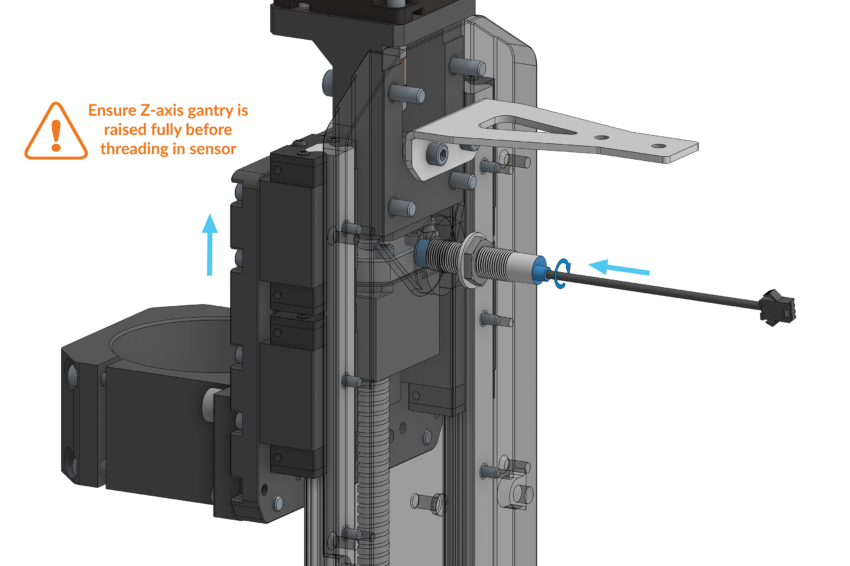

Slide the Z-axis gantry up to its highest position until it can’t move further. Thread the inductive sensor loosely through the back of the Z-axis assembly until the sensor bottoms out and locates inside the plate, do not tighten this further.

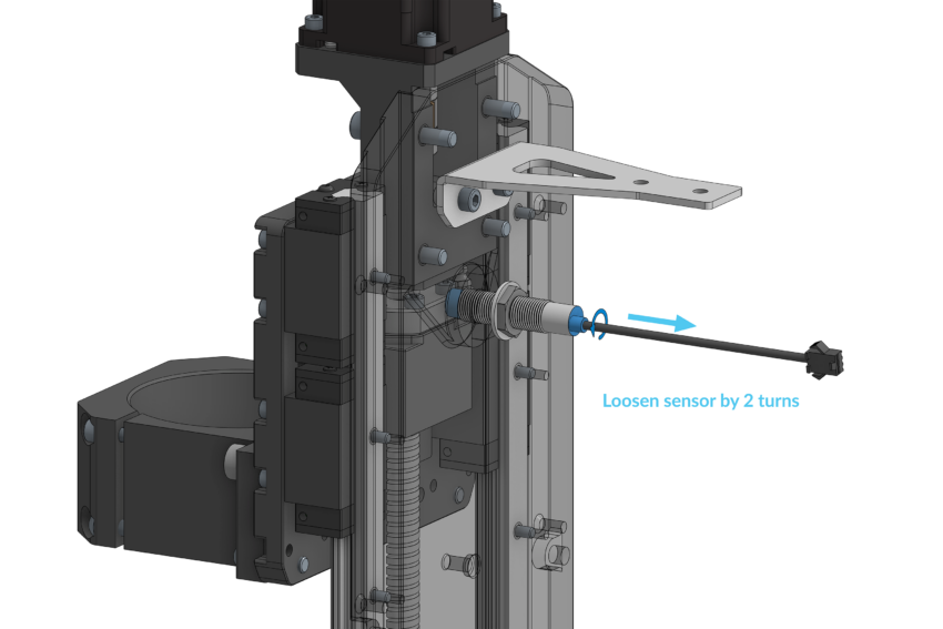

Next, loosen the sensor by 2 turns. This will locate the depth of the sensor correctly to ensure it triggers at the correct distance.
Lastly, lock the sensor in place by tightening the lock nut on the sensor using the side of the included wrench. Avoid spinning the sensor while doing so.
