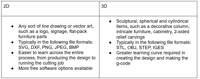

2D
  • Any sort of line drawing or vector art, such as a logo, signage, flat-pack furniture parts
  • Typically in the following file formats: SVG, DXF, PNG, JPEG, BMP
  • Easier to learn across the entire process, from producing the design to running the cutting job
  • More free software options available
3D
  • Sculptural, spherical and cylindrical items, such as a decorative column, intricate furniture, cabinetry, 2-sided relief carvings
  • Typically in the following file formats: STL, OBJ, STEP, IGES
  • Greater learning curve required in creating the design and making the g-code
2D vs 3D designs, from left to right
