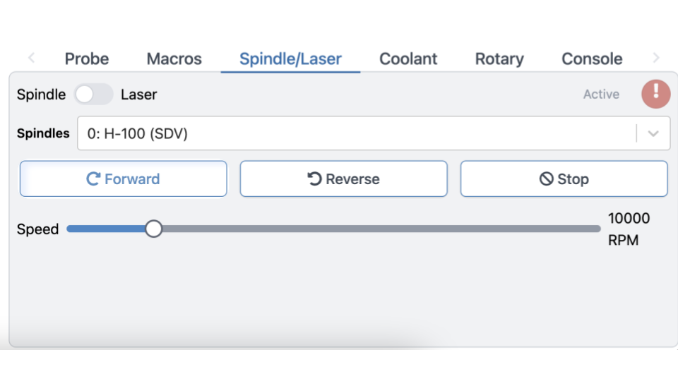

On gSender, you may have noticed that the main way to control the spindle is through the built-in buttons and sliders in the Spindle/Laser tab.
However there are two other ways to tell your spindle to spin up to a certain speed, change rotation direction and stop.

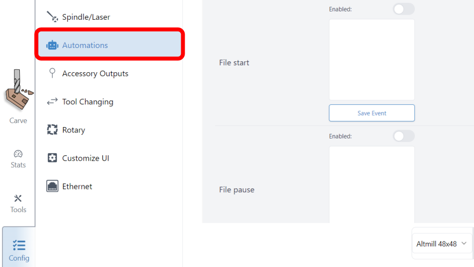

Automations
You can find automations at Config, at the left side bar.

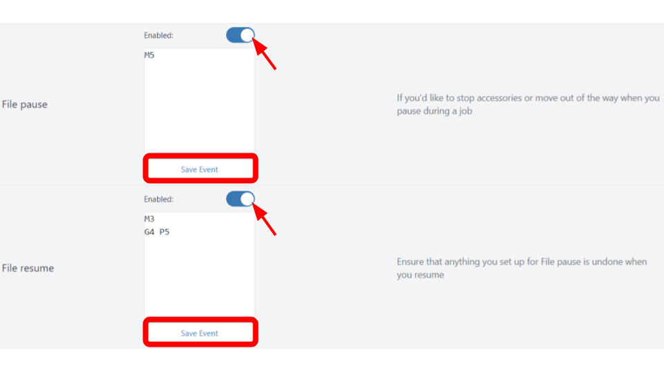

These Automations will occur at specified instances – specifically when you start, pause, resume and stop the job. Currently, gSender will not stop the spindle when the job pauses, nor start up the spindle when the job resumes. Therefore, we recommend inputting the following set of commands for peace of mind:
Pause
M5 Stops the spindle when you pause the job
Resume
M3 Spins up the spindle to the previous programmed RPM, counterclockwise
G4 P5 Gives 5 second dwell time for the spindle to get to speed
To put these into effect, set the toggles to “Enabled”, and then press “Save Event.”
