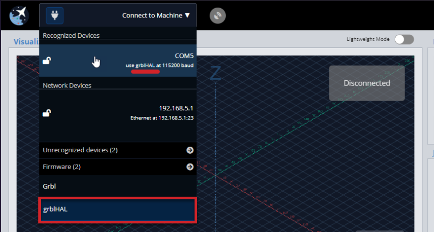

Error 2
Ensure that you are connecting using grblHAL.
